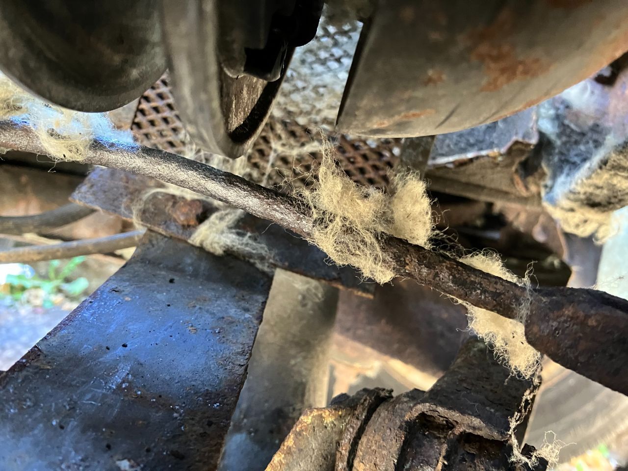

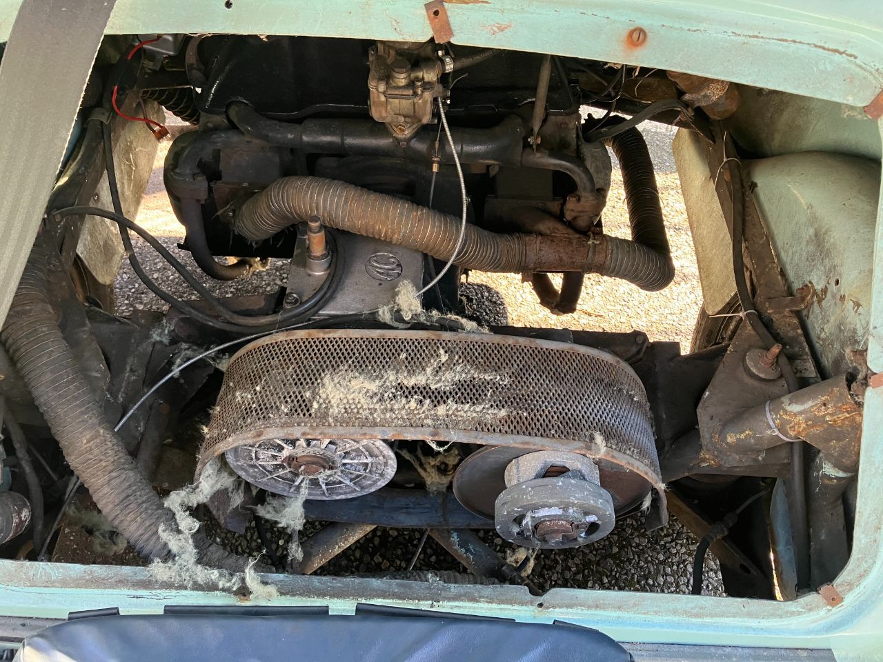

LightBulbFun Posted April 7 Author Posted April 7 so I popped down to REV got the seat-back out and then got the rear parcel shelf/gearbox/transmission access hatch out, where it looks like some small fluffy animal has exploded alarmingly I discovered the reason for the gear-shifter suddenly being stiff is not because of the string wrapped around it, but because its somehow become bent both upwards and to the left, and so it was now fowling on the hole that it enters the cabin through, and the linkage where it attaches to the gearbox is visibly twisted, so this in itself is pretty bad, how did it get bent, did it happen while the belt fell apart (maybe it was briefly grabbed by a bit of flailing belt?) or did something else happen which cause it to bend also cause the belt to fail? I had a look at the gearbox mountings, as I wondered did one fail or something and let the gearbox drop? and while they dont look in the first flush of youth, I dont think they have failed either but the other worrying concern is whats happened to the pulleys, for point of refrence this is the resting position they should look like (picture stolen from Zel) and heres what mine are current like as you can see the domed one thats meant to be resting open, is stuck closed and the one thats meant to be resting closed, is stuck open! and in the domed pulley bits of fluff/string have gotten inside of it for reference here is how REV's CVT area looked in 2019, you can see the gear selector rod was not bent then I do have set or 2 of new pulleys thankfully in the parts stash, but fitting them I fear might be a bit tricky for me, for example im not sure how re-usable these rectangular locking washer things are or where one might get replacements and then there is the matter of the bent gear selector rod, I suppose one would hope it can just be straightened out? but there is still the over-arching question of how did it get bent in the first place so I am little bit stuck as to what to do now, as it clearly wont be a simple case of chuck a new drive belt on as I had hoped, I suppose the fix from here would be remove pulleys, somehow straighten out the gear-selector rod and fit new pulleys with new belt Remspoor, beko1987, Dick Cheeseburger and 1 other 4
richardmorris Posted April 7 Posted April 7 Very likely it got whacked by the remains of the belt at 4000rpm ( or whatever it does on the m25). Sorry you couldn’t make it all the way, but very pleased it wasn’t catastrophic and more perilous for you. BesT place to come to a stop- well off the active lanes the other side of the slip road. MrGTI6, lesapandre, Zelandeth and 1 other 1 3
LightBulbFun Posted April 7 Author Posted April 7 7 minutes ago, richardmorris said: Very likely it got whacked by the remains of the belt at 4000rpm ( or whatever it does on the m25). yeah I am thinking this as there was a bit of a sudden shunt/slow down when everything suddenly let go (which is why in the moment I was worried that maybe my differential had just exploded or something along those lines!) but thankfully thats fine, the car rolls freely and the pulley attatched to the gearbox turns freely (and I can see the clutch drum turning as it should when I do that, so I know the rest of the drive line is fine I think! its just the CVT bit of things thats literally thrown a strop I cant see anything else out place that could cause it lesapandre, richardmorris and rustdevil 3
