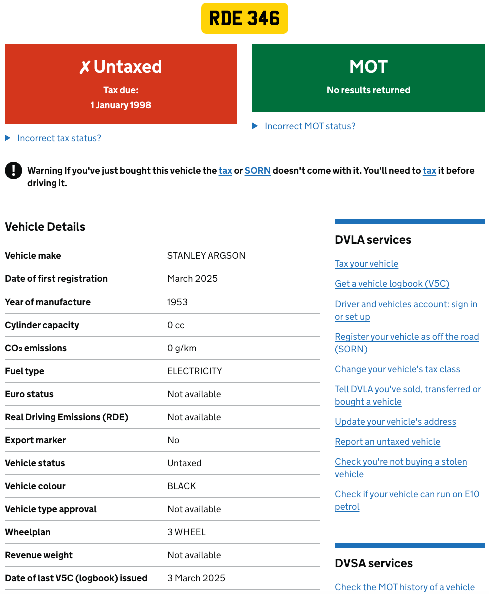

brummiejon Posted March 8, 2025 Posted March 8, 2025 Hi all.... Apologies for going off the recent and interesting topic... Some exiting news.... After a 3 year battle and endless writing and research, Flo, my Argson Electric has a V5..... Interestingly, the DVLA would only let me register with an age related plate, but the plate they have issued me is her original plate number.... So by the back door, I have retained the original number plate..... What a relief.... So the plates are going on today (the original ones)..... Can anyone recommend a suitable insurance company? adw1977, catsinthewelder, Andrew353w and 10 others 8 1 4
LightBulbFun Posted March 8, 2025 Author Posted March 8, 2025 4 hours ago, brummiejon said: Hi all.... Apologies for going off the recent and interesting topic... Some exiting news.... After a 3 year battle and endless writing and research, Flo, my Argson Electric has a V5..... Interestingly, the DVLA would only let me register with an age related plate, but the plate they have issued me is her original plate number.... So by the back door, I have retained the original number plate..... What a relief.... So the plates are going on today (the original ones)..... Can anyone recommend a suitable insurance company? indeed! its quite Awesome to see that the DVLA finally stopped messing about/prevaricate about the bush (for the most part), and got Flo Properly registered for insurance I have had good luck with BikeSure they are who REV is insured with, she is insured as an every-day vehicle, its explicitly not any sort of classic policy, but just a regular trike policy with no strings attached, and I have full breakdown cover included too, even covers me for trips abroad so if Flo is to be used regularly/as your only vehicle, thats who I would recommend although I imagine Flo is probably kept in a garage, so you might have some luck with the Classic insurance people like Hagerty (I know of a couple Model 70's insured with them) etc, although some as well as garaging also require you to have another vehicle thats on an every-day policy, so if Flo is your only vehicle your milage may vary when getting a classic policy but REV's regular policy is only a few hundred quid a year, for street parking in Central London, so even if you cant get a classic policy for Flo I imagine a regular policy wont be too much just make sure you nail home the point, that she *is* an Invalid Carriage, by the letter of the law, just make sure they are aware of that Mrs6C, richardmorris and brummiejon 3

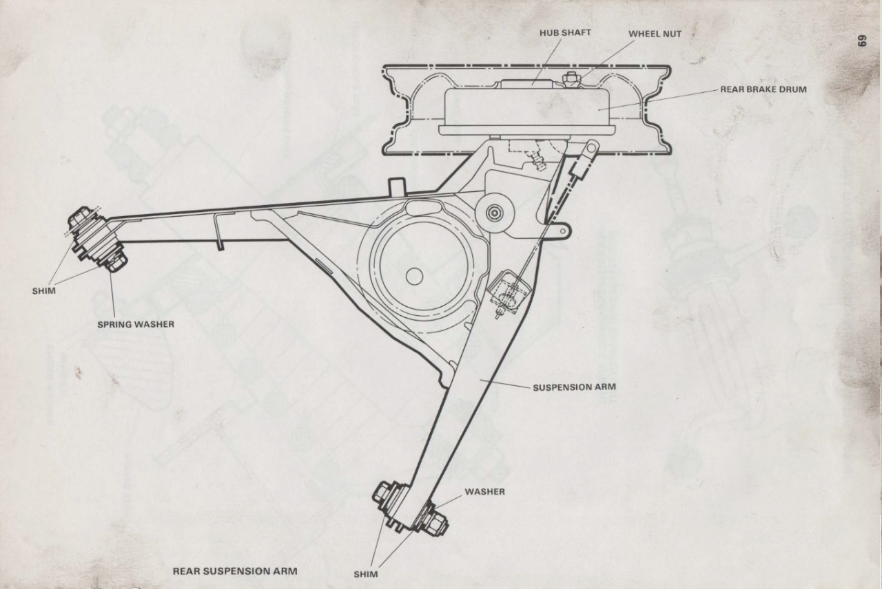

LightBulbFun Posted March 8, 2025 Author Posted March 8, 2025 speaking of Ye Olde Carriages, I had another stab at REV's brakes with my brother kindly popping down to help with the heavy lifting like egg very kindly did a couple days ago armed with the extra knowledge from the most recent posts, I was able to (with the wheels off the ground) get the handbrake to lock the wheels with 6 clicks of the ratchet, beforehand it was 8 clicks, tbh the brakes still feel the same as they did previously, but the fact I have taken a couple clicks out the handbrake travel obviously shows there was a little bit of adjustment needed on the front wheel, just as a sanity check, I have currently got it adjusted so that with the front up in the air you can give it a flick and it will spin round quite freely about twice before coming to a stop on the 3rd go round where it stops on the high point of the shoes (or would that be the low point in the drum?), as I understand it thats how you want it, but figured cant hurt to just mention it incase I am mistaken either way things seem to be working good, although I still cant lock the wheels with the handbrake my brother verified I was locking up the rear wheels with the hydraulic brake, so ill take that! we did briefly look at fitting the relay kit and I managed to actually get the nearside trim ring off that headlight and inspect its hardware (having previously done the offside one a little while back) but I was quite knackered at that point, so I made the decision to leave that for next time I did manage to remember tho to measure up the dimensions of the windscreen so I know how much windscreen seal to order for when I do that job, and I also measured up the diameter of the throttle cable inner, I would like to keep a length of that on hand in the car given that Model 70's do like to eat throttle cables! all in all a pretty good day, and although things dont feel any different, the fact the handbrake is a couple clicks shorter now ill take that as a win/a sign of having actually managed to do something LOL and at the end of everything, I did go for a 1.5 mile jaunt around the block, and none of the brakes felt hot/nothing felt like it was binding, so hopefully alls good on that front! its been an interesting learning experience if nothing else egg, Dyslexic Viking, Vimesy and 18 others 16 5

LightBulbFun Posted March 10, 2025 Author Posted March 10, 2025 1 hour ago, egg said: @LightBulbFungood to hear, still pulling a bit to the left under heavy braking? I think a little bit, which is extra strange because when I set up the handbrake and got it for 6 clicks it was the left nearside wheel that with a fair bit of effort you could still turn, ie was slightly looser then the right offside wheel which was completely locked up solid at that point, so why would it pull to the left under braking, if that left side showed to be the looser of the 2, I am not sure! I have a recollection of someone mentioning REV pulling to the left a bit under hard breaking on the day I picked her up from the FoD (ie before we started fiddling with things) so whatever it is its long standing, I almost wonder if it might with the brake shoe materials themselves, maybe when you slam on, 1 set is just gripper then the other, its all the more reason to get the drums off at some point and have a look at things Marshall2810 and egg 1 1
RayMK Posted March 10, 2025 Posted March 10, 2025 41 minutes ago, LightBulbFun said: I think a little bit, which is extra strange because when I set up the handbrake and got it for 6 clicks it was the left nearside wheel that with a fair bit of effort you could still turn, ie was slightly looser then the right offside wheel which was completely locked up solid at that point, so why would it pull to the left under braking, if that left side showed to be the looser of the 2, I am not sure! I have a recollection of someone mentioning REV pulling to the left a bit under hard breaking on the day I picked her up from the FoD (ie before we started fiddling with things) so whatever it is its long standing, I almost wonder if it might with the brake shoe materials themselves, maybe when you slam on, 1 set is just gripper then the other, its all the more reason to get the drums off at some point and have a look at things It may be worth checking all of the suspension mountings as they can also cause alignment to change under braking if they are worn or corroded and have play or are flexing. I know this because I was proudly demonstrating my Triumph Herald estate to my dad in the early 1980s when a dog ran out in front and I dabbed the brakes hard. Afterwards, the rear steer on even light braking was interesting. The right hand rear tie bar which had been brazed to an outrigger, not welded, had pulled away. Rear wheel fore and aft location was then only by the transverse leaf spring and somewhat lax. mercedade, wuvvum, egg and 1 other 3 1

LightBulbFun Posted March 10, 2025 Author Posted March 10, 2025 23 minutes ago, RayMK said: It may be worth checking all of the suspension mountings as they can also cause alignment to change under braking if they are worn or corroded and have play or are flexing. I know this because I was proudly demonstrating my Triumph Herald estate to my dad in the early 1980s when a dog ran out in front and I dabbed the brakes hard. Afterwards, the rear steer on even light braking was interesting. The right hand rear tie bar which had been brazed to an outrigger, not welded, had pulled away. Rear wheel fore and aft location was then only by the transverse leaf spring and somewhat lax. funnily enough me and @egg where wondering about that, as REV's offside rear right spring has sagged quite a bit compared to the the offside left (although I dont *think* its broken, when REV went away I did mention this issue incase it was something more sinister and I was told its just a tired spring, and I detect no clunking or otherwise undue noises from that corner) so we where wondering if that would affect braking, but theres no front and back movement (I think things would have to be quite badly messed up for that to happen on semi-trailing arms?) egg 1

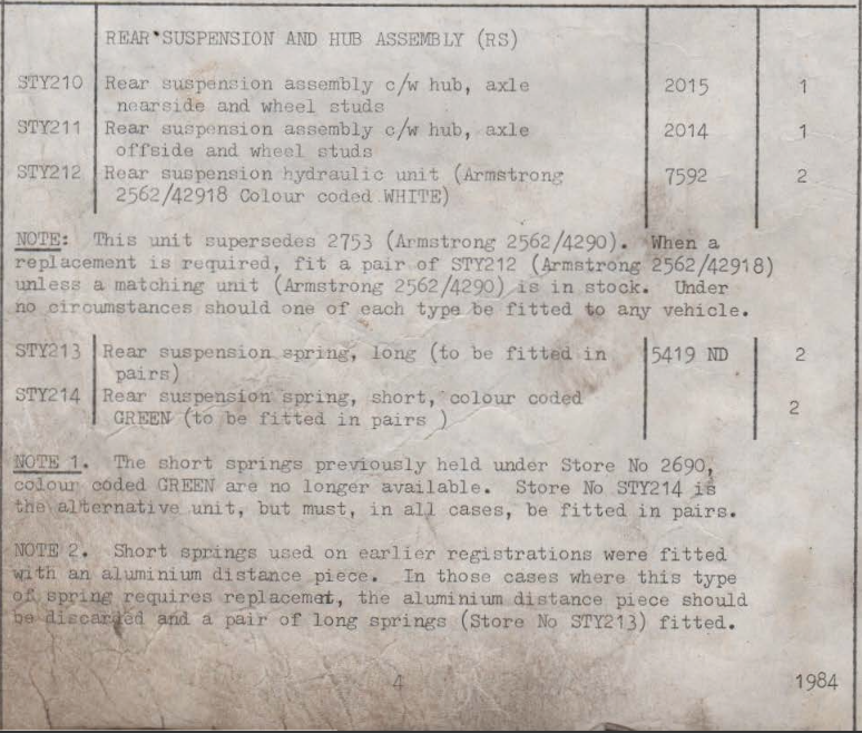

RayMK Posted March 10, 2025 Posted March 10, 2025 9 minutes ago, LightBulbFun said: funnily enough me and @egg where wondering about that, as REV's offside rear right spring has sagged quite a bit compared to the the offside left (although I dont *think* its broken, when REV went away I did mention this issue incase it was something more sinister and I was told its just a tired spring, and I detect no clunking or otherwise undue noises from that corner) so we where wondering if that would affect braking, but theres no front and back movement (I think things would have to be quite badly messed up for that to happen on semi-trailing arms?) If there is no obvious front/back movement it's a good sign that nothing too serious is going on, although the forces when braking are more than you can apply by hand - unless using leverage. Differing suspension height left to right caused by a tired or broken spring could have a small effect on straight line running with semi trailing arms. It depends on the designed-in geometry as to how much you might notice it. Some semi trailing arms are closer to being trailing arms. With those, there's very little change in toe-in or out with suspension deflection. I can't recall what the Invacar geometry is for the rear suspension but I'd be mainly checking condition of the metal bits, integrity of bushes and correct tightness of suspension fittings rather than slight geometric effects. If it's all secure and the pulling is very mild, just live with it. I once had a Jawa 350 with a sidecar. That had severe pulling to the right under braking (unbraked sidecar) and mild pulling to the left under acceleration*. I got used to it after 50 miles. No problem 🤣. egg and LightBulbFun 2
LightBulbFun Posted March 10, 2025 Author Posted March 10, 2025 16 minutes ago, RayMK said: If there is no obvious front/back movement it's a good sign that nothing too serious is going on, although the forces when braking are more than you can apply by hand - unless using leverage. Differing suspension height left to right caused by a tired or broken spring could have a small effect on straight line running with semi trailing arms. It depends on the designed-in geometry as to how much you might notice it. Some semi trailing arms are closer to being trailing arms. With those, there's very little change in toe-in or out with suspension deflection. I can't recall what the Invacar geometry is for the rear suspension but I'd be mainly checking condition of the metal bits, integrity of bushes and correct tightness of suspension fittings rather than slight geometric effects. If it's all secure and the pulling is very mild, just live with it. I once had a Jawa 350 with a sidecar. That had severe pulling to the right under braking (unbraked sidecar) and mild pulling to the left under acceleration*. I got used to it after 50 miles. No problem 🤣. tis Fiat 500 (but re-drilled for 4x4 inch PCD and fitted with girling brakes and bespoke 7 inch drums) thankfully as you say, its quite liveable with, its quite correctable, its not trying to make me pirouette on the spot or anything like that its only noticable when you do an emergency stop do you notice it and even then it seems almost dependent on the road surface (it seemed to want to pull more to the left on roads around the dead end rather then in the dead end itself, and I notice in the roads around the dead end I was able to get some quite impressive tyre screeching, but in the dead end itself it was much more of a gruff skidding if that makes sense!) funnily enough this saggy spring thing is one of things that have made me wonder what the story was with REV in her past, as for a fair majority of the problems she has had, theres been exactly *that* part in the spares stash I got with her, it almost gives me the impression that her previous owner had gone over REV, noted down her issues,, got the parts to sort them all, but never actually got round to doing the job, for example in the spares stash I *do* have a set of Model 70 rear coil springs (which im quite pleased about, because although Fiat 500 springs and shocks probably would physically fit, the damping/spring rates would probably be all wrong, even the ministry themselves went through a couple different spring and a few damper changes for the rear suspension RayMK and egg 1 1
RayMK Posted March 10, 2025 Posted March 10, 2025 Interesting. It is quite common in suspension design to have conflicting geometry, particularly in modern multi-link designs. The 'conflict' is usually deliberate in order to force a desirable characteristic under certain conditions e.g. passive rear steer to modify the vehicle's oversteer or understeer during cornering or often just to give varying compliance to improve ride characteristics. Rubber bushes or in some cases flexure of a suspension component accommodates the conflict. The Invacar semi trailing arms have a pivot axis which is not shared by the bushed pivot mountings i.e. the axes extended from each of the two hinge points are not the same. I wonder why? Perhaps because Fiat did it that way. The 'steeper' angle of the arms (the 'semi' bit of the equation) will give stronger resistance to roll than a more trailing set-up but also gives greater changes in camber and toe-in/toe- out when the arm is deflected. LightBulbFun 1
