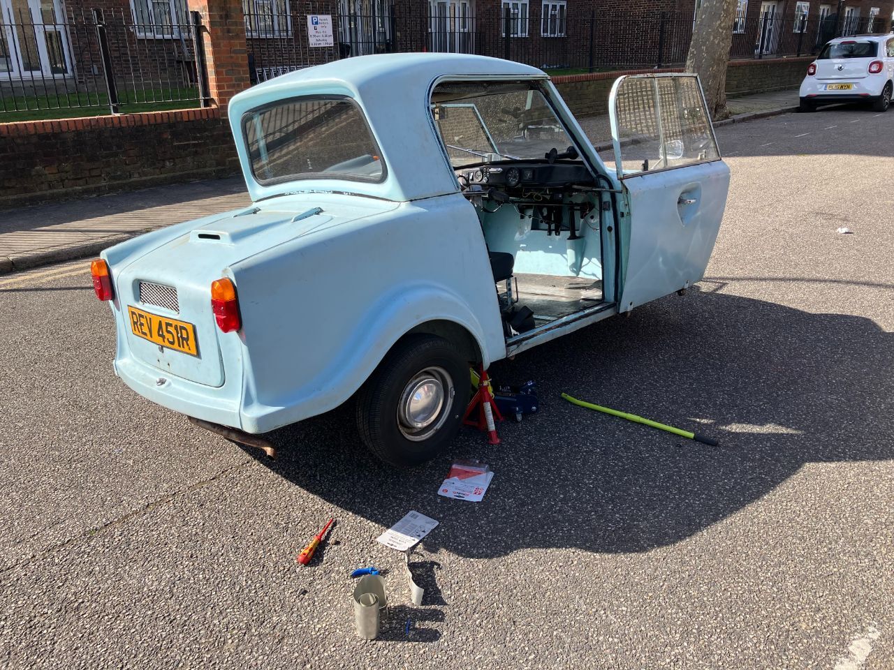

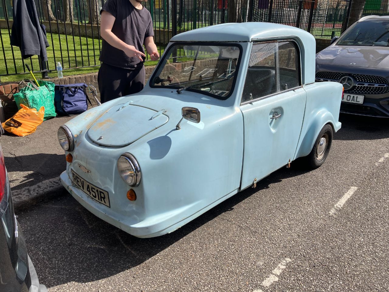

speaking of Invacar Model 70's, I roped my brother over here and had a go at bandaging up REV's holed exhaust down pipe
it appears REV had found a Tennis ball to play with!

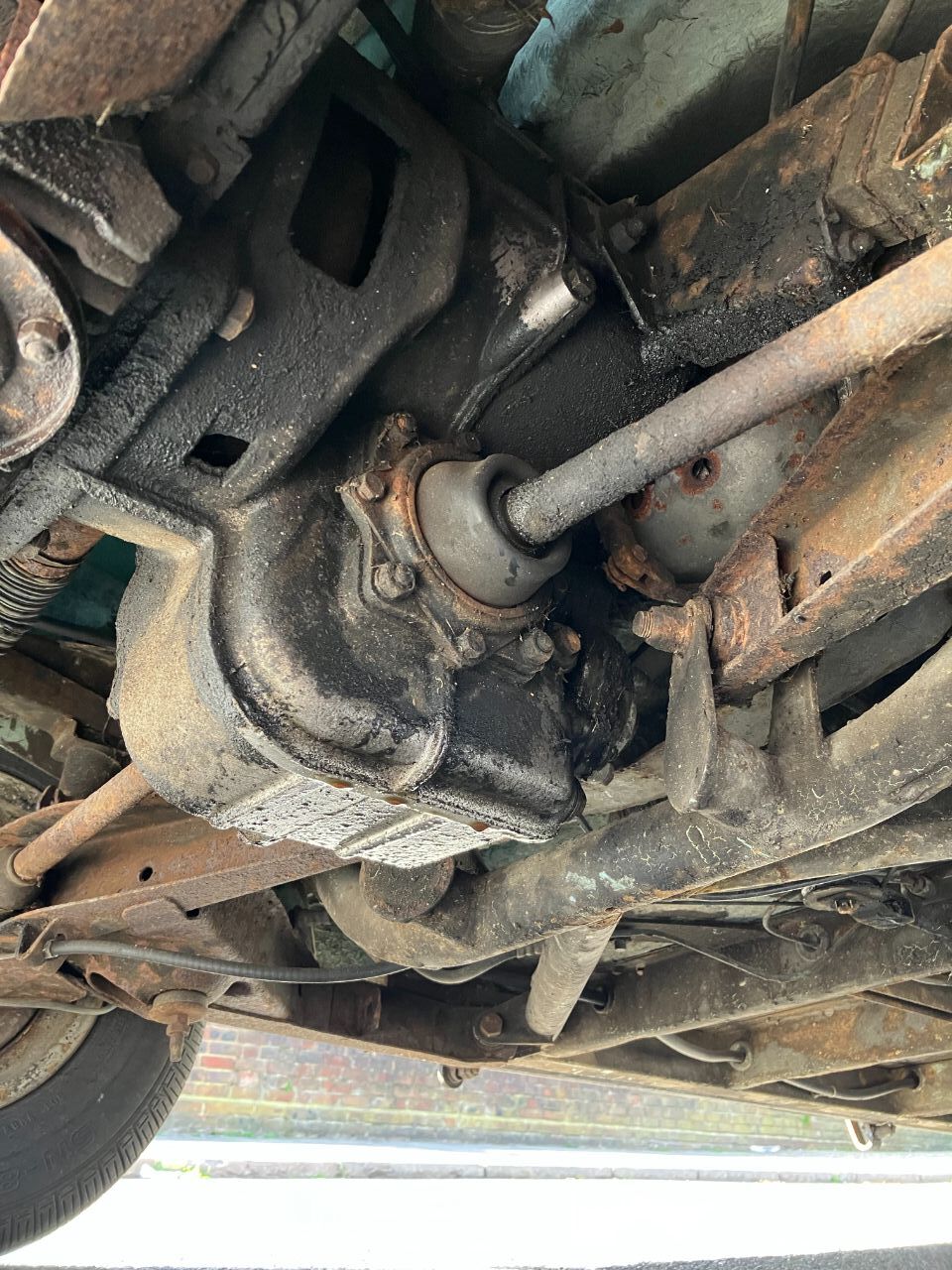

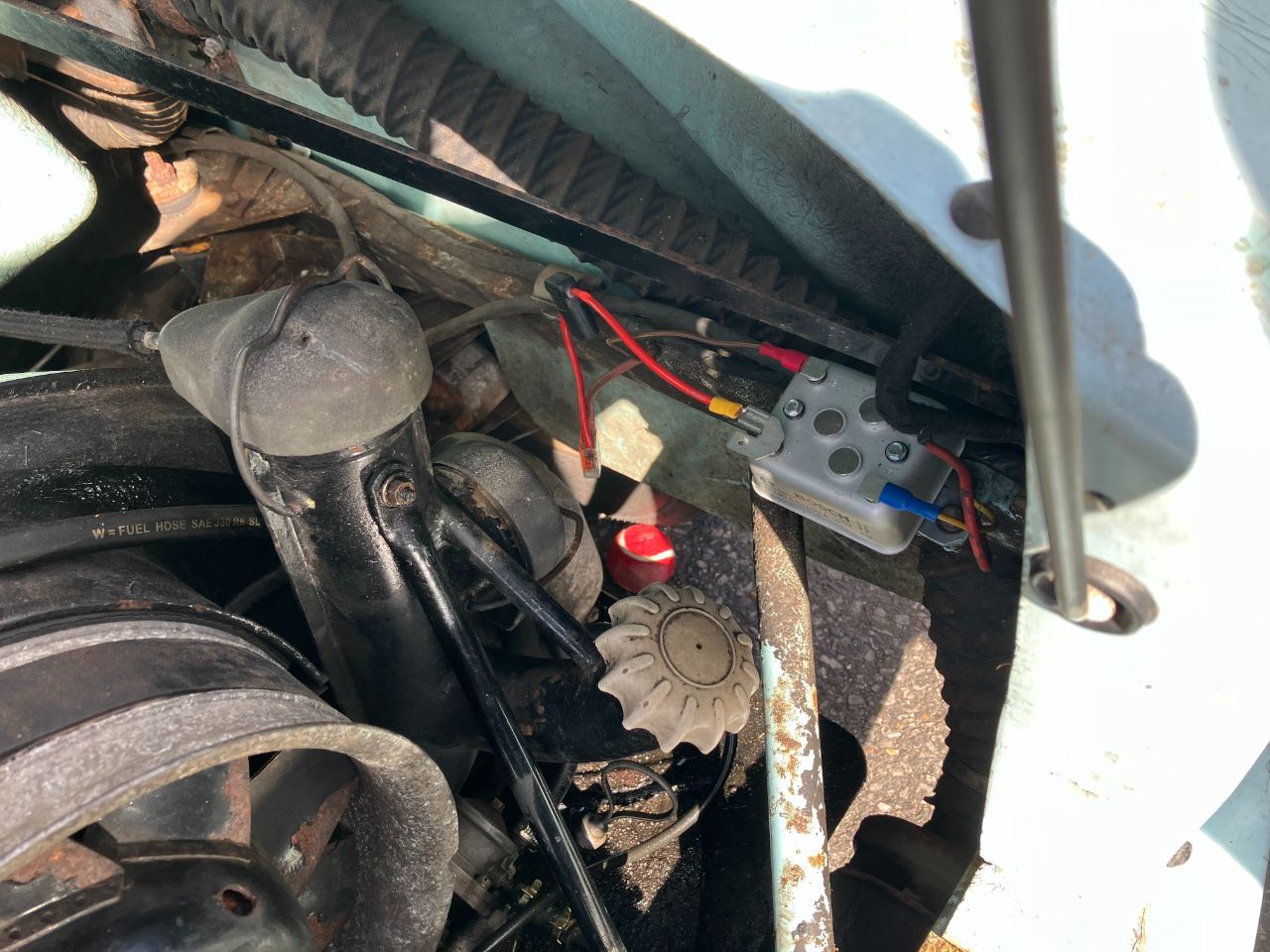

I also had a look at REV's oil leakage situation, this is after just over a week of sitting
although weirdly the differential itself looks oddly dry, apart from the drops of oil on the bottoms, im *assuming* the oil is leaking out of the drive shaft entry points, but I cant see much in the way of wetness there
the engine does not seem so bad, but the relatively big splodge from under the differential is a bit concerning, especially as you cant just easily glug a bit more oil in to keep on top of it, not without having to crawl about un doing level plugs etc, speaking of that sort of thing tho, I did top up REV's main engine oil amount, twas looking a bit low on the dip stick, although its always a bit tricky to tell because of the camber in the road, REV's saggy spring and the chassis rail thats right in the way of the dip stick preventing you from properly pulling it out straight
 but onto the main task at hand the hole above! which as I thought had gotten a bit bigger (it sounded like it on my most recent drives) but some prodding/poking with a finger did not make it any bigger
so jacked up that side and went to work
and after *much* faffing about
got the hole bandaged and pasted up! obviously cant tell how well its worked until things have had a chance to set, but hopefully it works! that corner of the tinwork that was up against the pipe made things bloody faff combined with the fact the hole was just behind a Y joint, so I had to take a notch out of one side of the bandage so as to (hopefully) be able slide it along far enough, in true  Autoshite fashion, the down pipe could not of picked a worse place to have holed itself! but eventually managed to get some paste all around and over the hole, slide the bandage over, tighten it up to buggery and then slather the whole thing  in exhaust paste for good measure
again remains to be seen if/how well it works, but I am hoping it does after all this faffing about with it!
and then REV was pushed back into a parking spot, and we wrapped things up here as I was not in any state to do anything else! (again I was thinking maybe i'd get the chance to fit the headlight relay kit I keep mentioning on wanting to fit, but not this time!)
next planned outing is on the 6th of april to this gathering, so hopefully that will have given it plenty of time to set! https://autoshite.com/topic/62113-autoshite-south-east-meet-sun-6-april-2025-flower-farm-again-again
(although it will also be a bit of a trial by fire for the exhaust, since it will be a fair few miles of A2 and M25 high speed driving)
Whatever that is looks quite wet. Anything on that side that could leak and run down the diff casing?
the differential drain plug and the chain case (which runs in the diff oil pool) is on that side
suppose next time Im tinkering I should whip the bathtub out and see if I can get a better look at things since thats how you get to the transmission side of things (which I have been meaning to do anyhow as I want to see how my belt and pulleys are doing after nearly 500 miles now)
as an aside on the "differential oil level plug" I am curious how exactly that works, does one just remove it and check there is oil on there, or will it have some or "min-max" marker on the end of it like a dip-stick? theres a fill plug for the diff on the topside, so I know the oil level plug is not also a fill plug, or is it a case of remove oil level plug, and just start filling the diff from the fill plug until oil starts pouring out of the level plug hole?
Oil level could be the fill if there isn't another,but you insert the oil till it leaks out of the hole,then put the plug back.underside of the diff looks to be soaking with auto transmission fluid (reddish brown colour) looks like that is what's leaking.
Please snip off that excess jubilee clip next time you are under there,won't be a nice thing to catch your hand on.
I hope its not ATF because its meant to be SAE90 or 90EP in there! but I am not sure what it is dripping from the diff in that regard, I have been told/heard that gear oil apparently has quite a strong smell to it? but when I stuck my finger into the drops and gave it a look/sniff, I could not smell anything from it at all go figure!
I'd get a tray and put under and monitor - to stop it getting on the road when parked up. A very little dripping can seem a lot - but most stuff of this era leaked oil - you only have to look at old photos. Just check the levels from time to time.
And the oil level plug was just that - when it was full it ran out. Different days really.
Memories. Yes, it does, kinda sickly sweet iirc - but many years ago.
EP90 stinks like cat piss due to the sulphur in it, if you get any on your clothes you will know about it.
  • Agree 2
You would know if it was gear oil,it stinks. What's run into three or four beads sat at the bottom of the diff looks thinner to me.easy way is to just put your finger in it and see what colour it is/smell.if it's red/pink it's atf.unlikely to be engine oil as it looks too clean.
