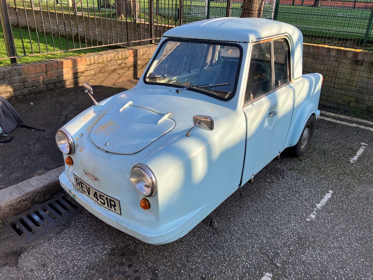

so today, @egg very kindly, just for the cost of his travel, came down to help me with some bigger jobs on REV, aim of the game was look at the CVT system/possiably change the drive belt and in a fashion, fit the head lamp relay kit I have, and then also adjust up the brakes for good measure since its been a few hundred miles now since getting her back, nothing felt particularly wrong per say, but I figured since it has been a few hundred miles of stop-start going, it would be good to give them a twiddle
and this is where things went a bit Autoshite, in that we figured lets start on the brakes first, and that just ate up all of the time so we could not get the other jobs done! the front was easy enough, but the rears where a real ball-ache, just because of how they are permanently coupled to the CVT system, so they are *never* free of drag and trying to get a feel for when  the brake shoes themselves actually dragging or not was quite hard, it was clear when it was locked up sure, but trying to find that sweet spot felt impossible, especially on the offside rear right, in that with the front, you adjust and the wheel locks, you back it off and the wheel is free, you give it a spin and hear the gentle "woosh woosh" as it spins and the shoes lightly brush the drum,, pretty decisive, but trying to do that with the rears, especially the rear right felt much hard, especially with after a few rotations of the wheel or brake application it would change how much resistance it would have
at one point we did get things nice very nice and sharp, (which is where we should of left it!) but she would pull to the left slightly when breaking harshly, so we tried twiddling things adjusting the right brake, but then she was obviously labouring due to drag on the brakes, so we ended up backing things off a bit which  at that point we ran out of time, so the brakes are kinda back to square 1 I think there about as good as before we started messing about, certainly I can lock them up, or at least lock one of the wheels up! (I am not actually sure when I hear skidding, if its the front or the rears or all 3 at the same time), but they are certainly not as good as we had them in the middle of the day, and there is still a pull to the left slightly under hard brakes, so im not sure what thats about exactly
all in all could of certainly gone better, but I very much appreciate @egg's assistance no less :) in-fact I feel bad for wasting his time in what just turned out to be a bunch of pissing about with the brakes, if I had know it would of been this much of a palaver i'd of left them be and done one of the other jobs instead, so we had something to actually show for all the work!
I suppose I should look on the bright-side that REV's not been immobilised LOL
It was all good fun, cheers Dez!

speaking of REV, I am wondering is there a good video anywhere, (or set of pictures) showing exactly how the adjuster on these borrowed-from-a-triumph 7 inch girling brakes work exactly/how things/the shoes are meant to move when you turn the adjuster? for example people talk about "clicks" but none of the adjusters really had clicks they had stiff points which I assume was meant to be a click, which has me wondering are these adjusters analog, so to speak in that, is there is still adjustment, between Clicks, or do they only move the shoes when they go click? they felt pretty "analog" to me, in that you would be turning the adjuster and before there was a click the wheel would go tight, and if you twiddled the adjustment spanner just a smidge backwards the wheel would release, but im not sure if this is "safe" or is the adjuster in some sort of position its not meant to so could ping back either way?
but I realise, having never really done this before I was not sure what I was supposed to be feeling exactly!  the front wheel was pretty decisive between "yeah thats dragging" and "yeah thats just right" but the rears felt a lot more gradual for lack of a better word? you would spin the adjuster and it would maybe bind a bit, but not so definently and you would wind it back and maybe it would feel like it freed off a bit but you where not sure if it was actually free or not
it also felt like the amount of twirling to get the rears to bind up was different from the amount of twirling to get them to then free off again or vice versa, (ie for example using random numbers, it felt like it took 3 turns for them to lock, but only 2 turns for them to free off)
also along similar lines, I was not sure how much drag is acceptable, part of me was wondering should I have the rears dragging a bit so that way I *know* there is no gap between the shoes and the drums and then let them bed themselves in so to speak, but you obviously dont want to do that too much or you will cook the brakes!
I also note that between the 2 rears, each one had a different feel to it, the nearside left wheel felt more "decisive" in its adjustment then the rear right offside wheel, that one felt particularly vague in its adjustment, and was the one was spent the most time messing about with!
i'd like to have another stab at adjusting the brakes and I *might* be able to rope my brother in to help with the heavy lifting, but i'd like to try and get a better idea on WTF im doing/whats going on/a better handle on things, so I dont go through another round of faffing about with no good end result!
as you can tell it rather bothers me that I have not been able to decisively be able to say "yep thats all sorted" especially with something like brakes, not that she is lacking in breaking performance, but especially after all the faffing about I do wonder if it could be better, did we actually manage to set things back to how they where or not, and that Im not sure about, it does somewhat feel like theres a little more travel in the handle bars then before, but I dont know if im just imagining things or now hypersensitive)

Triumph owners club forum?
Do you have any brake spares Dez?
It is difficult to feel what the adjusters are doing especially if they haven't been moved for some time and may be partly seized.
The adjuster is a plain screw thread.  On the business end there is a wedge which moves a pair of plungers apart to expand the shoes.  The wedge looks like a cone but has flats on it every 90 degrees, so each quarter turn there will be a click when the flat aligns with the end of the plunger.  In theory, it is possible to adjust without even jacking up, so you screw in the adjuster until it is tight then back it off usually 3 or 4 clicks and that is about the right clearance.  "Tight" is obviously a bit subjective and in practice it is best to jack it up and feel as you have been doing.
How is the handbrake?  Increase in handbrake free travel will indicate that the shoes are wearing.  I wouldn't have thought you would have done enough miles to need adjustment yet.
  • Agree 1
I think you may have to take a brake drum off to see what's going on. The two sides may be set up slightly differently in any event - maybe best to have a look how they operate.
If they are not leaking and pulling to one side they may be fine in the interim?
Here is the Girling advice for the Austin A30 - it again just talks about 'clicks'. I think if you leave between clicks and it moved one way or the other it would not be adverse just mean the brake performance is slightly different.
But it all just goes to show how 'hit and miss' old engineering is in set up.
I'm basing the above on an A30 and an A35 I once had. My approach was as Girling advise and then road test and if the drum remained cool and brakes effective job was a 'good-un'.
But we are a long long way away from the kind of braking that they thought adequate in the past - thought modern shoe materials have improved things somewhat.
I think it a case of try it and see. But as long as you are not losing brake pressure or fluid should be fine?
When turning the tyres, off the ground, it definitely felt loose-loose-tight for a bit-loose quite unevenly on both rears. At times we had both rears off the ground and I thought LBF had done a good job of balancing them.
We only did the front once - as that was much easier without the transmission drag (although it was also the adjuster that had most resistance to movement)
I think that's the same sort of setup as the Dolly's drums. Adjusted by a square drive on the back of the wheel cylinder through the backing plate?
Mine definitely lacked a firm click when adjusting, it was more like it felt lumpy - for want of a better description!
