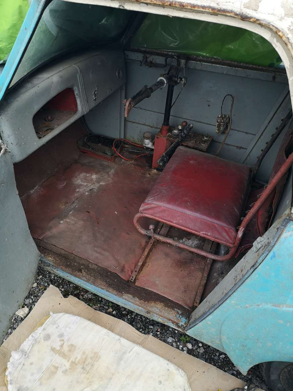

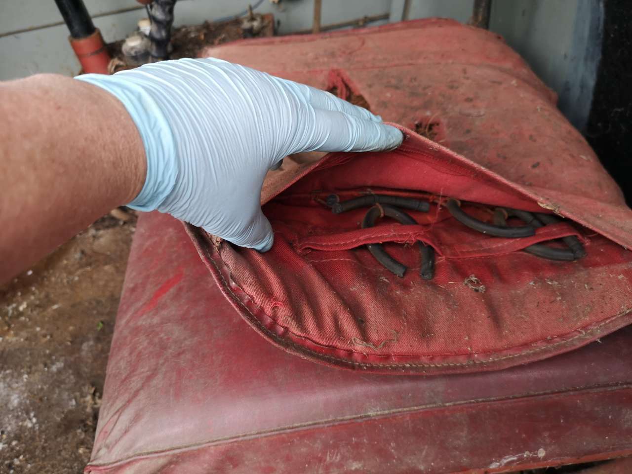

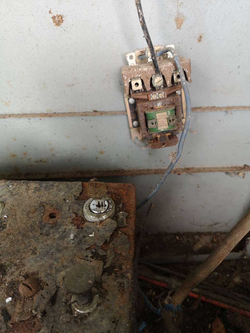

LightBulbFun Posted May 3, 2023 Author Posted May 3, 2023 so a small update on the Harper Mk6, it was given a quick poke and clean out a couple weeks ago an old door matt covered in who knows many years worth of nature was evicted from the interior, revealing a rather interesting original padded vinyl covering, and a battery tray, looks like they really did just plonk the battery in the cabin! I also like this shot, as it shows well what the interior of a Harper Mk6 looks like for machines this old even pictures are far and few between, so I am glad to have a good picture to show it looks like as well as the body being painted at some point itself, so was the interior which is interesting, wonder what the story with all this painting is, looks like the dashboard would of been a paler colour and the backing behind the seat black speaking of the seat, its a 2CV type affair, which has slightly fallen apart, but hopefully can be put back together with new rubber cords a quick look was had a look at the control panel and associated wiring nearby, it seems sadly the wiring has been been got at somewhat, and will need a good sorting out before power is applied, with this what I think is the reversing solenoid looking somewhat haphazardly screwed to the dummy door, and thats another interesting thing about the Harper Mk6, it seems to be of the automatic reversing type control, on something like an Invacar Mk12 or AC Acedes, you physically move a lever to engage forward or reverse, I think which physically moves a couple electrical contacts in the SIBA dynastart box and obviously selects the 2nd set of ignition points for reverse running but on the Harper Mk6 its of the Microcar style where you push the ignition key down and twist to engage reverse/start the engine going the other way, which as said I have seen on a few microcars but I am not sure if any other Villiers Invalid vehicle had this type of reverse?, although saying that a wiring Digram I have for the Invacar Mk12E does specifically state "Manual reverse" so it does sound like it might imply that perhaps a key selected/automatic reverse was maybe a thing/option? as always more research needed LOL all in all quite interesting 500tops, uk_senator, brummiejon and 10 others 13

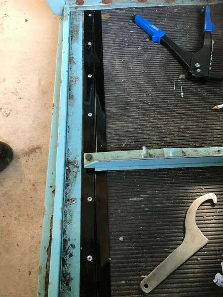

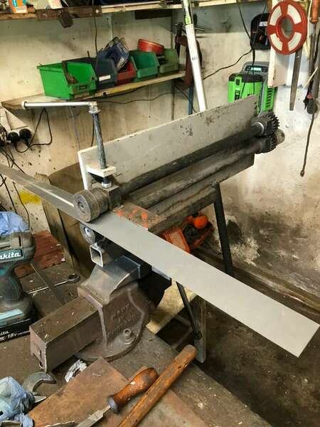

AdgeCutler Posted May 9, 2023 Posted May 9, 2023 With Brian now due to attend Castle Combe steam rally I thought it time to finish a few things off rather that just keep clocking up miles, which have now reached 720 since rebuild. The rubber floor mat edging has been rolled out this morning after borrowing a swager from a friend. LightBulbFun, High Jetter, Snake Charmer and 9 others 12

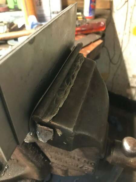

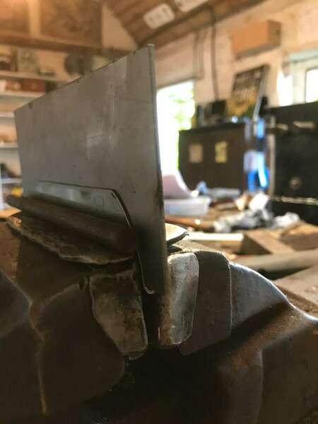

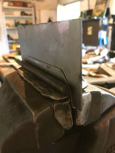

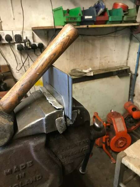

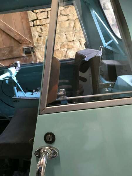

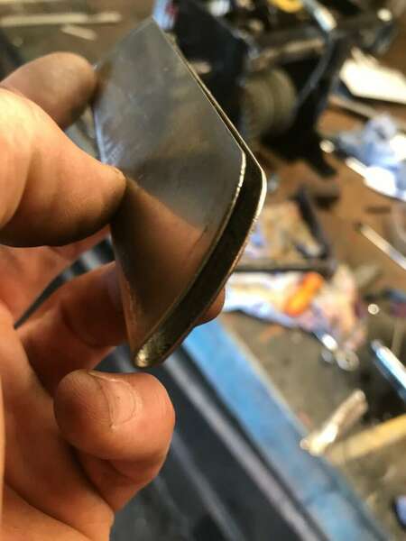

AdgeCutler Posted May 11, 2023 Posted May 11, 2023 I’ve now made a start on the window handles which are fairly important if you wish to open the windows or indeed lock them, the locking rod engages against them. The two remaining originals are well rotten as with all steel work throughout the car. I’m using stainless as the cost of chroming as per original was prohibitive, I hope I can be forgiven for this slight stray from originality? 500tops, egg, Remspoor and 7 others 10

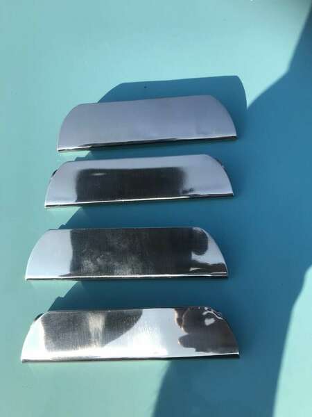

AdgeCutler Posted May 12, 2023 Posted May 12, 2023 Handles now knocked out and trial fitted, a bit of a polish and they might just be passable? Scruffy Bodger, Mrs6C, Remspoor and 9 others 12

High Jetter Posted May 13, 2023 Posted May 13, 2023 16 hours ago, AdgeCutler said: Handles now knocked out and trial fitted, a bit of a polish and they might just be passable? Looking sharp! AdgeCutler 1

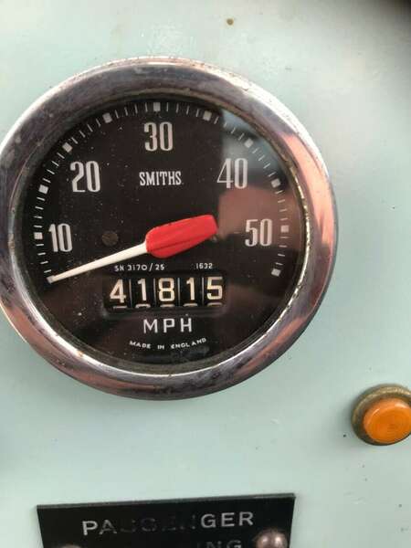

AdgeCutler Posted May 13, 2023 Posted May 13, 2023 Spit and polish! Also, in other news. Today I decided to fully open the throttle on a short stretch of level, straight road. A glance down at the speedo told me Brian had reached the dizzying heights of 51mph, something I won’t be doing often but curiosity forced me to. Dick Cheeseburger, egg, brummiejon and 9 others 12

egg Posted May 18, 2023 Posted May 18, 2023 On 13/05/2023 at 18:13, AdgeCutler said: Brian had reached the dizzying heights of 51mph, Blimey, maybe a new land speed record for a Villiers powered invalid carriage (accuracy of Smiths dials not withstanding), that took some guts! LightBulbFun and AdgeCutler 1 1

AdgeCutler Posted May 19, 2023 Posted May 19, 2023 On 5/18/2023 at 5:14 PM, egg said: Blimey, maybe a new land speed record for a Villiers powered invalid carriage (accuracy of Smiths dials not withstanding), that took some guts! The speedo seems to be accurate, at least it reads the same as the speed check signs locally. I’ve checked it against them on numerous occasions at various speeds and the readings always match. Snake Charmer, egg and LightBulbFun 3

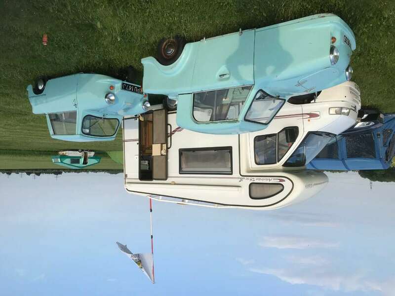

AdgeCutler Posted May 19, 2023 Posted May 19, 2023 All ready now for Castle Combe rally after roading two steamers and two Invacars to the showground. A little more steaming early tomorrow and then, relax! RayMK, Six-cylinder, LightBulbFun and 5 others 8
