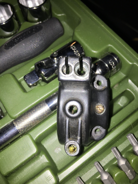

LightBulbFun Posted December 18, 2021 Author Posted December 18, 2021 26 minutes ago, DodgeRover said: What diameter are the handlebars? A pattern motorcycle one from the era will be what they used originally, probably made by Wassel the problem is not so much the handle bars (the diameter on those is your standard 7/8th inch/22Mm) but the problem is throttle cable outer is unusually slim/skinny this is the cable entry point on the current twist grip on the car (the knackered one) notice how there are 2 slotted holes and the one on the left is smaller diameter then the one on the right that smaller left hole is the hole my current throttle cable (the green one) fits into, but all of the twist grips I have seen and all the ones I have tried at the FoD and at home, only have 1 cable entry hole and they have all been of the larger size on the right, so the throttle cable in the car (the green one) just flops around and has nothing to to stop against if that makes sense (hence my idea of using a washer to reduce the hole size/act as a stop)

mitsisigma01 Posted December 19, 2021 Posted December 19, 2021 Have you got a pic or two or video of the twist grip with the green cable insitu ... just how slack is it ... how deep is the recess the cable outer sits in 🤔🤔🤔 Congratulations on achieving the chip shop 🏁🏆🏁 LightBulbFun 1

bobdisk Posted December 19, 2021 Posted December 19, 2021 11 hours ago, DodgeRover said: I don't know if you spotted it but there was a strand sticking out on the end of the throttle cable you posted a close up of, that really really won't be helping matters and you should replace it as soon a possible. It is entirely possible to fit a new inner cable to the existing outer one if you want to keep the look. @DodgeRoverYeah, I did notice that, but it is not interfering with the twist movement, it is in the slot on the twist rotating handle. I did accidentally pull the inner out of the cable while we were in the cab, but after cutting a fresh end off the carb end it fed easily back into it from the handle, so that proved the cable is good. @LightBulbFunI suggest if you want to replace the twist grip, get the same one that @Zelandethhas. See this page on Retro Rides: (I think Zel did a post here, but cant find it!) https://forum.retro-rides.org/thread/207975/model-invacar-visitors-occasional-distractions?page=42
DodgeRover Posted December 19, 2021 Posted December 19, 2021 Twist grip looks like the smaller hole is a standard motorcycle side. Does the barrel of the grip have 2 grooves in for different thicknesses of cables?

bobdisk Posted December 19, 2021 Posted December 19, 2021 2 hours ago, DodgeRover said: Twist grip looks like the smaller hole is a standard motorcycle side. Does the barrel of the grip have 2 grooves in for different thicknesses of cables? Yes, we used the smaller of the two.

mitsisigma01 Posted December 19, 2021 Posted December 19, 2021 Once the outer is in the recess on the twist grip and adjusted up on the manifold end correctly the cable outer shouldn't be going anywhere , if it does come out of the recess there is too much slack in it still .. bobdisk and LightBulbFun 2

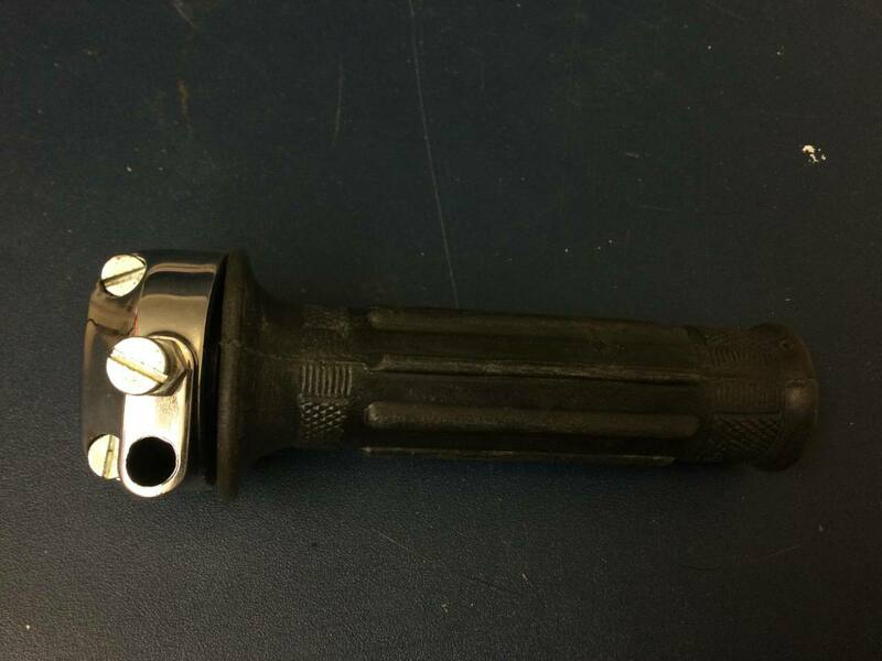

DodgeRover Posted December 19, 2021 Posted December 19, 2021 3 hours ago, bobdisk said: Yes, we used the smaller of the two. It's almost like it is set up for a second cable to operate something else, I thought at first it was a positive close (push/ pull) set up but it's in the wrong place. TBH can you encourage LBF to bin the shit that is on it (which sounds like an accident waiting to happen) and fit something like this: https://www.ebay.co.uk/itm/Old-Wassell-7-8-Motorcycle-Throttle-Twist-Grip-/174878707121? It's from the correct period. New grips cost about £5 for a pair, fit them using strong hairspray or super glue so they don't rotate or pull off.

LightBulbFun Posted December 19, 2021 Author Posted December 19, 2021 6 hours ago, DodgeRover said: Twist grip looks like the smaller hole is a standard motorcycle side. 31 minutes ago, DodgeRover said: It's almost like it is set up for a second cable to operate something else, I thought at first it was a positive close (push/ pull) set up but it's in the wrong place. the curious thing is all Model 70's I have seen use that larger hole, REVs original black throttle cable setup before it failed used the larger hole for example and so does the blue one I got in recently and all the twist grips I have tried their throttle cable outer entry hole is of that larger diameter so im a little bit confused if you say the smaller diameter is standard? unless all the other twist grips I have been trying have been missing a component? 31 minutes ago, DodgeRover said: TBH can you encourage LBF to bin the shit that is on it (which sounds like an accident waiting to happen) and fit something like this: https://www.ebay.co.uk/itm/Old-Wassell-7-8-Motorcycle-Throttle-Twist-Grip-/174878707121? It's from the correct period. New grips cost about £5 for a pair, fit them using strong hairspray or super glue so they don't rotate or pull off. trust me I dont need any encouraging! I have been wanting to replace the twist grip since I got REV over 2 years ago now! I have jut not found anything that will fit the existing cable setup (in some regards its a massive stroke of luck that REV's existing knackered twist grip so happened to have this mysterious smaller cable entry point!)
DodgeRover Posted December 19, 2021 Posted December 19, 2021 You are missing an adjuster probably something like this: https://www.ebay.co.uk/itm/Amal-Twin-Jet-Throttle-Cable-Adjuster-British-Seagull-/272274991400? LightBulbFun 1

bobdisk Posted December 19, 2021 Posted December 19, 2021 39 minutes ago, DodgeRover said: You are missing an adjuster probably something like this: https://www.ebay.co.uk/itm/Amal-Twin-Jet-Throttle-Cable-Adjuster-British-Seagull-/272274991400? The carb end has something like it. Look at the pic showing where the outer was loose
DodgeRover Posted December 19, 2021 Posted December 19, 2021 If it's like a bike then there would be one on each end, the throttle end allows easy adjustment on the fly mitsisigma01 1
mitsisigma01 Posted December 19, 2021 Posted December 19, 2021 If it has a deep recess (10mm ish) on the twist grip end you can probably get away with an adjuster like that with a tightish fitting nut that can be adjusted on the fly by hand without the need for spanners ...but ideally if the slack is taken up properly you probably wouldn't need one ....

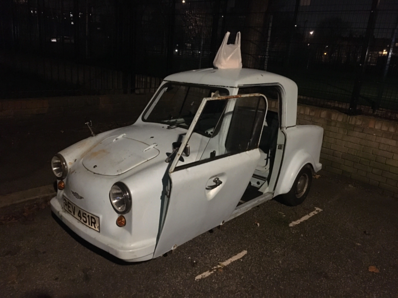

LightBulbFun Posted December 22, 2021 Author Posted December 22, 2021 did another chippy run in REV just now this time at night! which was an interesting experience! (one of my brothers was visiting so I figured id show him id got REV working and use it as an excuse to do another chippy run LOL) annoyingly I forgot to take some pictures at the actual chippy but did remember to take one after I parked up! I do think her rear brakes are binding somewhat, as I noticed she is quite sluggish to get going, and does not coast at all, and finally when checking the wheels I did notice the rears where warm, the front was fine however sounds like the rear shoes are not quite returning home for whatever reason, all the handbrake cables where replaced with new ones, however all the brake hardware itself, the shoes, pipes/lines, and cylinders are all still what was fitted to REV when I got her (adam got the brakes working, but aside from the handbrake cables, nothing else was physically changed) so I do wonder if something is playing up there maybe things just need a bit of use, I did notice towards the end of the run she was feeling a bit better, but at the same time, I obviously dont want to cook my brakes and find myself going into the back of someone! will be interesting to see how things are next time out (although I do admit I would really like to replace all the brake hardware still just for peace of mind! single circuit brakes and all that) jon.k, bobdisk, CaptainBoom and 12 others 15

High Jetter Posted December 22, 2021 Posted December 22, 2021 Brakes might just be down to lack of use, but it would be worth a look with drums off to be on the safe side - I know that's not as easily done as said, though. LightBulbFun 1
