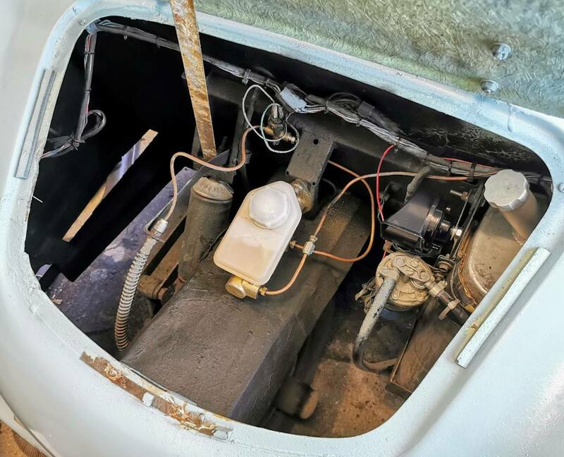

red5 Posted November 20, 2021 Posted November 20, 2021 Got a picture/s of its routing? LightBulbFun 1
Zelandeth Posted November 21, 2021 Posted November 21, 2021 Make sure the spring that runs from the air cleaner to the throttle arm is present... that's critical and the throttle will absolutely not return without it. Scared myself half to death and nearly deafened myself with that one more than once. The most finnicky bit I found regarding the cable routing was trying to make sure the cable wasn't kinked where it passes over the heater crossover hose between the left and right sides of the fan shroud. I think it was originally routed under it and tended to stick a bit. Don't seem to have a photo of that handy...but here's one showing where my fuel pump is as that's kind of relevant to what you've been up to. Helpfully the pump in my case was almost exactly the same diameter as a Lada ignition coil...and I just happened to have the bracket left over from that from when I did the injection conversion on my Riva (which used a coil pack so didn't use the original coil). So I bolted that bracket onto the top fuel tank strap. LightBulbFun 1
LightBulbFun Posted November 21, 2021 Author Posted November 21, 2021 1 hour ago, Zelandeth said: Make sure the spring that runs from the air cleaner to the throttle arm is present... that's critical and the throttle will absolutely not return without it. Scared myself half to death and nearly deafened myself with that one more than once. The most finnicky bit I found regarding the cable routing was trying to make sure the cable wasn't kinked where it passes over the heater crossover hose between the left and right sides of the fan shroud. I think it was originally routed under it and tended to stick a bit. yeah I made sure to re attach the spring when I was reinstalling the air cleaner assembly and its present in the video I took so its not gone ping into space or such thankfully! I did notice on the throttle cable run that as it ran under the heater crossover hose that its put under a bit of tension by it, which I cant imagine is helping matters, ill add re-routing it to run over the pipe to the list of things to hopefully try tomorrow the other thing I noticed with regards to throttle cables is on most other Model 70's I noticed the throttle cable comes into the cabin goes straight up then turns 90 degrees more or less then in another straight line runs along the bottom of the dashboard into the twist grip, but on REV it seems to be all droopy and not very defined at all if that makes sense, so it would be interesting to have some shots of how TPA's throttle cable is run from the bulkhead and under the dashboard to twist grip I also seem to recall that with regards to your throttle cable that the inner cable preferred being fed into the outer from one specific direction, I do wonder if something similar is going on here (although the Inner cable on REV, being a pre-made Model 70 part, has a premaritally attached thingy on the end for the twist grip so it can only be fed into the outer cable from the cabin/twist grip end, whether thats the way the outer wants it is another matter) I also know the previous owner of REV mentioned the throttle cable outers had some sort inner lining you could pull out of them, meant they munched through inner cables more often but made them much smoother to operate apparently? not 100% sure on the details there however 1 hour ago, Zelandeth said: Don't seem to have a photo of that handy...but here's one showing where my fuel pump is as that's kind of relevant to what you've been up to. Helpfully the pump in my case was almost exactly the same diameter as a Lada ignition coil...and I just happened to have the bracket left over from that from when I did the injection conversion on my Riva (which used a coil pack so didn't use the original coil). So I bolted that bracket onto the top fuel tank strap. yeah your setup looks much more substantial (and neater) then mine!
Zelandeth Posted November 21, 2021 Posted November 21, 2021 Don't think which way the cable is fed in will affect operation, I just found it easier to thread through from the cabin end, it tended to snag if going in from the engine end. Not the clearest photo but this sort of shows the routing in the cabin. If I manage to unearth her in the garage tomorrow I'll try to get a clear (and current) photo. LightBulbFun 1

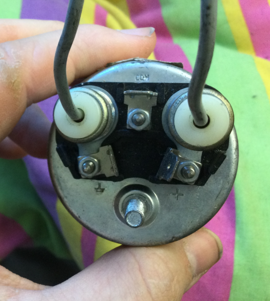

LightBulbFun Posted November 22, 2021 Author Posted November 22, 2021 for those curious heres the back of the gauge the Ground and positive terminals are pretty self explanatory, but then theres the mystery common terminal, which im Guessing is where the fuel sender unit's variable resistor hooks up to but then on the sender uni there are 3 wires coming from it, a black wire a red wire and a yellow wire now I presume the black wire will be ground, but the question is which of the coloured wires does what, one will be for the actual variable resistor in the sender unit that goes back to the gauge, and the other will be the switch that pulls the low fuel warning light to ground to turn it on when the Go Go Juice runs low the question is which is which (and being Italian I would not be surprised if my presumption of black being ground is actually wrong LOL) theres also the fun that @Zelandeth's Model 70 being an earlier one does not have any sort of voltage stabiliser for the gauges where as REV being a later Model 70 does have one and im not sure how that plays into things with regards to the veglia gauge and sender set and I still need to figure out exactly how to remove the old gauge from the dash and mount this one!

Mrs6C Posted November 22, 2021 Posted November 22, 2021 6 hours ago, LightBulbFun said: I still need to figure out exactly how to remove the old gauge from the dash and mount this one! You should be able to lie on the floor, stick your head up under the dash and take photos of the underside and back of the instruments, to see what is going on back there as regards fixings. Sometimes gauges are held in place by brackets like this, held on by knurled nuts. You undo them, draw them off and then push the gauge out of the dashboard from behind. It may require a bit of a twist and wiggle to get it going. Once it is free and you have drawn it forwards, you can disconnect it from the wiring harness. LightBulbFun 1
LightBulbFun Posted November 22, 2021 Author Posted November 22, 2021 17 minutes ago, Mrs6C said: You should be able to lie on the floor, stick your head up under the dash and take photos of the underside and back of the instruments, to see what is going on back there as regards fixings. Sometimes gauges are held in place by brackets like this, held on by knurled nuts. You undo them, draw them off and then push the gauge out of the dashboard from behind. It may require a bit of a twist and wiggle to get it going. Once it is free and you have drawn it forwards, you can disconnect it from the wiring harness. ah thats good to know! I had a feeling the stud on the back had something to do with mounting it I just hope it matches up with the existing mounting hardware for the smiths gauge! 17 minutes ago, Mrs6C said: and ooh thats interesting! good to know what the voltage stabiliser looks like! going by its size it must be up in the dash somewhere as I have not been able to spot any extra electrical components otherwise throughout the car just doing a bit of quick googling, they are quite simple devices, http://www.britishv8.org/Articles/Voltage-Regulator.htm (I remember finding out a while back why old British cars had them/why they where needed, but I never actually looked into what they looked like/where comprised of until now!) should be easy to bypass if needed EmperorPigeon 1
bobdisk Posted November 22, 2021 Posted November 22, 2021 I checked the butterfly at the carburettor, with the cable disconnected, and it easily opened and closed (with the spring fixed to the air filter, as @Zelandeth pictured) when I moved it with my finger. For the throttle cable, it seems to be free but tight along its length because I disconnected the twist grip and pulled the inner cable and @LightBulbFun saw that the throttle butterfly open and close. The twist grip is free to rotate when off the handle bar. But I did notice it was fixed too far up the handlebar, by the bend which it rubbed against, so I moved it more towards the end, and it is now free to rotate. With it fixed to the handle bar, and the cable hanging loose, the throttle appears to work, but it is stiff, and the return is sluggish. If it is held up, like Zel’s pic, it does not return properly and the throttle remains open. As @Mrs6C says, fix it at close intervals, but I would like to see the path it should take from one end to the other, perhaps pictures of the route on TPA from Zel and TWC from @dollywobbler would help. I think once we find a path without any tight bends that might be the answer. For the fuel gauge, I have found several Veglia Borlettis and connection diagrams, but none exactly like this. At the sender, one is for a switch to earth for the low fuel light, so the light connected to the + terminal goes there. The other two are the level resistor, but not sure of which is what colour, or how the connections go. Further investigation to come. Not sure if REV has a voltage stabiliser like that, it would be mounted on the back of the speedo, but I cant see one in Claire s pic. LightBulbFun 1
LightBulbFun Posted November 22, 2021 Author Posted November 22, 2021 1 hour ago, bobdisk said: Not sure if REV has a voltage stabiliser like that, it would be mounted on the back of the speedo, but I cant see one in Claire s pic. I think the picture @Mrs6C used i think is just a generic picture to show how dash gauges are mounted normally (I mean Im not aware of any Model 70's with a red dashboard!) from what I can tell REV will have one somewhere as she is a later Model 70 and from March 1976 onwards they gained a stabiliser Model 70's from Production start, to March 1976 had gauges like so, note the chrome surround and small speedo then in March 1976 the Model 70 got a bit of an internal face lift, among a host of other changes (like a rollover bar and a headlining) they changed to different gauges with black surrounds and a much larger speedo, so the fuel gauge was also changed (still a smiths just a different type) and this is when the fuel stabiliser was also made a part of things
Mrs6C Posted November 22, 2021 Posted November 22, 2021 2 minutes ago, LightBulbFun said: i think is just a generic picture to show how dash gauges are mounted normally That's correct. The photo was of a Triumph Spitfire speedometer and the drawing was a set of Spitfire gauges from the Rimmer Bros online catalogue. They were to illustrate how round gauges like these were often fitted. LightBulbFun 1
bobdisk Posted November 23, 2021 Posted November 23, 2021 @Mrs6C, Ahhh!! I see !! If you look at REVs picture, you can see the green throttle cable hanging low, that is the position it almost wants to work. Fix it higher, and the problems come. @LightBulbFunForgot to mention REVs charge light problem: There is a large relay somewhere to operate the starter side of the Dynastart. You can hear it click when you operate the starter with the key. It could be the contacts in that. I did notice a voltage regulator in REV positioned on the chassis near the rear offside light. That is the most likely place for the fault. There will be a type number on the top. It looks like the Bosch one on the Daf. The Daf has a conventional starter and dynamo, so they are probably different types, but in the same box. Those are places to look for REVs charging problems. I will have to look at the circuit to see how it works, probably similar to the NSU, which also had a Dynastart. LightBulbFun 1

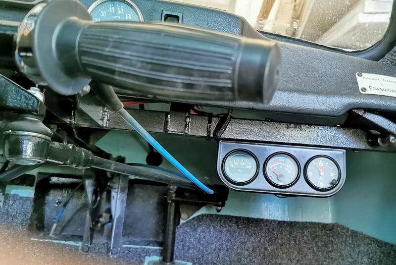

Zelandeth Posted November 23, 2021 Posted November 23, 2021 Just went and grabbed a couple of updated photos to confirm the interior routing of the cable on TPA The cable used to run through the circular cutout in the brake actuator yoke, but that caused the cable to be pulled too taught at times, particularly when reversing into parking spaces. Did try snapping a couple of photos under the car but you could see everything in them *except* the throttle cable, I'll need to try another time from the other side I guess. Mrs6C, LightBulbFun and bobdisk 3
bobdisk Posted November 23, 2021 Posted November 23, 2021 @Zelandeththanks for pics! @LightBulbFun, REVs indicator switch is on the right, so to get the cables straight path as TPA, it will have to be moved over to the left side. If you remember, the lever got in the way of the cable. I think REVs cable goes through a hole in the vertical panel(does it?) so it should be moved to where TPA has it. Both of those changes should make a favourable difference by making a looser bend. Next is to look at the path underneath the car. LightBulbFun 1
