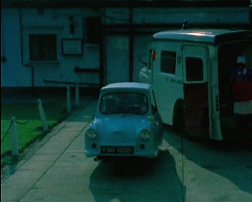

I was watching an episode of a series called "The Protectors" on our PVR last night and spotted this:
Potatocam photo of paused TV so not great but you can see that it is an Invacar Mk12, registration FNO 100H.
From the copyright info this episode, entitled "Think Back", was first shown in 1971 and was broadcast again on Talking Pictures TV (Freeview channel 81) at 06:00 on 15/09/2021.
@LightBulbFun don't know if this is one known to you but thought it might be of interest.
Ah thank you for the heads up :) I have known of this one for a good few years now as its on the IMCDB https://www.imcdb.org/vehicle_38695-Invacar-Mk12-1968.html
but I appreciate the heads up :)
BTW while it is indeed an FNO-H car, I had doubted it was FNO100H as as Invacars went up/where registered in blocks of 100 and generally started from x01, for example the FNO-H block is FNO101H to FNO200H :) there are exceptions to this rule, but generally its quite rare, and indeed looking it up FNO100H is on a Honda moped of some kind (sadly no Invacars from the FNO-H block survived into DVLA lookup range)
the picture is not very clear but looking at it and your picture id say it was FNO180H :)

BTW while it is indeed an FNO-H car, I had doubted it was FNO100H as as Invacars went up in blocks of 100 and generally started from x01, for example the FNO-H block is FNO101H to FNO200H :) there are exceptions to this rule, but generally its quite rare, and indeed looking it up FNO100H is on a Honda moped of some kind (sadly no Invacars from the FNO-H block survived into DVLA lookup range)

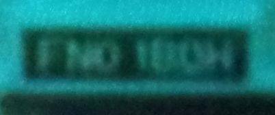

I took a very close up picture of the number plate as well but didn't bother to upload it before as it is very fuzzy. But here it is:
Not particularly clear but after a closer look it could indeed be FNO 180H.
Originally posted picture cropped to just show number plate:
Not much clearer. But from your in-depth knowledge of all things Invacar, especially the registration blocks, I am sure you must be correct.

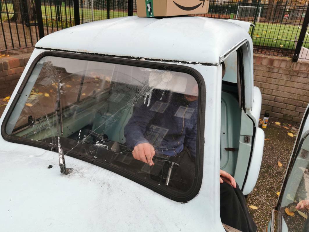

today was a good day! with many thanks to @Mrs6C and @Six-cylinder who very kindly volunteered their time today and braved central London to help me with REV :)
turns out she wont start as her fuel pump is knackered and wont draw any fuel through no matter what we tried, but she happily runs on ether/starter fluid so Ill take that as a good sign!
current plan is to fit a simple electric fuel pump and bypass the mechanical pump entirely, to that end @Zelandeth if have any tips or tidbits I should know or have links to the setup you use that would be most helpful! although I do understand you got gifted the setup so probably cant link to it on eBay or what have you!, but if you have any pictures showing how exactly you set it up or any pitfalls I should be aware of that would be good to see/know :)
not that I for-see it being hard to install one at all its just disconnect 2 fuel pipes reconnect them to the electric fuel pump, secure the pump somewhere in the engine bay and find an ignition switched Live!
we also managed to sort out the issue of the door falling off :)
old knackered and incorrectly installed bobbins (which we where pretty sure where made of wood! very much looked/broke apart like it!)
and new bobbins installed correctly :) (although the split pins where past it, so they are only held in with wire passed through the holes but it should be good enough until some properly sized split pins can be found)
all in all a pretty good day! im glad to know why REV would not run and that she does with assistance and I am very thankful once more to @Six-cylinder and @Mrs6C for the visit and help!
I really could not have done it without them :)

Turned out it was an air leak on the fuel line from the tank so there was nothing wrong with the old one. I’ll have a look next week…if I can find it, I’ll happily stick it in the post to you 👍
I made a trip to London and could not find the London eye so settled for Invacar hunting!
The fuel pump made its failures know as there was a fuel filter with no petrol in it so that's where we started. Mrs6C sucked and blew down the pipe and then we started the engine on Easy start  and held the revs up but still no pumping action. Remounting the door was good. Small jobs such as changing the windscreen wiper and testing the washers work along with fitting hub caps were also achieved.
