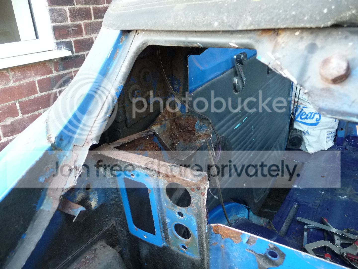

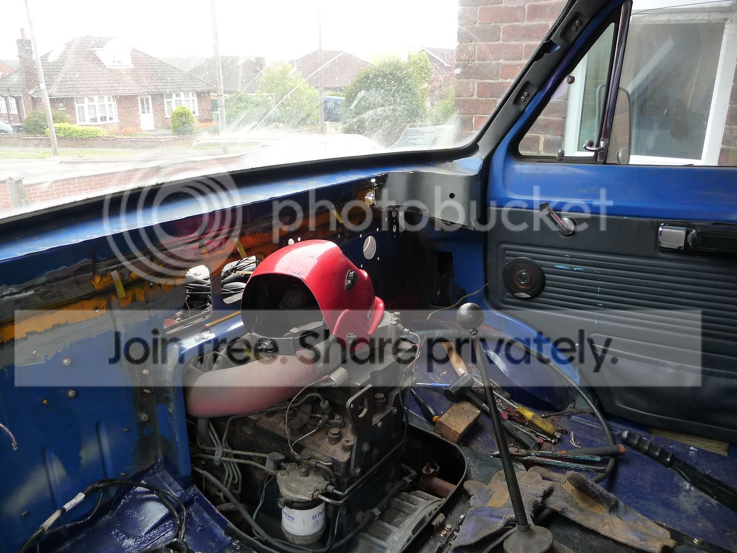

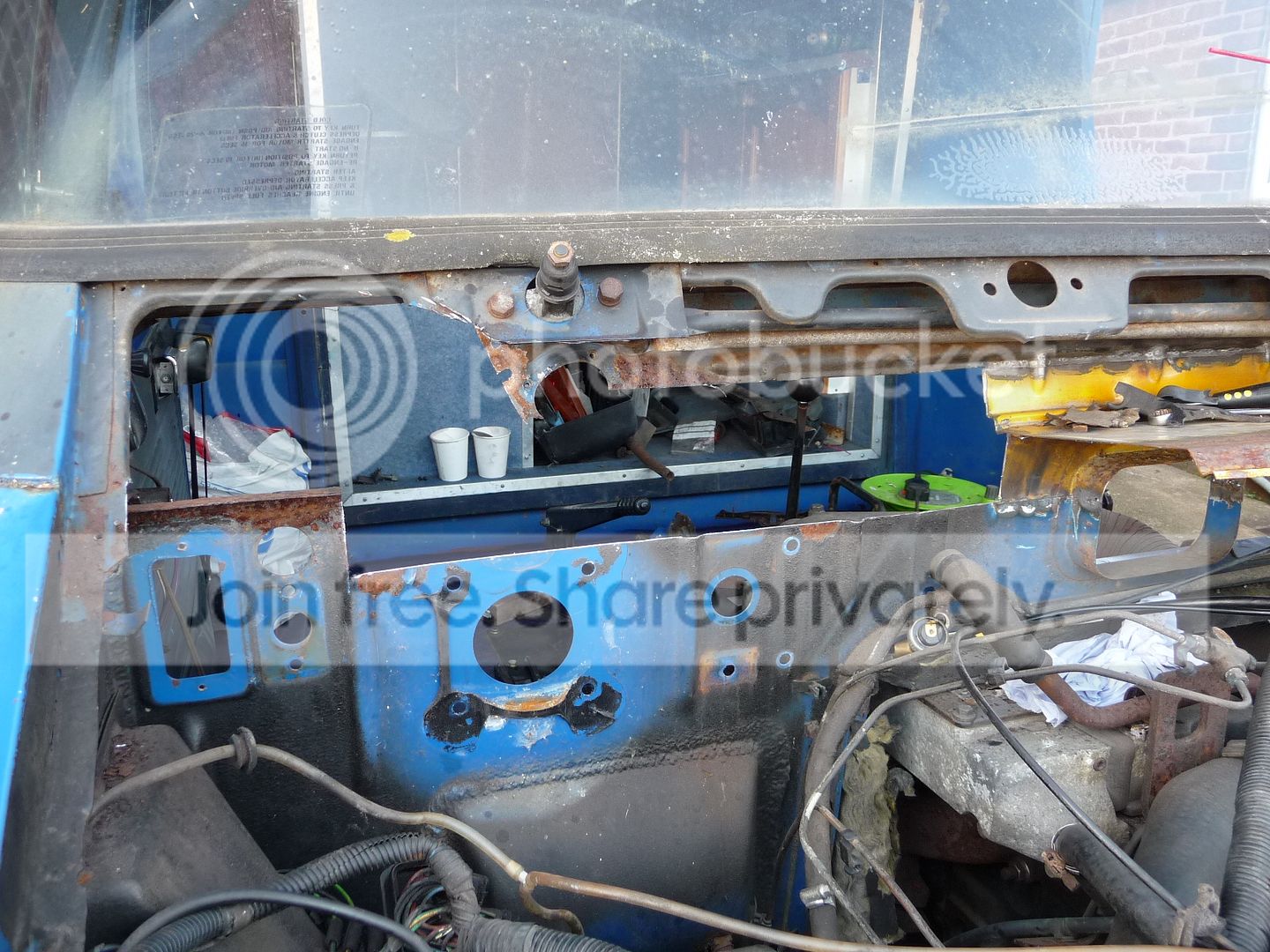

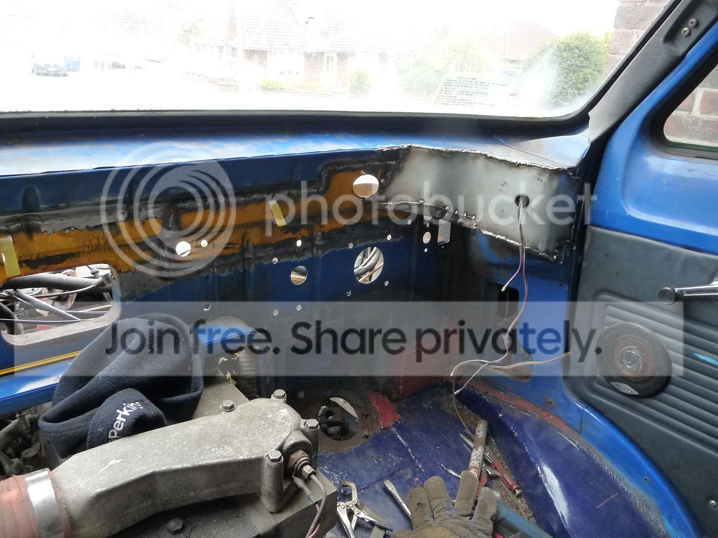

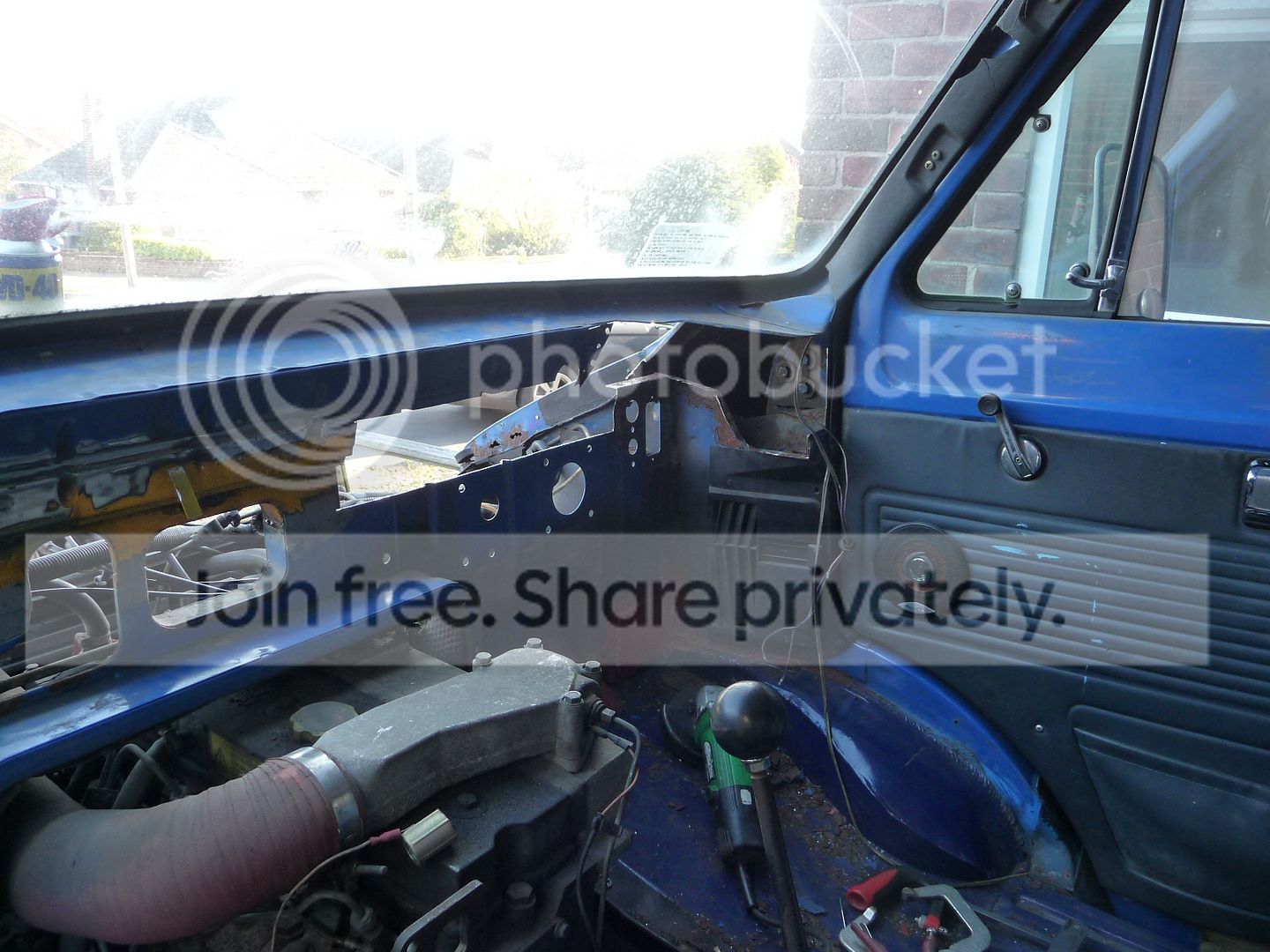

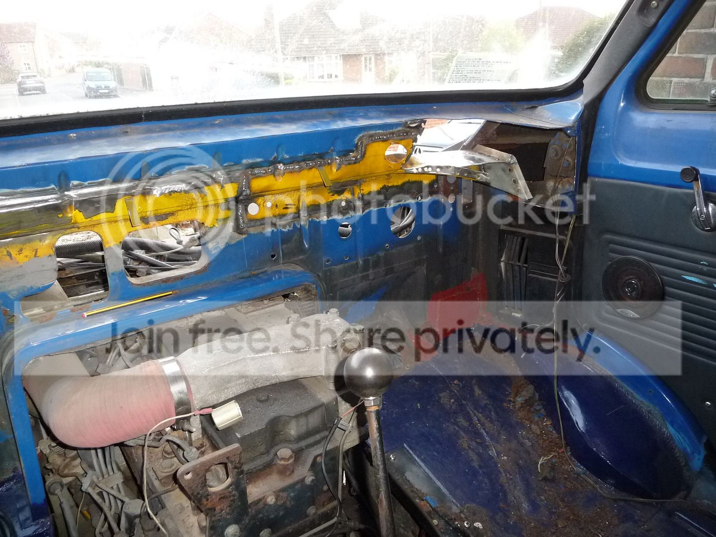

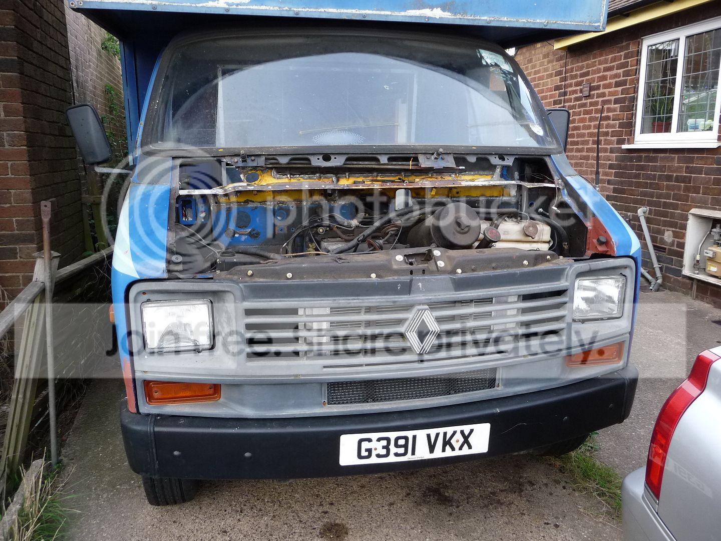

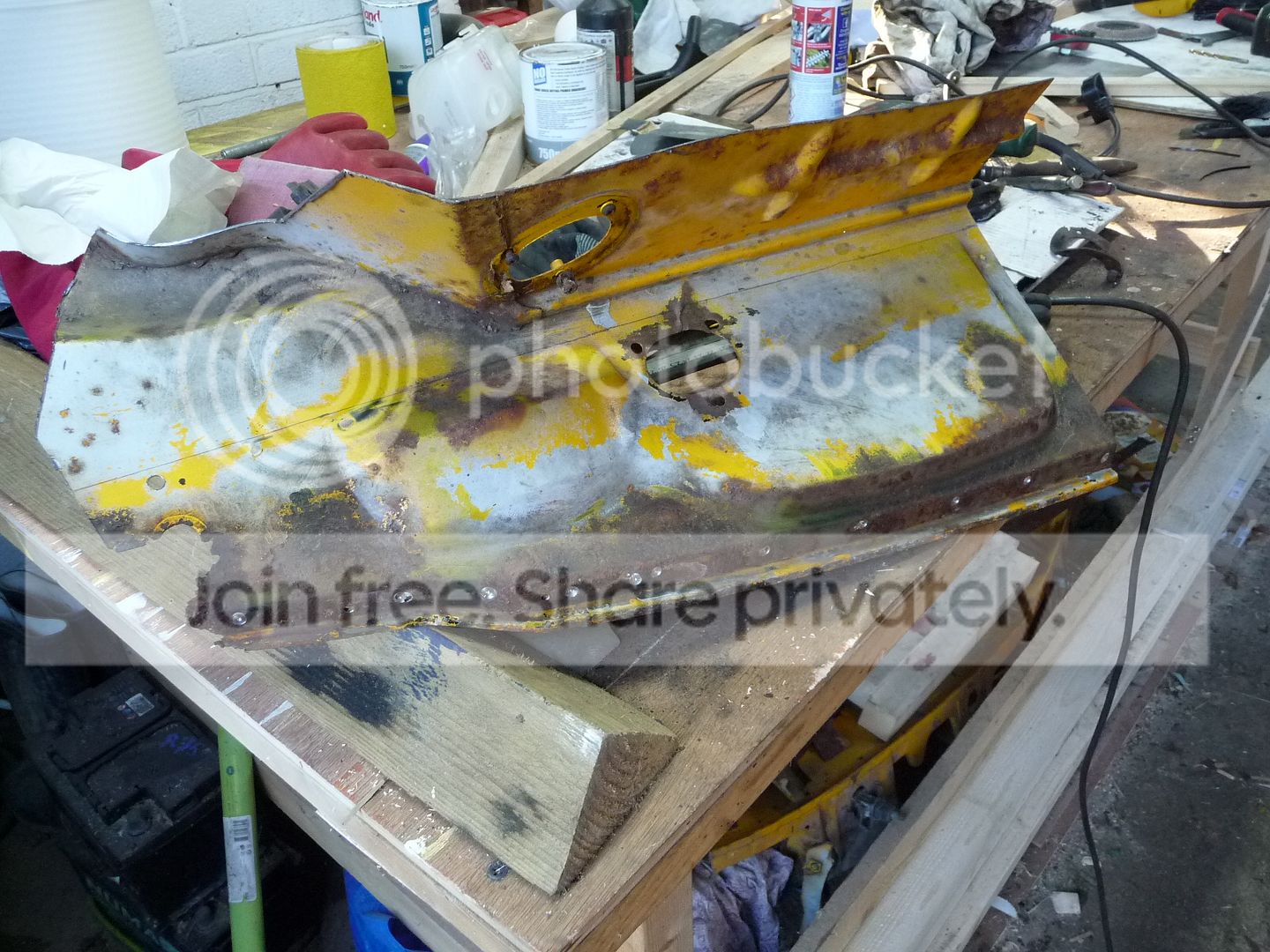

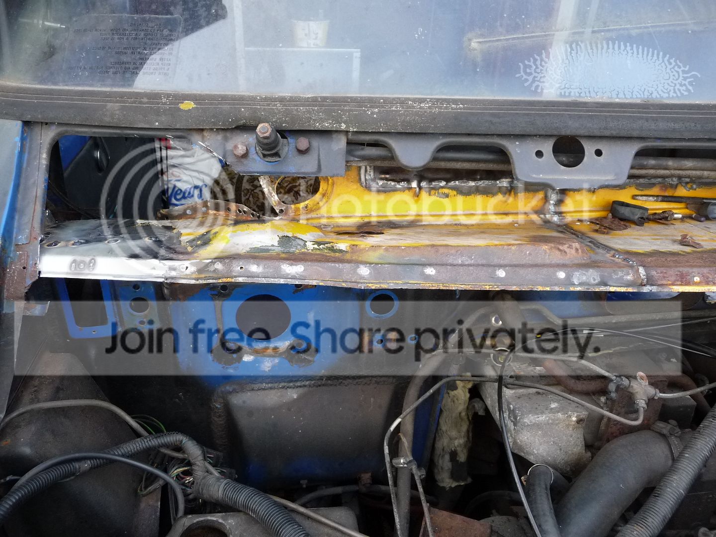

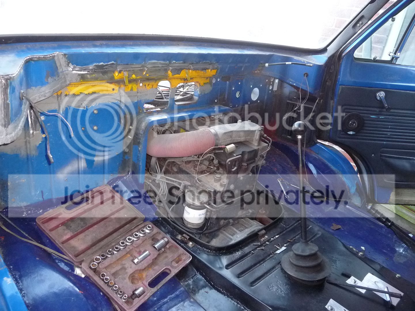

Managed to get maybe an hour and a half in on this today. No more welding to be done on the passenger side so time to start stripping out the drivers side.

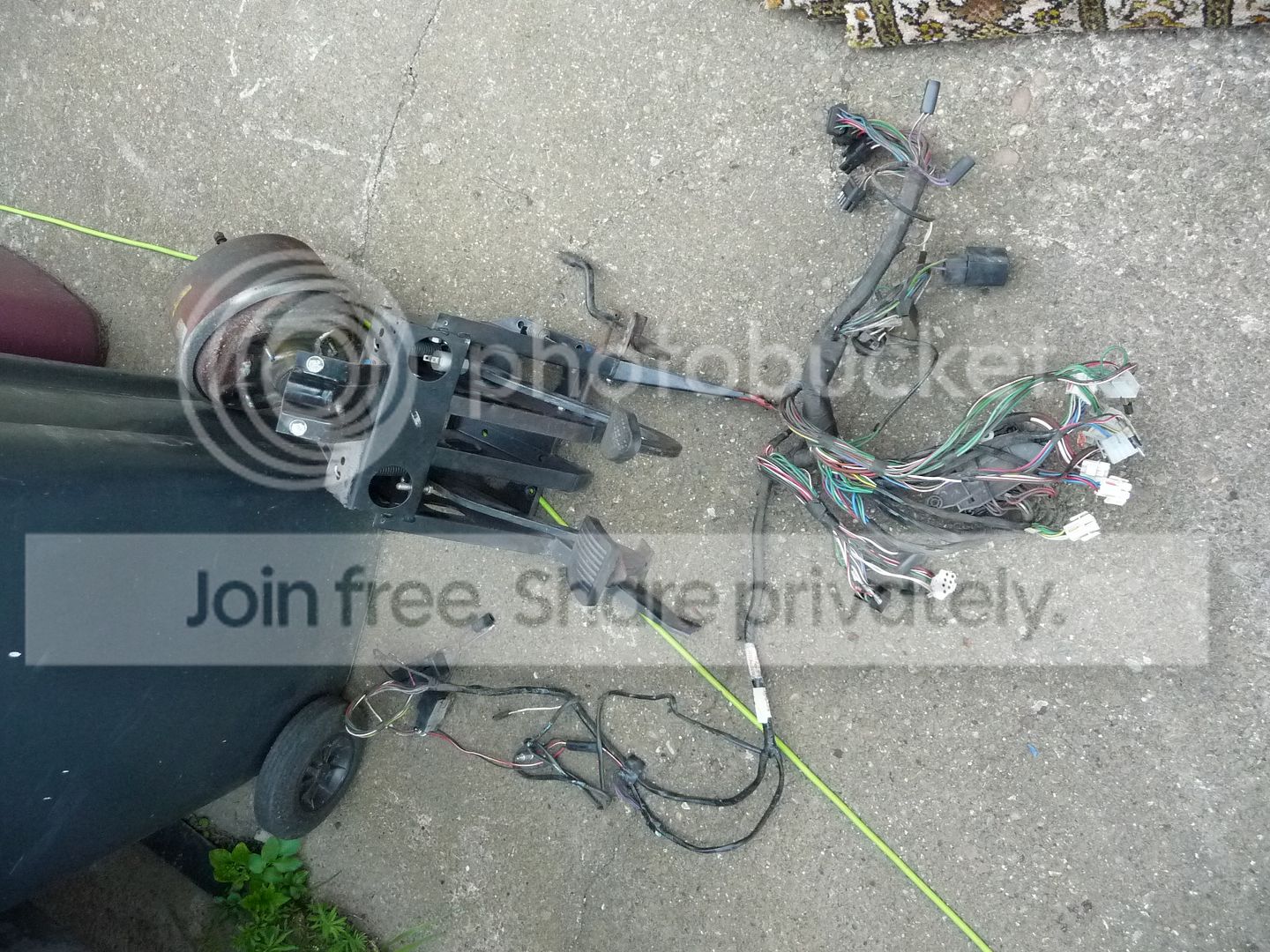

That didnt take long. Here's some of the bits I removed - pedal box, brake servo, wiring loom.... The loom has 4 big plugs at the bulkhead, you can unplug these and remove the interior wiring harness complete.

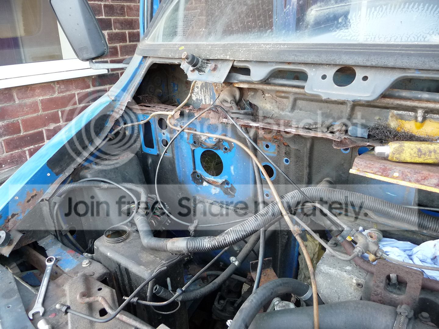

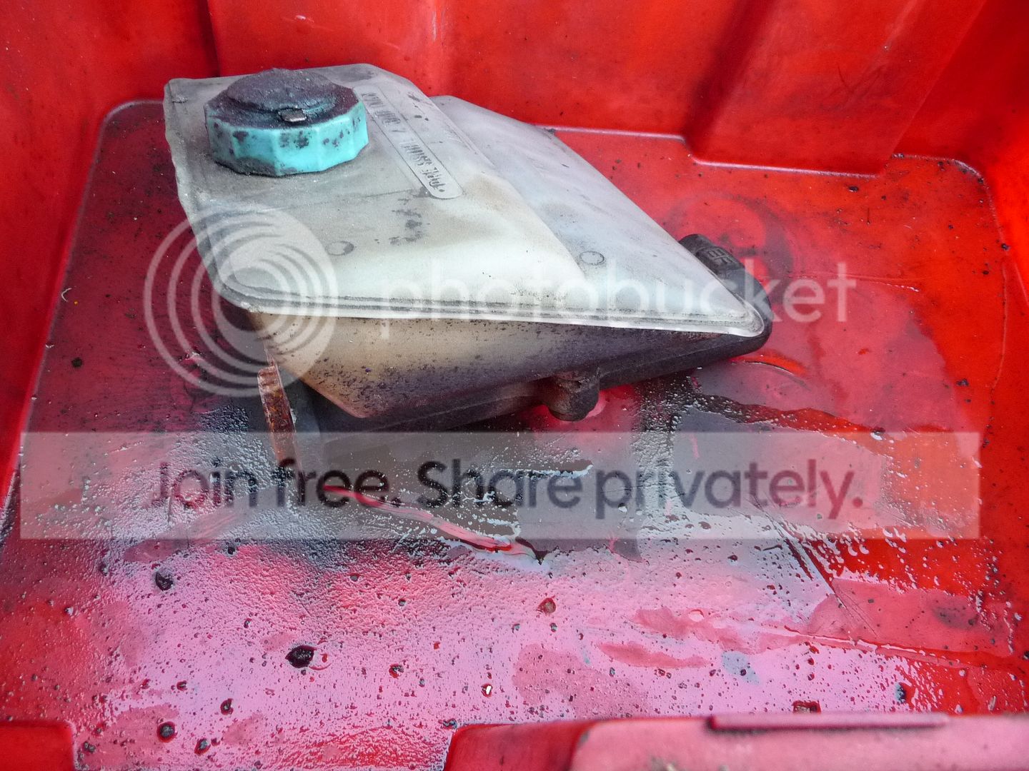

Heres the brake master cylinder, I didnt want to disturb this, I find old hydraulic systems often start playing up when you try and bleed them thorough after a 'major disturbance' like this. The seal kits are expensive and if you need a rebuild (no new ones exist) its a £170 touch at past parts. I will clean this up a bit but I hope I don't end up needing to open it up!!

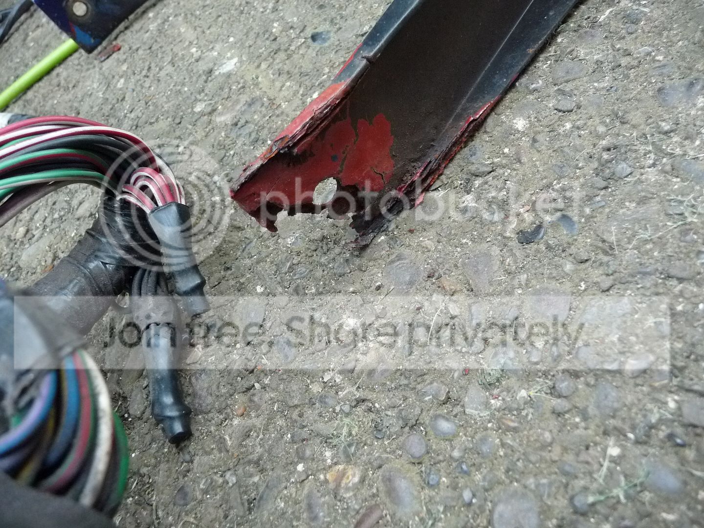

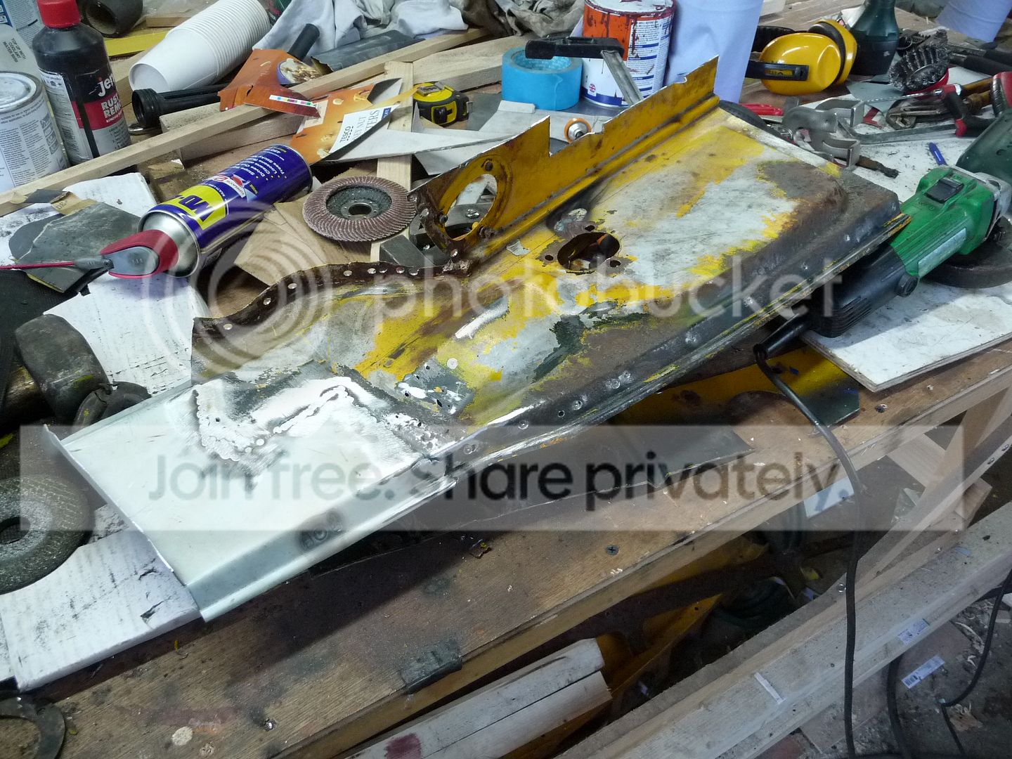

Even the flippin pedal box needs some welding

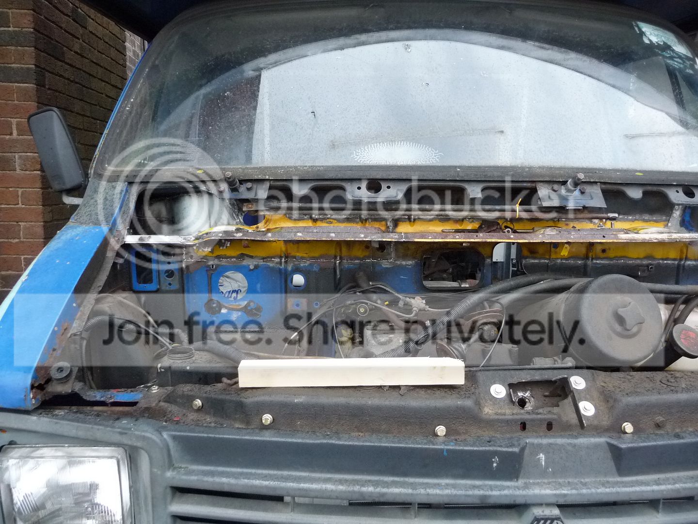

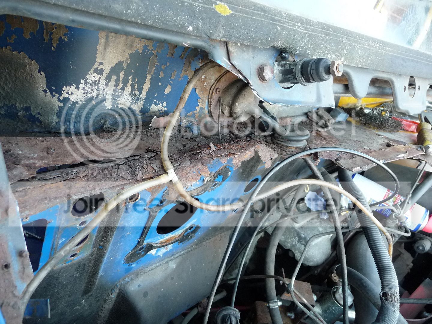

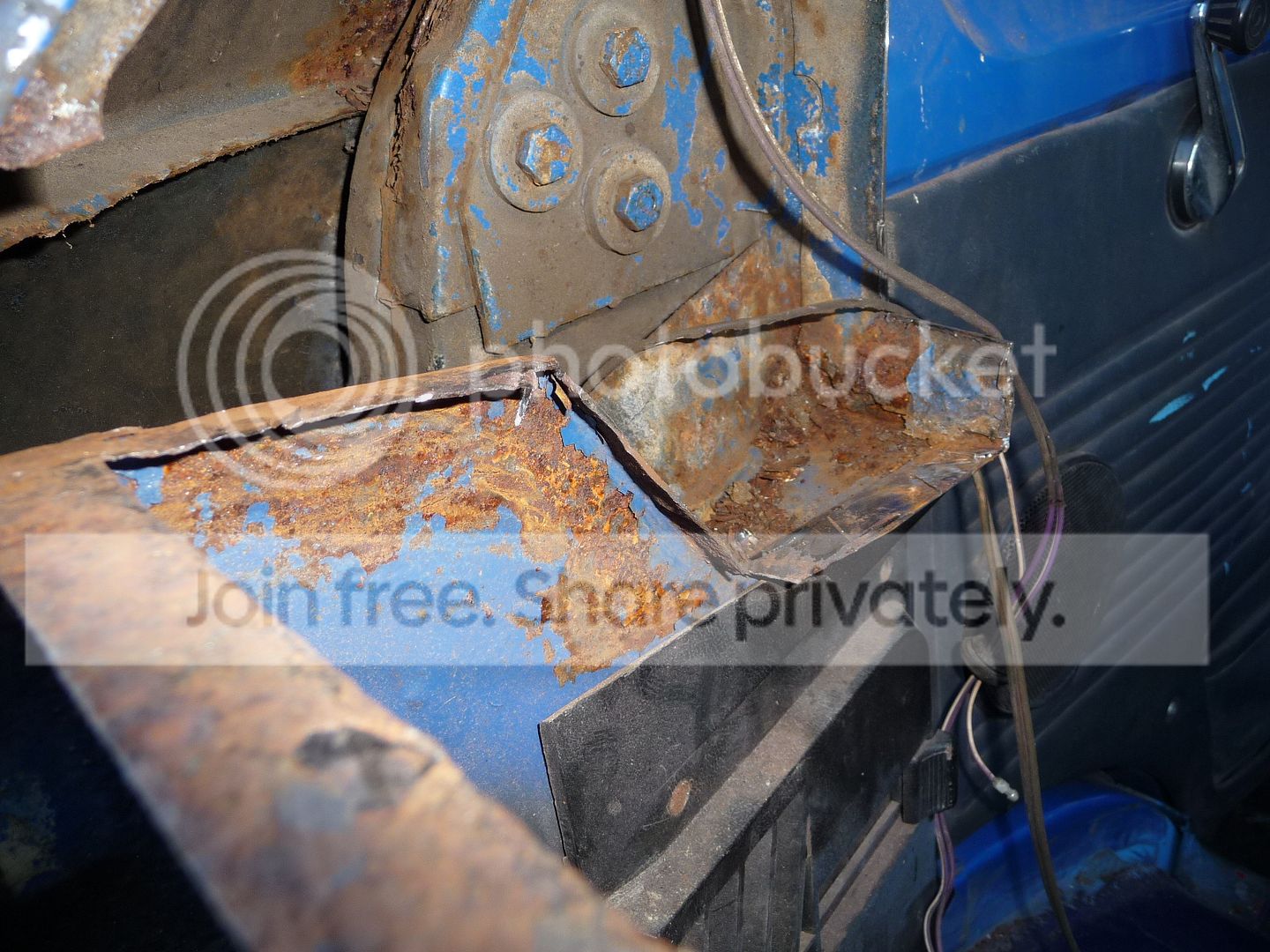

Anyway with that lot out I could have a proper look at the crustacea:
Hmm, looks pretty chronic but I don't think its any worse than the passenger side really. Basically just got to repeat what I've already done on the pass side. Must remember not to blast the neighbour's window with angle grinder sparks BTW

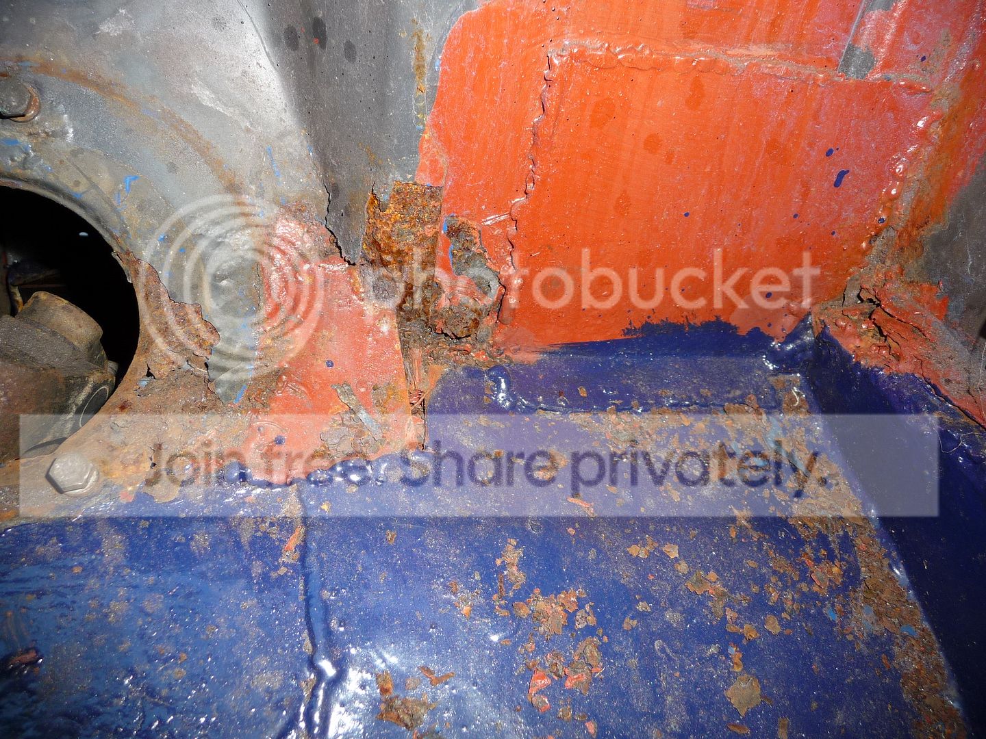

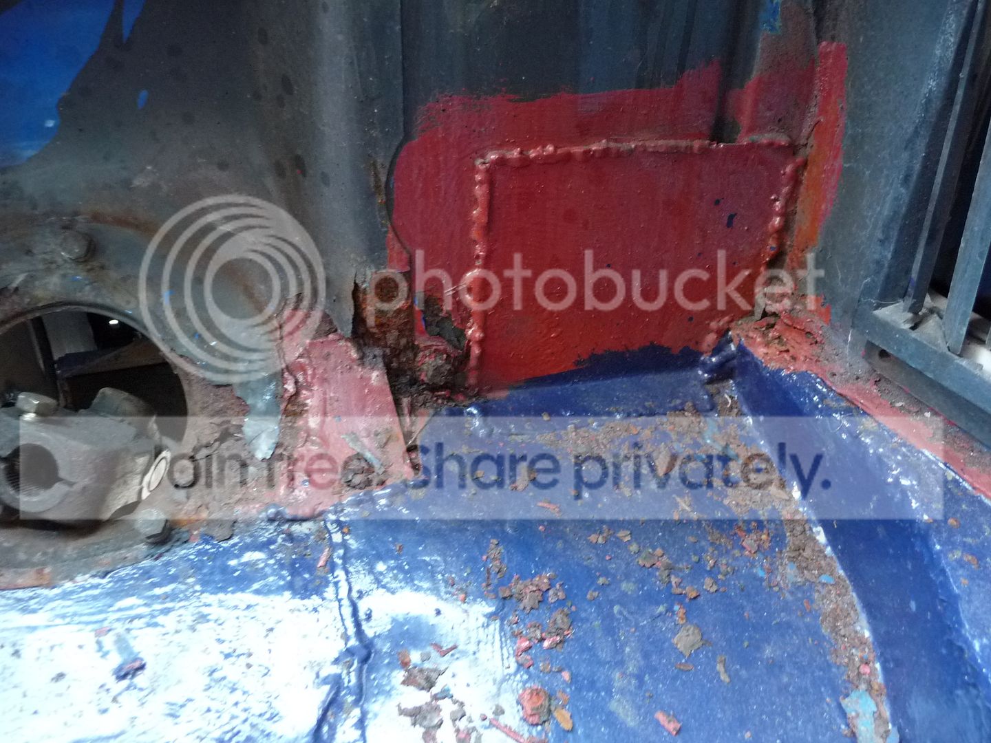

The drivers footwell isn't great. Al Bundy patched this up  in 2018 and i think he did what he could with the access he had (very limited) but now the dash and pedal box is out, this area really looks like it could do with some more in-depth sorting out. I might find it hard to look past this lot if I have invested loads of time sorting out the rotten bulkhead. At least this area is mainly constructed from fairly straightforward flat bits. Think I will order up some extra Zintec! Le sigh......
Would it be worth keeping the master cylinder immersed in fresh brake fluid?  Figure it might help prevent the seals drying out?  No idea if it would help, just a thought that popped into my head.

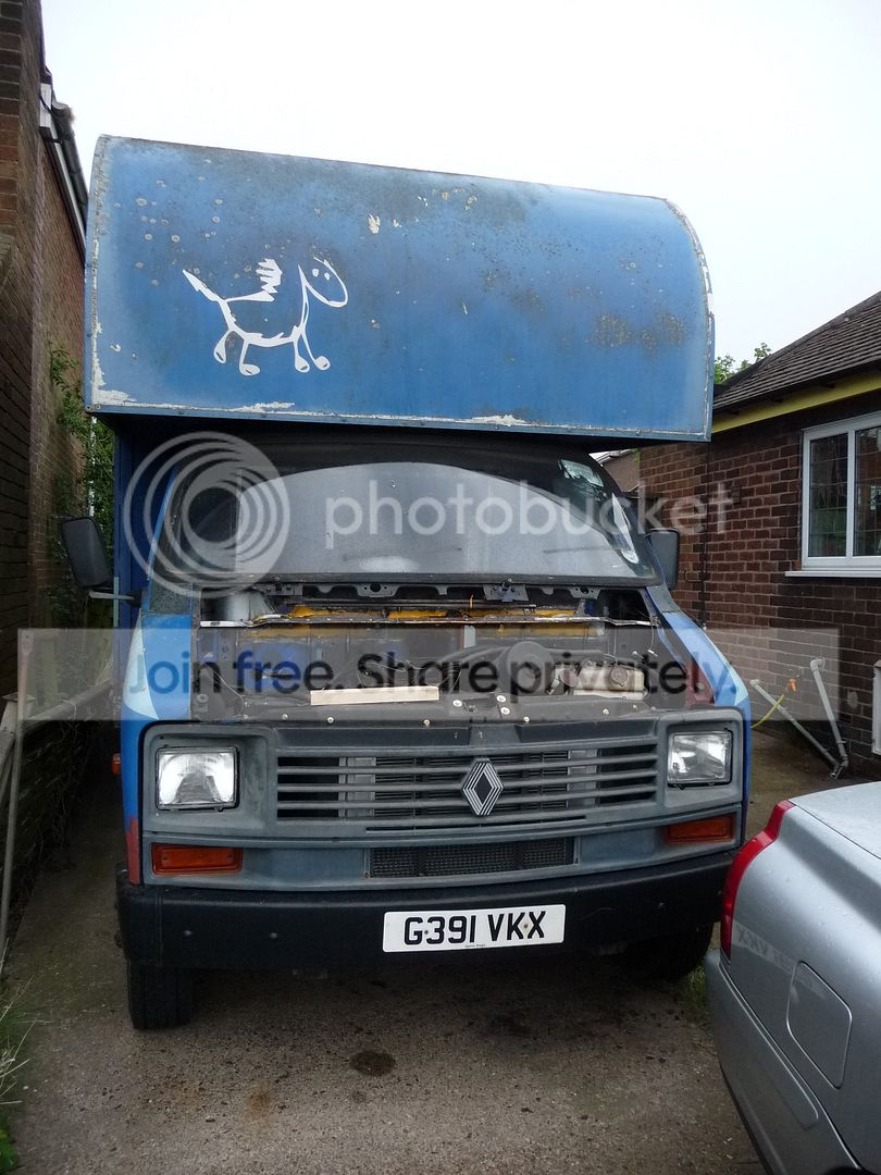

I actually saw one of these trucks today, a matt black recovery flatbed apparently lacking any exhaust based on how loud it was from the opposote side of the dual carriageway, roaring off down the A5 sounding like a bloody Spitfire as I turned off into MK.  Can't remember last time I saw one.
I'm looking forward to this being fettled and on the road. What are your plans for it when it's all done?

Past Parts sell master cylinder kits which aren’t too expensive, about £30 I think. There is an exchange master cylinder on the shelf or was the last time I was there, but it carries a mega surcharge so best to send your one in first if you need one!
The clutch hydraulics can fail as well, again we’ve got all the kits on the shelf and can rebuild. Got all the flexis as well iirc. We get shitloads of enquiries for Dodge 50/RB44 brake/clutch cylinders of all types, yours is a posh one with front discs! As an aside, those discs are fashioned of purest unobtanium, same with the trackrod ends, kingpins, etc.
Cheers AD!! I am pretty certain I'll be drafting in PP at some stage, I am envisaging pulling the rear wheel cylinders off and sending them in for a refurb when the time comes to bleed the brakes through after reassembling this lot. I'm hoping the master cyl will survive the ordeal, but we'll see. The clutch master and slave are visibly pretty new-looking amazingly, so hopefully they will be OK, plus I have not broken into the system there.
Actually @Angrydicky do you know if the lid on the brake master cylinder  is a standard part? Both terminals for the fluid level sensor ore busted off on mine so if I found a cheap new lid I would probably buy it!
I'm glad it's not just me who always seems to end up having to put a new master cylinder on every time I need to bleed the brakes on any car. Presumably (Angrydicky can probably clarify?) it's because the bore of the MC is corroded/clarted up outside of it's normal "throw" so pumping the pedal down the the floor to shift the fluid knackers the O rings?
 Hi, Yes it knackers the seals by making them roll over as they pass the wear/dirty ridge and they don't function as they should. Pressure bleeding with out moving the pedal can over come that problem.
 Colin
I normally shove a bit of wood or something under the pedal to prevent it going past it's normal travel point just in case.
I reckon the tendency for any debris that has settled in the bottom of the reservoir when the fluid level drains out probably doesn't help either.
