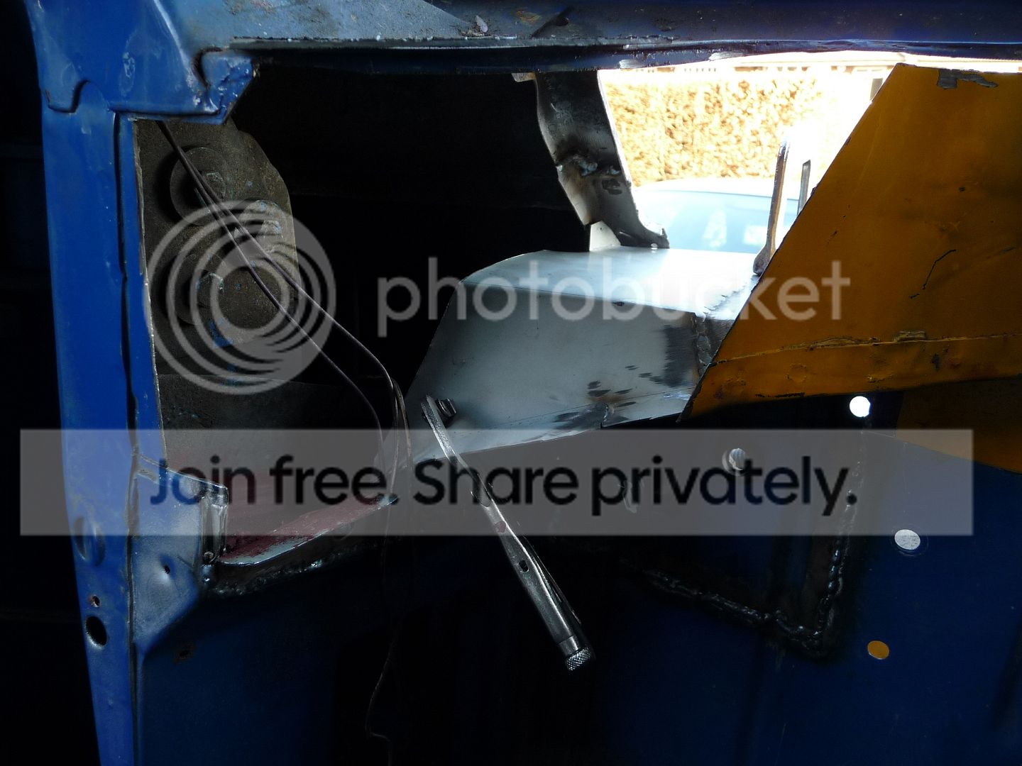

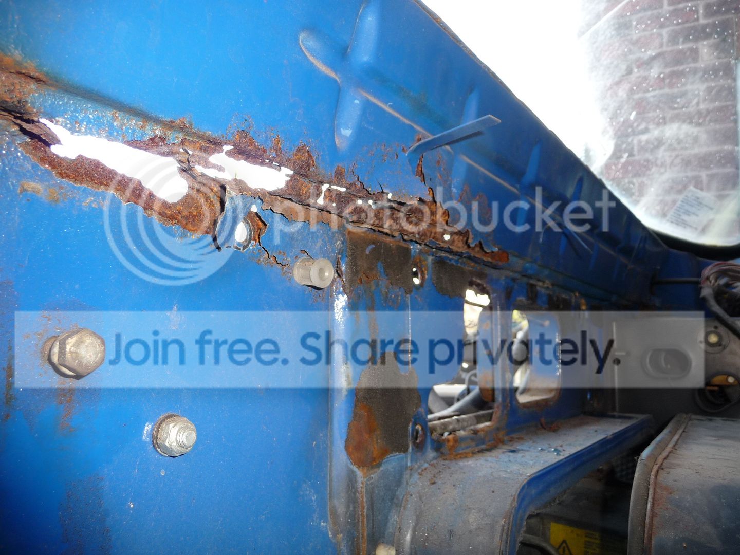

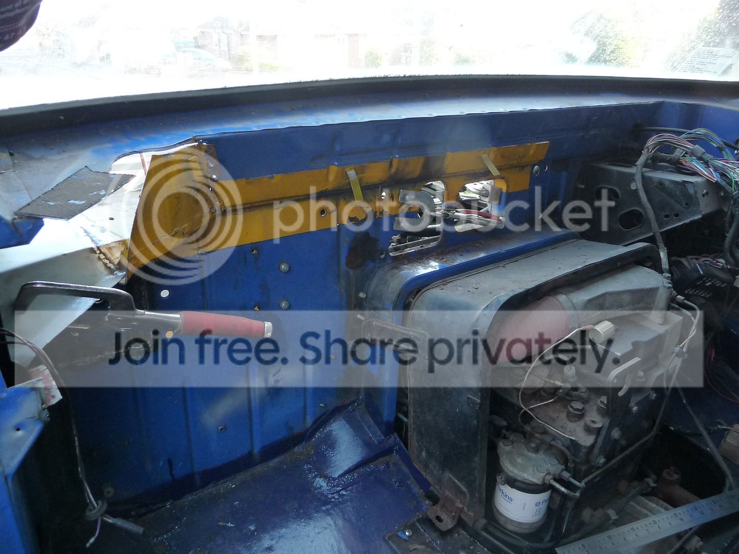

Back on the lorry, I cleaned up the new scuttle and uncovered a load of rust (surprise surprise)
I don't mind the odd pinhole, but that was too much. So:
Thats better
Next, because I had chopped it out, the ends of the new scuttle were missing. I had to extend it to replace the bits 'left behind' in the scrap cab:
Made it over-long with the idea that I would chop it down to fit. Had to do lots of measuring to be reasonably sure the 'extension' would sit comfortably against the front wing, the bulkhead and the scuttle drains.
OK that will do!!

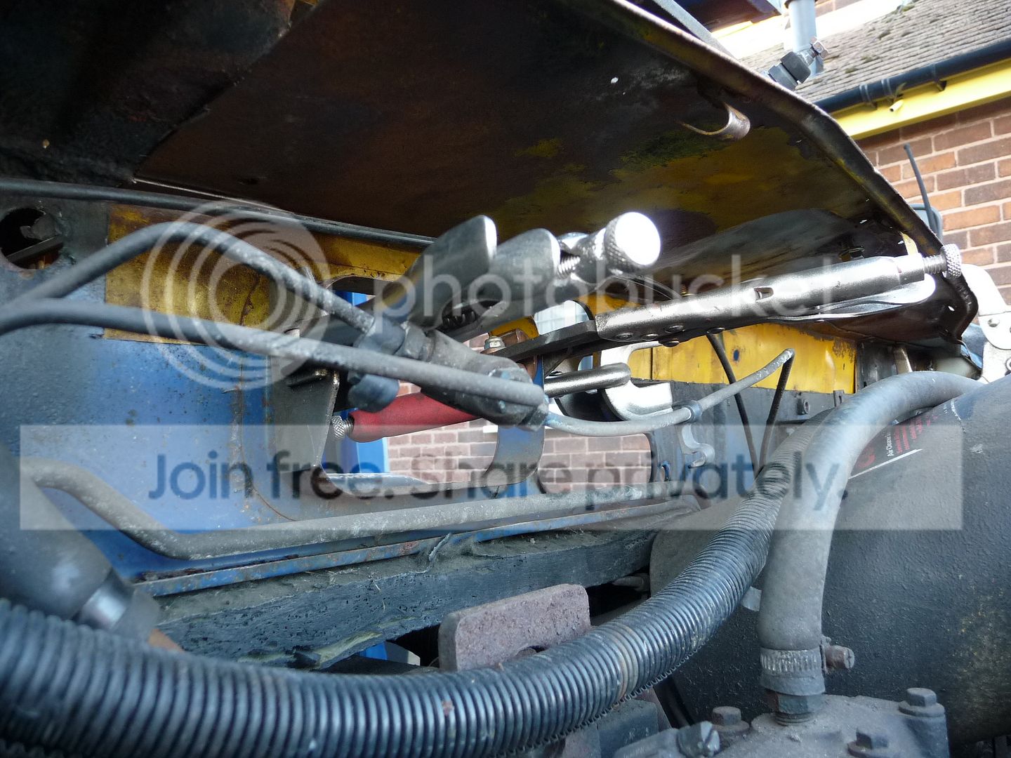

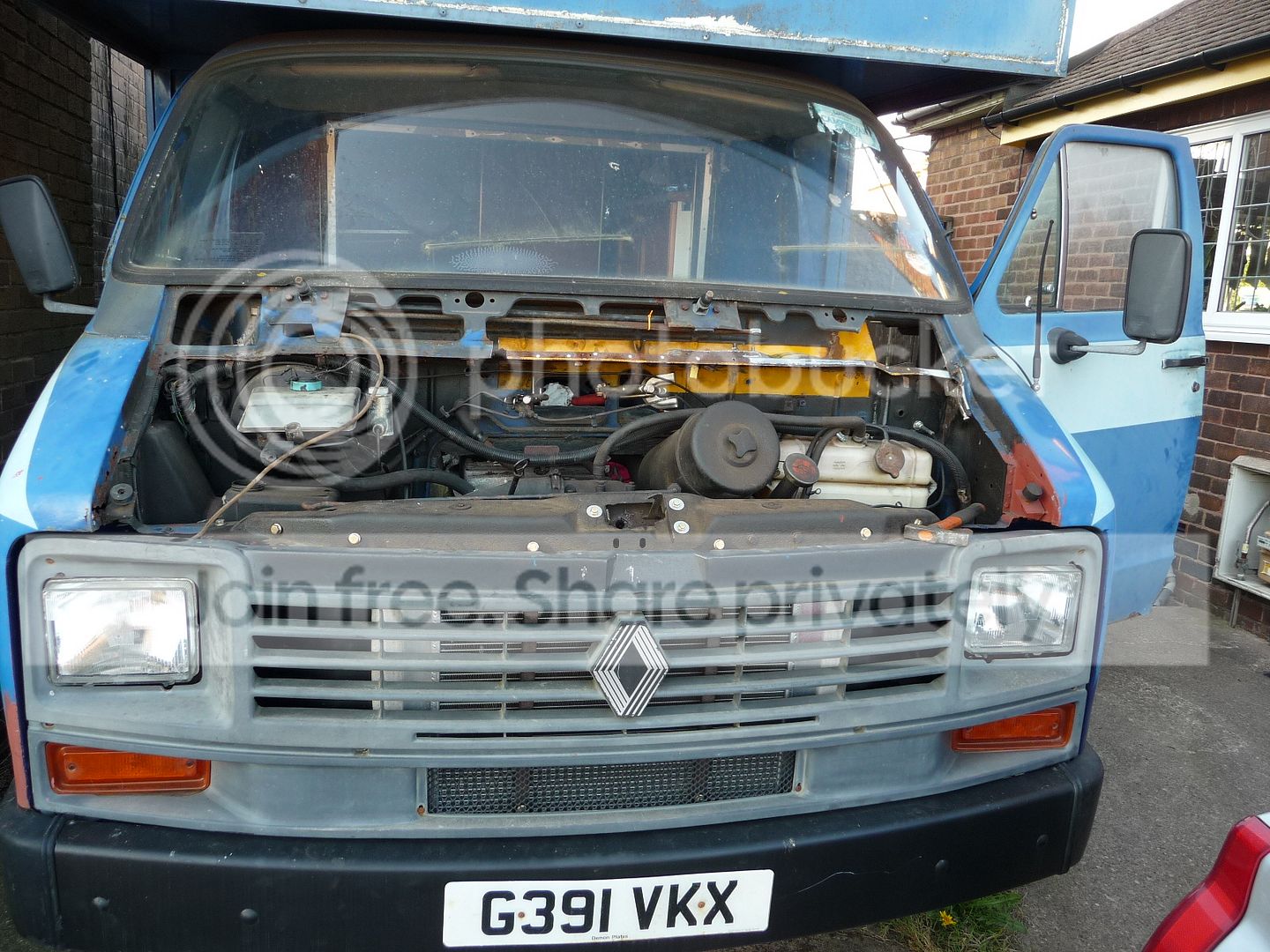

Right there was not a lot else I could do with it at this stage. Had to get ready to start slicing the old bulkhead out.
Started by draining the coolant:
This was fresh coolant not long ago, now its black! I think I will bin it and clean the circuit out with a dishwasher tablet before refilling it.

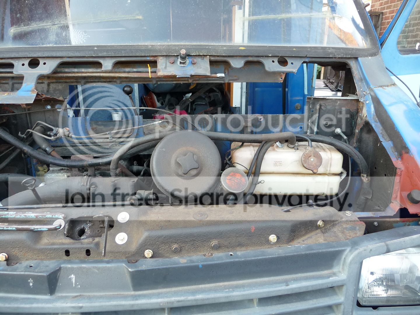

With the coolant drained and the expansion bottle off, I could get a good eyeful of the grot:
Took the heater out. Every single cable and lever on this is seized solid. Will see if I can free them off, if not I have a spare heater box from the scrap cab (dont know if that is any better mind you)
Eeeewwww!
OK now we have good access to the whole bulkhead.
Started working out and marking up where to slice this thing down to fit. measured up and scribed all the cut lines:
After a lot of chopping I had this. I chopped it in 'half' as I want to do the job one side at a time so as to not feel too overwhelmed by the whole truck being in a million pieces!! Looks useful though right?
Started marking up on the bulkhead as well;
Lots of measuring and scribing
Ooohhh!! Thats the malignant tissue excised (Yes i know it has gone metastatic)
Nice big gaping hole in the cab now
Offered it up. Needed quite a lot chopping off the 'extension' and a bit of fettling but was not too bad a fit.

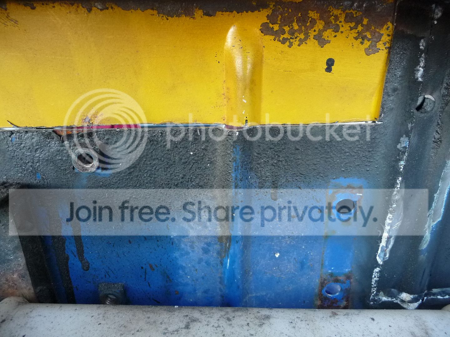

Not great though. Those vertical stiffening ribs actually don't line up all that well. I've got it clamped on that rectangular fan duct in the middle, if I align that, the vertical ribs are out by about 8mm at the outer edge!
I did read that the metalwork on these is all over the shop. I think the bits that were common to the yankee van, were pressed in the states and sent to Dunstable. The Dodge 50-specific bits were tooled up in the UK. They had loads of problems because the yankee parts were off tooling that was already ancient and the parts were nowt like the drawings. So tooling up new parts to fit with them was a nightmare and it led to never-ending panel fit and cab assembly problems. Certainly there is a marked visible difference between these two scuttle panels.
Anyway, after having it in and out half a dozen times I was happy with the fit Ias much as I was ever gonna be). I removed it and cleaned up all the edges ready for welding. Then I took a deep breath and stitched it in!!!
Fucking BOOOOOOOMMMMM!!!!!
After like 4 days of preparation it only took about half an hour to weld it in. I've still got to do the curvy bit at the outer edge but will get on that tomorrow. But, the bulkhead itself seems very satisfactory. Phew!!
What a job!!! I can't wait to get it all cleaned up and a coat of paint and seam sealant on it. That will be a right mojo booster.
Obvs I still have the drivers side to do but I'm hoping I can do that a little quicker now i've done it once already. Hopefully i will need less 'thinking time' on it.
After all this high-intensity tat work over the last few days, the garage is looking like a total shit tip! I might invest an hour in sorting it out this weekend. Or I might not!!!
