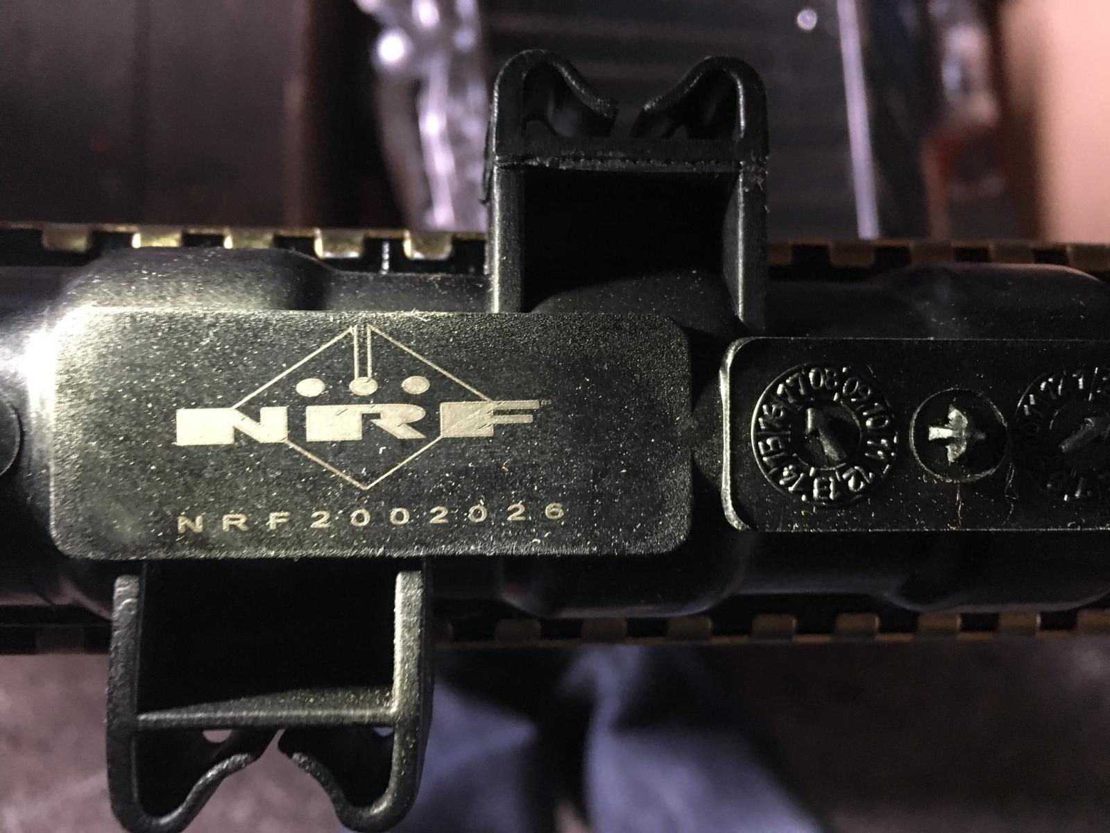

I’ve got a brand new nrf radiator that has some of the fins bent by being mishandled, the part number on it is 2002026. Happy to offer shitters discount on it if it helps.

Here's some more pics of the radiator I have if it's any use to you, feel free to make me a derisory offer :)
Although I think it might be a big to small for you, that's it sitting in front of a doorway to give you an idea of size. A question for other shitters does anyone recognise what it's from as the part number on it doesn't seem to result in anything from googling it???
My first reaction to the question of what that's from would be Pug 306 I reckon...
Yes it's definitely a PSA product of the late nineties, early 2000s
Actually on closer inspection it's for a 1100cc Saxo so I reckon you'd need about half a dozen of them to cool a dodge 50 being dragged up a hill with all bolloxs hardwood worktops, cast iron stove with stone hearth not to mention his massive collection of dream catchers and horseshoes.

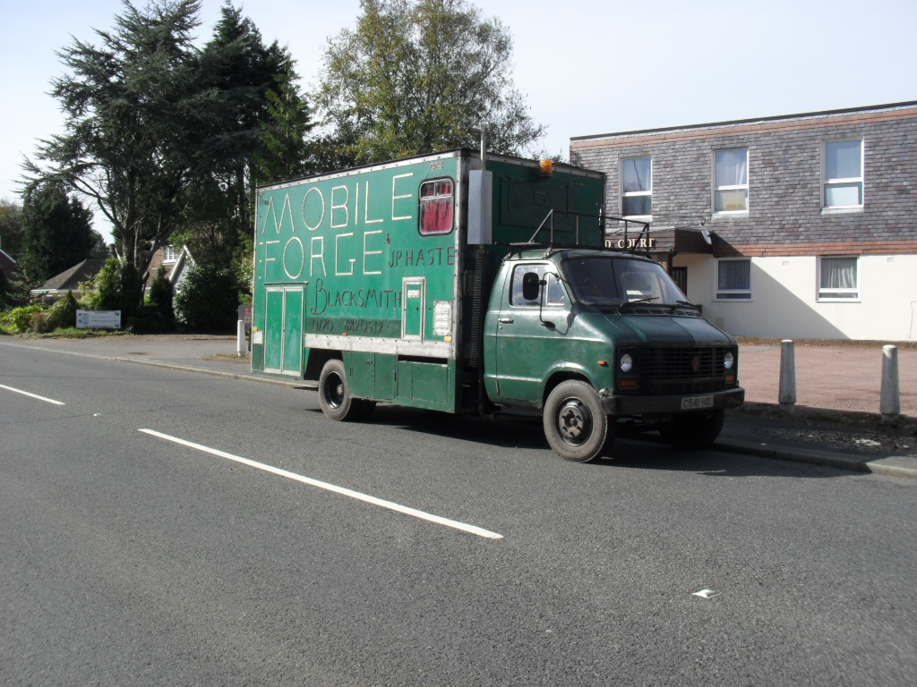

Mobile blacksmith spotted locally,i waited to speak to the owner but he was obviously busy.
