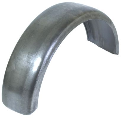

 Hi, What about trailer mudguards cut in half lengthways and will do both sides, just like the Spedeworth guys do.

/\ Problem with that is that 50-series front arches are nowhere near round, so those would take a lot of pissing about with to get to fit properly.
Are you on the Dodge50 Facebook group Mr B? I'm sure someone has figured out what available arches have the nearest profile already - apologies if the concentrated wisdom is indeed those above.
