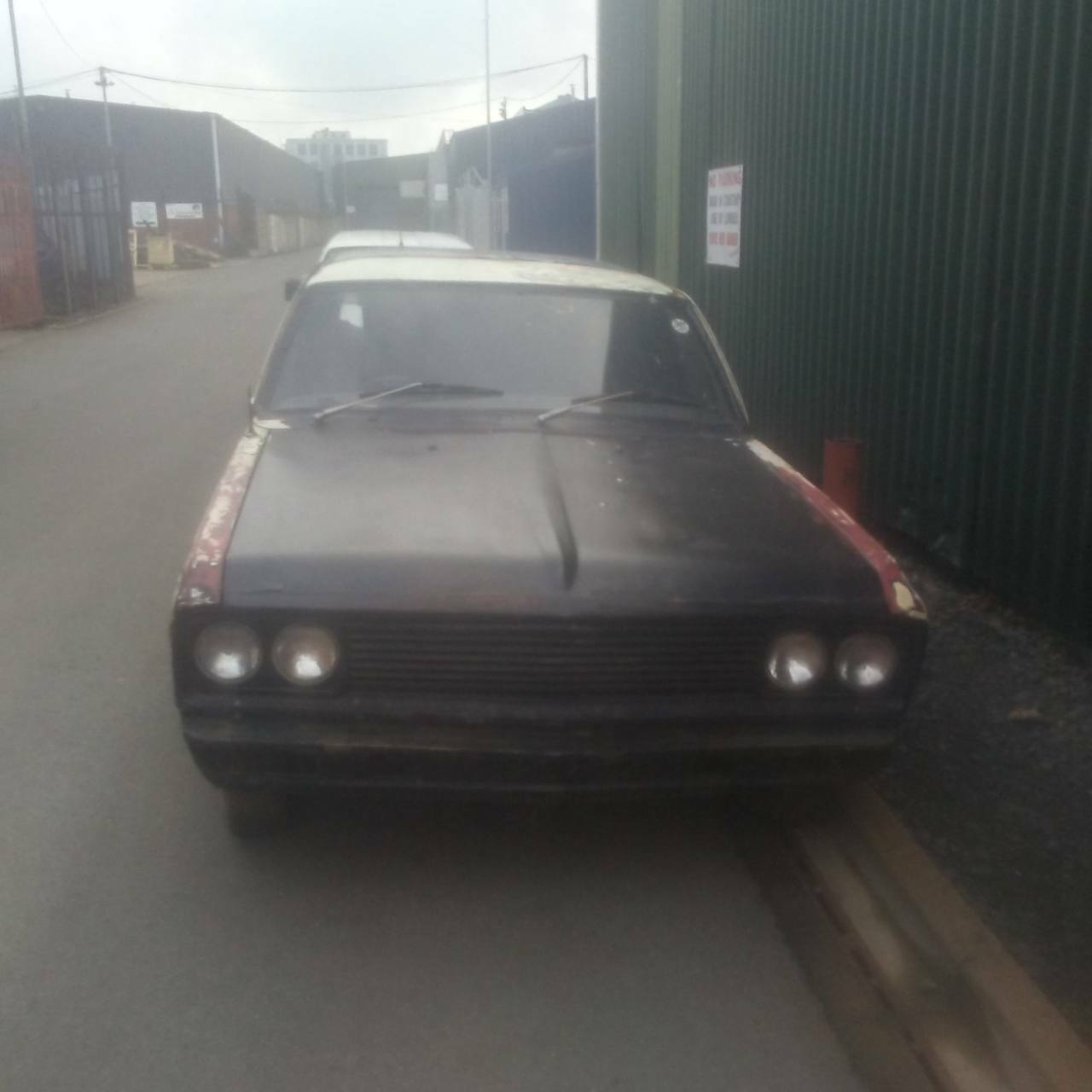

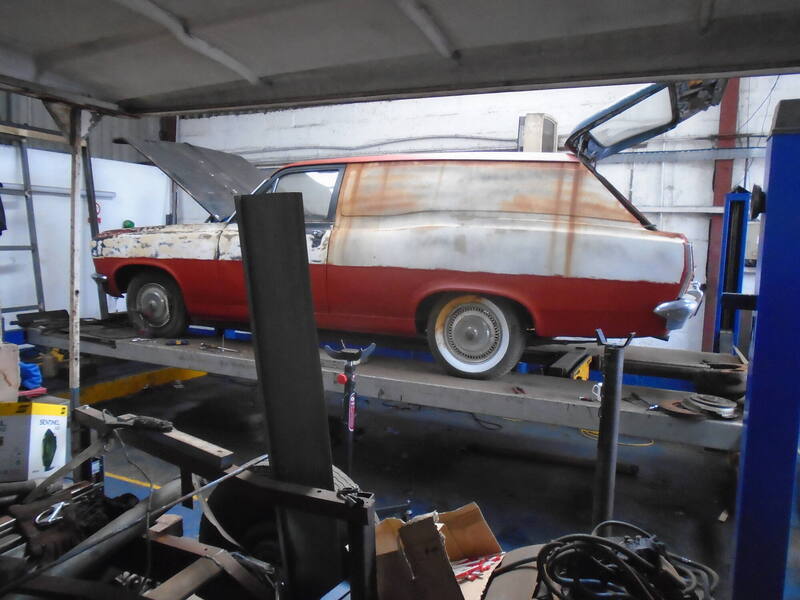

Anyway have a couple of gratuitous photos,
There’s an excellent selection of tat in and about that workshop. Is that an Aston Martin DBS V8 in a couple of shots?
This is knocking about locally, the eccentric but talented owner is building a bored, stroked and injected lump for it. I just hope he fits it while there's still something to bolt the springs to,the rear quarters are getting pretty ripe.
Sure is.

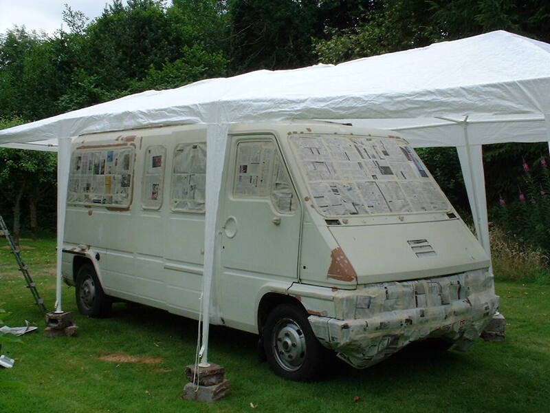

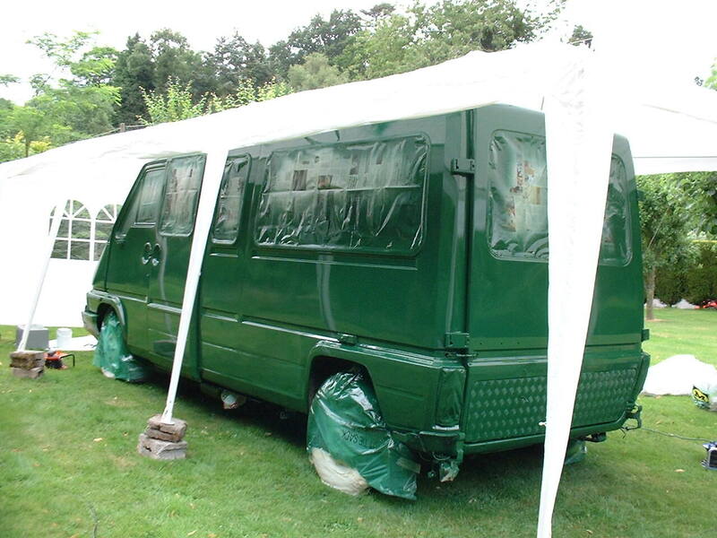

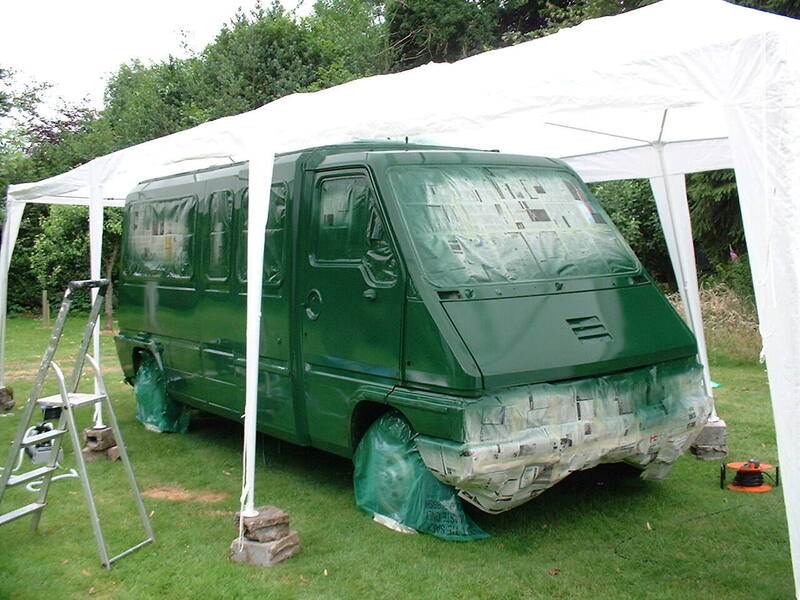

I'm not sure what to do paint/colour wise with it. I can't afford a full body job and respray
I was in the same boat with my old T35D Master camper back in the day. I sprayed it with coach paint using one of those cheap Apollo HVLP sprayers. The overspray was horrific (I was green from the waist down) but the end result was better than I could have hoped for. Total cost was about £250 (including buying the sprayer).

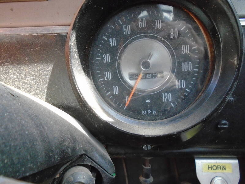

 Anyway, got to wait a couple of weeks. I'll leave you with a gratuitous, too much sunnage, photo of a Cresta speedo.
Note the warning lights. Three ? I think there are five in a 305. Progress !!
Just noticed. I knew about this but didn't realise it was in the pic. The easy access horn for all your motoring needs.

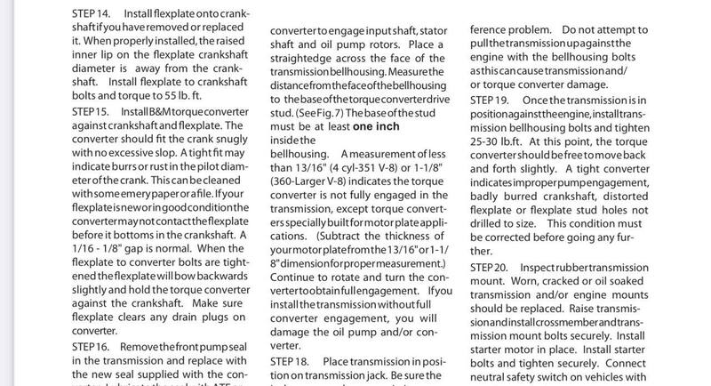

Well, it's been a while and things have not gone according to plan. Got the gearbox back from Andy but my mate got really busy and couldn't fit it. Eventually got a Saturday afternoon when we could get it in. Bloody hell it's a heavy lump ! After a bit of a struggle we got it on and all the bell housing bolts done up finger tight.
Then came the problem. The Torque convertor seemed to be jammed and wouldn't turn to line the fixing up to where it bolts to the end of the crank/starter ring. Bollox ! Couldn't get it to fit no matter what we did. More bollox !! So that was as far as it got which was about 2 weeks ago.
Contacted the Cresta club and various other bods but no luck on finding out any useful info. Then I got in touch with Andy, which I'm sure some of you are thinking why didn't you. Maybe I was over thinking it but asking why a box that he built might infer that I was saying it was his fault that it didn't fit which I didn't want to do. So I rang and had a chat with one of the two mechanics that work there, and emphasised that I wasn't criticising their work, and he said he knew how to sort it. He did start to explain but I had to stop him as I have never had an auto in my life so it was right over my head.
Upshot is they can have a look at it in a couple of weeks and sort it out.

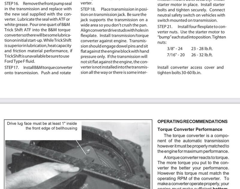

This page is a good read on the things you have to get right when fitting a GM auto. I don’t know if any of it is exactly specific to your car, but in general terms it may be helpful. Note that the torque converter is trial fitted to the engine in step 15 and then seperately trial fitted to the gearbox in step 16 before finally fitting the converter / gearbox assembly to the engine.
https://static.speedwaymotors.com/pdf/20020483.pdf

Video about torque converter to flex plate and 'box clearances. It's a bit rambling and disjointed but might clarify things a bit.

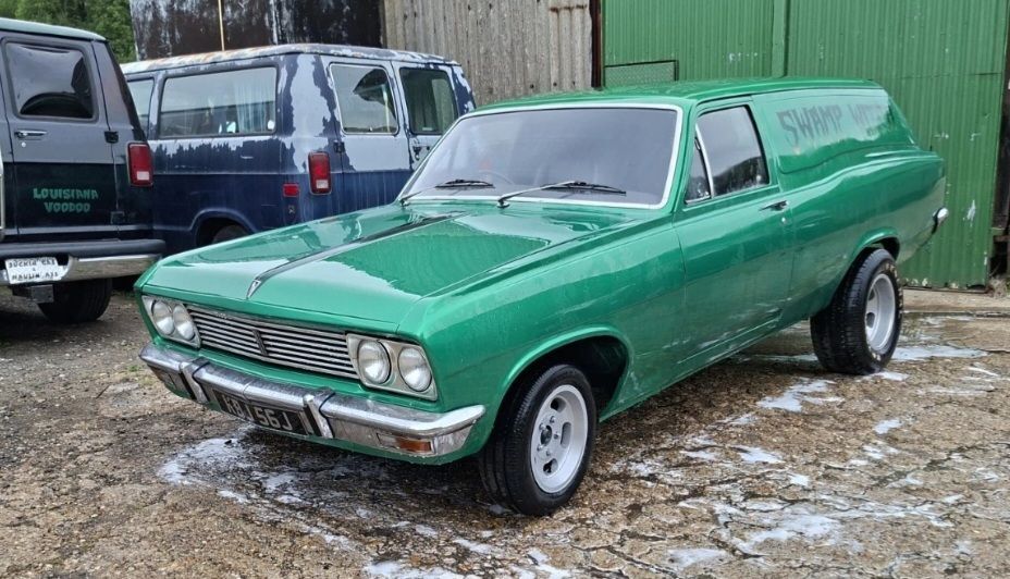

On 12/10/2021 at 3:10 PM, puddlethumper said:
Turns out the new owner is going to put a MANUAL DIESEL in it.
Or maybe not?
1916303318_Screenshot_20211211-195731_SamsungInternet.thumb.jpg.a960197ce2e99410e30afe24940c176a.jpg
Whatever, it lives on for now - which is nice to see
