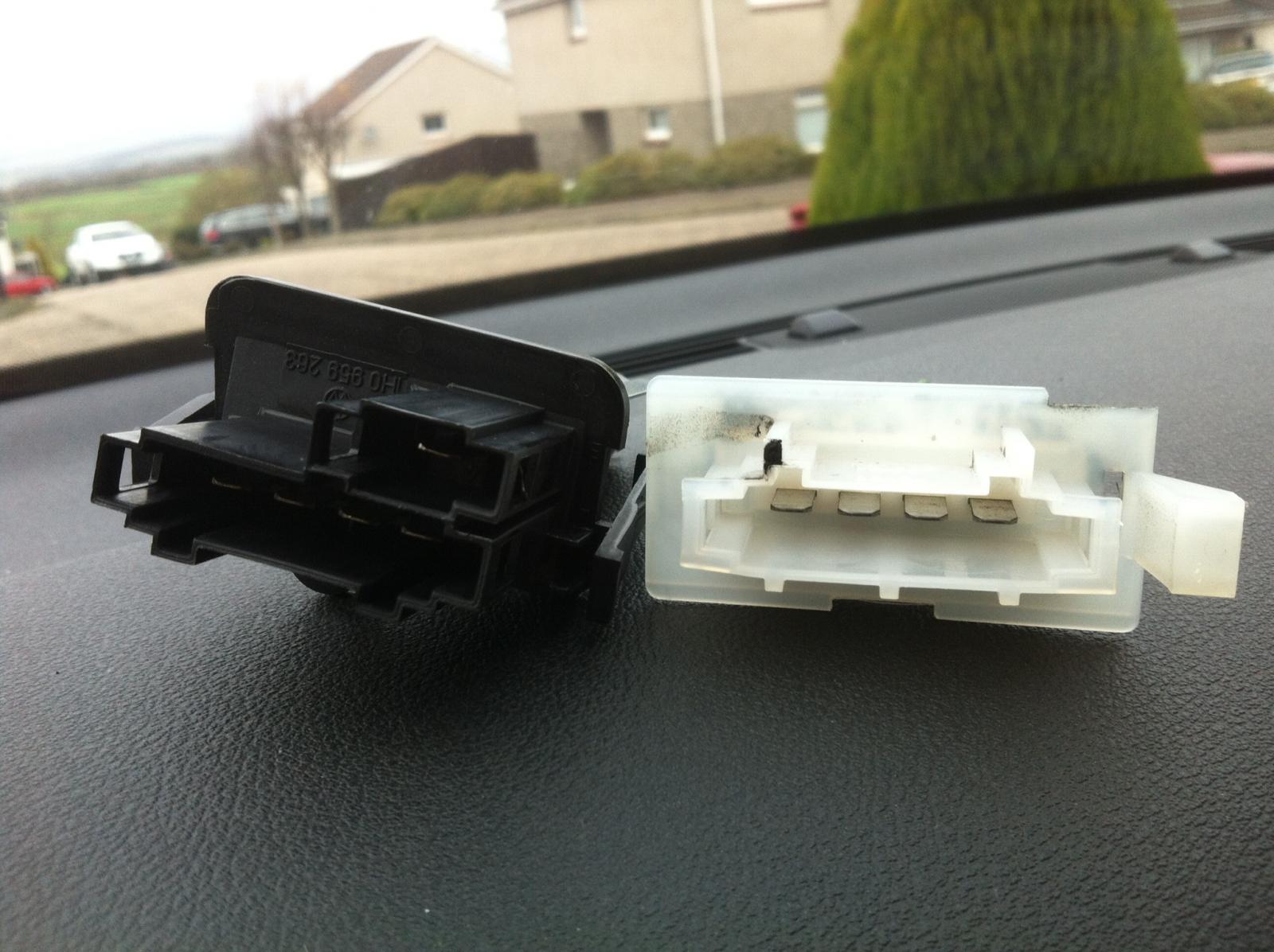

[gm] I'm such a smart arse and I fixed my heater blower for only 99p, aren't I a clever dick ? [\gm]
Arsebiscuits ! My super duper mega fix lasted half way to the shops before there was a faint whiff of smoke and the heater stopped running ! Cruel fate, why do you mock me ?
A trip to the scrappies tomorrow then :)

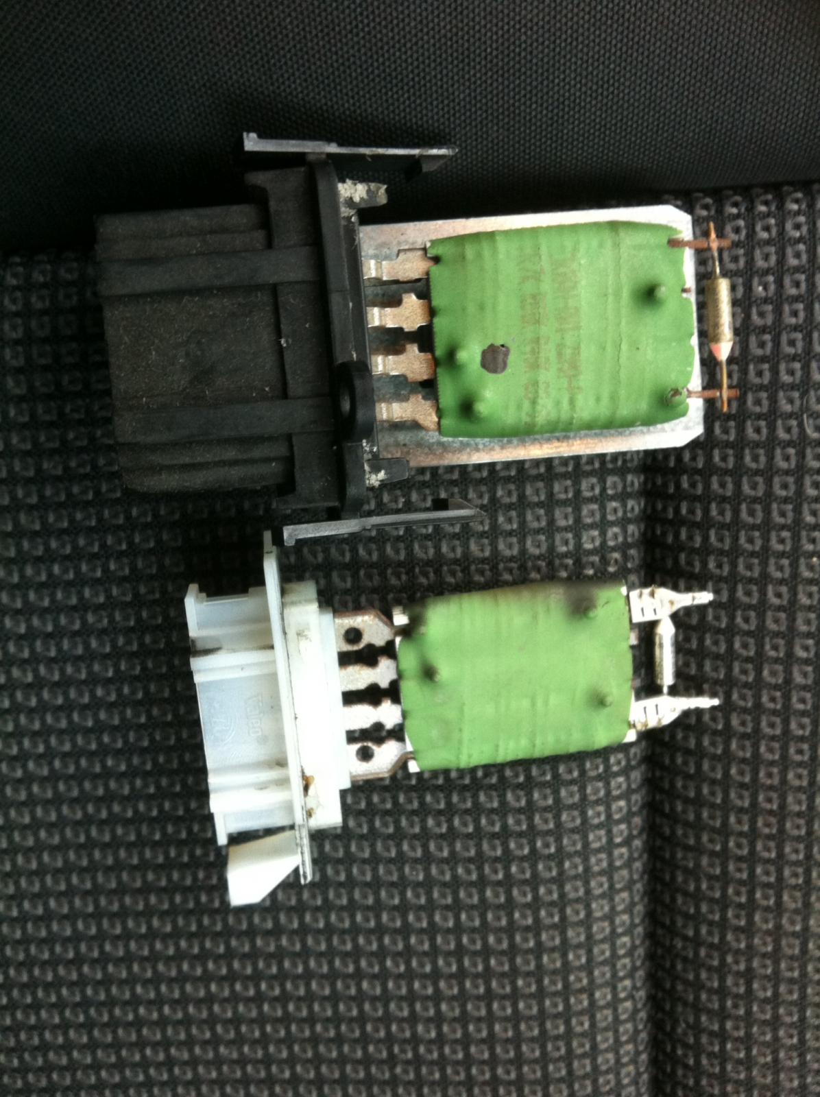

This suggests that there's a fault elsewhere ! Don't waste money on a new resistor pack before finding out why the fuse has blown (twice !), otherwise it's likely that the new resistor pack's fuse will do the exact same.
Edit : Checking that all the contacts of the resistor pack are free of corrosion may be a good start ?
I'll take the multimeter with me to the scrappies and see what readings I get off another unit, at least it still works on full belt
If it still works on max, it's probably the resistors that have gone rather than the fuse - perhaps this had caused the fuse to go the first time round ?
In which case you may indeed need a new resistor pack. The one in your pictures looks very similar to the one in my 6N Polo - I bet that various 90s VAG_SHITE will use the exact same unit.

Resistor pack - if replacing the thermal fuse made it work for a while on all speeds it isn't the resistors. I'd suspect either a blockage in the heater box (not that likely now you did the pollen filter) or the fan has come loose from the motor because that also got hot while the pollen filter was blocked. I've also seen half siezed knackered motors that work but draw over double their rated wattage.
Basically, pull the motor and have a look - it's probably that.

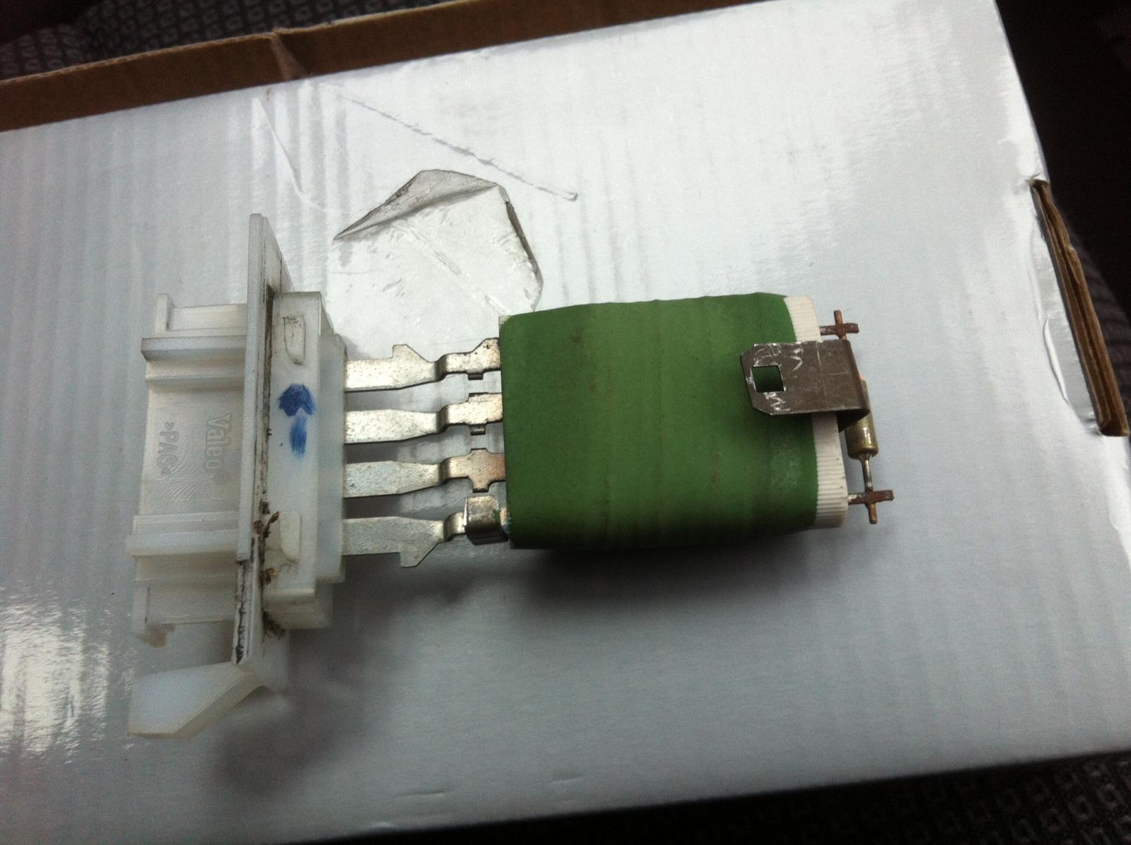

Right then, back to this aldi heater fan nonsense - a trip to the local breakers drew a blank on aldi a3s of the right age but a poke around the vag area (ooh err) proved beneficial when I found this in a polo
the guts look to be close enough, a check with the multimeter showed the resistors to be the right range and working, only one snag, the plug is a slightly different fit.
a quick poke around with the screwdrivers and they're in bits.
that 5th pin was deemed unnecessary and chopped off, and here we have the finished article
which (drum roll please) sort of works - fan speeds 2&3 are the wrong way round but I'd just fitted the guts into the plug upside down, a quick swap round and the jobs a good 'un :)
now let's hope it lasts longer than the five minutes the previous fix did !
cost this time £10 (which included two of these polo fan packs and a replacement glovebox for the mazda as the last on fell off its hinges half way round knockhill a couple of months back)
