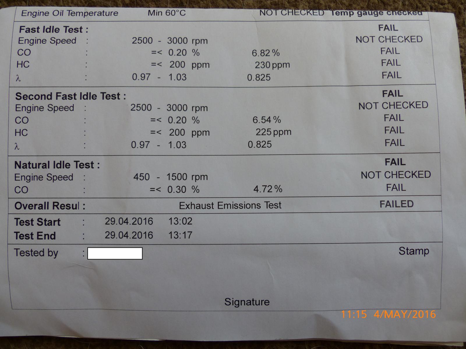

I took both Transit vans to my favourite stretch of bypass this evening for some "performance testing".  Interestingly, although the newer van feels subjectively quite a bit quicker to drive, against the clock it's only a second and a half quicker to 60 (23.5 seconds against 25 for the DI).  The DI is lower geared, which I suppose helps its case.  The difference is more noticeable when overtaking though - I suppose that's where the turbo diesel's superior torque comes into play.

I thought, having bought some new plugs and an air filter, plus some 'crud-be-gone' fuel additive for the catalyser, it was time to figure out the enormity of the task of getting the Presidential Renner's emissions back in line with current regs and a new MOT being likely
And they are so far out, I hadn't realised that the target figures were already on the emissions test results sheet.
So here, for your amusement, are the results:
*Identity of my tame MOT tester has been redacted to protect the innocent
Yes, the CO is 33 times greater than the limit at fast idle, while the HC is 12.5% over.
Oh dear. How is this engine even running? Will one bottle of crud-be-gone be enough? Or is this total cat failure? Only time will tell...
That emissions read out is a car running crazy rich - no treatment will help that .
Id put money on a coolant temp sensor or maf ( if it has one ) fault or maybe a misfire.
Its not a cat failure at the mo but it may have poisoned it if its been running like that for ages
Typical cat failure is a "just fail " of about 0.5% CO
I thought my Pandas emissions were bad.....Im surprised it didnt set fire to the guys exhaust probe.
Would a lot of oil getting into the combustion chamber give the same values?

Hydrocarbons aren't too bad so I'd rule out a missfire,or oil burning. Something is causing it to go rich, coolant temp sensor as mentioned, or I've seen Lambda sensors doing this on Renners. Can you get a diagnostic machine on it, even a cheap hand held one can tell you if the Lambda is switching properly. Inlet air leaks also can give a crazy reading like this as the lambda sensor tries to compensate for the really lean mixture.
when the jaguar had a cracked exhaust manifold, that too caused the lambda thing to get all squiffy and have the car over fuel itself, and run really rich.
