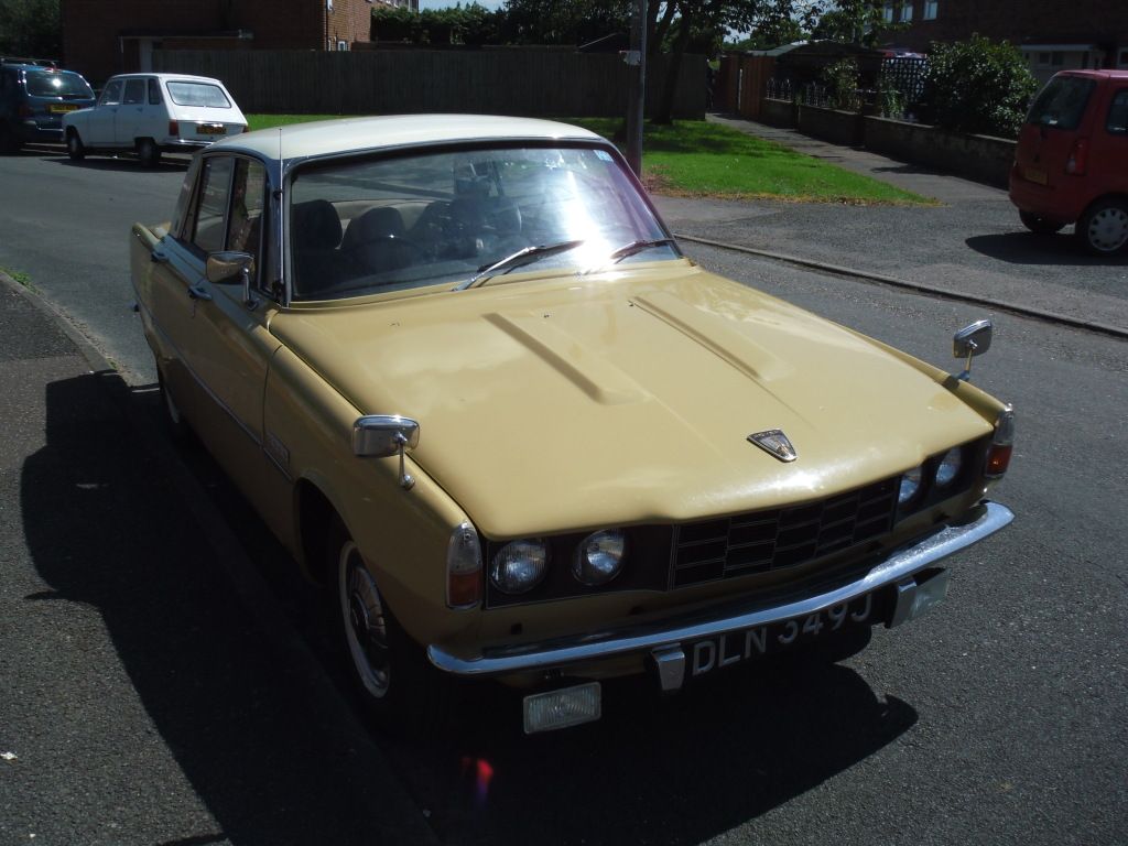

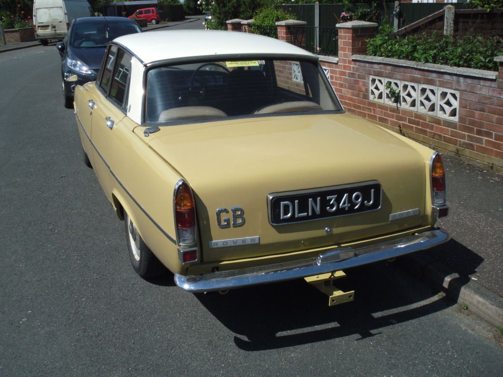

I managed to acquire some more tax exempt chod earlier this week. This, to be exact:
It's an early Series 2 2000 SC manual, so it's not the quickest thing on the road but trundles along OK. It's very solid for a P6, having been restored a few years ago, although it isn't perfect. It drives well, although the brakes need a hell of a shove at the moment as the servo's been bypassed, and everything seems to work, even the HRW - a first for me on a P6.
Before anyone says anything, I didn't actually buy it - I got it as a swap for the Jeep (which needed more work than I'd anticipated), the Metrocab and one of the Spacys. I don't know how long I'll be keeping it though - I do quite like the old crate, but I could do with the moneyz as well.

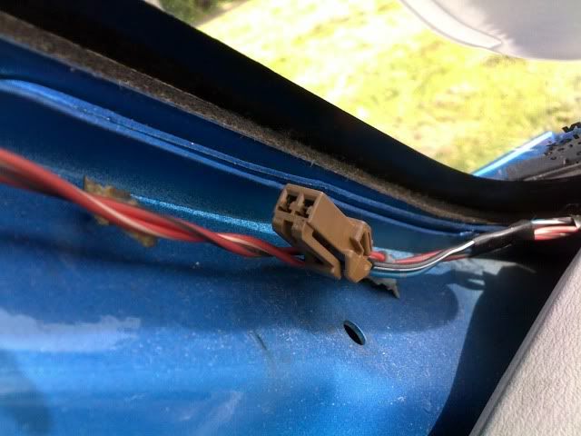

Took the Micra for its MOT today. Apart from the nearside rear wheel bearing and a couple of sidelight bulbs, it passed with flying colours. At the same time it was given a service which it hadnt had for a couple of years. Whilst waiting around I took a stroll to a nearby scrappy where I managed to pick up (yet another) parcel with OEM speakers, though the shelf has seen better days the speakers work fine. I also picked up some A-pillar trims with little grilles in them for the tweeters which aret installed in my car.

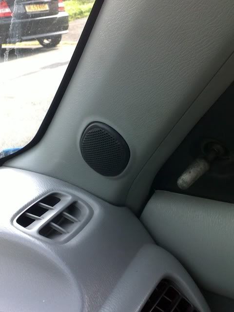

In a true autoshite fashion, after removing the A-pillar trims for the first time I discovered a tweeter connection on the passenger side, but not one on the drivers side:
Looks like I'll have to just wang on a tweeter on the passenger side until I can be arsed to find/fix up another connection for the drivers side.

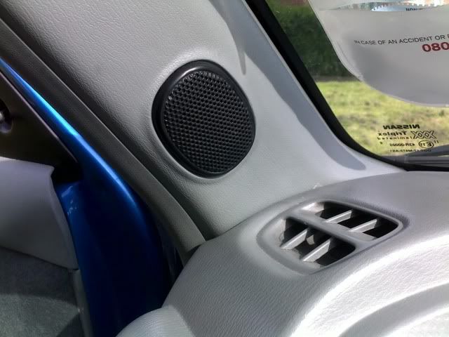

I've got some tweeters somewhere but I cant be arsed to look for them so I'll grab some from the scrapped Micra I robbed some parts off today.
A-piller trim:
Nothing behind the little grilles yet so I'm kind of cheating but at least it looks like I've taken advantage of the 'accessories' option :|
