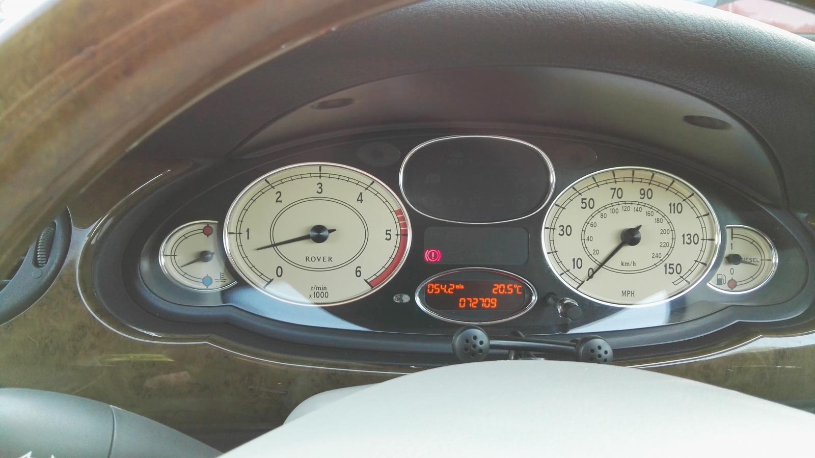

Im not an expert on the Diesels but you could have a sticky thermostat? Diesels can sometimes run too cool. Why don't you monitor the actual coolant temp by using the onboard temp gauge, this is how;
Normal operating temperature for the petrol engines is between 90 and 100*c, the Diesels probably aren't too different.

Any pics of the 75 yet shumarialto?
a) Put key into ignition and turn it to position 1 (instruments activated).
a2) If you intend driving with diagnostic mode active, start the engine now.
B) Press and hold the trip reset button. This is the button sticking out near the speedometer.
c) Your LCD display will show "test 1.-"
d) Immediately press the reset button every half second until you get to "test 19.-". (19.0 allows access to diagnostic mode)
e) The display will now show alternating "Log 1 -on" / "Log 1 -off"
f) While it shows "Log 1 -off" press the reset button and. .
g) With no delay press within a half second until number 7, then your coolant temp will appear
Thanks for this, i will have a look tonight. I will get a photo up soon. Interior is mint, cleaned it up last night. Exterior is very straight, just a shame every panel has been keyed  :shock: but that will be fixed soon. It really is a lovely place to be, only driven it 50 miles so far but it really is nice.
