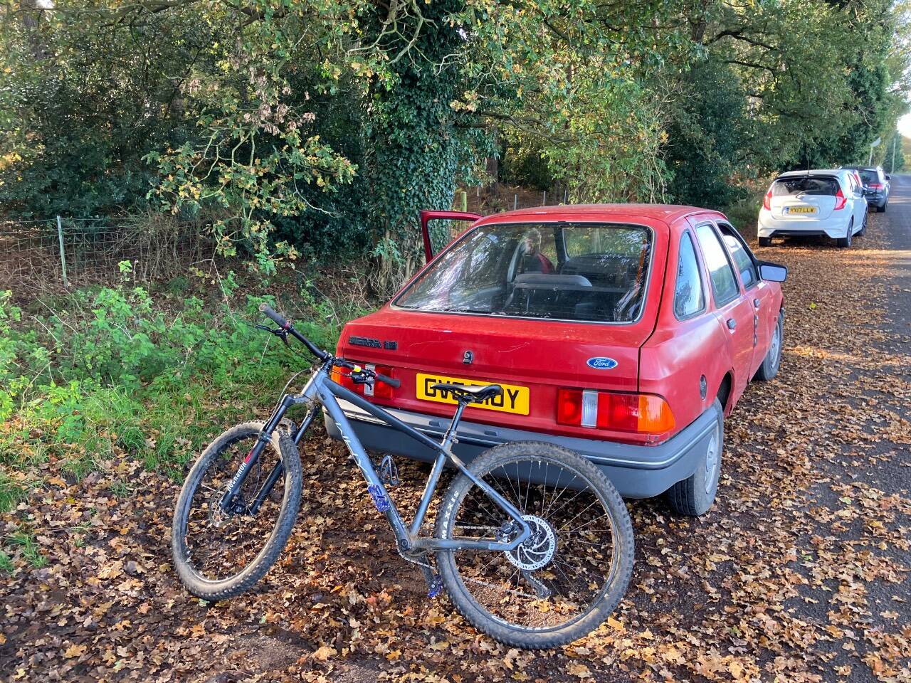

On Tuesday, I took the LEAF for petrol
I did actually get a can as preparation for collection of this mighty steed
Plan is to get it to the unit tonight and see what it will need for it's next MOT.
Thanks to @Split_Pin for his help in organising.

That's a seamless respray on the back end.

Aye. Think an old owner (not the gent I got it off) was a fan  of painting things.
It's exactly as advertised and drives really well. Pleased with it so far

Good news. Had it not been for a chance conversation with my neighbour last week then this would have been scrapped. It seemed a waste as neither the current or 2 previous owners had any bother with it and I'm glad I asked on here.
Good luck on the MOT!
