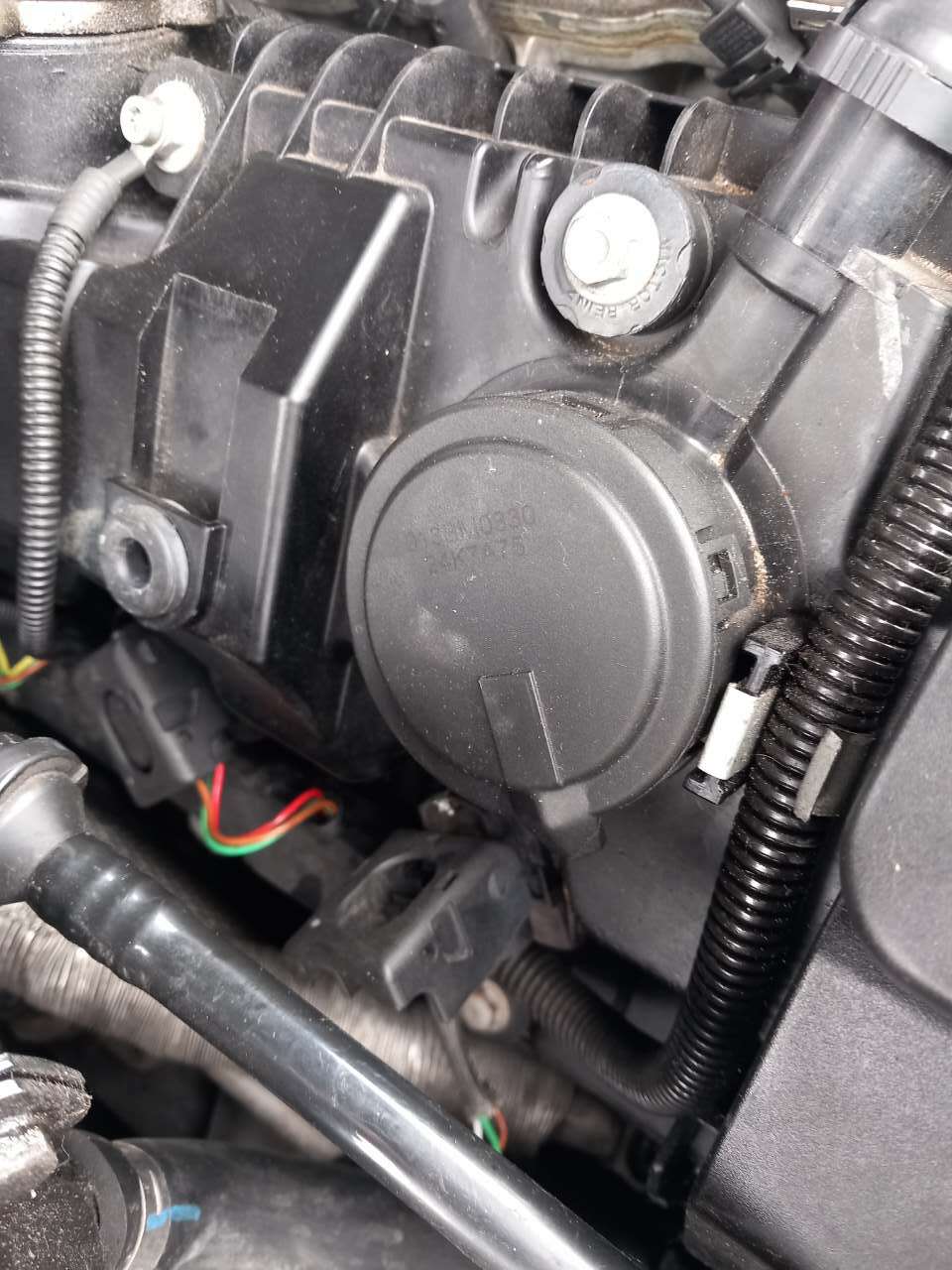

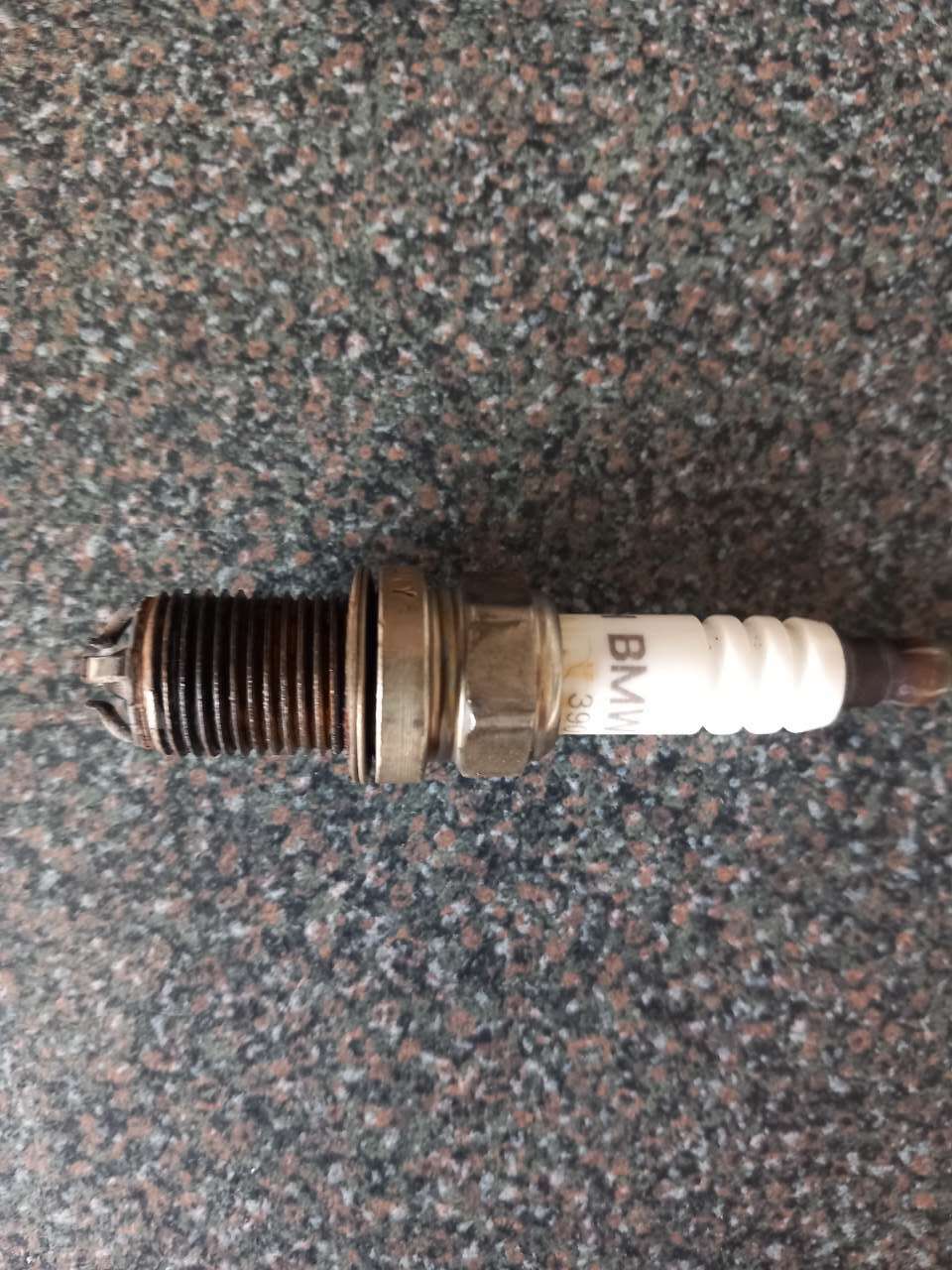

I have avoided replacing my BMW's spark plugs for a number of reasons - access is a nightmare and the risk of breaking twenty year old plastic.
The car runs very well - however, to me any way, it seems to need larger throttle openings than should be needed for an engine producing over 300 hp and over 300 ft/lb of torque.
Time to let the dog see the rabbit -
A bit of WD 40 and some dismantling gives better access. I put my finger through the hole in the clip and pulled. Out came the coil.
A 16 six sided socket is needed to get the plug out. I found this -

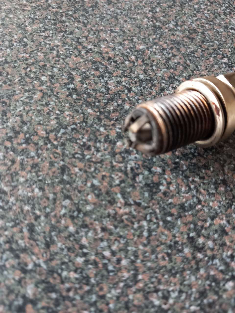

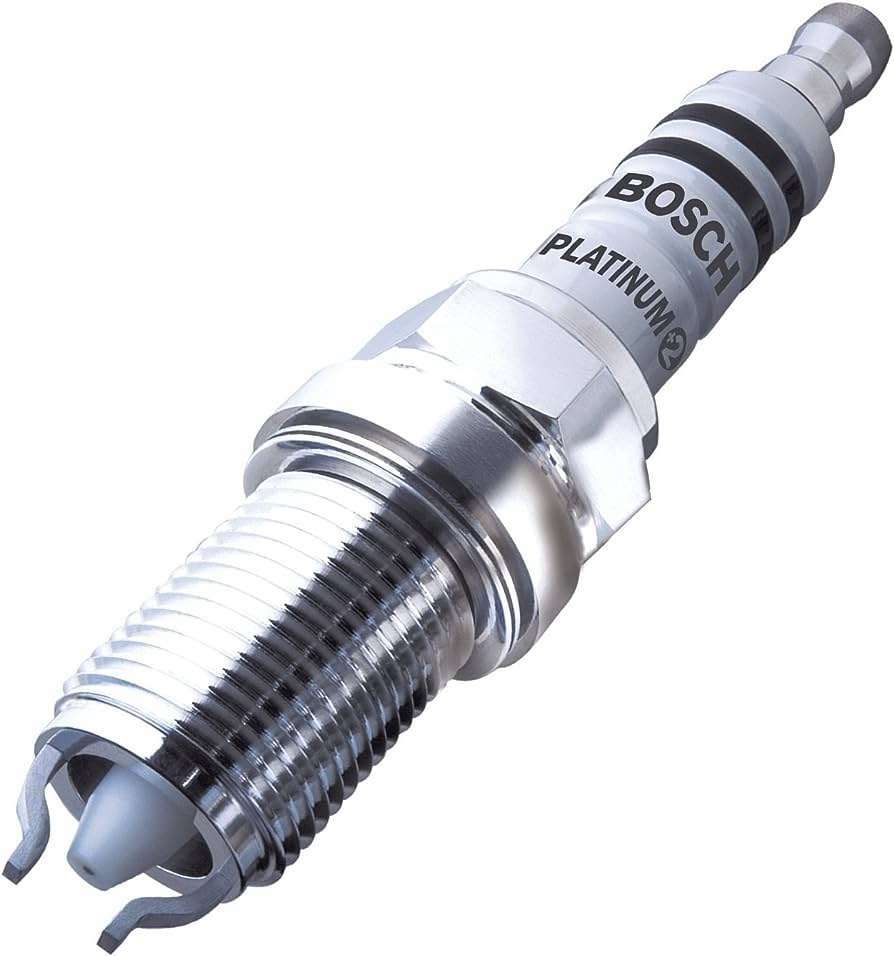

my suspicions the car had it's original plugs proved correct. In fact they are the worst plugs I have ever taken from a car - 20230827_141245.thumb.jpg.c6344cad9cbec359f732024553b06cc0.jpg
The centre has eroded away completely. A new set for Tuesday methinks......

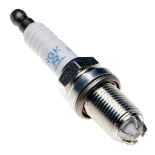

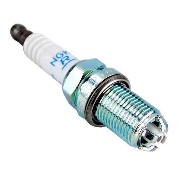

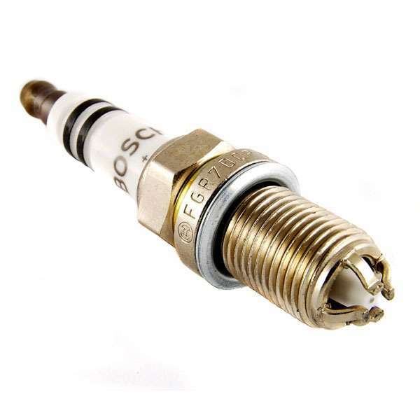

Some platinum plugs have no centre electrode exposed when new. I can't tell from your photo, as it's a bit too blurry, if they're supposed to be like that.
Looking at those then mine may not have  eroded - however I doubt they have ever been changed so I will buy some new ones.
I suspect they're probably fine. But I'd be changing them too if it was me and I didn't know when they were last done. Especially as the car is worth money, plugs aren't that expensive and you want to rely on it being reliable.
Nothing in the history to suggest they had been changed - I doubt anybody would have fitted BMW branded plugs. I will get some in the week.

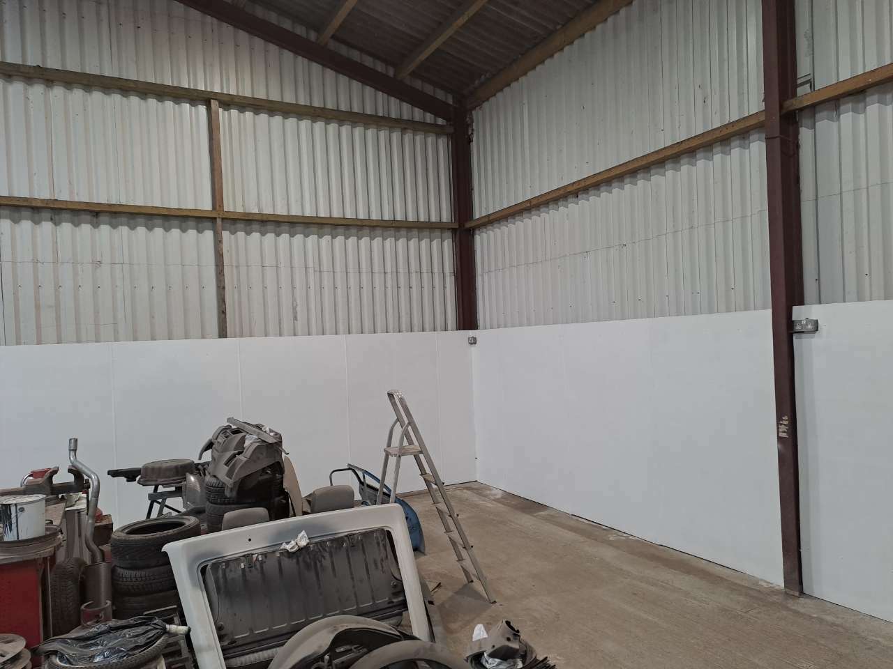

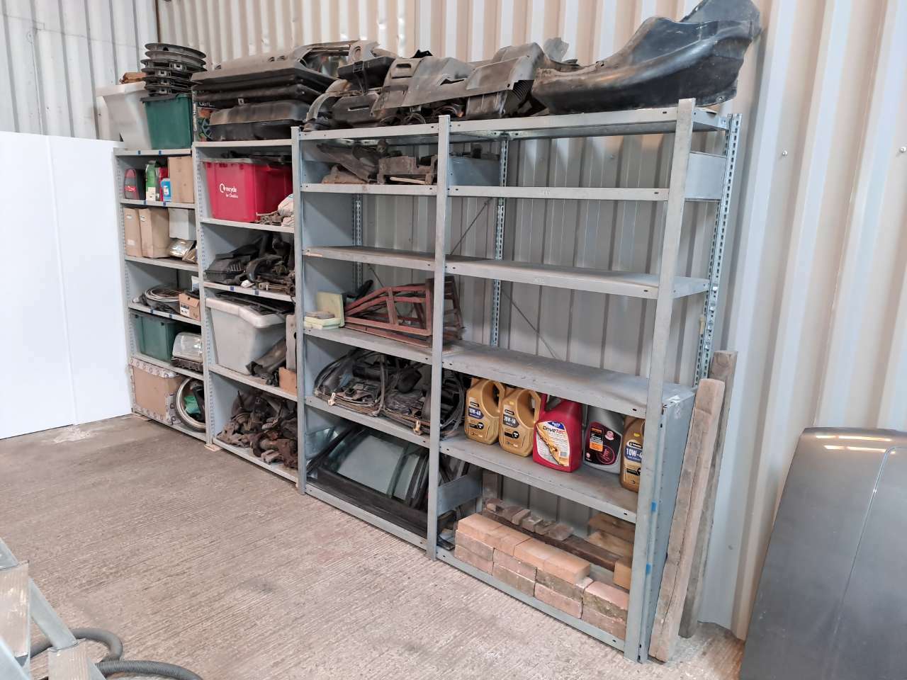

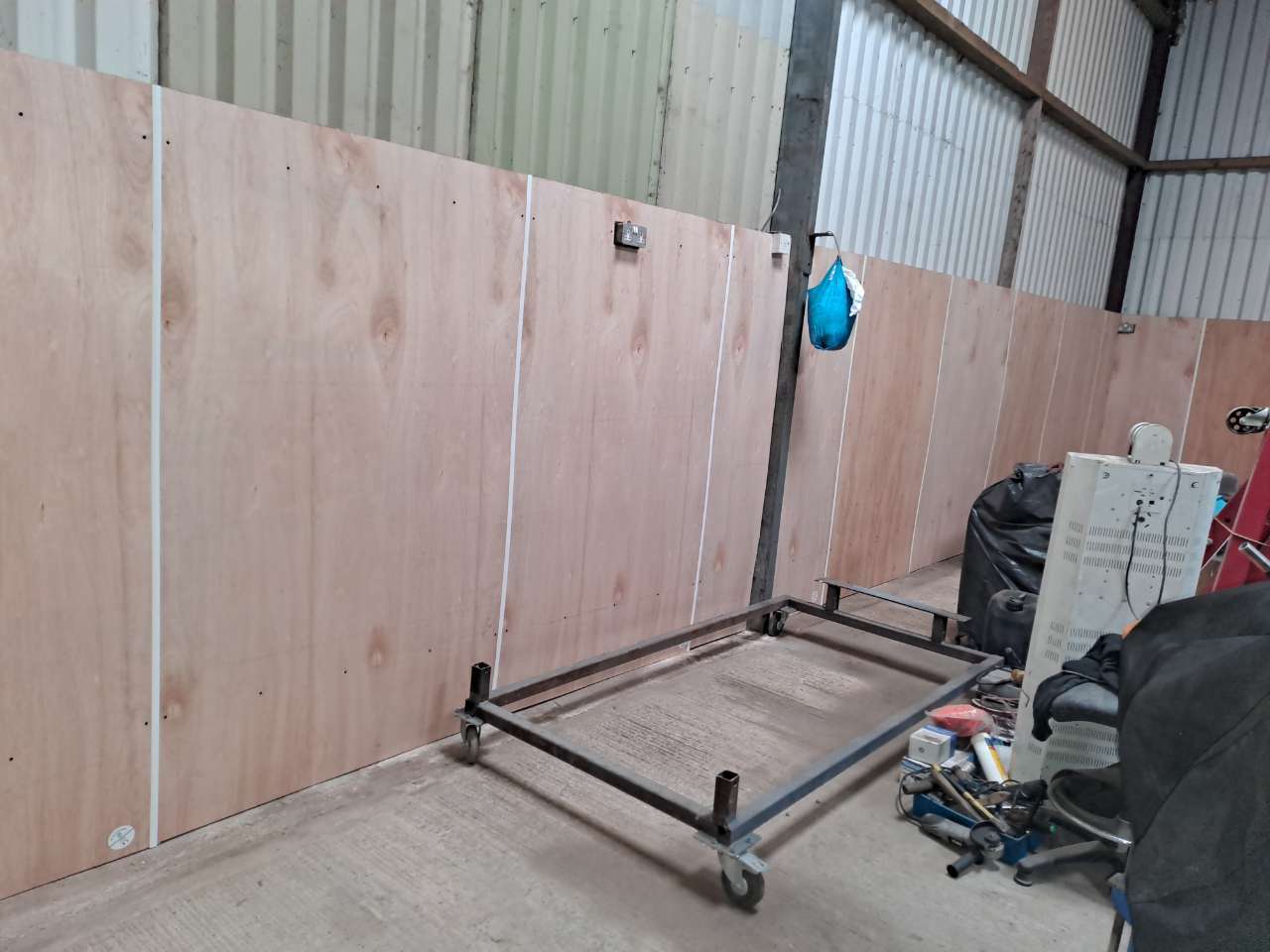

New improved shed almost ready to use now. Panelling installed.
then painted.
shelving put up and loaded.
should get the rest of my tackle arranged and functional tomorrow.  :)
