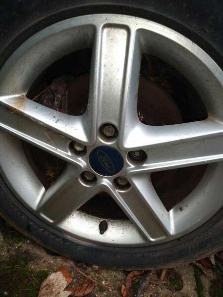

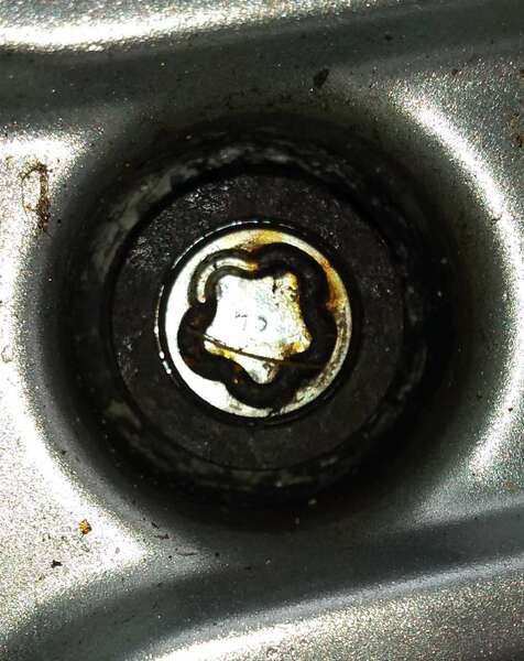

Mcgard locking wheel nuts 😡😡😡😡😡😡 has anyone had the pleasure of trying to remove the ones with the fat spinning collar... Obviously done up full whack by a Kwikfit monkey, signs of at least two of them having broken bits of key in them and on another a mate has wanged a socket on and got it stuck as well 🙄🙄🙄 .All help gratefully appreciated 🙏🙏

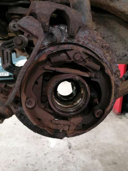

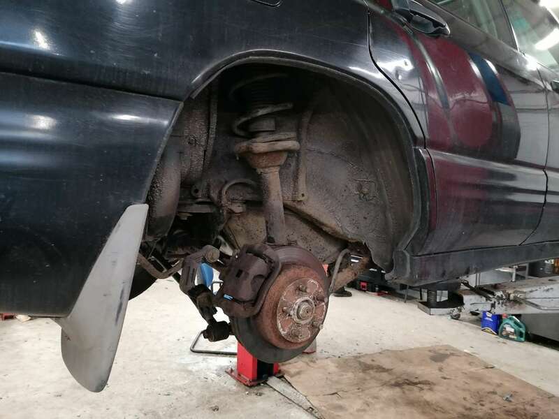

6 sodding hours as the rear d-side bearing was fubar'd.  The caliper carrier bolts were a complete nightmare aamd took most of the afternoon Air chisel eventually got the bearing out.
IMG_20230211_151525.thumb.jpg.6ea549fc6c051d50833860841d5cdbeb.jpgIMG_20230211_163804.thumb.jpg.ea3f332f4a3ac76cf8f4f99af6d149f4.jpg
Now I can hear the other side 🤬That'll be next Saturday taken care of then.....

How thick is the spinning collar? All the ones I've come up against so far I've been able to split the collar with a sharp chisel and then once that's out the way it's business as usual with 12 point socket and a lump hammer.
1403614359_IMG_20230209_1242297722.thumb.jpg.9b91475c570a291adaaccea6577c333b.jpgabout 4mm ishIMG_20230209_124442387.thumb.jpg.78b70e05ff9422d35e2c82fb01cbdd24.jpg
How about getting off the Halfords advanced socket my mate wanged on with a lump hammer 🙄☹️
