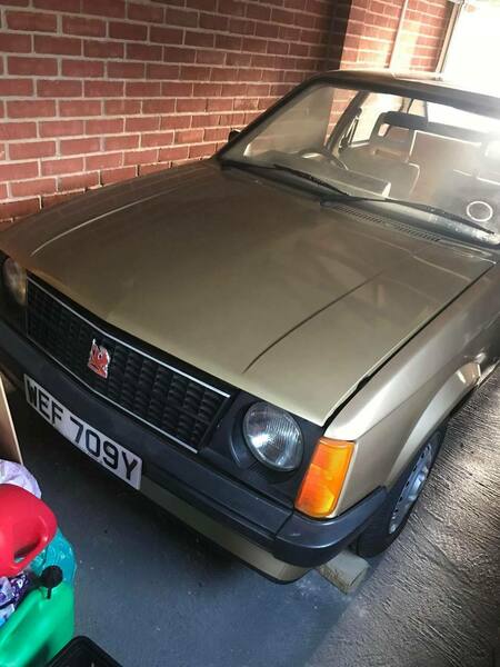

21 hours ago, Dick Longbridge said:

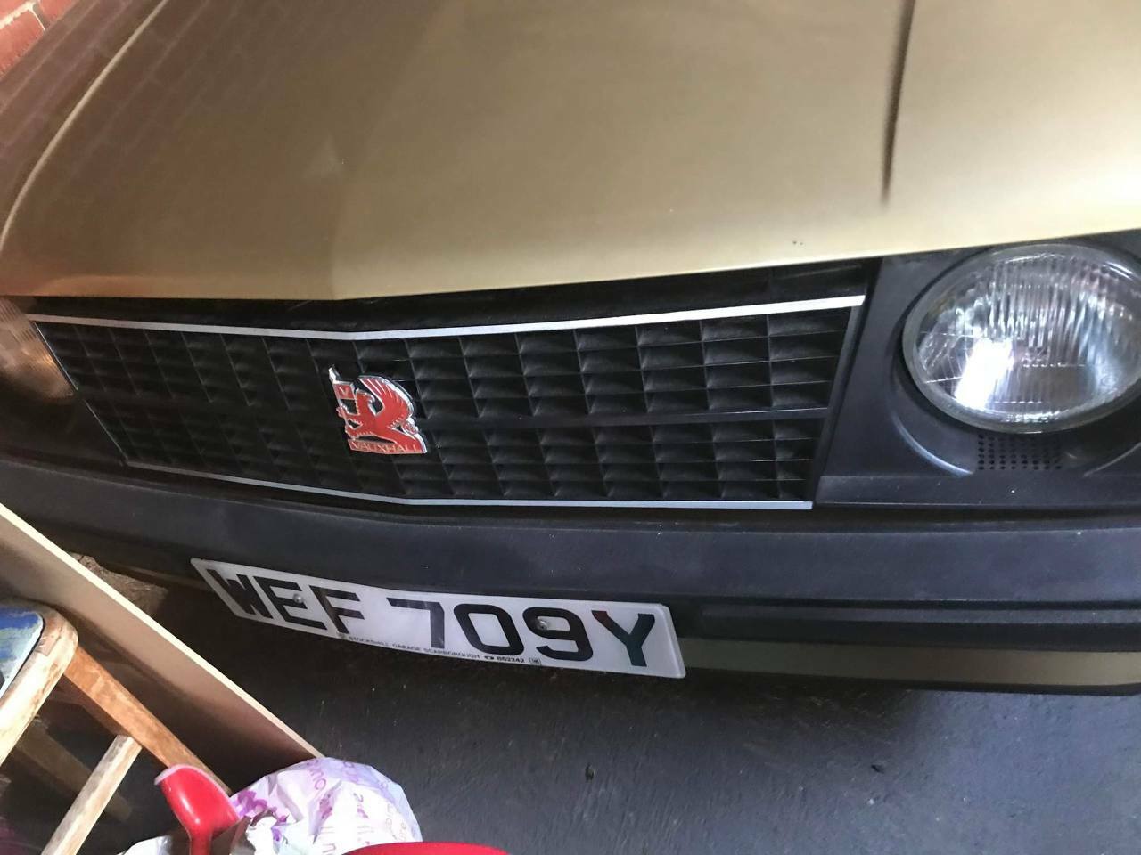

There must be another story with the car being mega early spec yet registered on a Y plate. These were all on a very W plate weren't they?
Neither the saloon body nor the basic round headlight E trim level were part of the very limited Astra range as launched.  Both were added in October 1980, but in late 1982 the saloon was dropped and the E trim level replaced by a base trim badged simply Astra, with the same headlight shape as the rest of the range.
As usual, Vauxpedia is an excellent resource if you can cope with the headache inducing colour scheme:
Vauxpedia - Mark 1 Astra

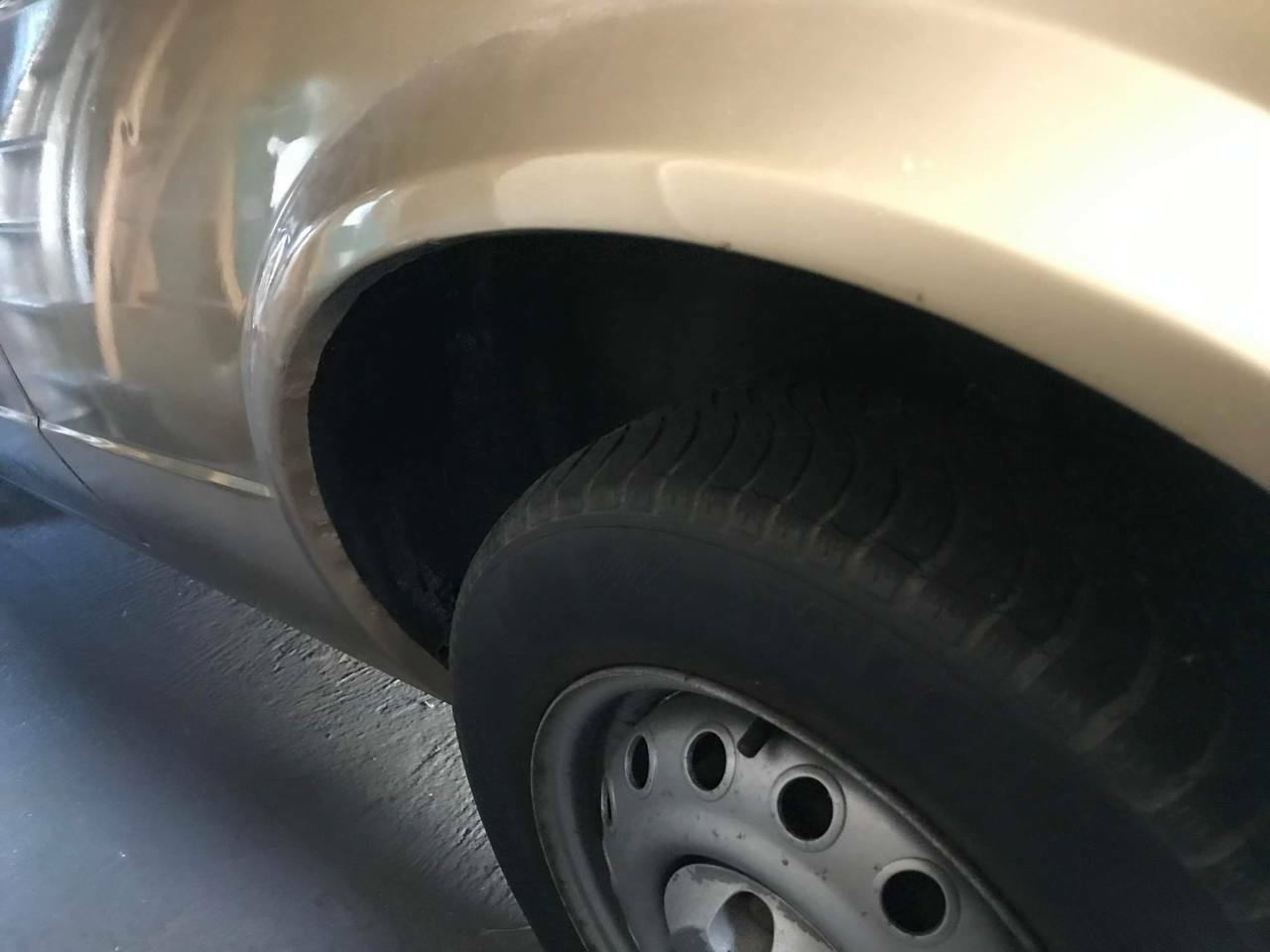

I spent a while on there last night reading up about them, they sound quite miserable with the Viva and presumably Chevette OHV engine but it's a real rarity in that spec.

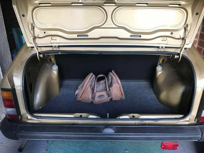

Look at the condition of them arches!
I think the engine in these were based on the German Opel version of the pushed engine, not the Vauxhall one.

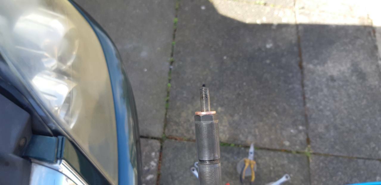

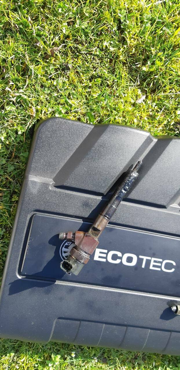

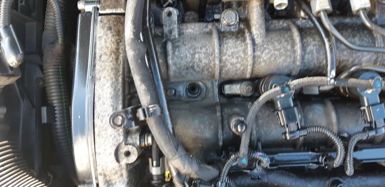

Thought I would attempt to tackle the vectra's leaking injectors. I bought no special tools because if they did'nt come out it's wasted money. I removed the leak off pipes and other clutter and got the water pump pliers out.
It came out with little persuasion. It's minging. Sprayed carb cleaner and left it to soak
Gave the hole a clean. Carb cleaner, rags and various screwdrivers and wood drills turned by hand got rid of the shit.
Injector cleaned and new washer. It went back together ok. This was the worst one - black diesel was going everwhere and making a real mess.
The second injector refused to budge - in fact it began to unscrew so it was put back. I retightened the clamp - the leak on this is minimal - tiny bubbles around the base of the injector. It will get worse - someone else will own it by then or it will be bean cans.
I call this one a win.

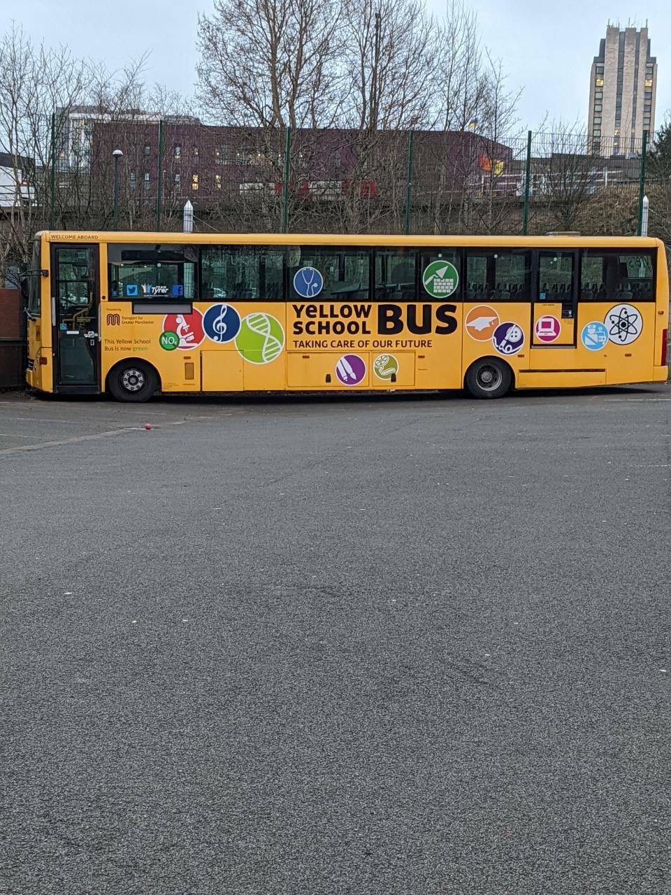

Been tasked with trying to find someone willing enough to scrap this heap
Apparently it was gifted to the trust I work for, but being parked for 2 years, neglect and vandals mean it's utterly fubar.
Its brakes are seized, the batteries are flat and scrotes have smashed the dash and it's based on an Iveco for bonus will it start points.

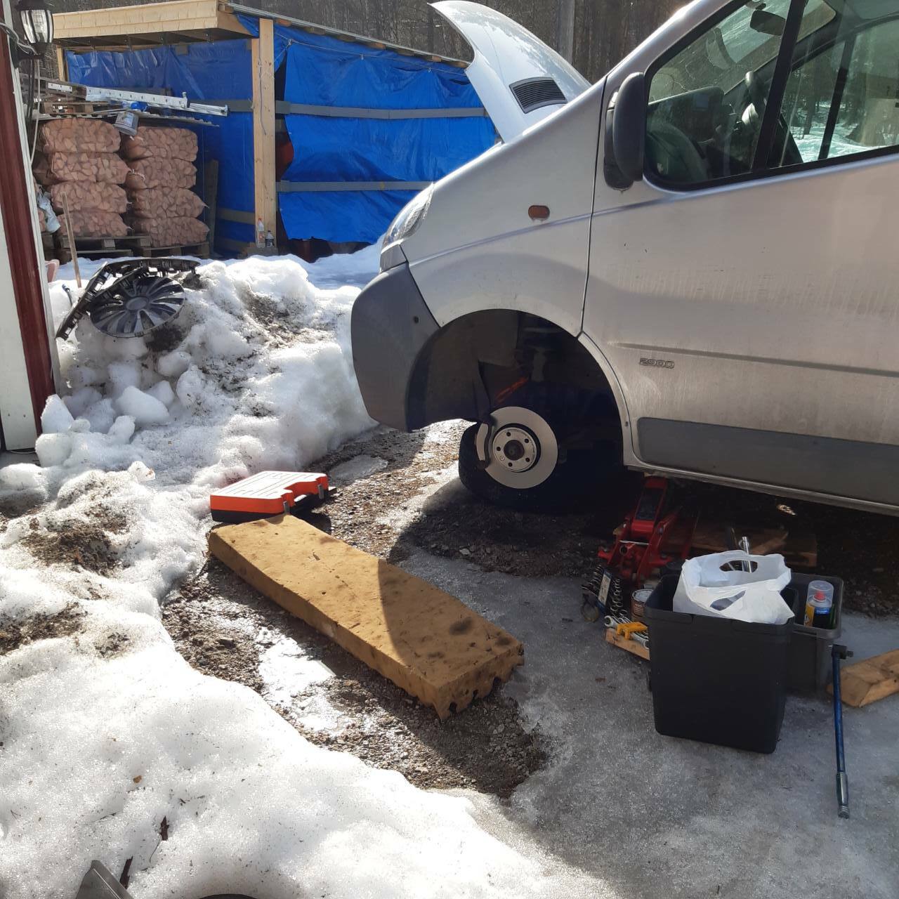

I'm still working on the Vivaro and will be done soon. But I had thought and hoped I was done with working on vehicles outdoors in winter/early spring and in the snow.

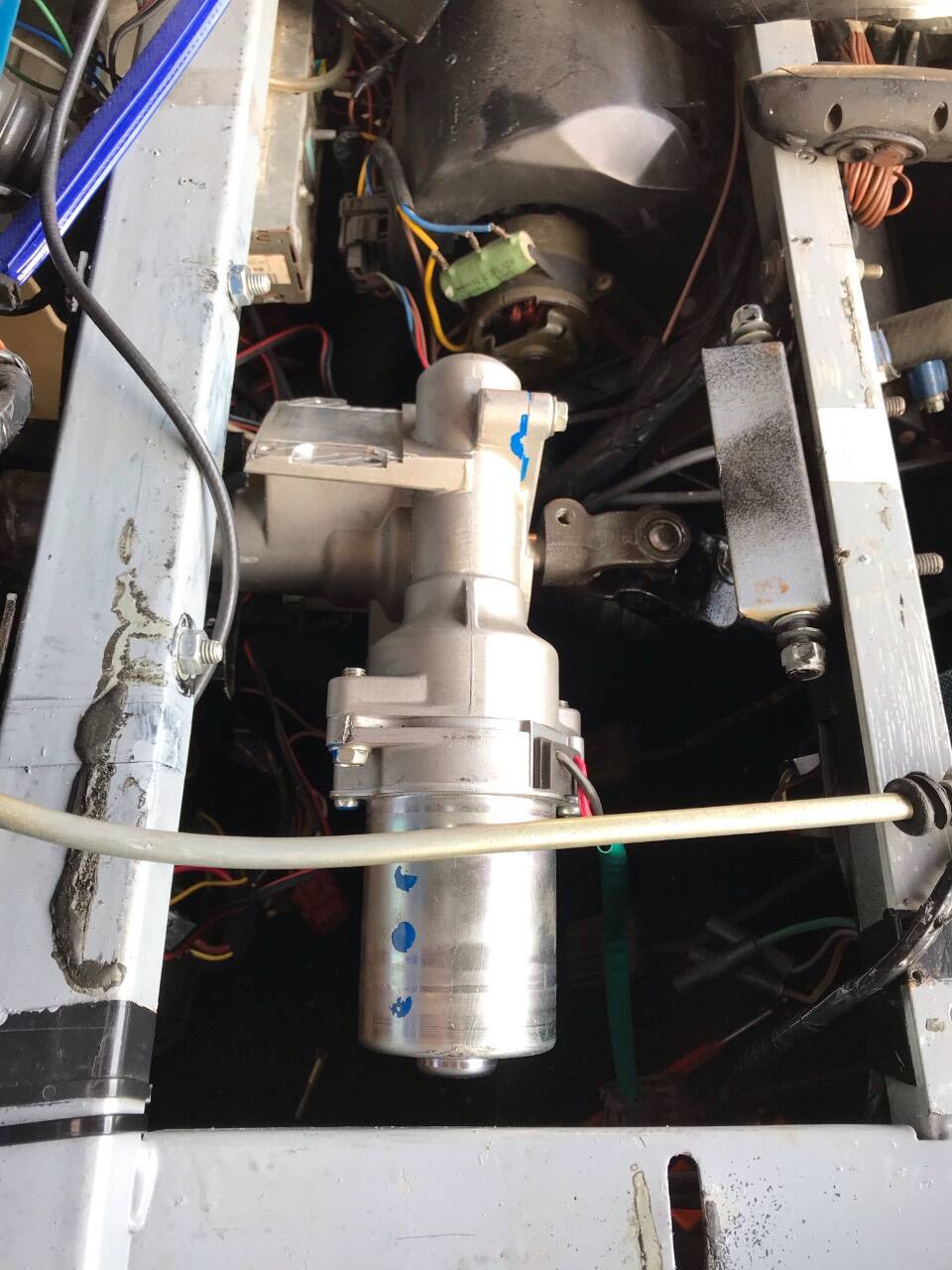

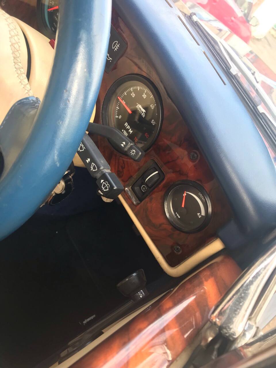

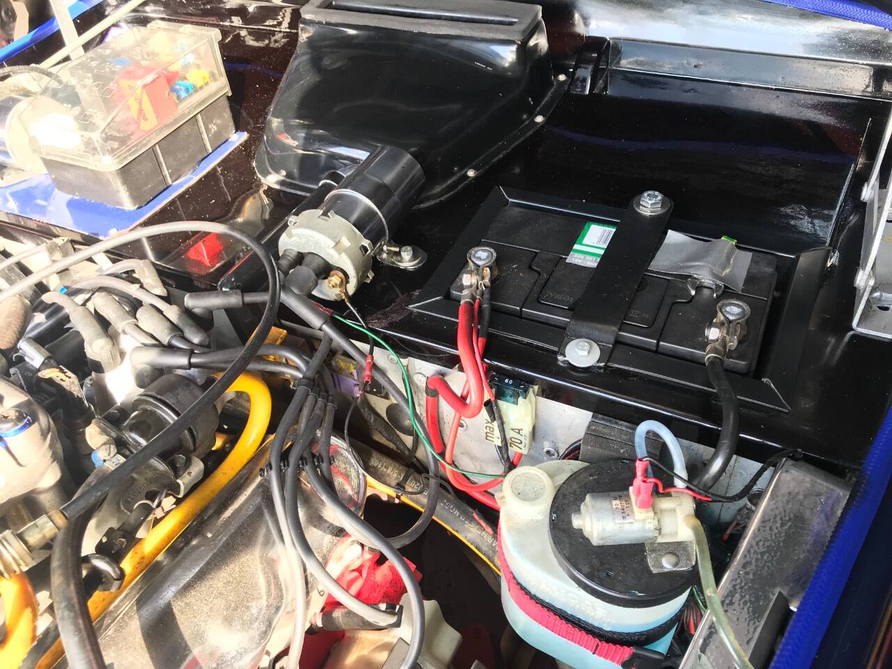

Finished off a power steering conversion using Suzuki Alto components, on a Panther Kallista over the weekend. Makes such a difference to the low speed manoeuvrability but assistance needs winding off at higher road speeds. Quite pleased with the outcome.

My mechanic friend fitted one to a 1953 Citroen traction BN some years ago. Not sure what car it came off, but made parking easier.

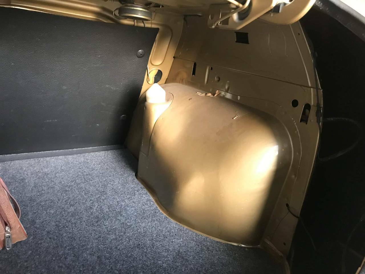

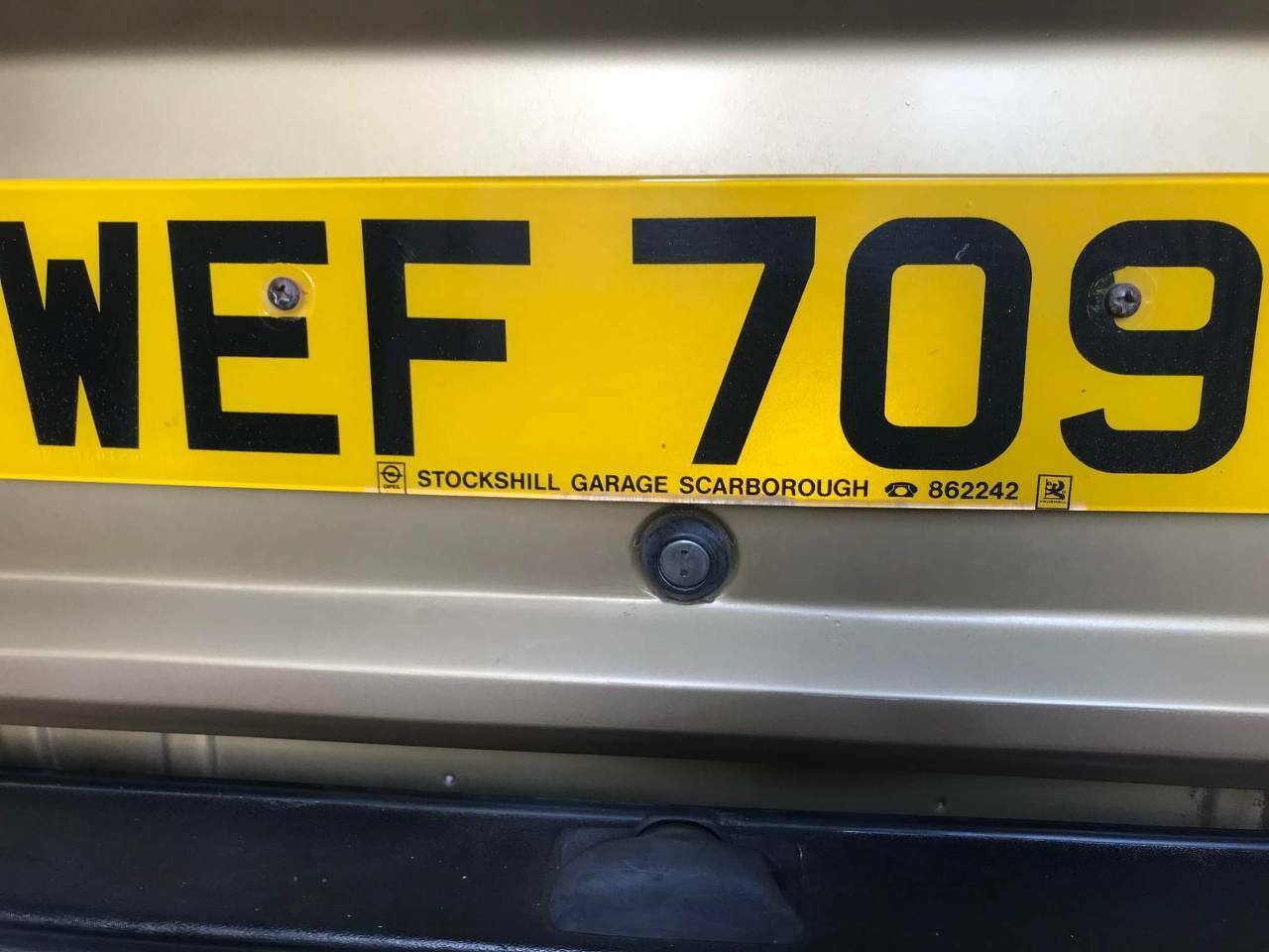

I've been offered a car today, apparently a 1 owner from new, he won it on holiday in 1982 in Scarborough whist staying at a hotel, he's owned it ever since but is now 81 and is too scared to drive it  but I must say the body work is mint. I'm not sure what it's worth or if I really have room for it? .
That is truly glorious.  This model is to Vauxhall what grey grilles are to Sierras. I loved spotting this variant as a lad when they were current. They weren't even that common back then though. I do recall them most frequently being seen in either being in solid yellow, red or terracotta so this nice metallic colour is a treat.
