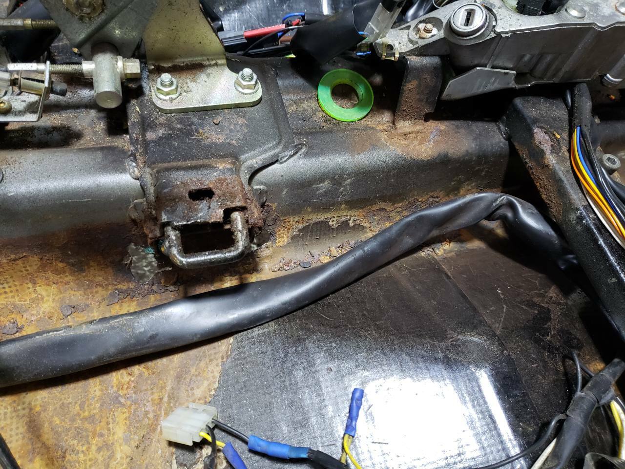

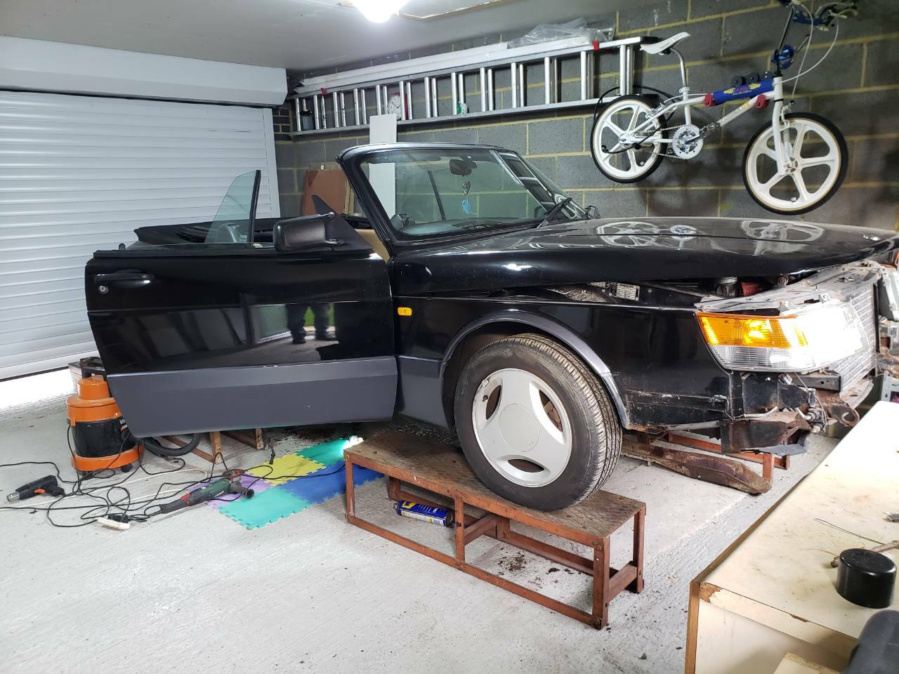

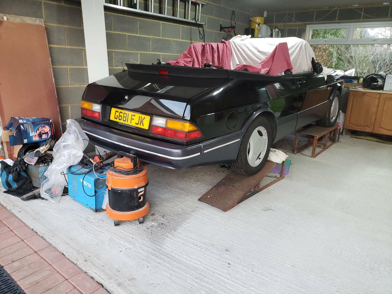

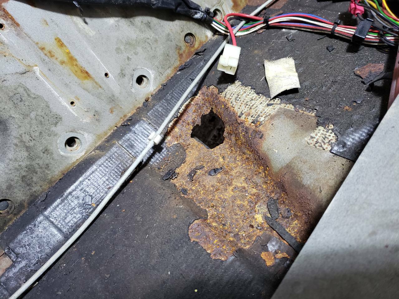

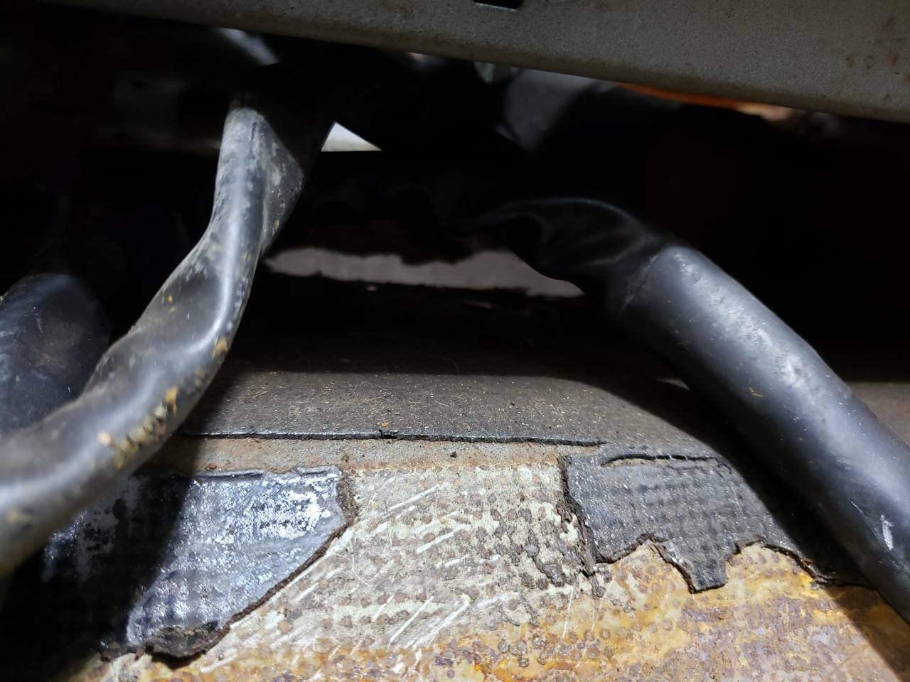

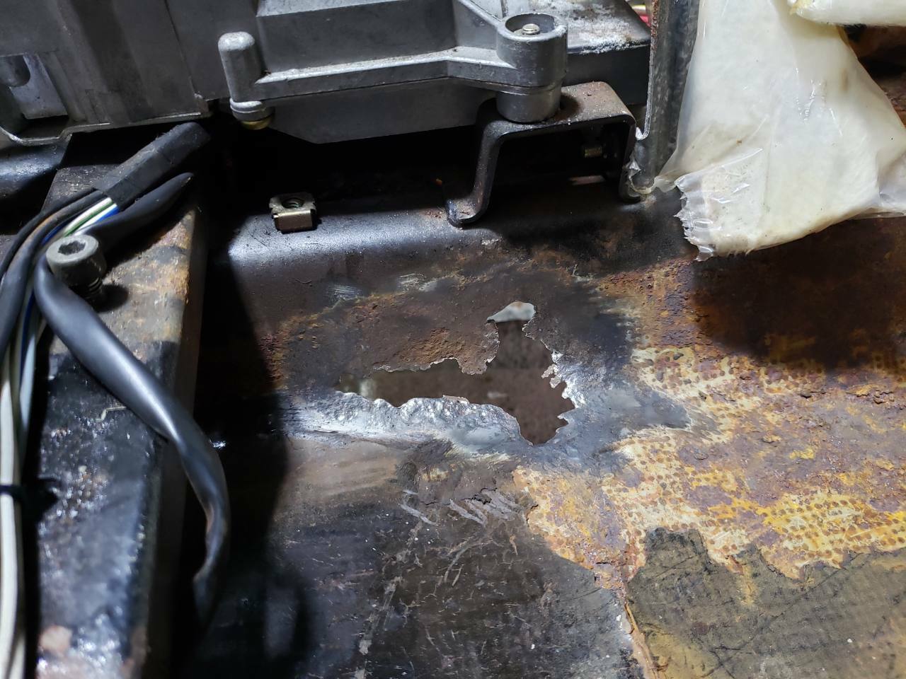

Today's victim is this Saaab 900 turbo cab my mate has just bought. Looks alright but has a few crusty bits
20220128_135056.thumb.jpg.e448d9a46a33e423f6f01f91aa66d2d8.jpg20220128_162005.thumb.jpg.8e6202f8dc6660b9dcbabe414ea5d680.jpg20220128_135102.thumb.jpg.32b93cfeb05ed41f3944ccce3d441480.jpg20220128_133045.thumb.jpg.d5ad13d72ff3380063146fdc4eeb6b4f.jpg20220128_133033.thumb.jpg.51ffc43b87eec52a1da9b0be8ff16780.jpg
Akwardish bit under the rear seat brace thingy
Attacked it with the grinder
I did a bit of CAD, cut out a lovely patch and started tacking it in - then it just kept blowing holes. Don't really understand why as I cleaned up both sides and there didn't seem to be any pitting. So it needs grinding back and any holes plugging, quite annoying really. At least all of the holes seem to be in fairly convenient places to repair

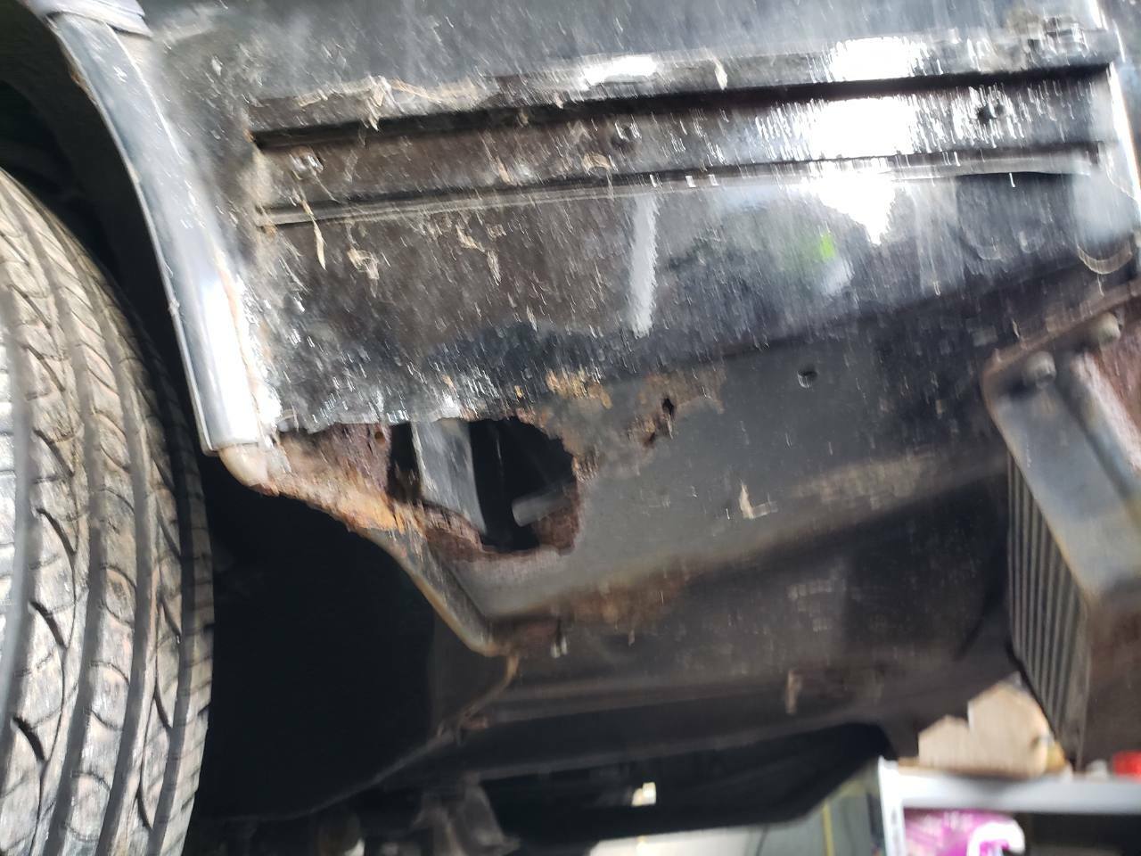

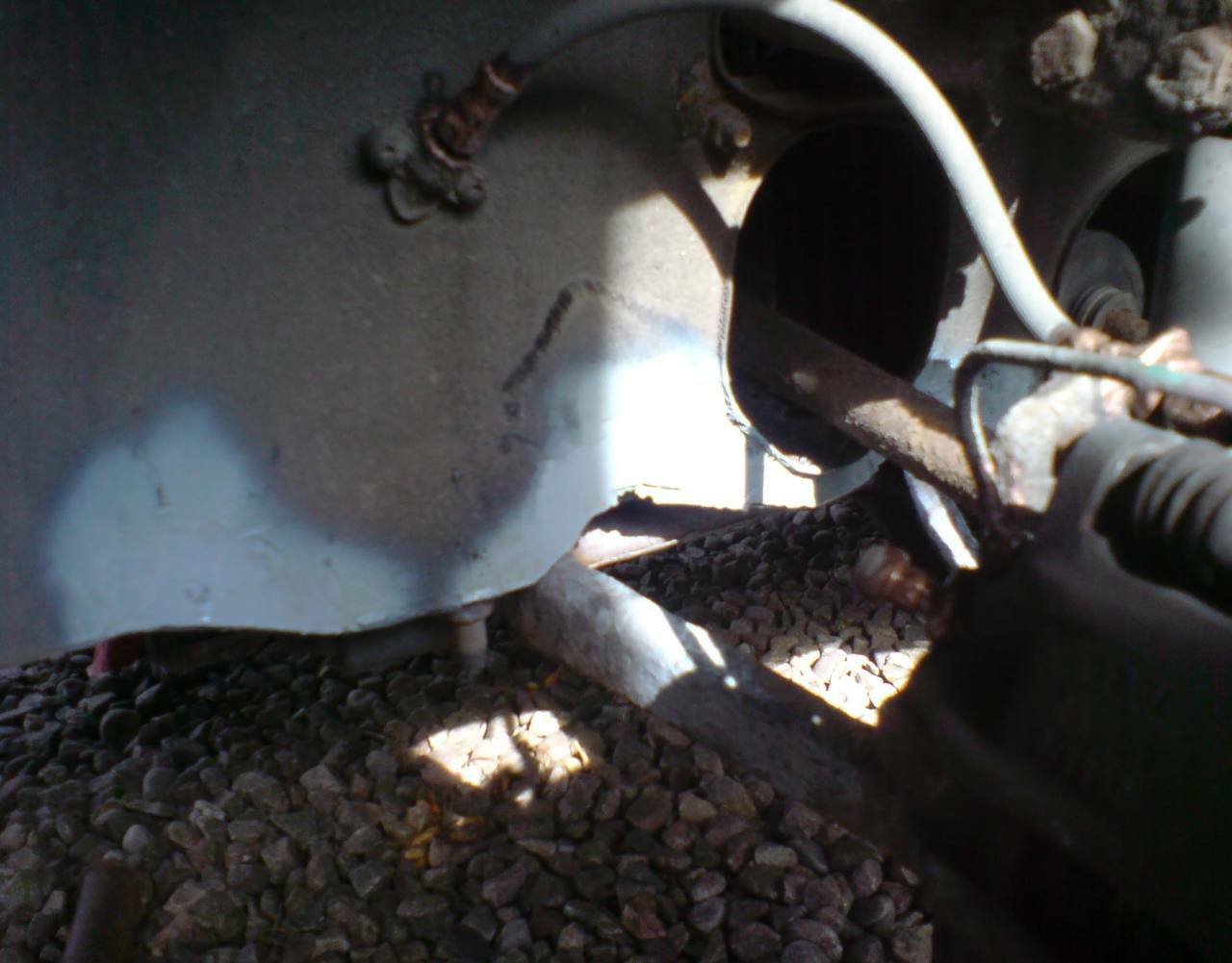

Have you done a really thorough check of the front chassis rails around where the driveshafts pass through?  They're buggers for rotting there and it's quite an involved repair to do because of the amount of stuff that needs to come off.
No - I don't know a lot about them so useful info. Was busy scratching my head over the backwards engine and chain drive gearbox. It seems pretty solid other than where water must have sat under the carpets on the offside causing those holes. All easy to point the welder and grinder at thankfully
Basically this whole area.
It fills up with silt, grit and general crap and the rots from the inside out.  By the time you can see it it's already too late.  Being something that only gets poked from underneath by the MOT tester once a year, by the time you hear the crunch it's already pretty far gone.
Repair sections do exist I believe, but to do it properly the whole lower suspension arm, track rod and driveshaft have to come off.
To be honest I'd say it's the only really *bad* rot trap on the classic 900 though.  It has a few like any car of the era, but this is the one which has the potential to write an otherwise spotless car off completely out the blue.  It's difficult to get a really good look at without removing the wheel too, so is easy to miss even if you're trying to be careful.

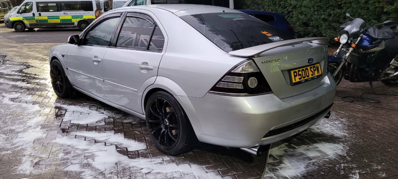

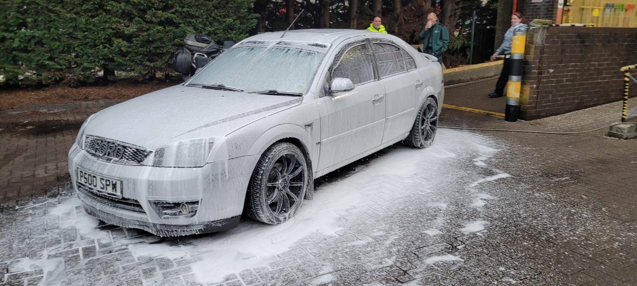

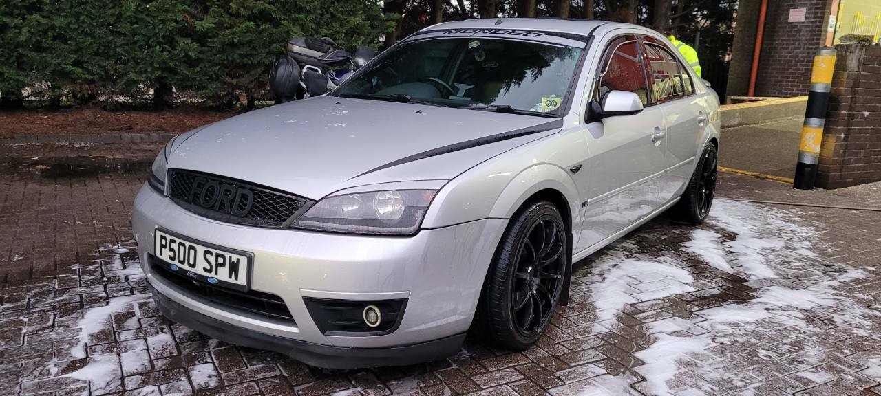

Everyone at work raves on about snow foaming cars and ambulances, I joked well u can do mine... so she said OK... alright here's the keys have fun...
Is it a viable thing to splash out on? Any one else use it?
Yeah I have one it's just an attachment that fits on to the lance of my jet wash, this was a weak mix.
