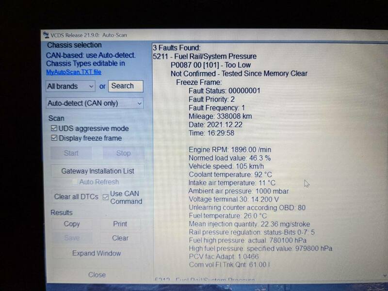

Phone call from Mrs SiC.
"Glow plug light is flashing on the Audi A4, what should I do?"
If still working and no other warnings, drive on I said.
*2 minutes later*
"It's cut out and won't restart"
Recovery called. 60-90mins.
It's making a decent tailback on the M5 J20 exit. 🙈
You bloody tempted fate @Kiltox 🤣
Could well be terminal.
Highways agency have arrived. They couldn't figure how to get the handbrake to unlock 🤣
Talked them through it and they've pushed it to the side. Told them to leave it in gear with handbrake off. It's just had a pair of £280 new tyres on the back, so the last thing I want is it being dragged on its arse because the battery has got too flat 😬
*2 minutes later*
Could well be ternimal.
Broken VAG? Bugger!

Doesn't look good. Actual Vs demand dropping significantly between the three error codes logged.
  • Sad 4
Fuel rail clearly not building up pressure when cranking.
Next steps would be to do a leak off test on the injectors but I'm not sure if I want to get that involved with this. To add insult to injury, the Moggie is pretty much ready to go for a drive now but the A4 fat arse is blocking it in.

1 hour ago, SiC said:
Fuel rail clearly not building up pressure when cranking…
High Pressure Fuel Pump possibly? Worth a Google and Youtube search. Expensive but probably diy-able for someone with your know-how, I’d have thought.
…that’s if the car is a keeper of course. It has served you well.
Almost certainly yeah. It's going to be either that or the injectors really. Fuel pressure regulator unlikely as that was changed 70k ago. Also would have expected those 3 freeze frame codes to show it not dieing off like that.
Should pull the filter and cut it open really.
I guess could also be an injector leaking but I haven't noticed a lot of regens recently. Leak off test will confirm or deny that likely.
If HPFP then probably should have injectors as well if it's disintegrating internally.
Car take back say £675. In my mind that's the budget to fix. So if it sharts itself again soon after, at least I can get a recent expenditure covered.
It's just when do you call it quits? At least this is a major enough sharting that it's a fairly easy decision. But then given I don't have much to loose, I could DIY it.
Either way I think Mrs SiC will be getting a new car. Then if I get the A4 working, I'll sell the Fabia and use the A4 as the runaround.
Will phone my garage tomorrow to discuss potential options with them and what they'd be prepared to do too.

I'd go more with the pump. If it was reading over its more likely to be the sensor. Given its reading low, I'd expect the demand from the pump to increase and thus over fueling rather than under. You can see it in the video where the pump eventually builds up enough and then coughs as it drops back down again. Admittedly a sensor is a cheap and easy part to change.

That's pretty much the next plan is to contact my local garage and see what they say. Second hand HPFP aren't £50 unfortunately - more £200-400. There is a HPFP and 4 injectors going on eBay for £400 at the moment. No idea on labour time, but say ~4hrs (iirc cambelt change time) then £200 at £50. All in would be £600. For that sort of money it'd be worth a punt.
Thing is, as you probably well understand, Mrs SiC isn't keen on a car that has blotted its copybook like this. So either way she will want something to replace it. But for £600, I'd sell the Fabia and use the A4 as a run-around instead. Replacing her car will allow us to get something that is Bristol Clean Air Zone compliant too.
We knew this day was coming and we knew it was effectively on borrowed time given the mileage. I'm most surprised how it went from flashing coil warning light but no messages on the screen (unusual for German and VAG!) to zilch in literally 2 minutes of driving and no untoward noises. You can see it in that freeze frame data where at 1630 the code first triggered (and Mrs SiC contacted me) with a low pressure, to 2 minutes later the pressure dropping even more significantly (when Mrs SiC re-contacted me to say its died).

@SiC there is a really informative video about VAG tdis with the p0087 fault you described.
Definitely worth a look.
Interesting video, thanks. I knew a lot of it already but good to have a reminder with everything in one place and also a few numbers to test against.
I've just been out to run the pick up tank pump and the aux pump with VCDS. I can hear both running and running smooth which is a good sign they're working. Of course doesn't tell me if they're producing enough pressure though. But fuel should be getting up there at least.
I think the next step will be to take off the fuel metering valve and inspect for any metal particles. That'll be the smoking gun if it is the pump. Unfortunately he also mentions that is a common fault diagnosis!
Also want to do a leak test on the injectors. Interesting that you can also do it with a vacuum pump too. Might dig that out and give that a go too.
