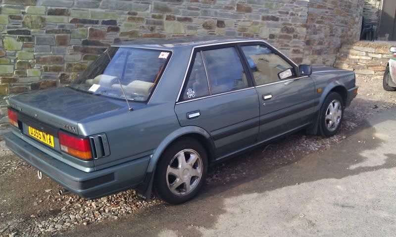

Here it is, cleanest it's ever been and doing a good job at hiding it's rust at Brooklands last March :) It's a 2.0 GSi automatic and needs a bit of tlc after serving me well over the last 18 months with minimal amounts of maintenance bar servicing, up until a recent mis-fire saga that is....
My original idea was to run it cheap and then throw it away after a few years, but seeing as I like driving it so much I'm tempted to throw a few quid at it later in the year to sort the rear arches and other bits of grot.

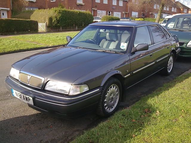

One day I'll probably upgrade to executive class and get an 800 (an early Sterling with duo-tone paint is my ideal), but don't think I've deep enough pockets at the moment to run one!

My old Sterling, got an identical one now, they were once pictured together, I own the one of the left now:
My old one has been scrapped as its engine imploded due to some serious bodging to the coolant system by one of the last owners, plus the body was getting worse by the day. I took a shed load of parts off it though.
