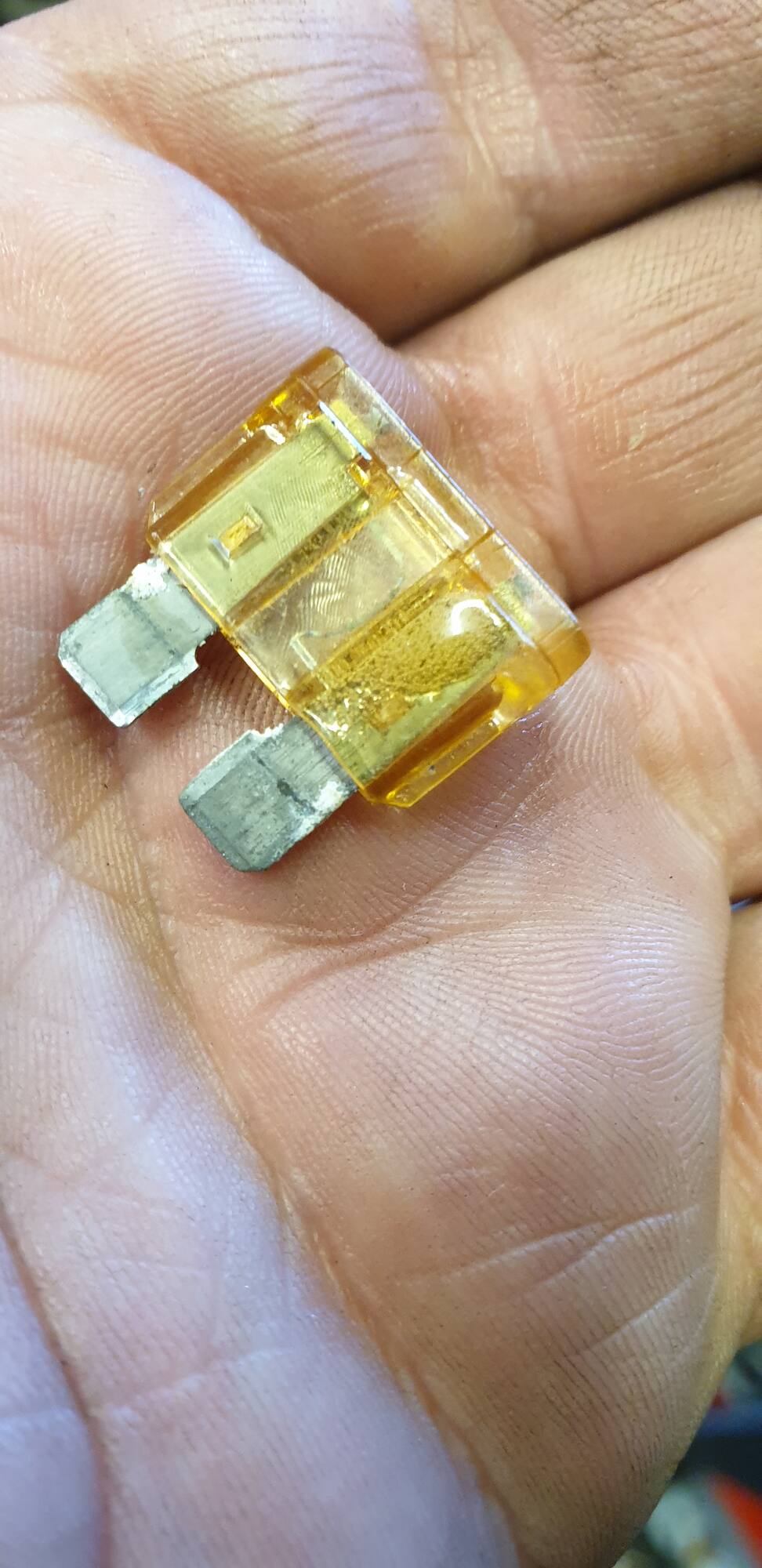

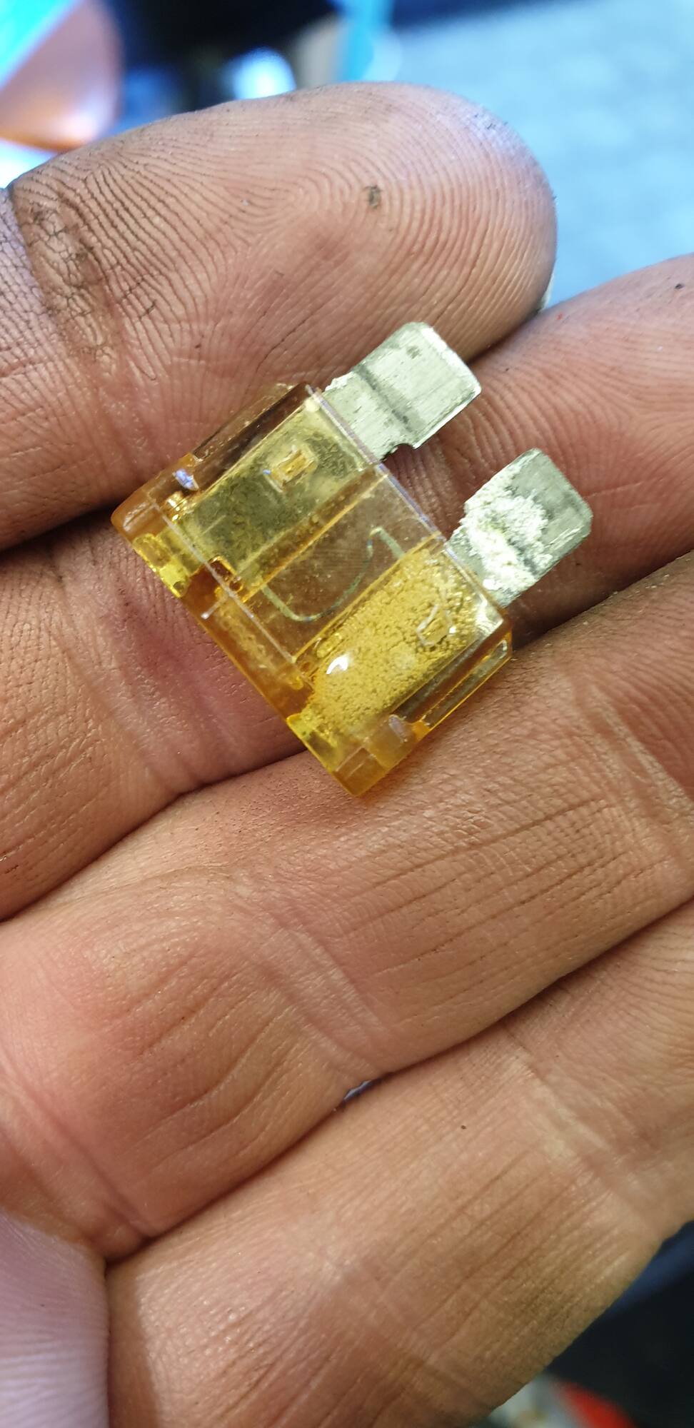

Thought I'd play scooter too.. reassembled... new battery.. nothing... fuse corroded inc holder, and pins on relay, also battery leads all cleaned up, thought I know I wont use starter I'll kick start it, lever solid, hmmm whip up spark plug wet and oily, thought I know id kick it over with plug make sure not seized,( i did used to always kick start it as regularly to stop seizing) well it moved freely and oil poured out spark plug hole, must've be oil locking, back I pop in spark plug and it's still doing it, next wonder if exhaust blocked, undid nuts, stood up and knee went snap, struggled indoors, almost tripped on the cat, taken drugs now laying on sofa in agony and stinking headache... bloody scooter hates me...enough for today

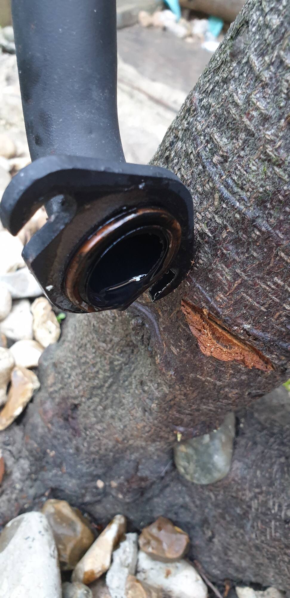

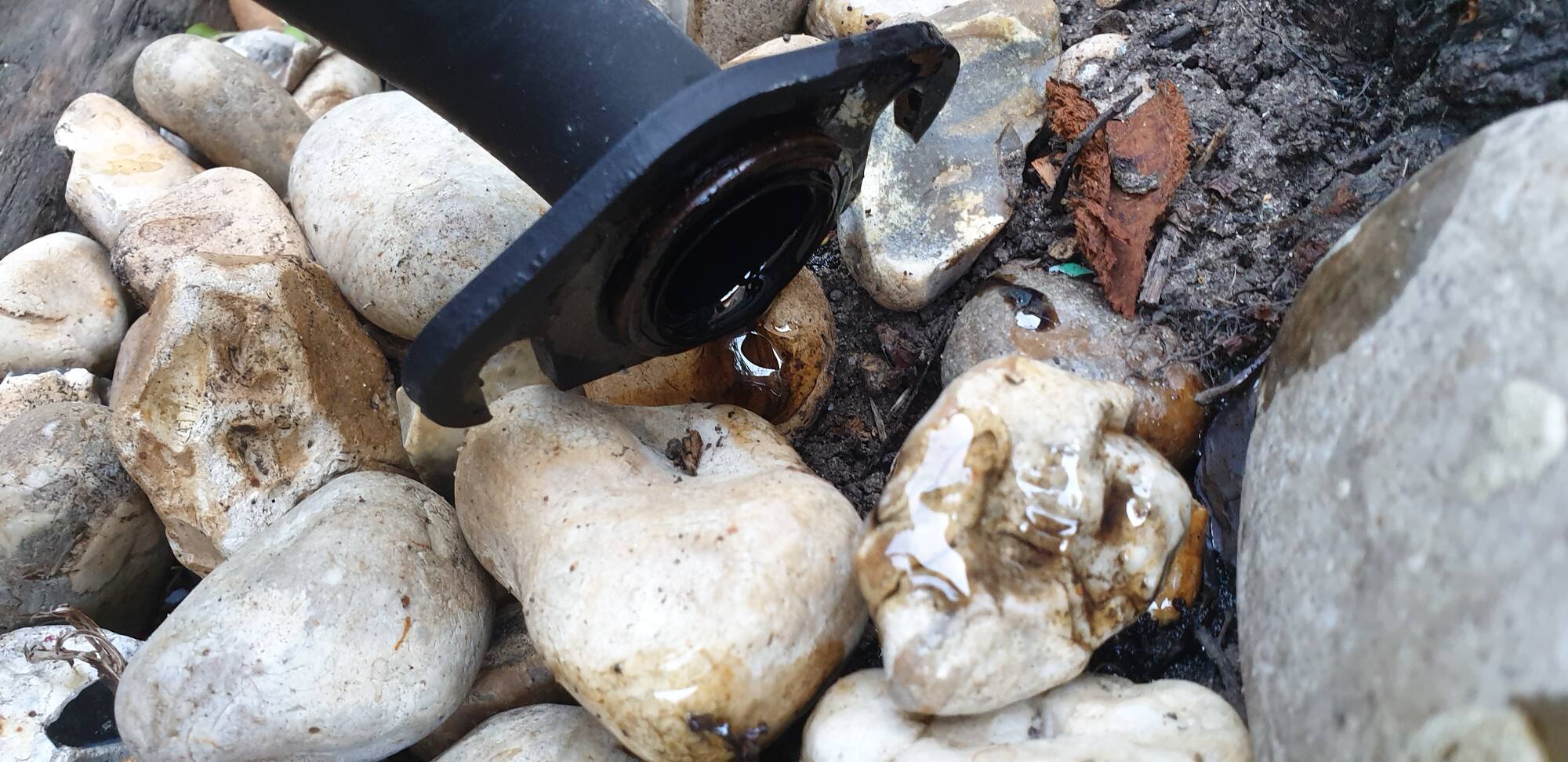

#quick rest on the sofa I went out removed the exhaust and was quite lot oil in it, but still wont turn over with spark plug fitted but will turn over minus the spark plug, any suggestions???
@stuboy that's well flooded if it's pouring out the plug hole ! . Is it a two stroke ?Has it got a fuel tap? Don't leave it on pri if it has , on or res only . Take the plug out and keep kicking it to clear the fuel if it's a 2 stroke .

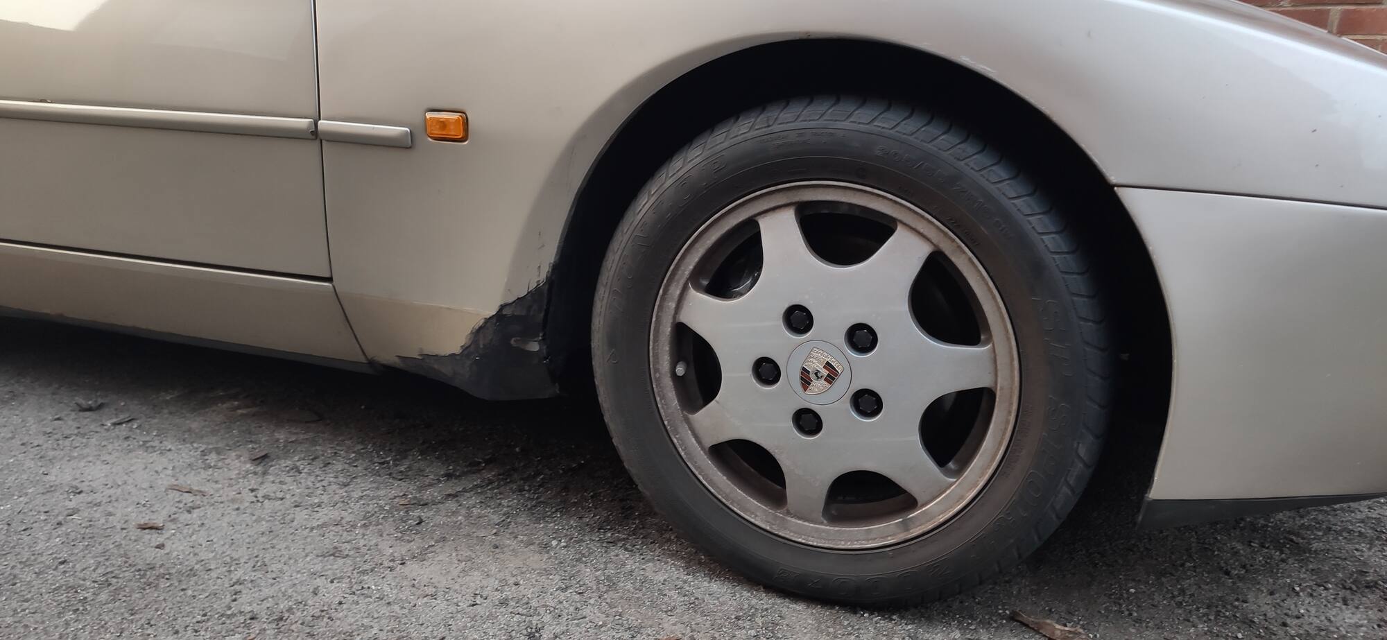

Legacy is playing silly buggers running out of electric and stalling at junctions. Going to look at it properly tomorrow. However, on the assumption that it might not be working for a little bit I decided to put the 944 back together today as the Legacy was my only working car.
Wing looks okay, nowt a bit of filler can't sort out and defo better than it was before.

2 stroke yes, but why it locking up compression when spark plug in but remove it it fire out with both kick and electric starter??
@stuboy when they fill up with fuel the crankcase fills up also on a 2stroke , with the plug in its scooping up more fuel from the crankcase and hydro locking . Has it got a fuel tap ? If it's a on demand tap (vacum) type it might be stuck open filling the crankcase with fuel . Clamp the petrol pipe or tap off , plug out , full throttle and kick it over 20/30 times or crank on the starter . It's the fuel tap and or the float valve in the carb in my experience. I have been wrong before though ! . But the excess fuel is causing the lock up hopefully.

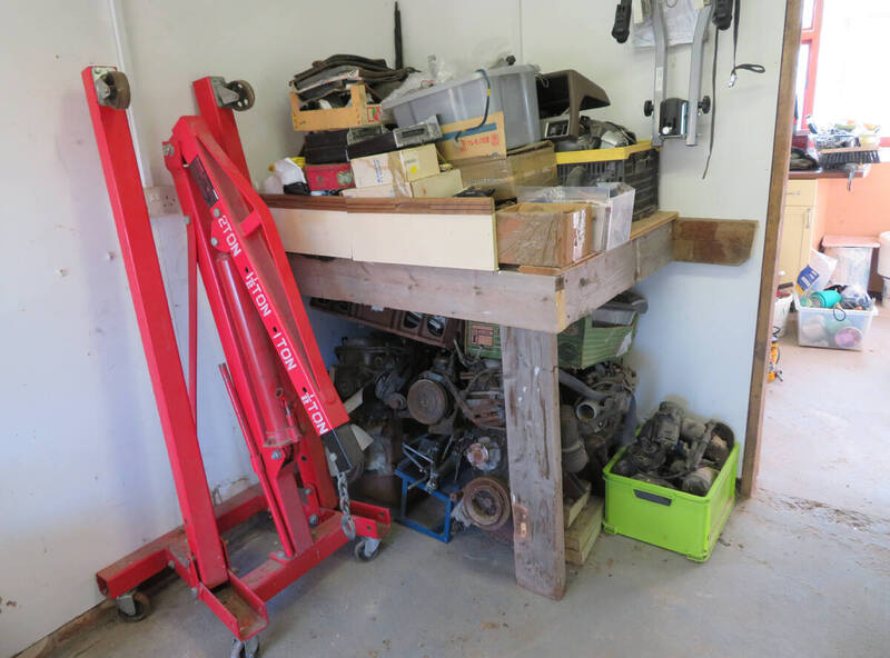

Sunny Saturday skip filling lockdown activity resulted in this, with assistance from the kids:
The two Skyline 240K engines (same basic straight-six lump as in my Laurel) have been sat there for a while, but buried under bags of kindling, old carpet and assorted dead domestic rammle. The other boxes of car parts were scattered elsewhere and getting in the way.
Knocked-up a rather crude timber frame and top with various old cast-off bits of timber I'd got, does the job nicely. The effect is now sullied slightly by the return of the kindling, but I need that more than I do the engines.
The engine crane is with me on what appears to be a permanent loan, from someone who hasn't got room to store it himself.

seems only to be oil in exhaust
@stuboy ....Oil? Interesting .... Most of the auto scooters I know don't run gear oil , the variomatic belt runs on the end of the crankshaft and run dry . It might have a small transfer case with oil in it , the crank seal might be leaking .
has it got a autolube tank ? Is that empty ? .

yes autolube and no
peugeout looxor 50cc
Is it the right plug? A long reach plug in a engine needing a standard or short reach plug may well contact the piston and stop it turning over.

@stuboy well I'm at a loss then . I can't find a manual for it . Was going to check if it had a transfer case with oil in it / filler plug /level screw / drain plug . If it hasn't got oil in a gear / transfer case the only oil going near the engine is 2stroke oil ? . I'm puzzled now . If you know of online manual post up a link . I will keep looking . What year is it ?
