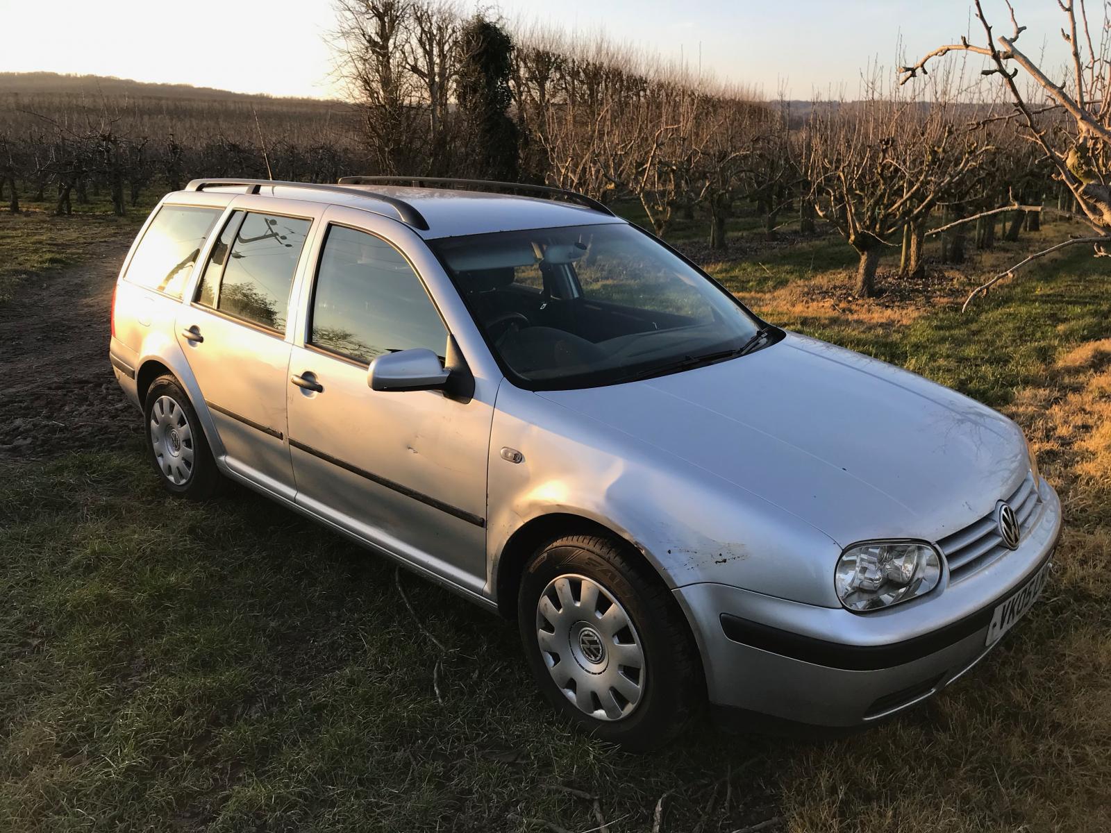

Got the Golf back.  Just over £1K from the garage for the flywheel, clutch and slave cylinder.  Plus CV boots and they tightened my handbrake (which they just did.  It was on my list of things to do anyway).
They showed me the old flywheel.  Fuck me.  Utterly shagged.  Being a DMF, it's supposed to have two reciprocating masses, right?  Wrong.  It had seized, twisted over the stubs that hold it together and was operating as one, massively unbalanced mass.  Words cannot described how fucked it was.
Car drives nicely now.  And there's no rattling.
