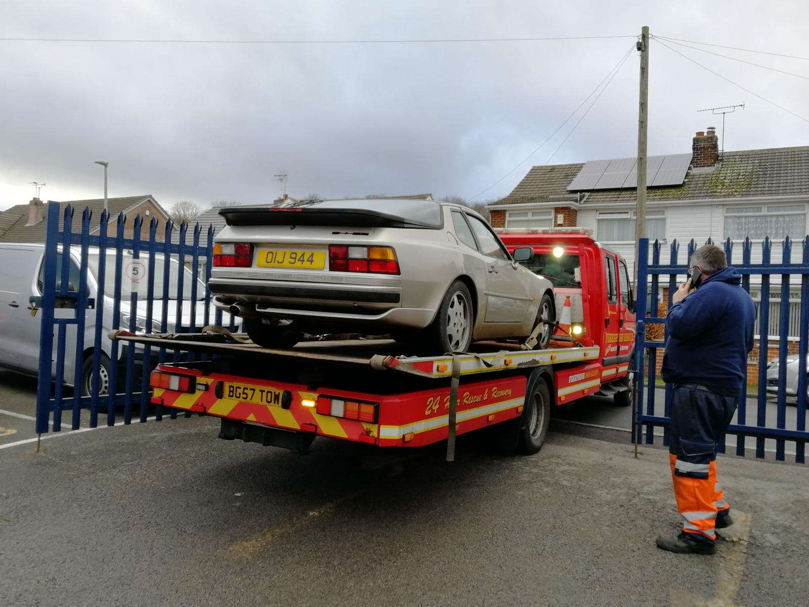

Broken down at a car dealers in Dewsbury.
Think its the immobiliser.
Bloke from Yorkshire Rescue came out, thought it was the battery and dragged it back to his yard.
Turns out the positive had come off the starter motor.
All sorted.

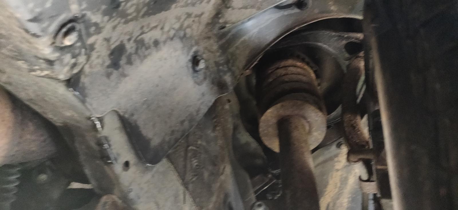

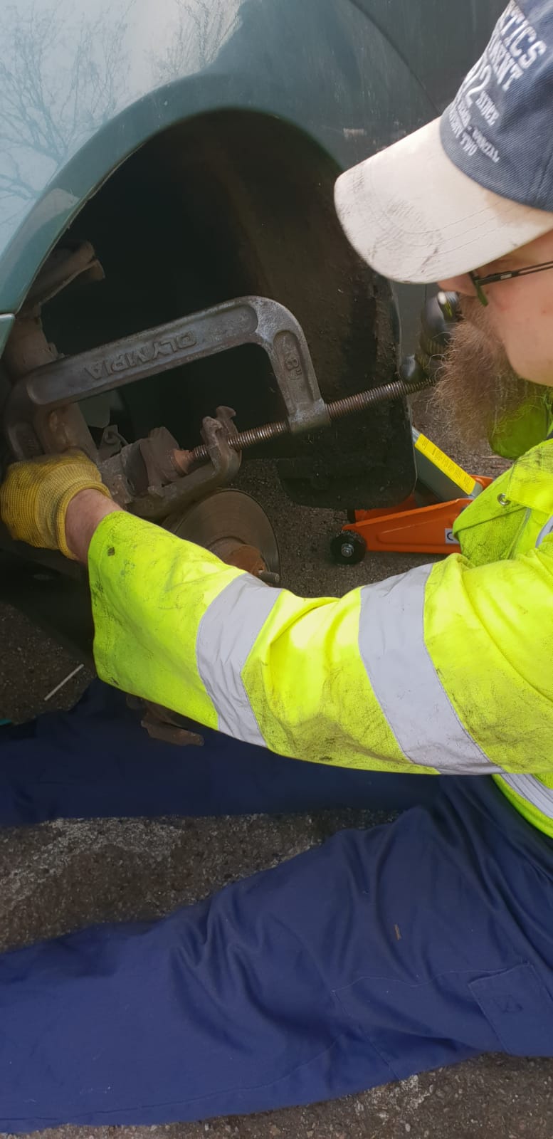

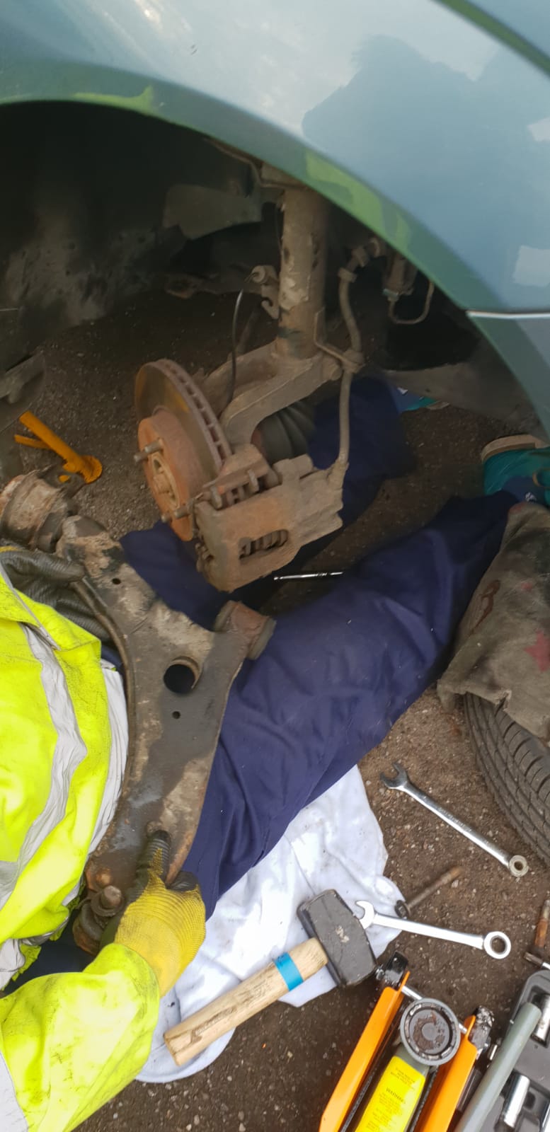

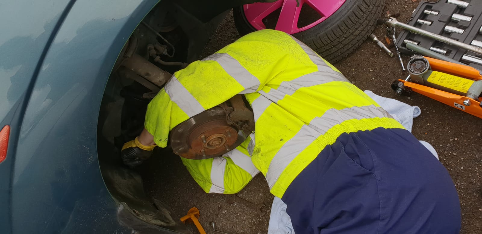

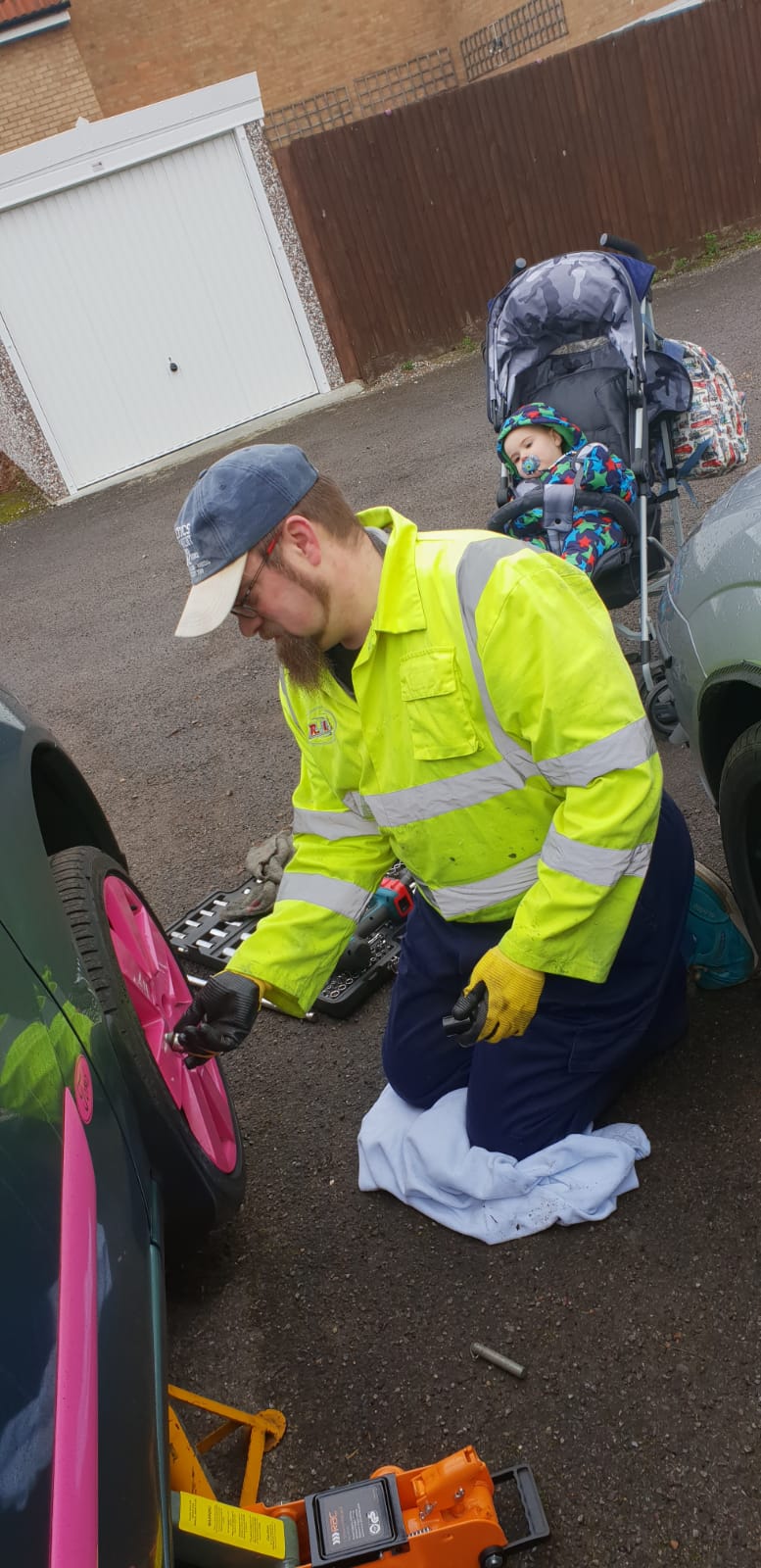

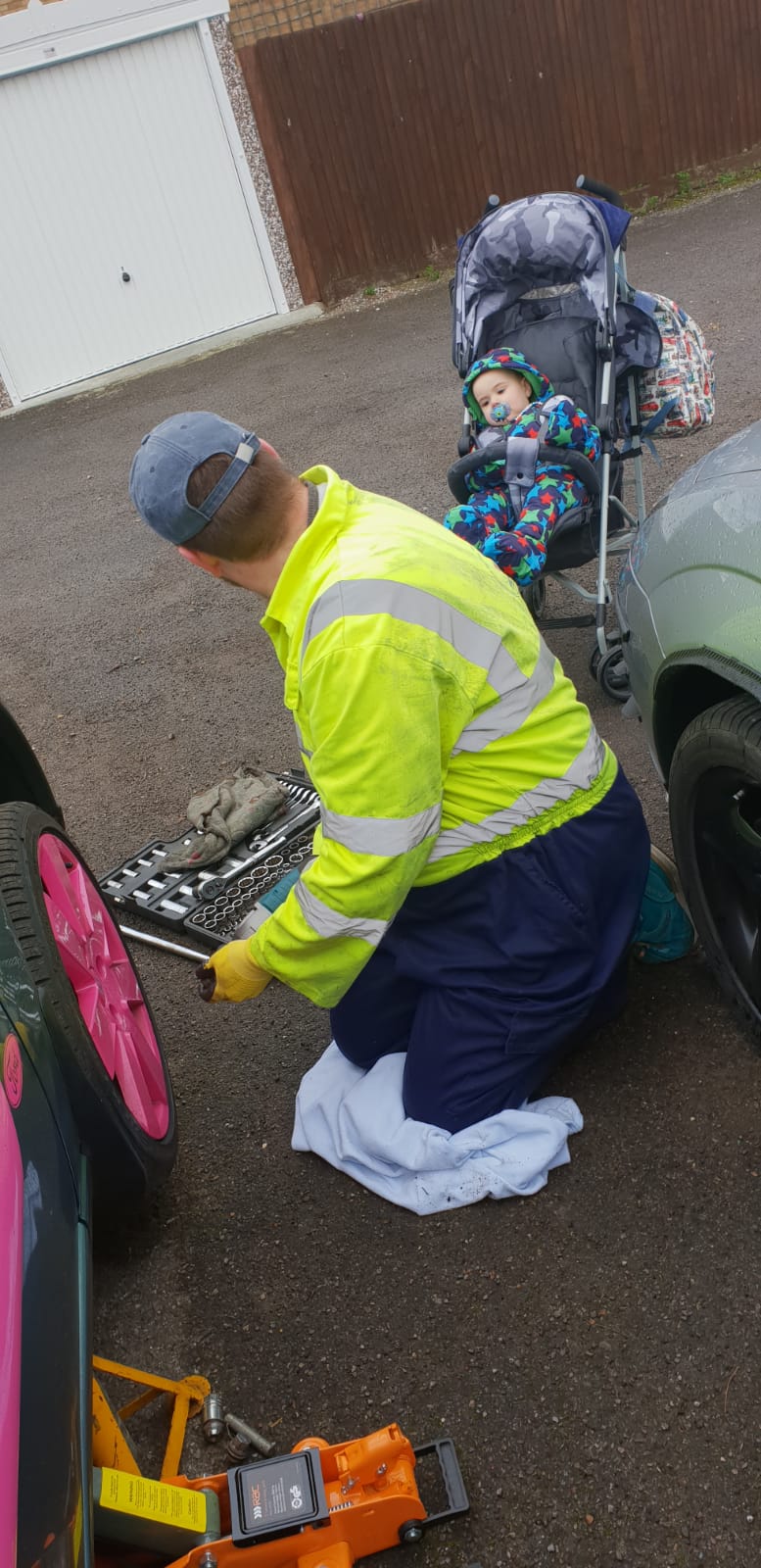

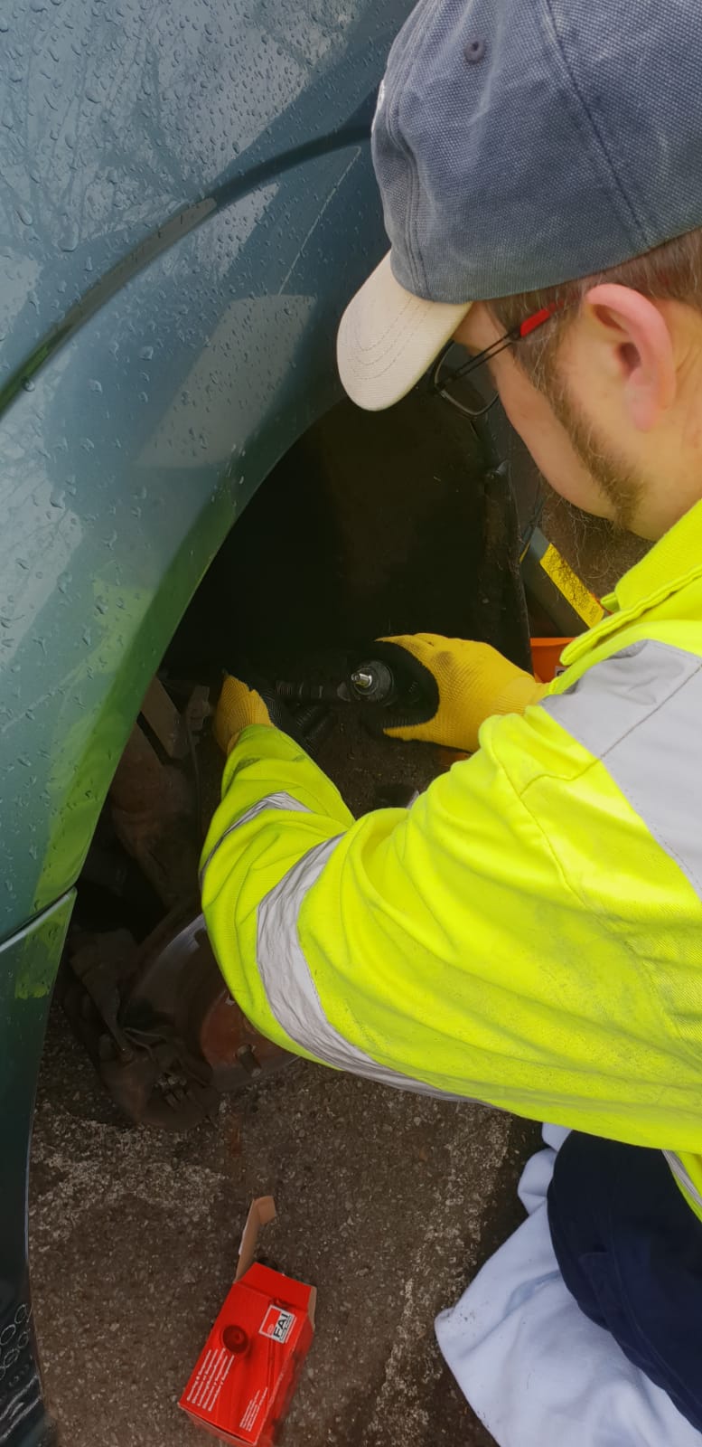

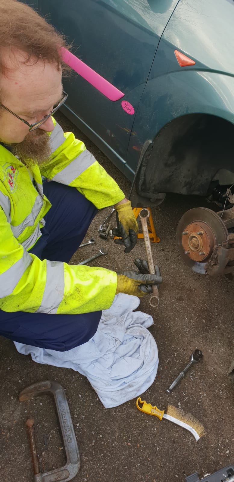

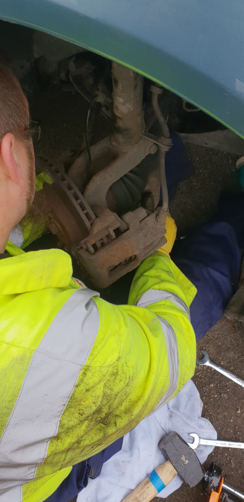

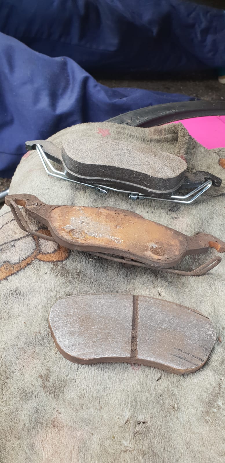

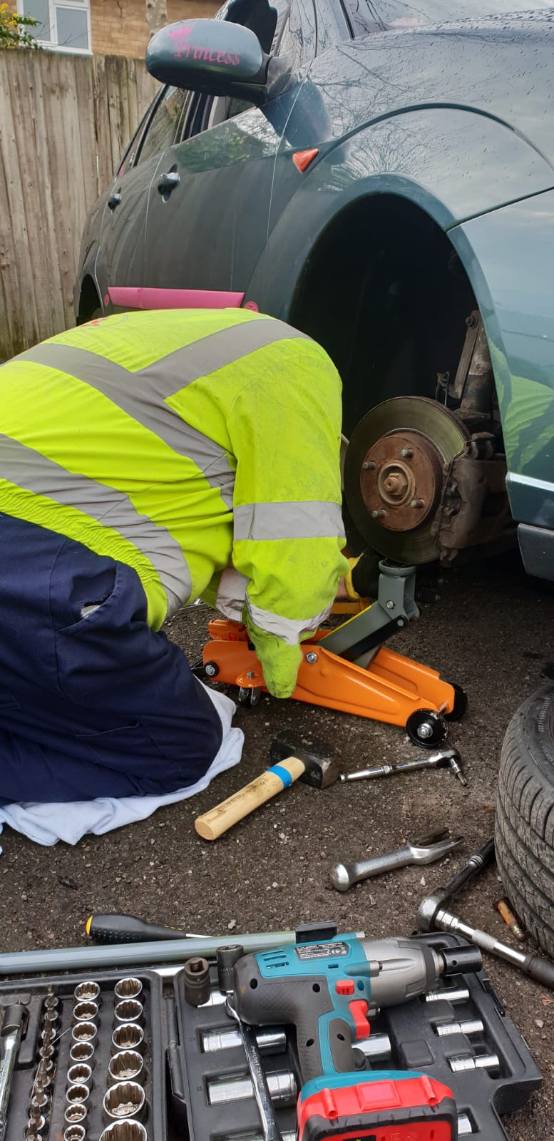

Well today started off gloomy with spitting with rain, trackrod end on nearside all ok, jack up offside, took wheel off to change lower arm( what a palaver with rear bolt), wheel i turned disc to get better access i noticed brake pad had seperated from its back plate, so new pads needed, only halfords was open and missus when off and got them £14.99 so three jobs all done ready for mot retest.. im fucked... ????????????
You've done well there. Glad you had a large enough clamp to push the piston back for the new pads. I didn't, had to push it with my thumbs, they hurt for days afterwards!

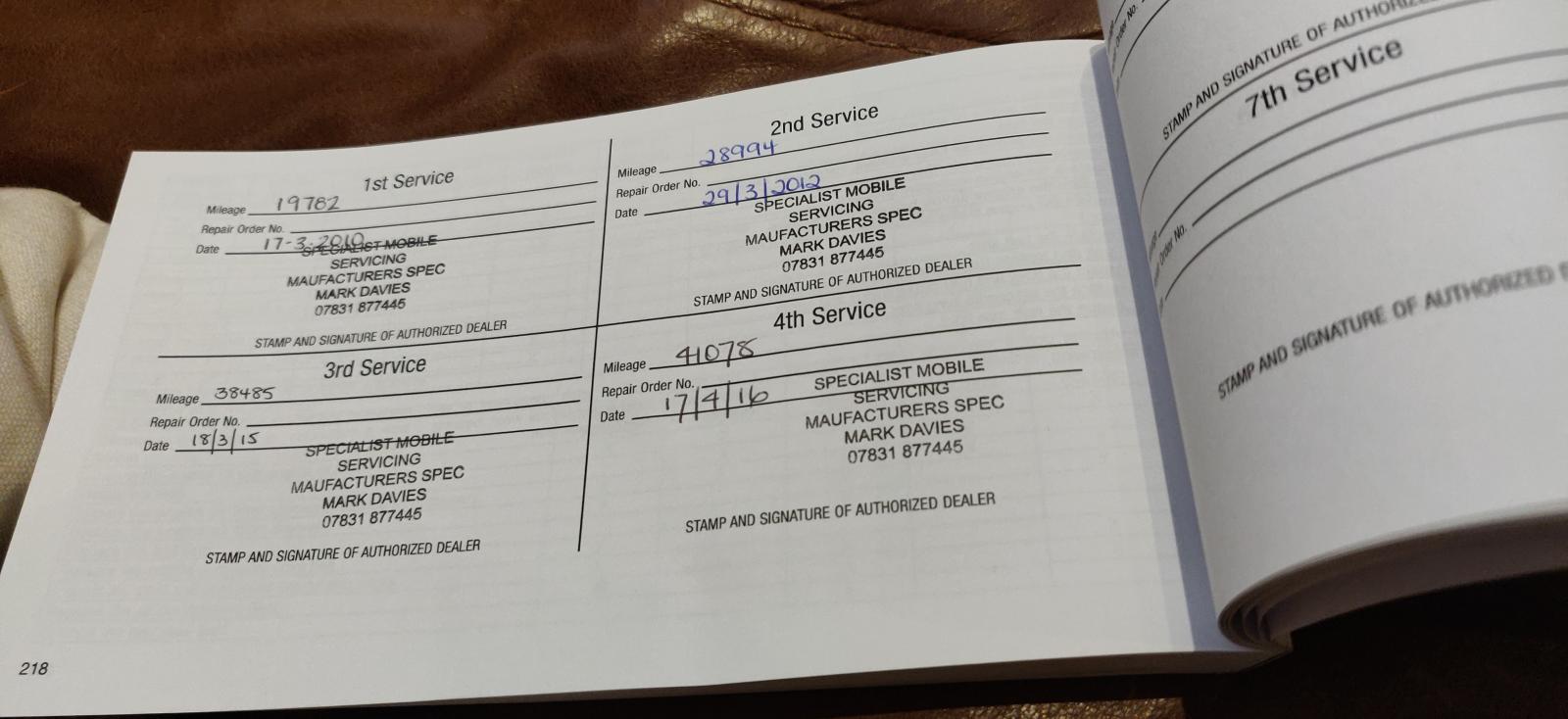

The service manual has a ‘full service history’, this isn’t worth quite as much as it sounds however as having a look at the document in detail reveals that the first service apparently didn’t happen until the car was three years and 20k miles old, and was not exactly from a main dealer.  Or a garage that didn’t have wheels of it’s own.  Still, at least it was to 'maufacturers specification', and it speaks wonders to the authenticity of this document (and/or the attention to detail of the chap performing the servicing) if this spelling error on his stamp wasn't corrected over all the years he serviced this car.
That doesn’t really worry me, however - as the service manual is for an estate, and ours is a saloon – so it’s likely not my problem.

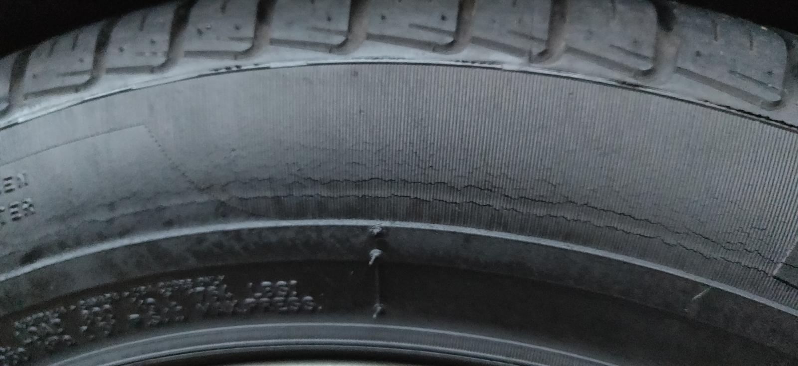

Had a quick look at it today in the daylight.
It’s got cool looking premium branded vintage tyres
And seems in generally good condition.
post-20251-0-83301800-1547397337_thumb.jpg post-20251-0-53517100-1547397384_thumb.jpg post-20251-0-15072200-1547397429_thumb.jpg post-20251-0-34169500-1547397495_thumb.jpg
The unbearable wheel wobble above 60mph means speeds are kept sensible, so new disks/pads may be in it’s future, but luckily a quick look at the suspension reveals things look pretty much like they did when it left the factory!

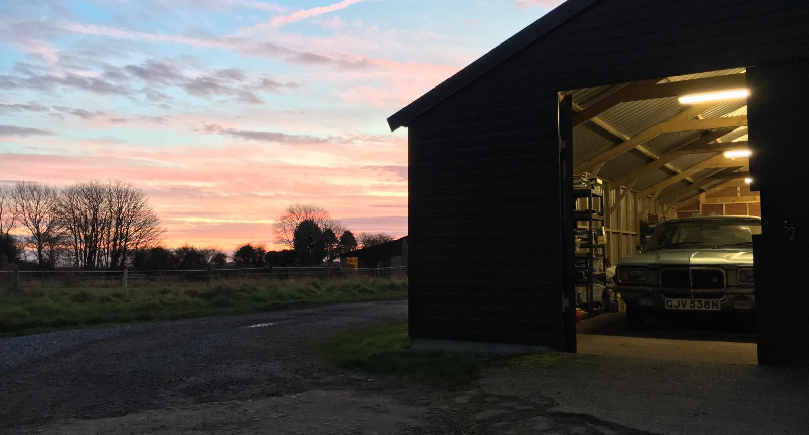

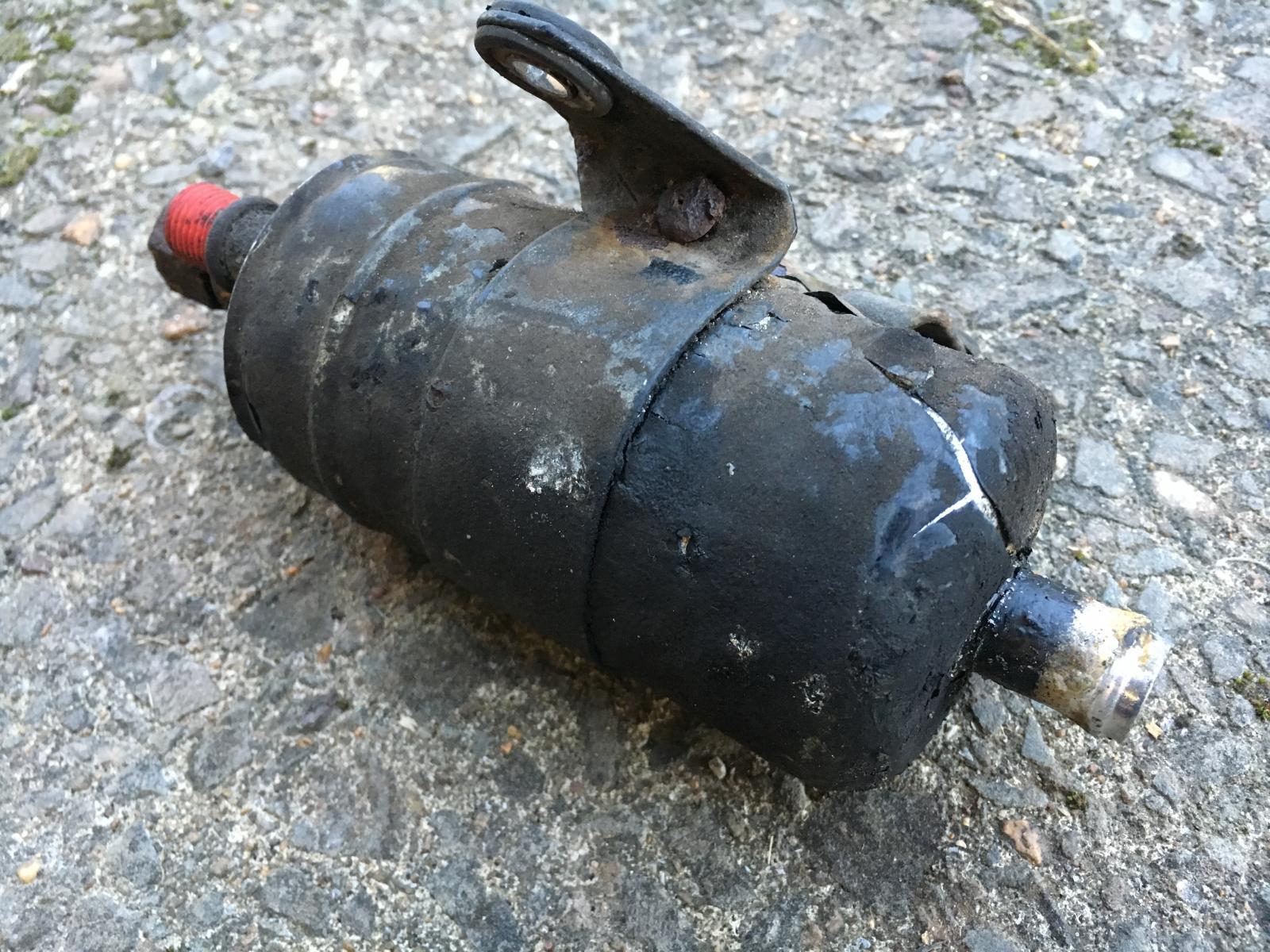

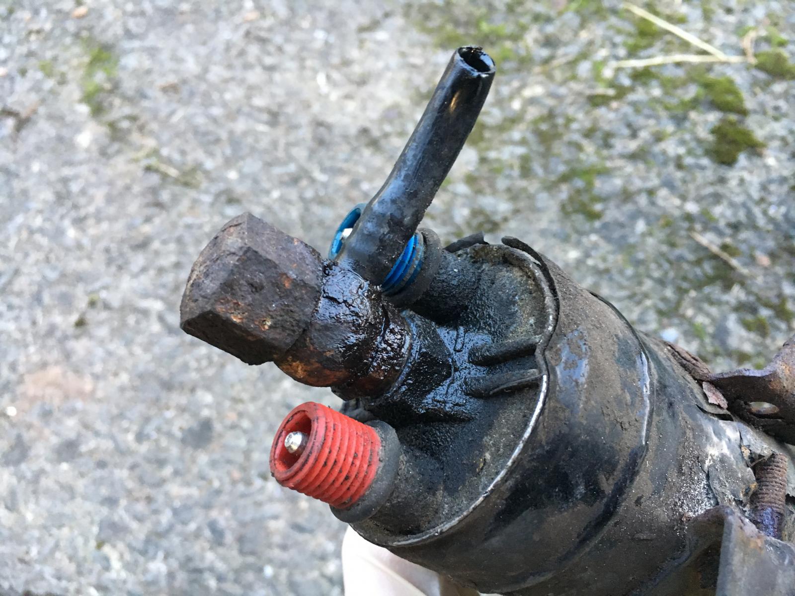

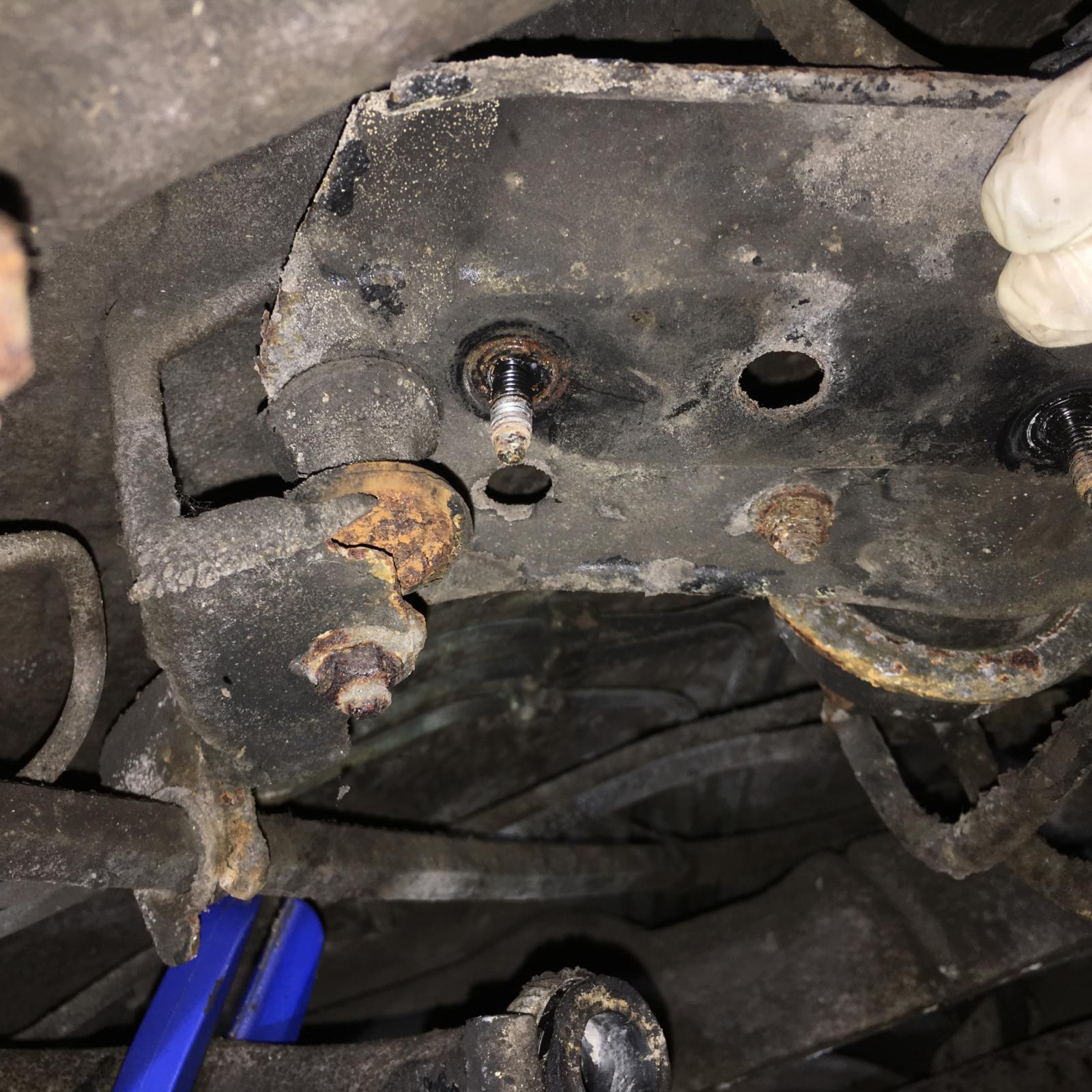

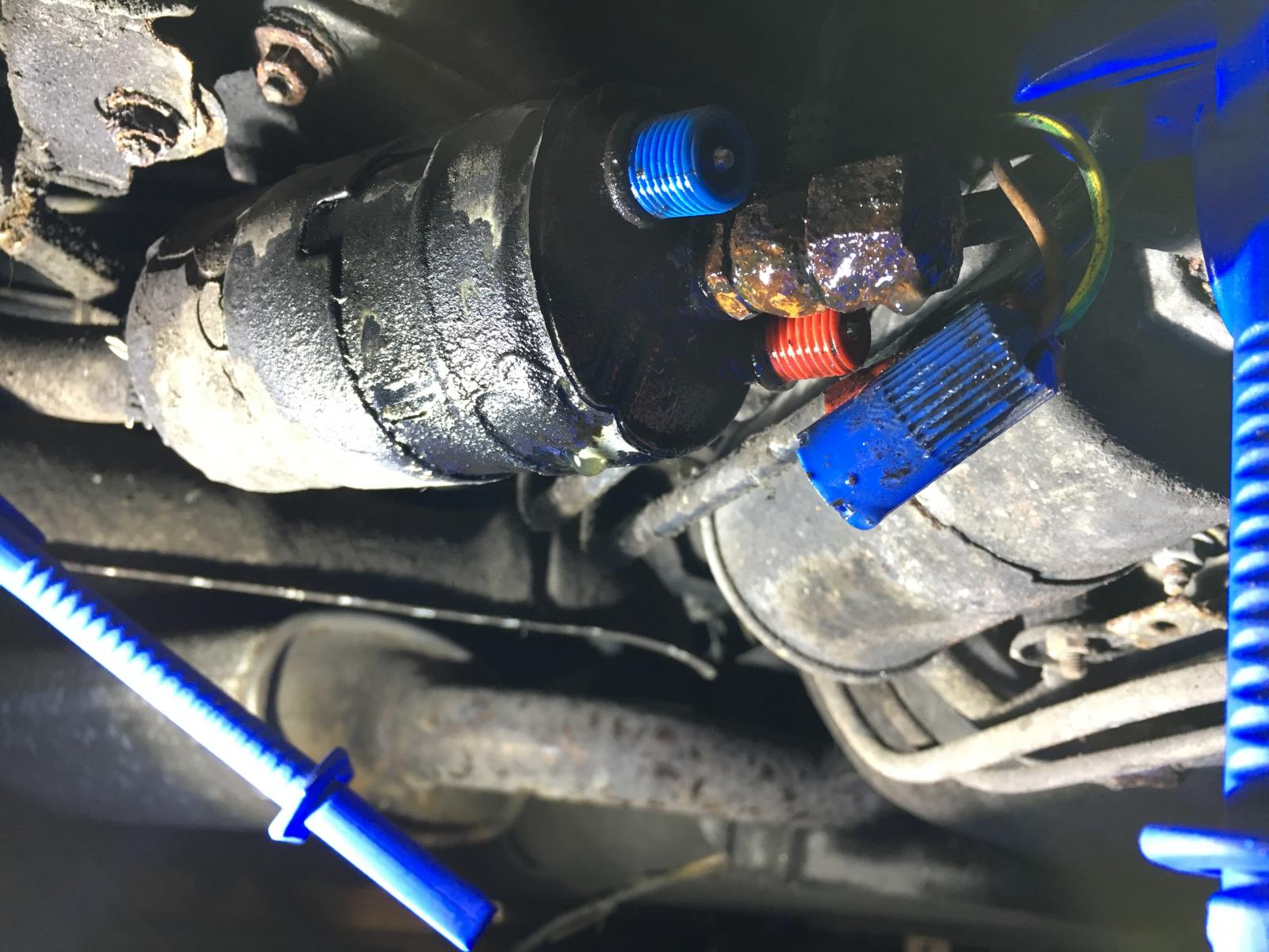

Made some very slight progress today; I wrestled the failed fuel pump off the Audi 80.
I started this last weekend but got nowhere as everything was rusted up to buggery, so I sprayed it with the outstandingly good Screwfix No Nonsense fuck-you juice and left it to think about its behaviour until today.
Take that ya bastad.
Quite liking those blue plastic hose clamps, by the way - set of three from Machine Mart, easy to use and effective.
That clamp bolt is toast, too. BFO bolt cutters soon persuaded it to let go and I’ll replace it with a stainless one, with some nylon washers to prevent galvanic corrosion.
I ended up having to cut the fuel hose as there was no way it was coming off the banjo fitting and the banjo itself was going nowhere. It’s impossible to get a spanner on the locknut properly because the terminals are too close. I’ll get a new banjo fitting.
The fuel pump and filter are mounted on a bracket that’s fixed to the car by three rubber mounts. The tiddly M4 bolts through two of these mounts have sheared, so they’ll have to be replaced (although I have to admit cable ties flashed into my mind).
So another round of penetrating oil and another instalment next week.
The correct Bosch pump is NLA so I’ve procured an ersatz replacement made of finest Chinesium. At least it’s a similar weight.
And so the sun sets on another unfinished job...
If "Mark Davies Specialist mobile servicing" has ever existed, he's never once advertised his name or phone number on the internet, nor registered as a company and had any of his details scraped. But he did remember to swap to a blue pen for one of the services at least so it does show some willing. I wonder what was in the real service book which made this seem better?

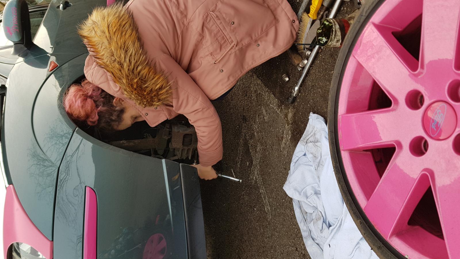

I am going to attempt getting the v70 to work tomorrow. The brakes are better, but rather digital.
Well the Rover 75 now has working trailer electrics.  I took as much of the centre console to bits as I could to try and see if I could spot the elusive red wire, but no luck.  So then it was out with the climate control and the ashtray unit to see if it was lurking behind the dash anywhere.  Again, no sign.  So it was on to Plan B - run a replacement wire from another live source and join it up to the existing wire half way down the car.  So I nipped down to Roys of Wroxham for a roll of 17 amp cable and an inline fuse holder.
I couldn't find a permanent live behind the dash which looked man enough to power the towbar electrics, so as a temporary* fix I took a live feed from the passenger side heated seat wiring - that is only live when the ignition is on, but I can't think of many circumstances where I'd have to have trailer lights on with the key out of the car, and if I did find myself in such a situation I'd just use my magnetic flashy red beacon thingy.  So it'll do for now.  Getting all the trim back on was as fun as it always is, but it's more or less all back together now.
Now if only I could get the poxy front wheel off...

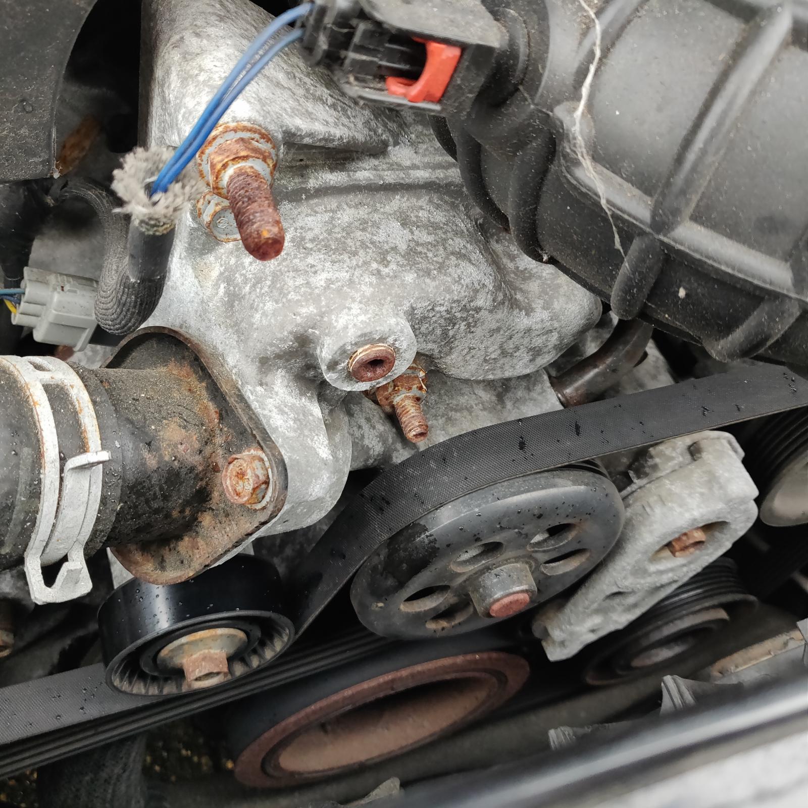

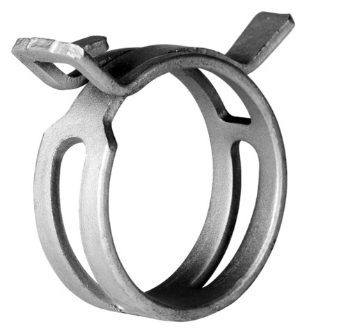

I hate those clips with a fucking passion.
I find them quite easy, because I've got a set of the proper pliers for them. The twat comes before that, when you need to spin the clip around 180 degrees with screwdrivers, pliers etc so you can get any sort of purchase on it.
Because I presume they would have been installed out of the car, they inevitable face the opposite way to you leaning over the engine from the top, buried under shit.
Bastards. I bought the tool to do the pumas thermostat housing, and it was still a cunt of a job
