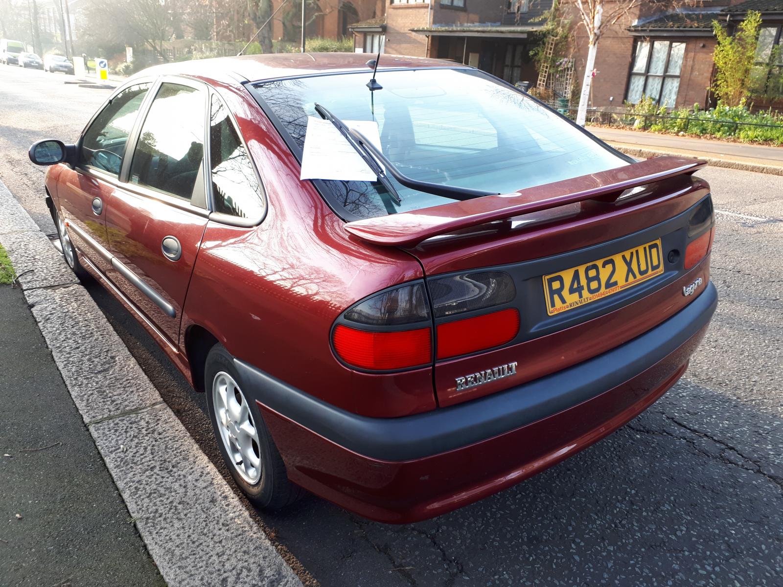

Fresh ticket for the gooner this morning.
I was hoping some rear brake fettling (which I did on Tuesday) plus a cheapo driver's wiper blade would see it through, and it did!

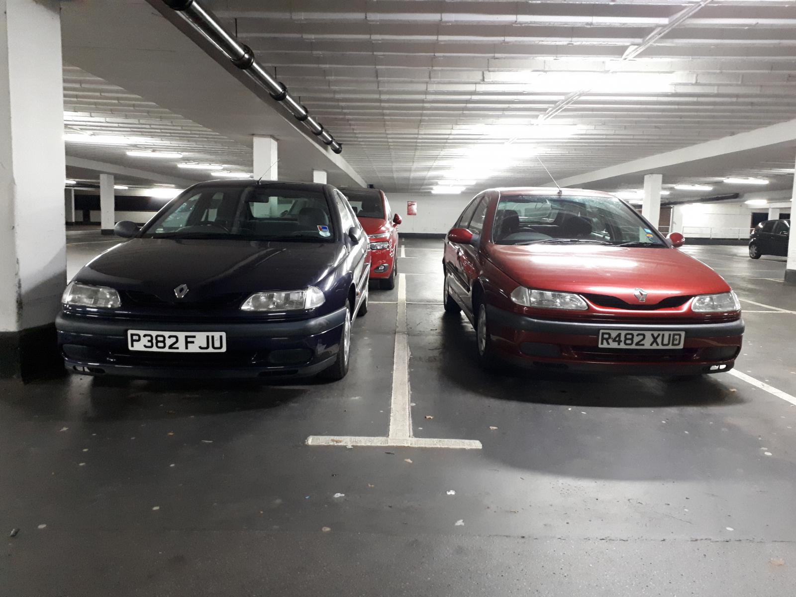

On a late evening wine run to Sainsbury's yesterday this was in the car park.
It's one of my regular spots and has only 37k on the clock, in an unusual aubergine colour.  Both are RT spec, but his looks more dismal.  I can only assume mine being a late pre-facelift means they chucked the toys at it, such as alloys, leather steering wheel and AC.

RobT, I reckon yours is an RT Sport - I had one some years ago and I think the only evidence was on the VIN sticker inside the door.  Spoiler/alloys/bit stiffer I think.

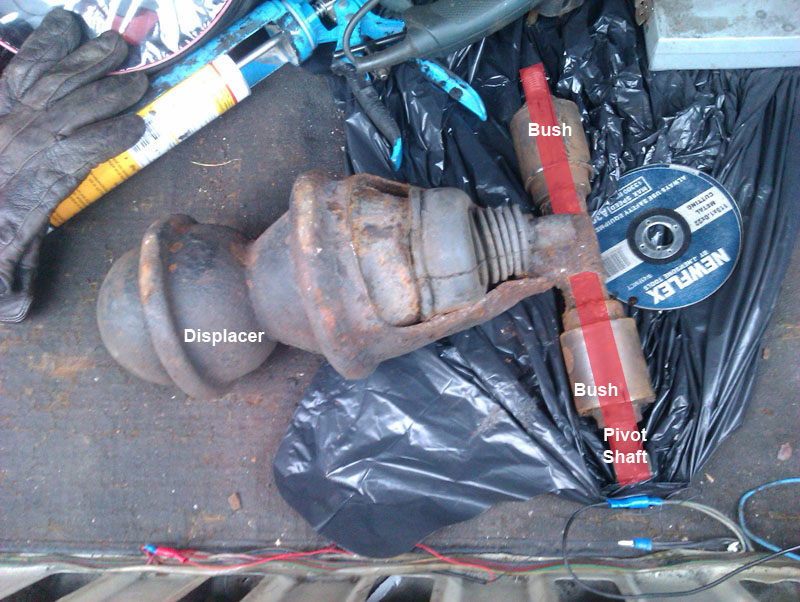

I cut that out of a trailing arm today, which is a job.  Reason being, I collected the two suspension units I dropped off at a machine shop yesterday.  They confirmed what I'd already found when trying to un-seize the parts, which was that basically you can't without destroying the trailing arm and the pivot shaft.
The issue is the part of the suspension unit where the displacer joins the pivot shaft.  Both components are made of steel, and both are exposed to everything that gets chucked up underneath the car.  There's no easy way to protect all this and the recommendation when new was that this is a service item, requiring regular greasing.  Of course, this never got done with the majority of cars.  So, both pairs of my spare displacers will now have to sacrifice the trailing arm so I can liberate the displacer and pivot shaft.  Then, because of the shape of everything, the machine shop can't press the shaft out unless it's fairly flush to the displacer socket, which means sacrificing the pivot shaft too.
This wouldn't be a problem except for the fact that I suspect the pivot shafts on the car are also seized.  Spares don't really exist and sometimes when you have a unit that seems to have unseized shafts actually turns out to just be spinning the bush in the trailing arm instead.
There are two solutions to this issue.  The first is to actually grease the suspension as regularly as suggested, keeping it in top health. The other is to manufacture/modify a T-shaped boot to go around the bottom of the displacer and the trailing arm which would keep all the dirt and grime out and the grease in.  I have no idea how to go about the latter, so I intend to do the former when I get the rear suspension sorted out.

Would the bushes come off with a little heat or some gentle persuasion with a grinder? Or would this risk damage to the displacers?
Wondering if you manage to get them out intact, they could be powder coated or enamelled to prevent rust?
Ah of course, I should have know that, thanks.

dozey:  The bushes are easy to remove, and I'd be replacing those anyway since they're all shot anyway.  It's the bit where the pivot shaft goes through the displacer socket that's the problem.  It just sort of rust-welds itself together.  New pivot shafts can be made easily enough, they're just a length of plain steel bar with a thread cut in each end, really, so sacrificing them isn't the end of the world if I have to, I'd just rather not if I can avoid it.
