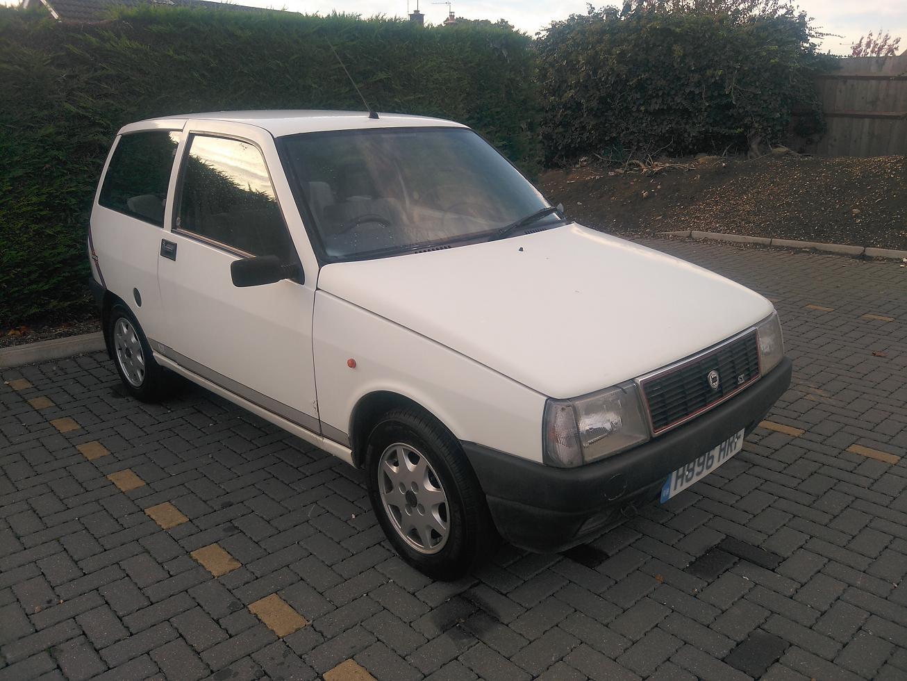

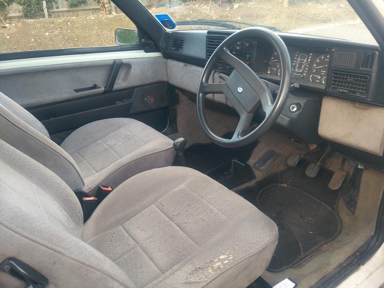

Been having a play with the Y10 today.  First I took some pictures.
Smoll car is smoll.
Alcantara on the driver's seat is showing slight* signs of wear.

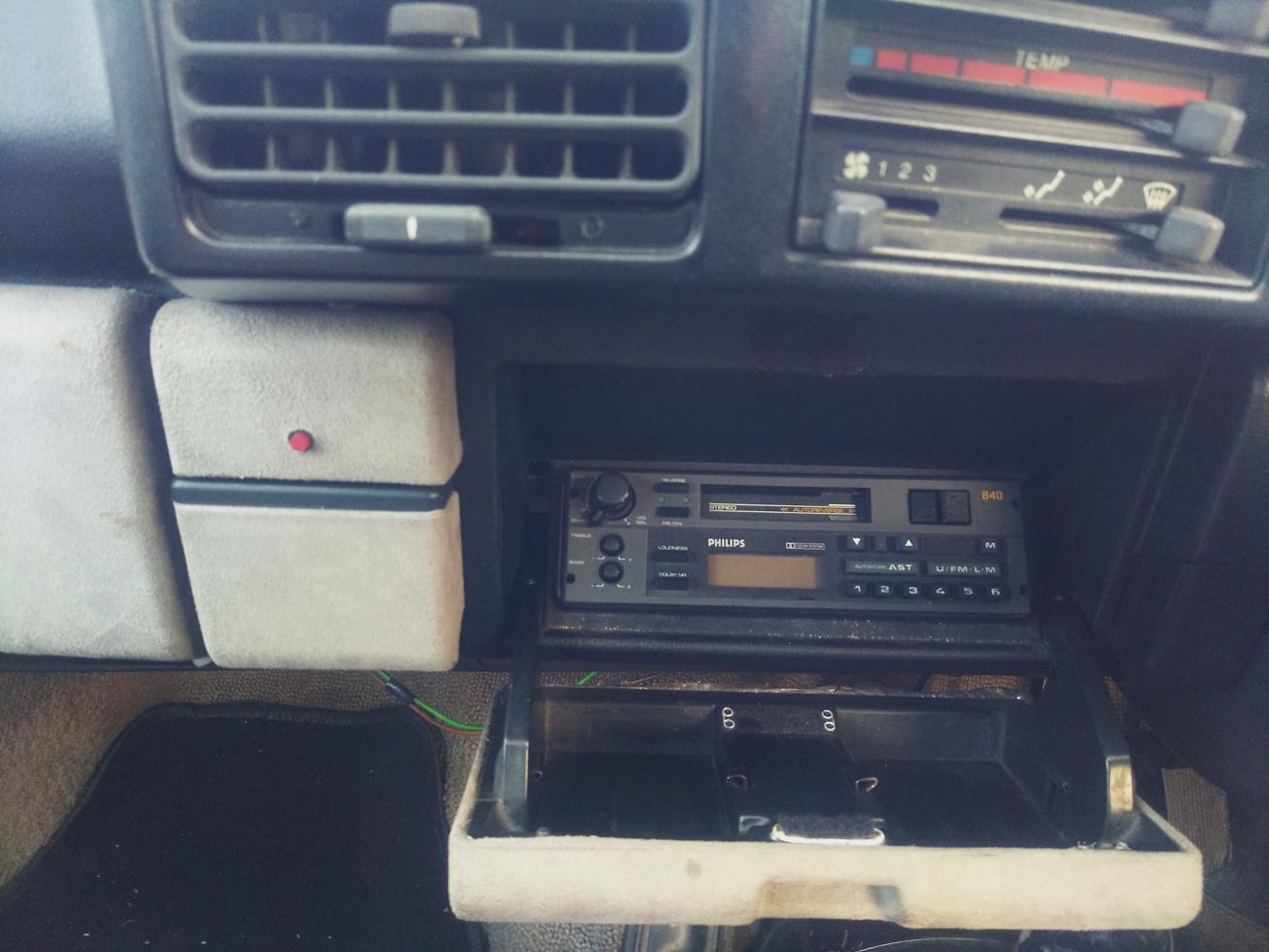

Hidden stereo, just like a Bentley (or a Laguna 2).

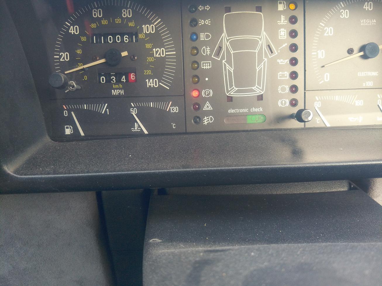

Anyone for some warning lights?
Green means go!

Of course it wouldn't be a Lancia if the electrics were all straightforward.  Since fitting the replacement horn the speedo has developed an interesting* trait - as soon as the car starts moving the needle shoots round to 140 and stays there until the ignition is switched off, with the stepper motor whirring away in the dash and the milometer and trip meter spinning over just as quickly.  I'm wondering whether I've somehow managed to disturb the wiring to the speed sensor in the gearbox whilst fitting the horn - the speedo was working fine beforehand, even after I removed the original horn.  I'll have another look tomorrow in daylight, weather permitting - hopefully it's just a loose wire, although if the sensor has shat itself then replacements are available off eBay.  If it's the clocks themselves which have gone wrong then that's more of an issue, although I can't see why they would have - it seems too much of a coincidence that I was buggering about in the vicinity of the gearbox just before it started to play up.
I've had a look through the paperwork and this car continues in the long* tradition of my ACA purchases by being smoll, white, unusual and having had far more money spent on it by the previous owner than what I paid for it at auction.  In this case a bill from a Lancia specialist for £2,057.48 in September 2016 for rectifying various faults - water and oil leaks, dodgy brakes, clutch cable, fabrication of a new gear linkage bush and diagnosing a running fault.  Most of the bill was labour - 35.5 hours at £45 + the dreaded per hour. :shock:  I also found a bill for an oil change - as suspected, fully synth and probably much too thin for the engine, so I've bought a gallon of nice thick mineral oil and I'm going to do a swap as soon as I get around to it.
I had a look underneath while it was up on the ramps and it looks sound enough under there - it's been quite heavily Waxoyled.  There are a couple of bits on the sills which I'll have to keep an eye on (although nothing sounded crunchy when prodded with a finger), and a couple of rubber bushes look like they've seen better days, but overall it's remarkably sound for a 28-year-old Lancia.
I'm still quite chuffed with it.  The speedo thing is mildly annoying and I'll have to do something about it (if nothing else, it's making the recorded mileage go up very quickly...) but the remaining issues I can easily live with, and now it's got a properly functioning heater it's a lot more usable - and an enormously fun thing to hoon around the back roads in.

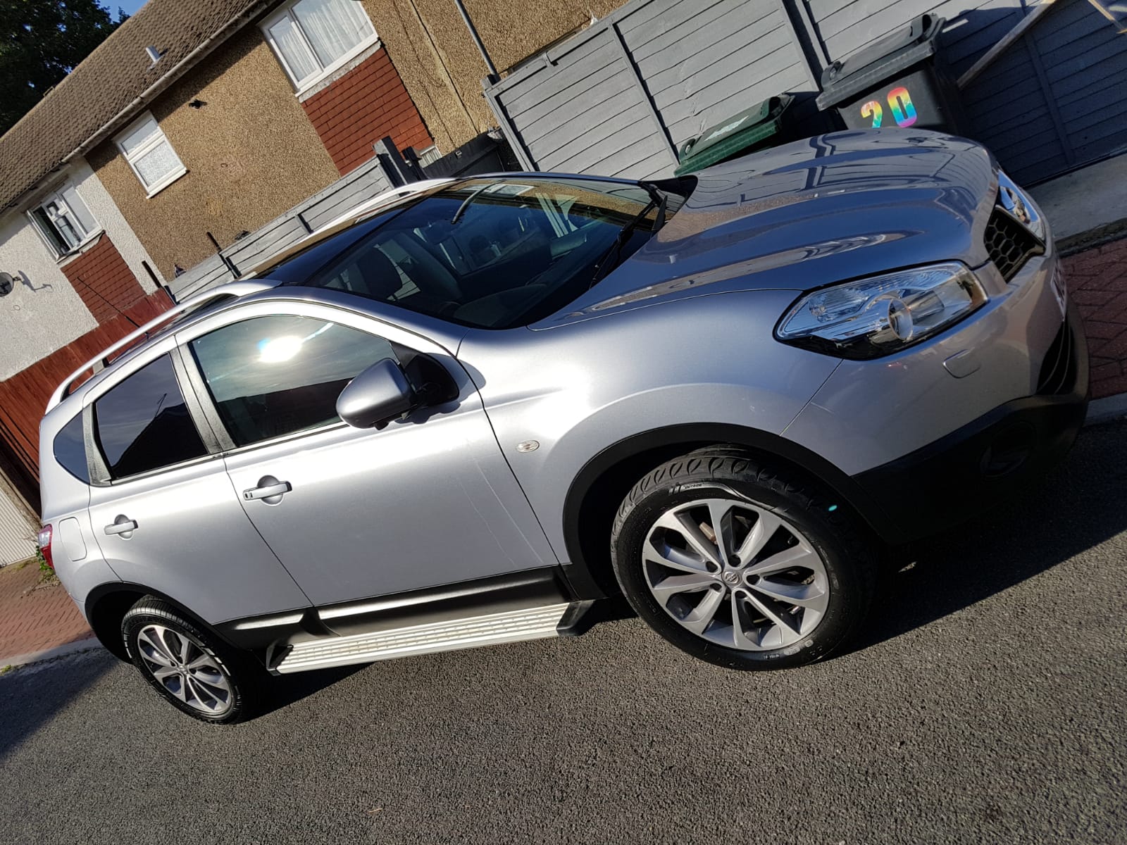

Noticed today how many nissan cashcows have gaffa taped tailgate handles are about
Cashcow door handles are the new Mondeo bumpers?
Y10 speedo is still playing up.  Couldn't find any issues with the wiring either at the sensor end or the clocks end (although it's such a tangle of bloody wires behind there that I would struggle to spot any issues that did exist), so I'm going to assume that the timing of it going haywire was coincidental and not linked to me fitting a new horn (the sensor is on the other side of the gearbox anyway).  So I've fixed* it by unplugging the wire from the sensor - I'll just use my phone as a speedo for now.
Long term I should probably fix it, but I'm not sure whether it's the sensor or the clock causing the issue - is there any way of measuring the signal from a speed sensor?  Is it variable voltage or is it a pulsed signal?  Sensors are available but it's a twat to get to, at least without removing the brake master cylinder (which I'd really rather not do).  There is a replacement speedo on eBay but it's in Italy and thus in km/h (although one assumes the faces should be straightforward enough to swap over).
Speedo sensor will almost certainly be a pulsed signal, X pulses per mile.
If it goes wild even after you've stopped, I reckon the clocks could do with a repair. If you can spare them for a bit I'm happy to have a look.
In answer to Stuboy, the plastic on the moulded clips used to connect the handle to the tailgate frame on a Qashqai isn’t up to the job and eventually snaps. I’m lucky, ours is black so I just bought an aftermarket unpainted one as a replacement. There’s three different types depending on whether you’ve got keyless entry and/or a reversing camera.
I’ve seen a lot of hideous chrome ones, Qashqai owners can go almost as mad with the stuff as PT Cruiser owners.

Speedo senser will almost certainly be a pulsed signal, X pulses per mile.
It goes wild as soon as the car starts moving, so it's obviously getting an input from the sensor to send it haywire.  It doesn't stop until the ignition is switched off though.  That's a very kind offer - I'll probably stop using the car once the council start salting the roads so will drop you a PM then.
