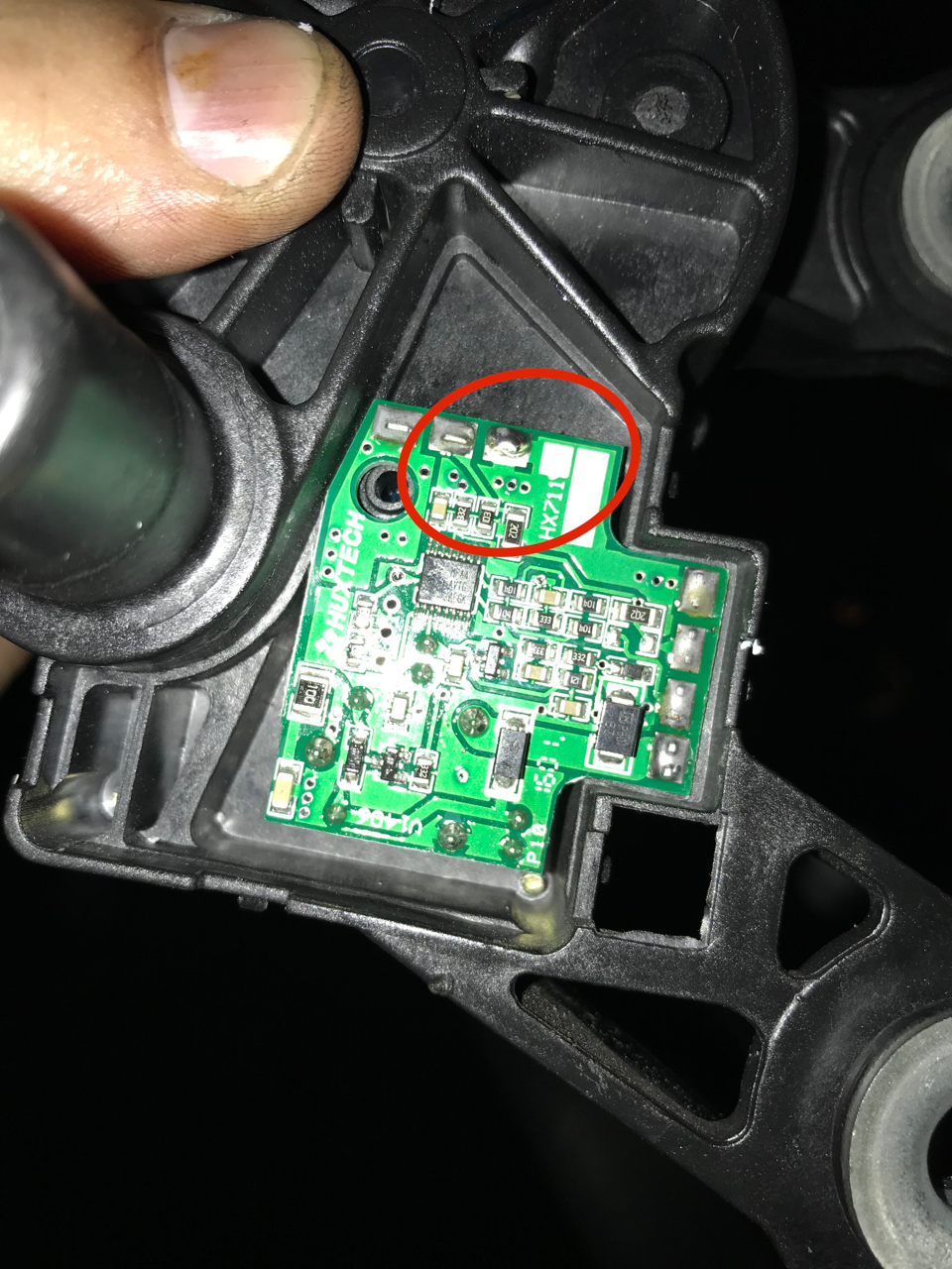

Bought a new rear wiper motor for the Golf.
Easy to change.  Change the motor in 20 minutes or so.  Test.  Great, it's working.
Except for the fact that it doesn't bloody switch off again.  Bugger.
Strip down the motor, replace the cheap aftermarket bits that I think might be failing with original teutonic OEM parts from old motor.  Same problem.  Bugger.  Re-strip, re-fit, check electrics inside for shorts.  Look at the relay:
Spot the dry solder joint.
Went inside, fired up soldering iron:
Took it outside to admire my genius.  Doesn't fucking work at all.  Must've overheated the tiny IC on the board to buggery re-soldering the joint.
For fuck's sake.  Ordered another one.  Fortunately, I got £10 off my order because of a Post Office cock-up last time around.
'Tis the true Autoshite way.   Spend fucking hours mending something before realising its fucked anyway and buying another one.   I think I am starting to resent the time more than the money these days, though.

A PCB in a wiper motor, that's what's fucking wrong.
