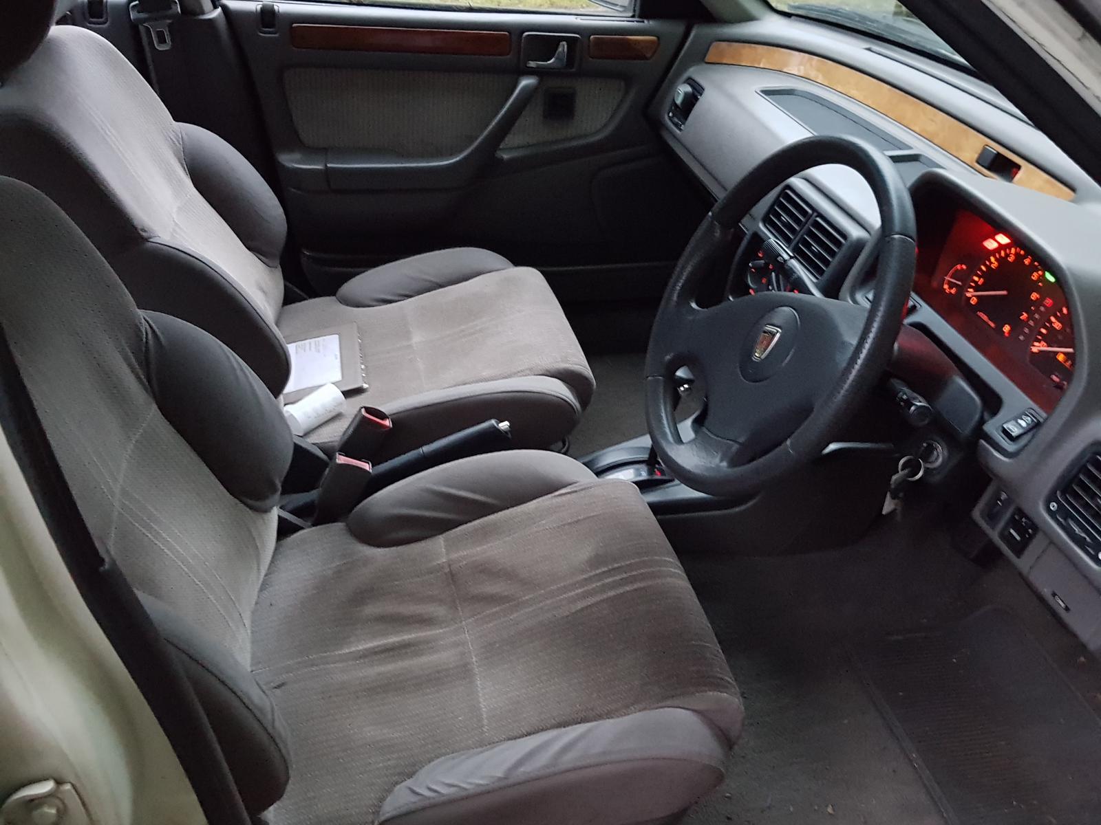

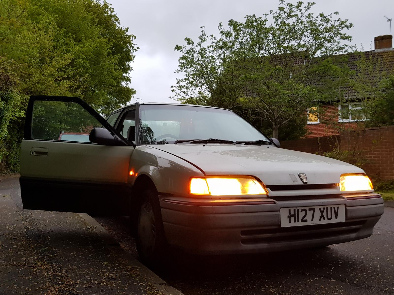

Yesterday I went to look at another car, if I buy it I might stick my audi up for sale... 793037f216e7facf20335d614c1dcb28.jpg

Its not bad. The drive home definitely made me aware of some issues (thermostat needs replacing, wipers don't work intermittently) but it was fun and these are good to hustle. Pretty quick off the line too.
Oooh, that is very nice. Is it a 200 or a 400, as I can't quite see the boot?
It's a 400. 416 to be precise. I'm conscious that the Honda lump can eat head gaskets if used heavily following a period of inactivity so I'm trying to take it lightly. It really really needs cleaning though.
