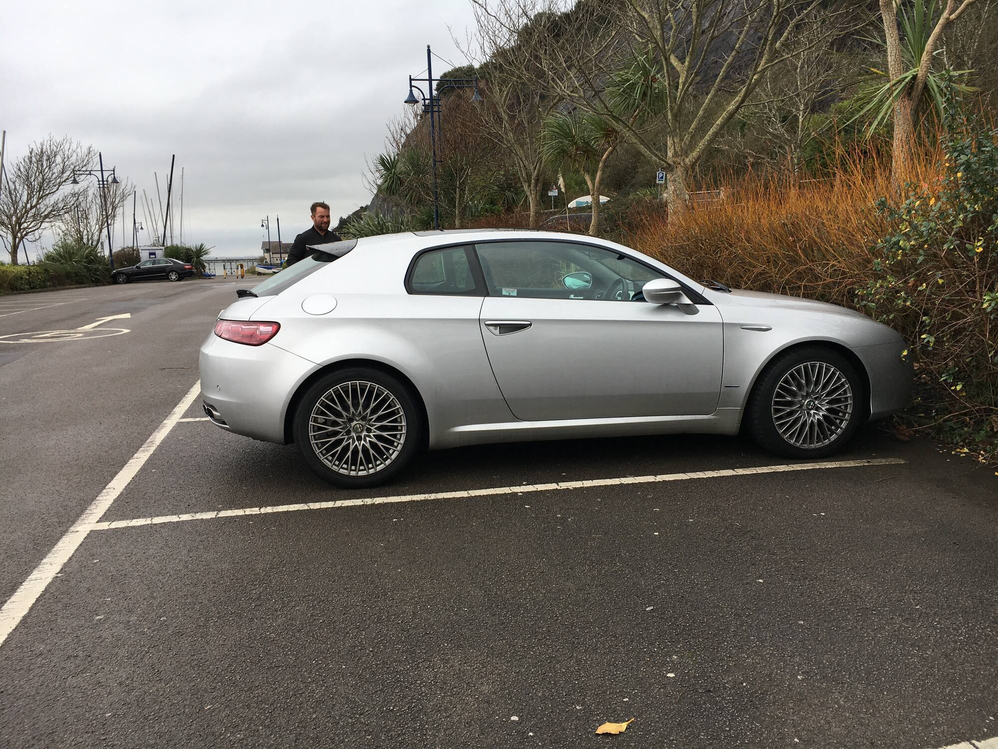

After a number of misadventures culminating in a meet-up in a betting shop in Wapping, I now have possession of an Alfa Romeo. Money shot:
It runs very sweetly and looks very shiny and got me across the middle of London and home to Wales in considerable comfort and style. And has a few minor electronics niggles to sort out, just so I can say it's got character.

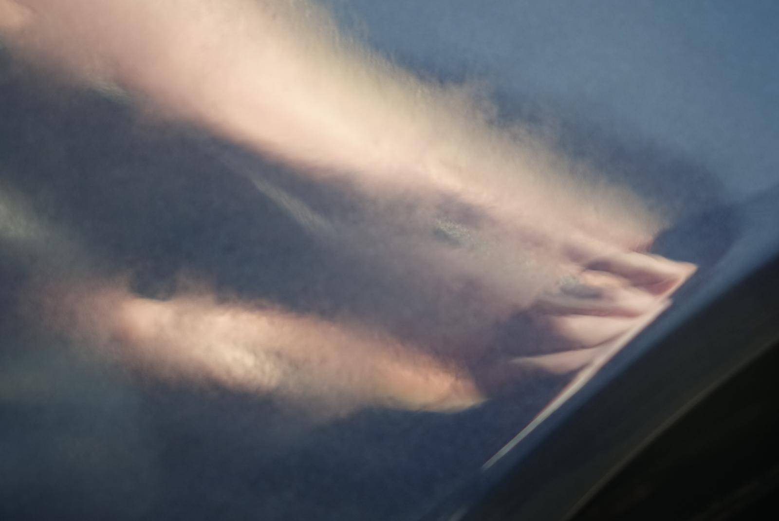

Popped over to the paint shop for Barry to examine the paint problem with the Mercedes. He says it looks like the metal primer coat has probably not been totally dry when the top coats went on and has reacted with the lacquer.
He is hoping a polish will fix it. He had a go with a sanding block and farecla on a small section followed by an orbital pad which seems to have fixed it. So is having it back next week to do the whole lot.
