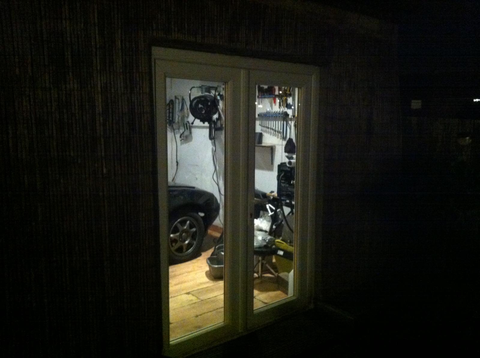

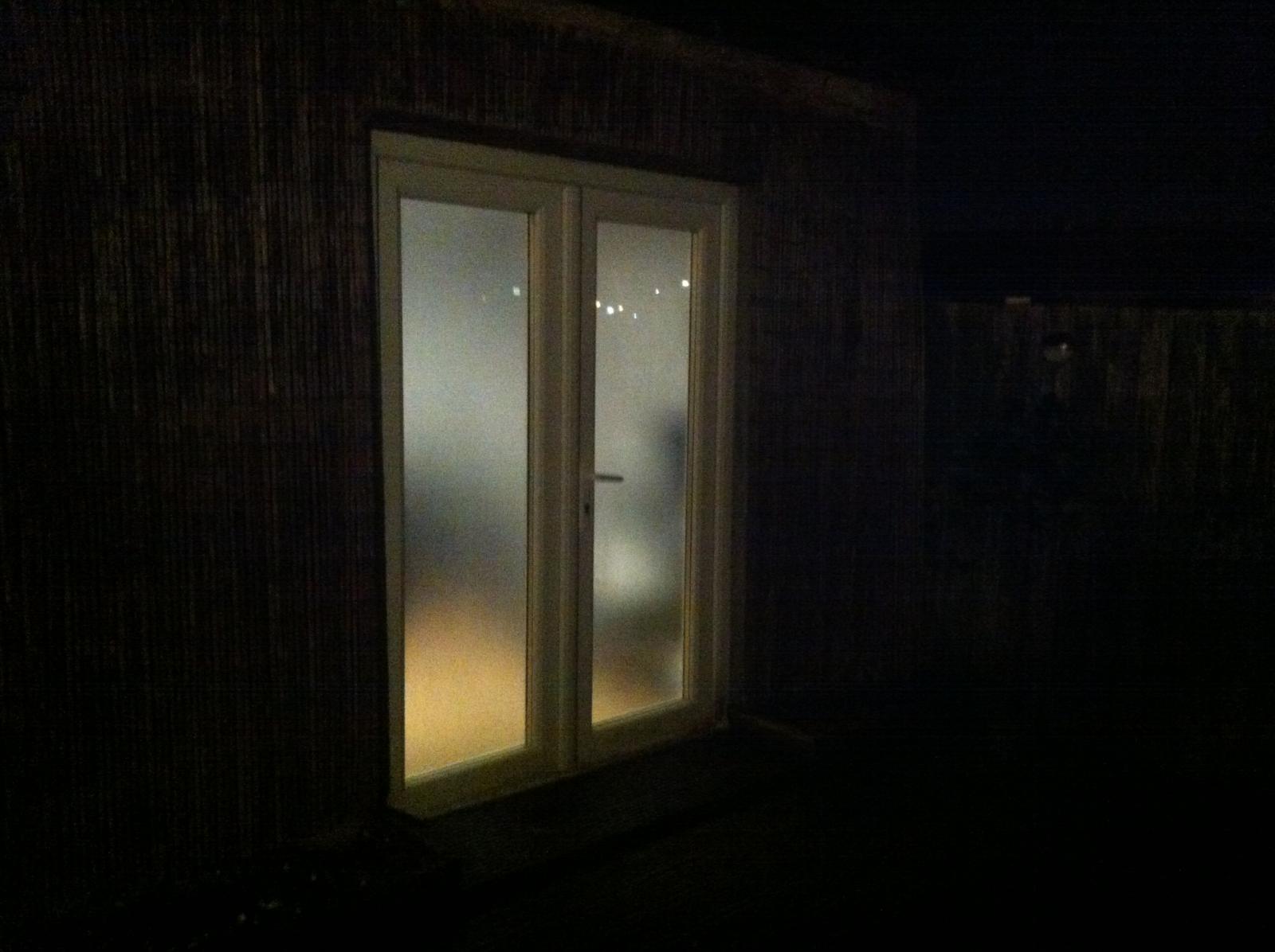

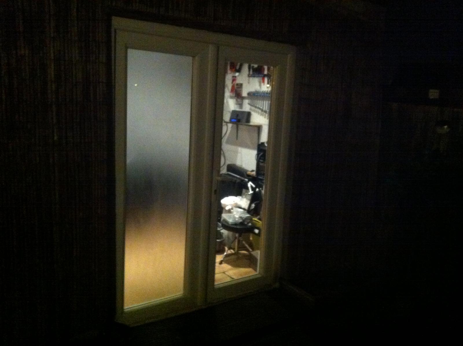

A couple of folk have recently pointed out that having great big see through windows in my garage with the mazda and all my lovely tools on show might be just a little too tempting to the local scrotes
so I sorted it tonight with a roll of 'frosting film' off ebay - a pain in the arse to fit but I'm pleased with the results
now I can fondle my mazda in peace :)
