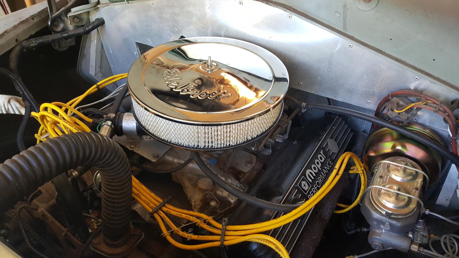

Couple of months ago I had to buy a new battery for Mrs DFs modern. Anyways it came with a coupon for $40 off $100 spend. This was about to expire so I treated myself to a fancy new multimeter, a headlight restoration kit and a shiny chrome 14" air cleaner to replace the old 10" one.

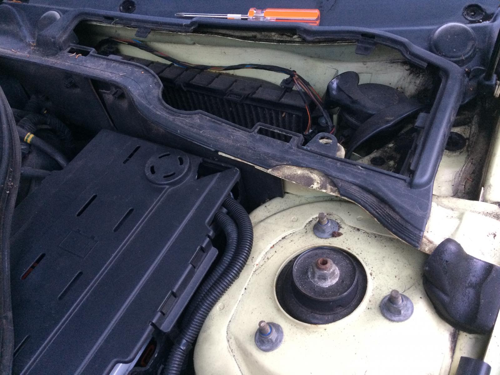

Anyway this is now really annoying me but the NS windscreen keeps really misting up when its raining or shortly after rain fall, and the only way to keep it clear is having the screen clear on full non Econ, which obviously makes it even less *economical. I can live with that small gripe but driving around to the sound of a full blown wind tunnel coming from behind the dash is annoying.
The NS plenum drains are clear even after a couple of days of heavy rain all seemed fine. Any ideas chaps?
I think its the weather, mine is like this just now as well. I think its the moisture held in the aircon. Mine is fogged, then gets worse for a bit, then clears. There is a demist button which helps a bit. I had hoped this year it would have been better as i have fixed the boot leak from last year but is just as bad fogging as last year.
EssDeeWon:  check the floor for holes/carpet for squidginess.  Sounds like moisture is trapped inside the cabin on the passenger side.  Had similar problems with the Princess and that was down to water coming in through the bit where the floor, sill and inner arch meet and the soundproofing foam wicking it up into the carpets.  Don't 75s have a reputation for leaking heater matrix?  That could also be a likely candidate I'd've thought.

Thanks Vulg, I will have a good poke around on the passenger side.  It must be something like that because its ONLY the passenger side, never on my drivers side.
@Nyphur, yes you are right I did notice that actually, simple enough to do and their only a tenner or summit.

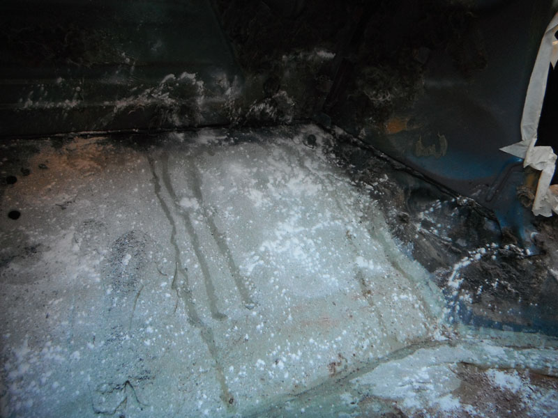

Oh, and don't forget the talcum powder trick if there's no obvious sign of ingress.  You just poof it about in the affected area and it sticks to the water, works surprisingly well to highlight unexpected ingress points, like here on the Renault where it shows water coming in through the bulkhead-to-chassis seam.  Sure it was someone on here tipped me off about this as a thing and it's really useful.
