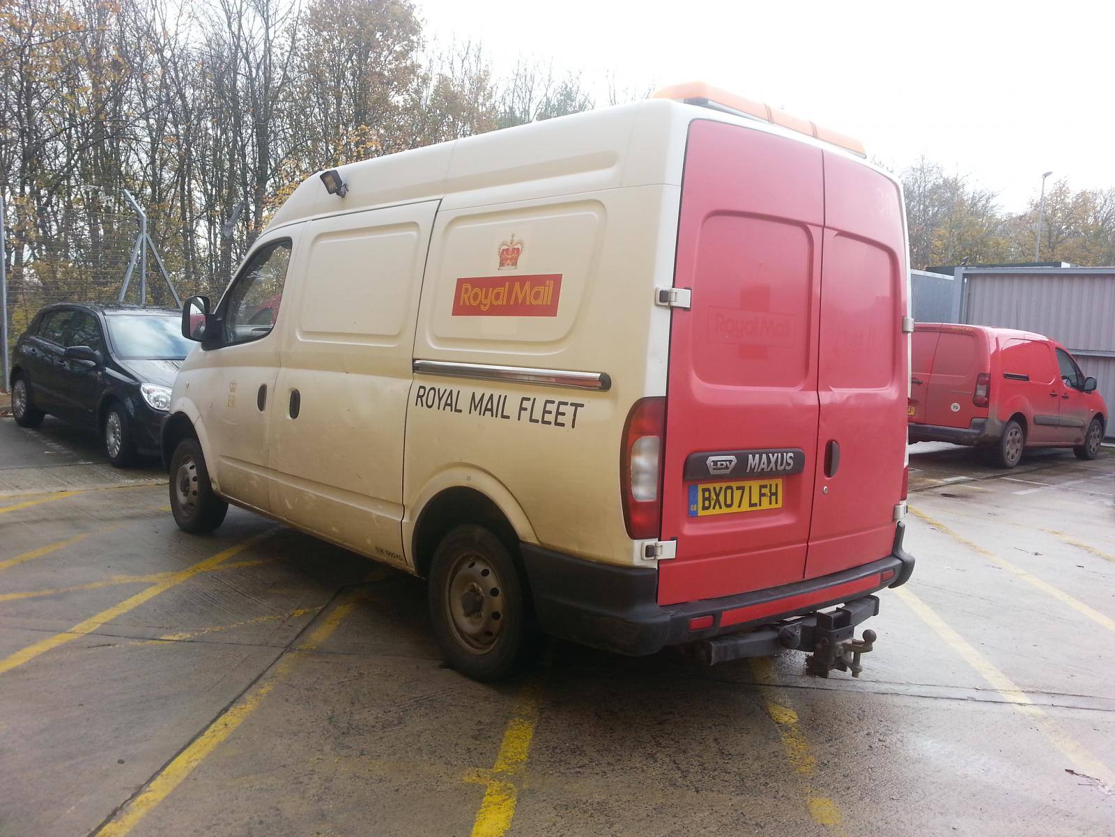

Maxus you say. Here is one I snapped (and was briefly a passenger in) at the Swindon Royal Mail sorting office. I was there picking up a 67-plate Peugeot Partner RM van.
Royal Mail still seem to have a fair few of these hanging around their yards, usually in a state of disrepair (flat tyres/mould growing around the parking spot/very sun faded RM-related bumf in the dash etc...)
Birmingham City Clowncil had a couple of them in thier fleet when I worked there a couple of years ago. Never drove it properly myself as I always got given bloody Transit Connects or Fiesta Vans, plus the Maxus eventually got bashed by another inexperienced driver. I really want to try one out properly.
