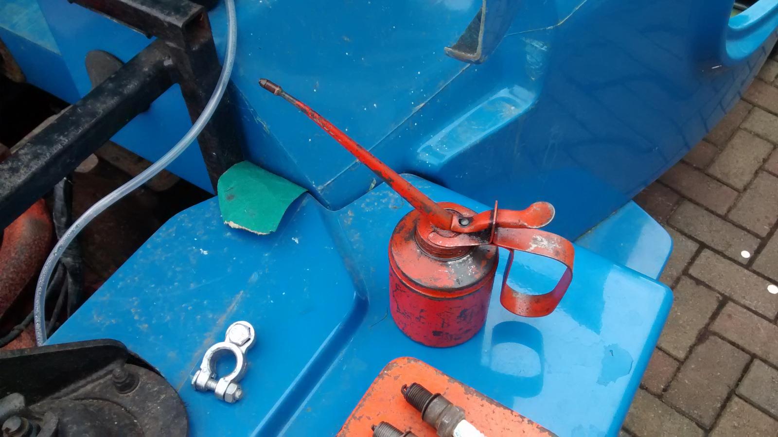

Since it wasn't raining, I had a couple of hours tinkering on the Geep again today. The jobs to do were to oil the bores and cam and rocker arms, then have a look at the rear brakes.

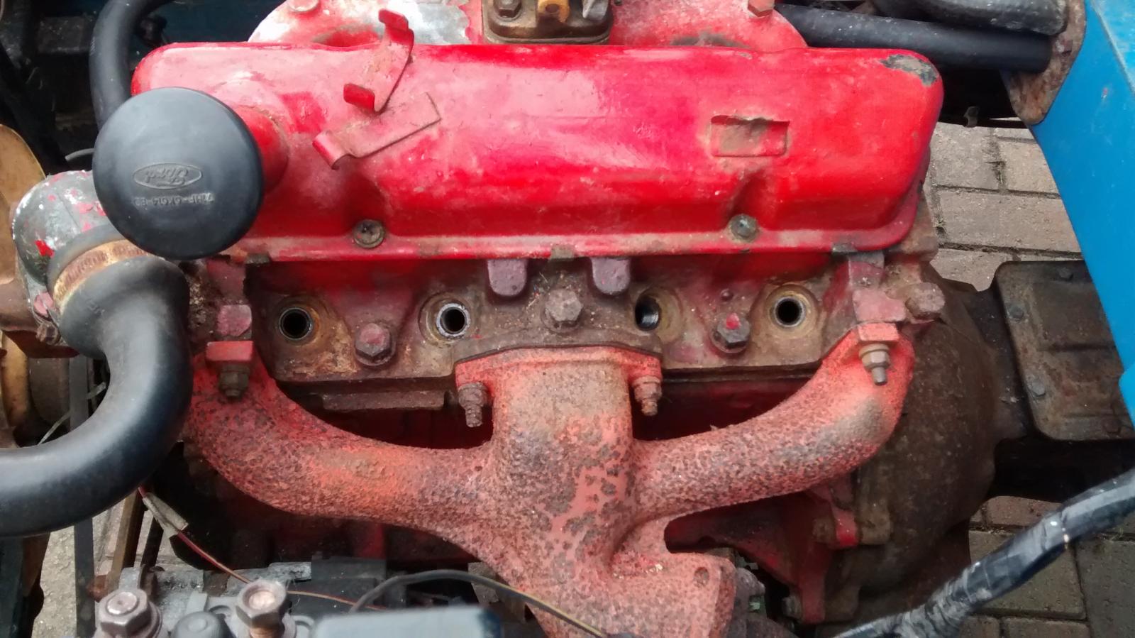

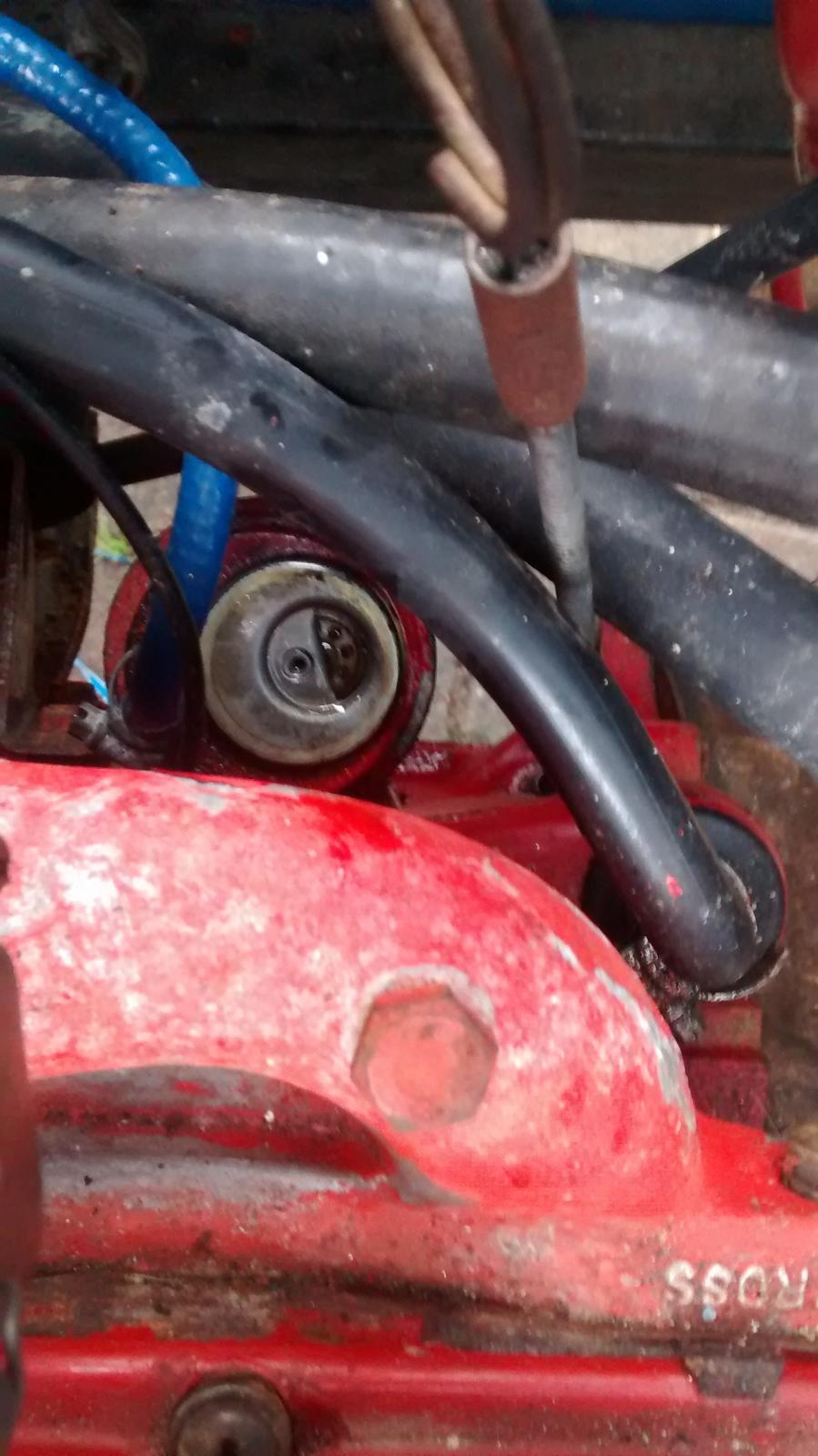

Familar sight. Plugs out
Deploy weapons
I put a squeeze of 10w/40 down each bore, then got the 16mm spanner and started turning the engine by hand on the end bolt on the crank. This sucked, so rather than keep nipping my fingers in the fan blades I went and refitted the starter motor. It didn;t turn the engine over quickly, but it did turn over by itself so that'd do. I hooked up the battery to the starter motor with a jump lead and turned the engine by touching the jump lead on the battery terminal. I gave it about a dozen 10-second bursts with some time to cool down in between.

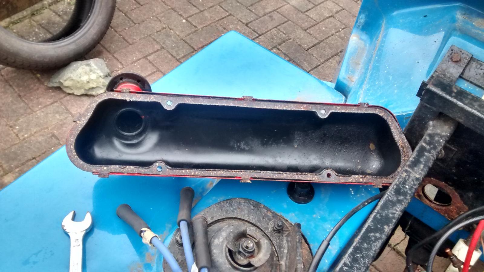

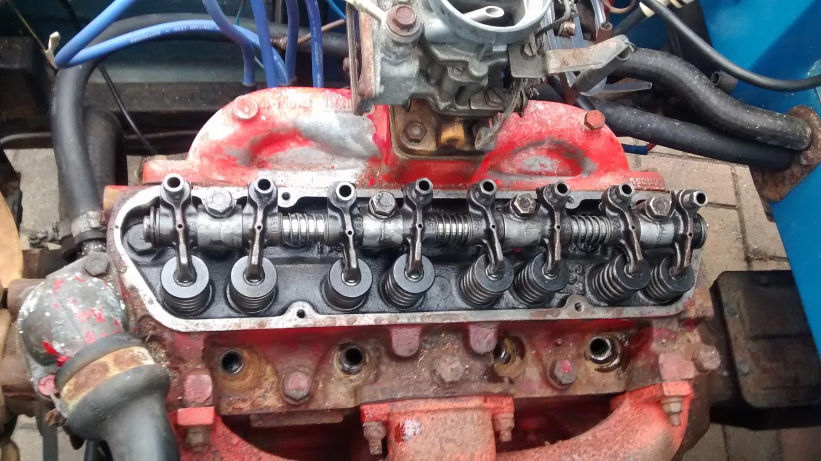

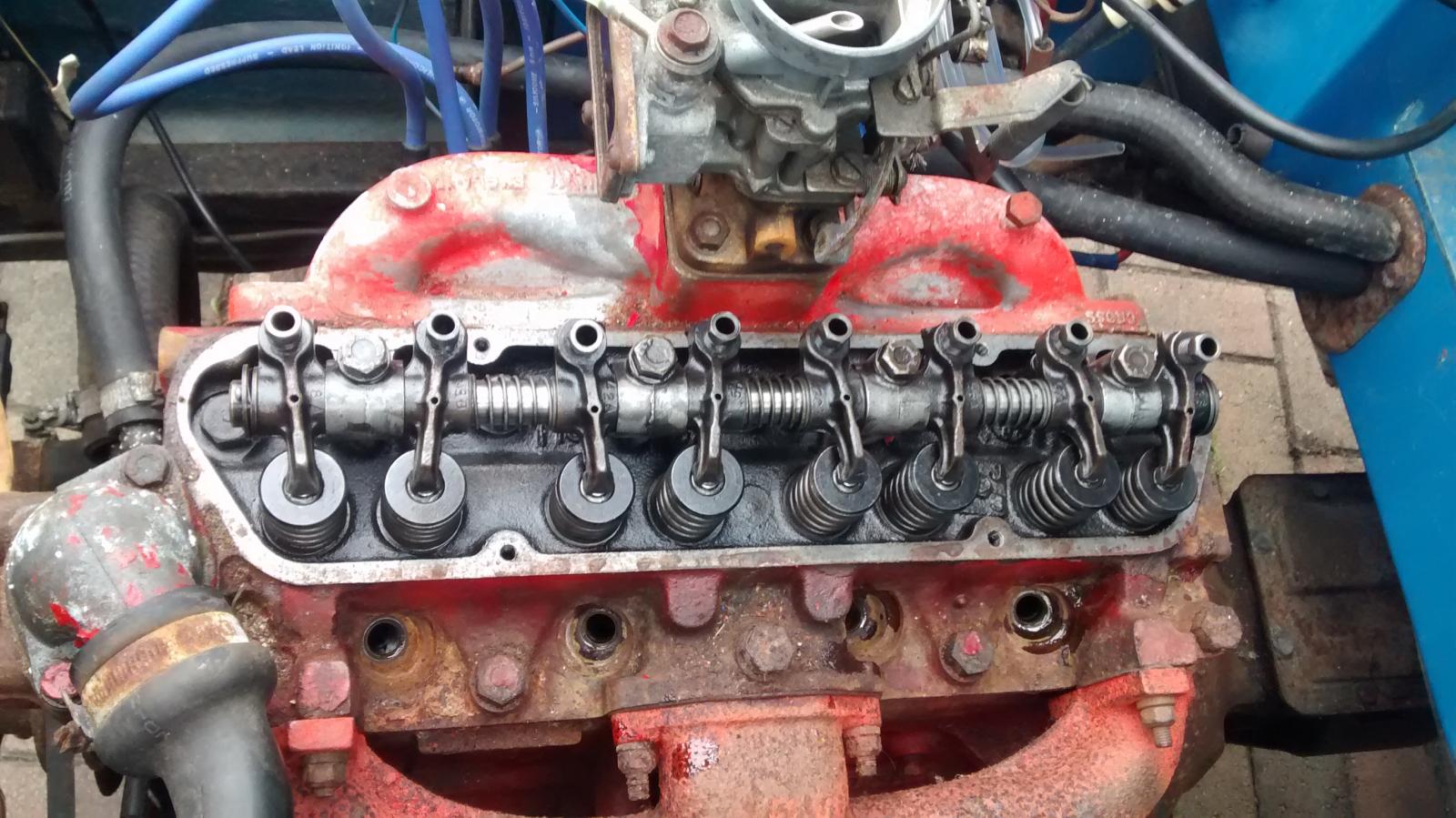

Next up, remove rocker cover. This is held down with 4 phillips-head bolts/screws. These were torqued down to 'toddler' plus a 1/32th turn.
All looks pretty clean in here. I'm pretty pleased with that.
Observe my testing
Seems Ok right?

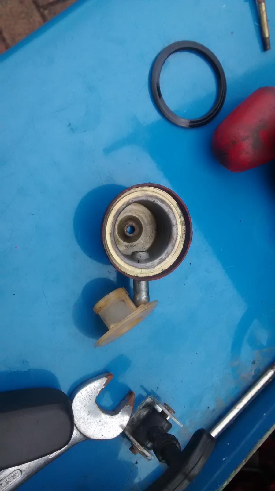

Next up, have a good look at the fuel filter as fuel was coming through very slowly.
Also reasonably clean - I gave the filter a blast out with carb cleaner and a wipe over with a rag and refitted it. Is there any more you can get to other than this?

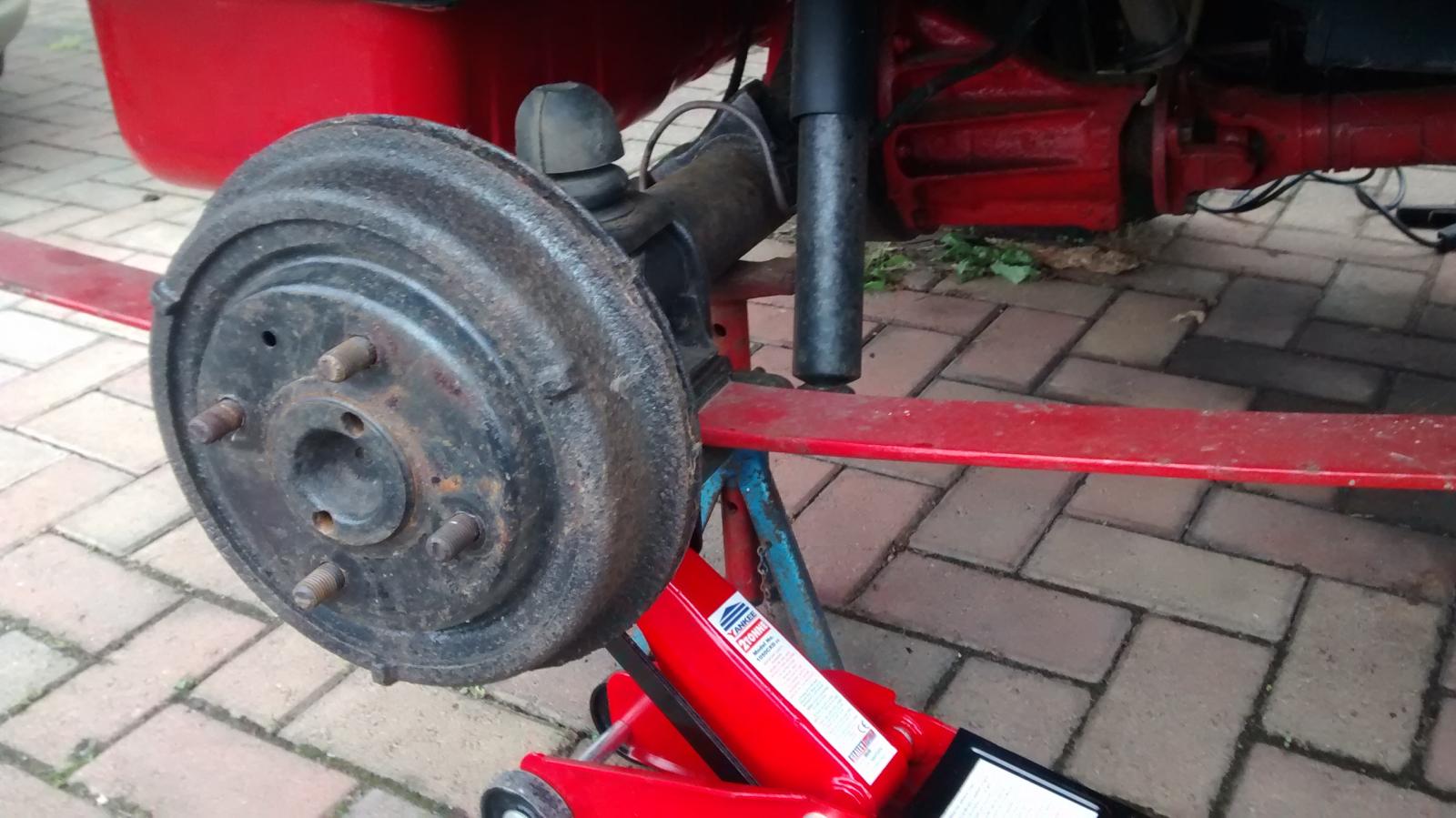

Next up, the rear brakes. I whacked out the trolley jack and an axle stand, jacked it up and put the stand in place

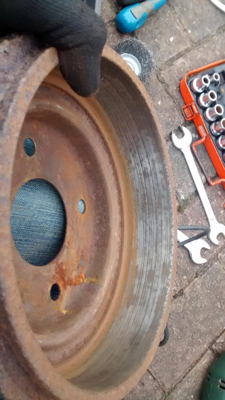

Wheel off, which was a piece of cake, and then used a big screwdriver to gently lever the drum off the hub
BOIIIING

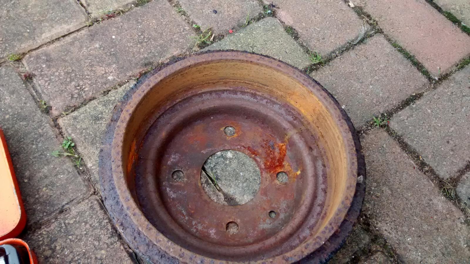

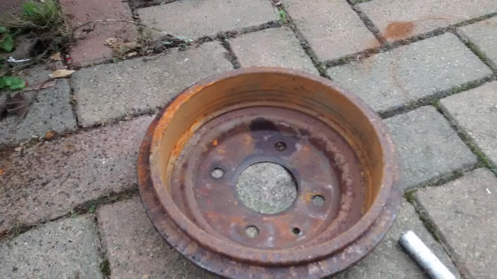

Well, thats not very clean is it?

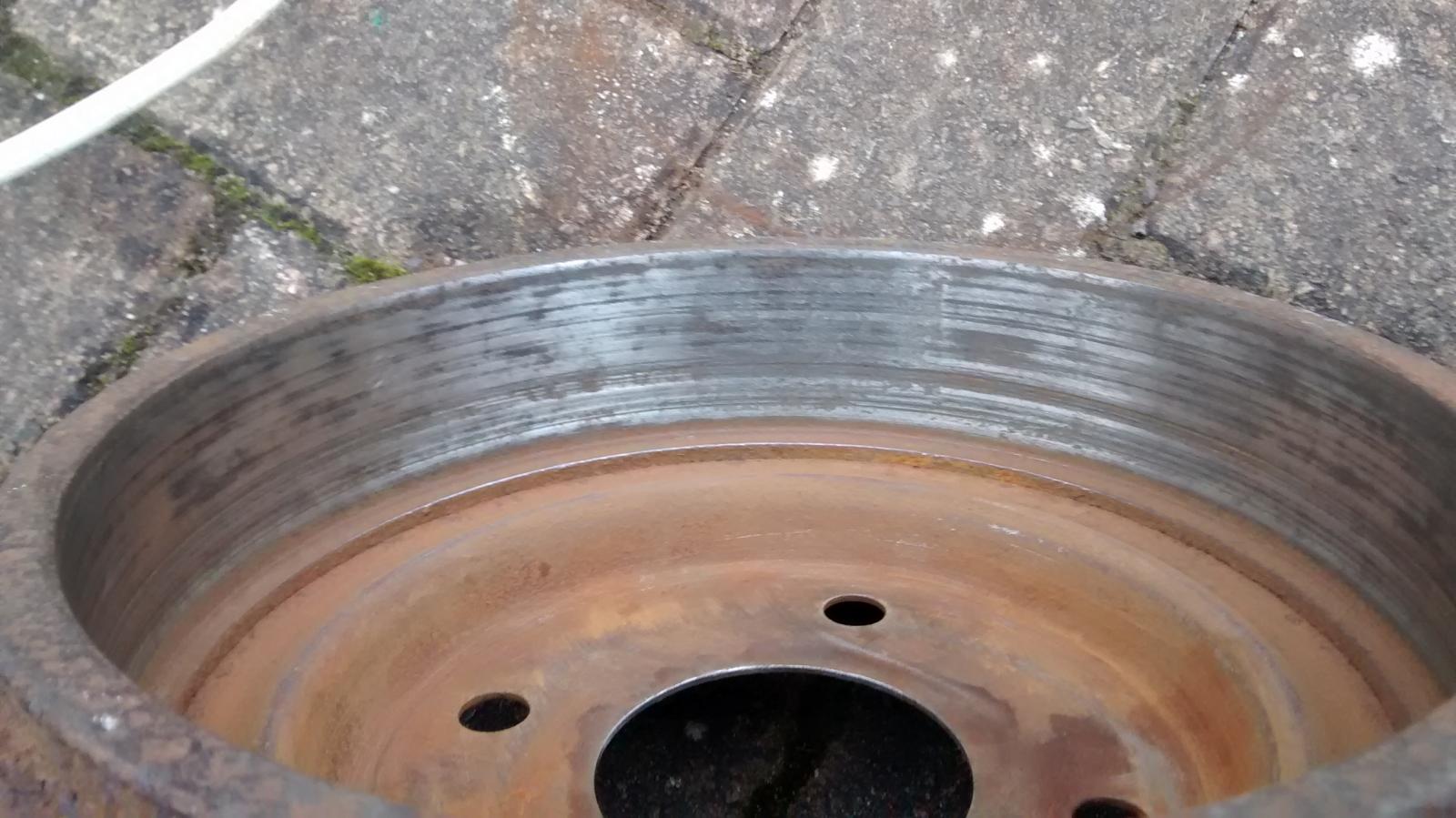

I broke out the sandpaper and gave it a good seeing to, then got the flapwheel thing for the drill, held it down and tidied it right up

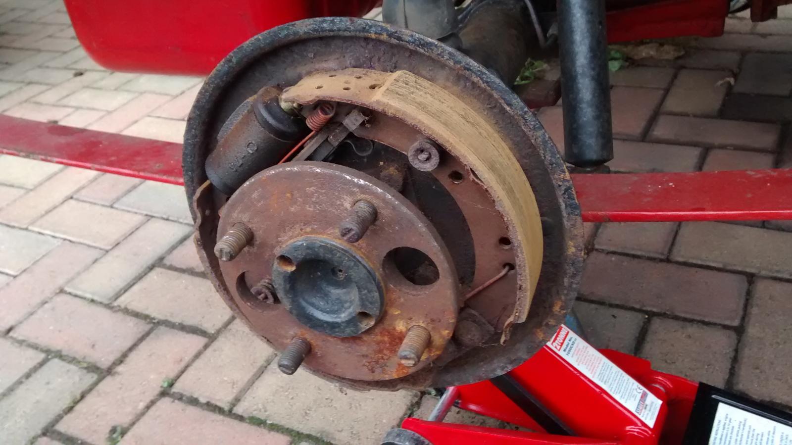

Lots better I think? No scoring and back to clean metal. Next to be looked at was the shoes, cylinder and general insides of the drum.

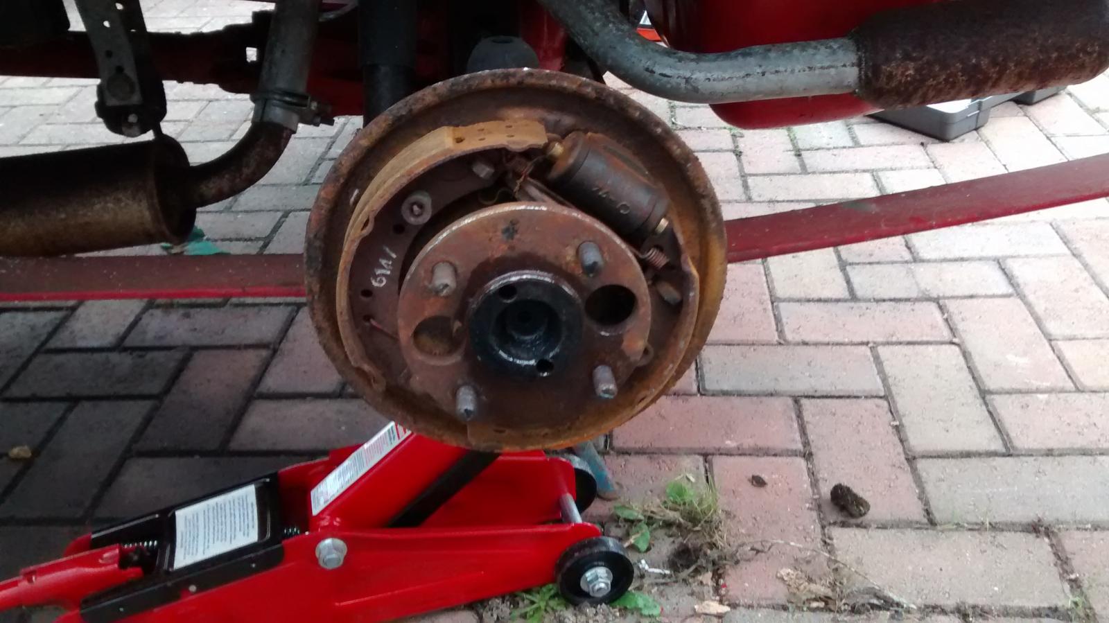

Not too bad on the drivers side. the cylinder still worked as the handbrake operated on this wheel fine, I gave the shoes a going over with my wire brush to clean them up and abrade them a bit. Loads of rust came off but I gave it all a good clean out and replaced the drum and whacked the wheel back on, copperslipping the wheel studs and the edge of the hub as it fits into the drum very lightly as i suspect they will need to be back off again at some point.

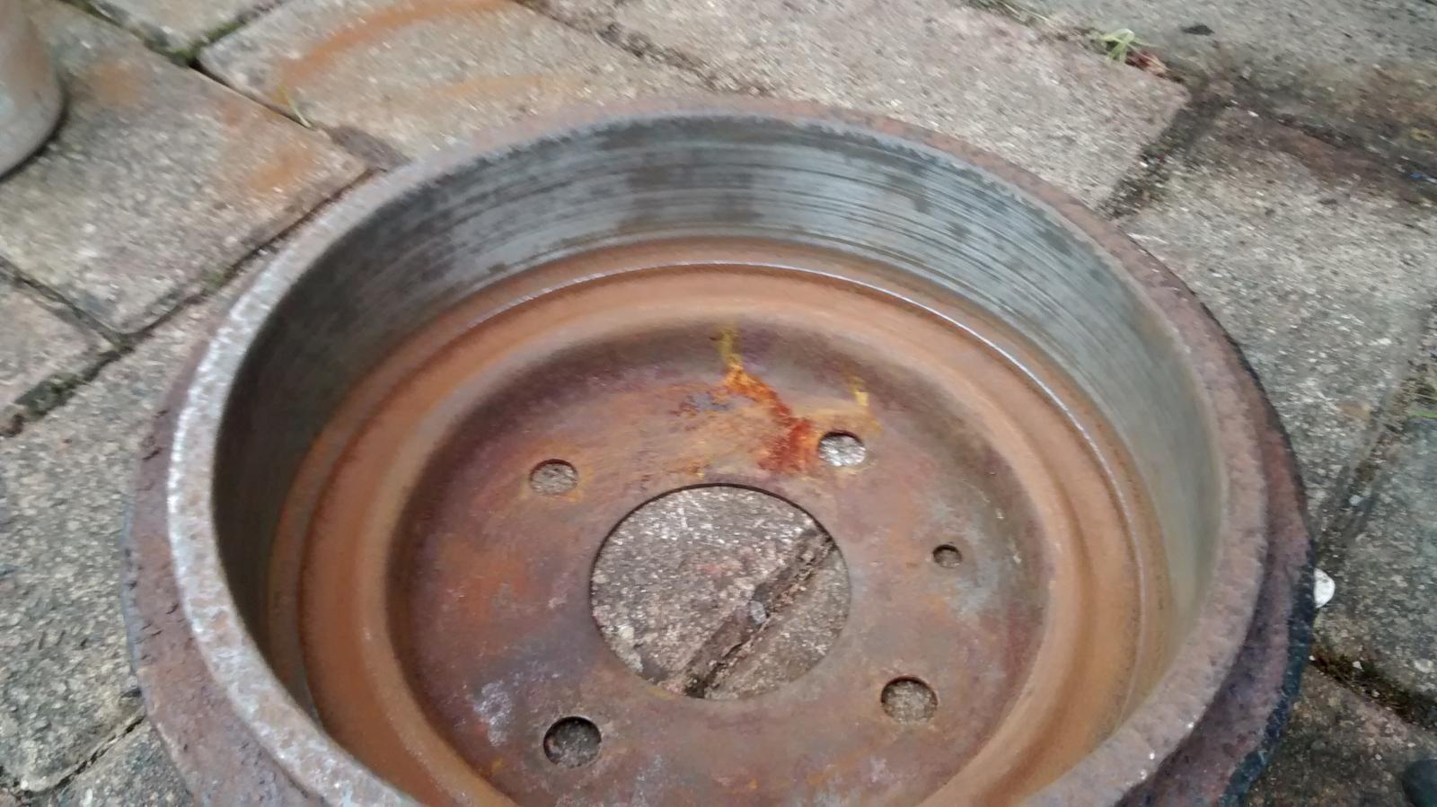

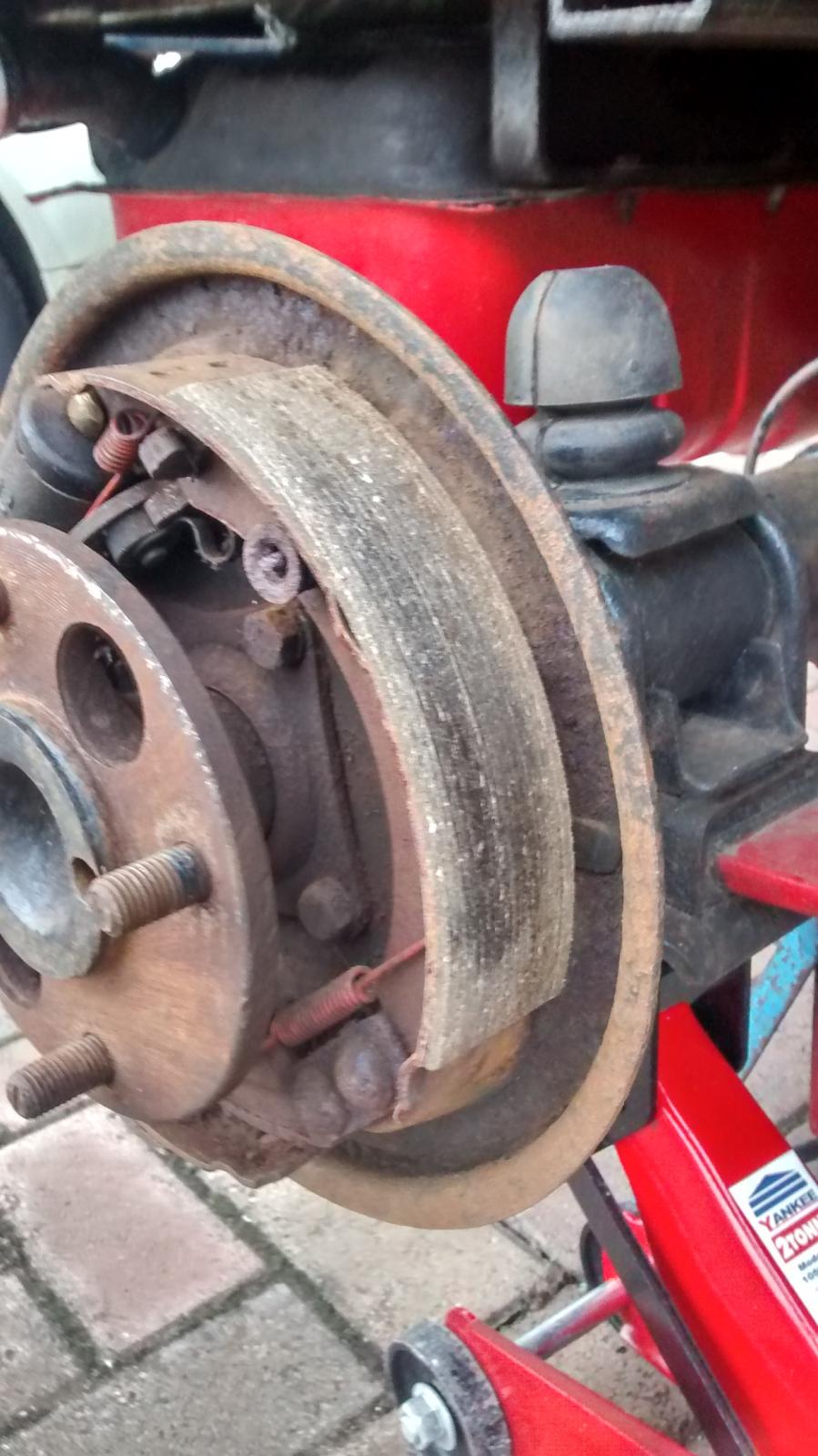

This was a complete c-unit to remove. I tried to replicate the success on the driver side, but the drum was very very well corroded to the hub. It took ages gently levering all round the edge, then trying two screwdrivers on opposite sides, then penetrating oiling the hub/centre bore of the drum, then going round tapping it with a hammer, then gently chiselling the join, then more oil, then more hammering, then I swore a bit, and everntually managed to lever it off after about 20 minutes. It might have come out quicker if I'd been more viloent but I really didn't want to break the drum.
This one was even more rusty, I'm not sure why really, but it was. I gave it the same treatment as the other side
Much better. The shoes got a going over with the wire brush, when I'd finished it did dawn on me that there was quite possibly asbestos in the friction material but it was too late by this point. I was mildly dismayed to find that the cylinder in this drum did nothing on application of the handbrake. Absolutely nada, so its possibly seized? Can they be replaced?
As there wasn't much else I could do I put it back together and lightly copperslipped the threads the wheels go on, and the bit where the drum and hub connect. Looks like it needs a new cylinder, or this one freeing off or something. So at present we have at least 25% functioning brakes which is a plus.

Are you sure the handbrake is supposed to operate the wheel cylinders? I would expect a cable operating a lever that acts on the shoe.
I can't remember if you've checked the brake fluid level, but if you suspect the cylinders are seized try pressing the pistons in with a clamp.
Ah, thats good - the handbrake definitely doesn't do anything on that wheel when applied, but I can take it apart again and see what it does do when the handbrake is applied.
On the Invacar, there's a cable-operated lever that slots into the bottom of one shoe. All simple stuff.
Which is why it's all the more annoying that removing and refitted shoes somehow manages to be a complete trial for me.
Yes its just the levers at the side of the wheel cylinders for handbrake.
Usually seize up on the rivet, need to disconnect the cable and take the lever out and waggle it about.

Handbrakes have to be separate to the normal wheel brakes. MOT & other regs say it has to be a secondary braking system rather than part of the primary.
