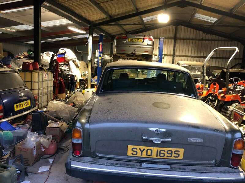

One day last week it took me over 10 minutes to find a 13mm spanner despite having loads of them, so decided that the time to tidy the shed had finally arrived. To make it easier I decided to move the Bentley (parked on the ramp) and the Saab parked behind it outside to give me more space. The Saab had been sat for 3 weeks and the Bentley about 6 weeks. The Saab started instantly and stopped just as quickly, with no sounds from the fuel pump and refused to restart, but the ignition switch started to stick as well. I towed the Saab out of the way, the Bentley started easily to be driven out and the Saab pushed onto the ramp for investigation

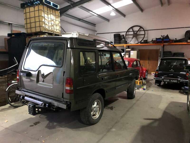

The Bentley was returned as the tidy was postponed sadly*, this picture shows why the tidy is needed

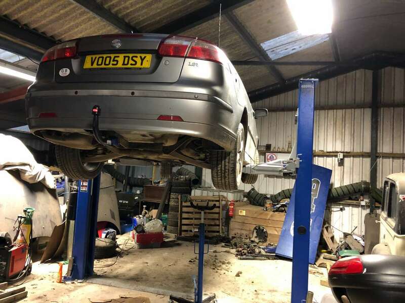

A check showed no power to the pump and putting power to the pump directly had it running. The Ignition Switch Module (ISM) on these Saabs are standard across the range so the one out of the diesel spares car was removed and fitted but made no difference. Googling showed nothing else but an enquiry on UKSaabs told me there is a relay in front of the A pillar on the drivers side, so that is the next job as I ran out of time as I needed to load the Smart 4-2 for delivery to Rotherham. It had not moved for 2 years so three of the brakes were stuck, but wheels off and a hammer had them turning.

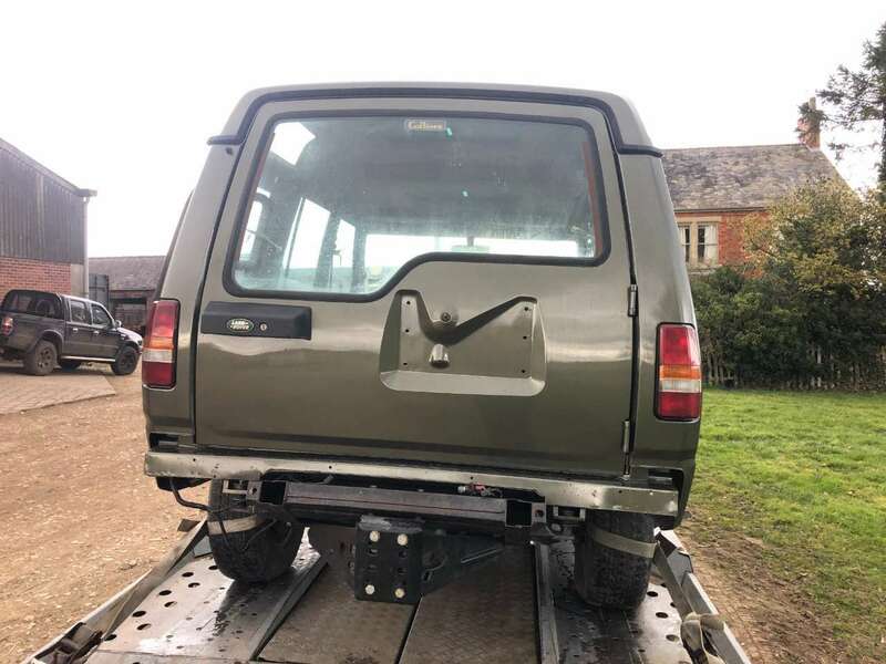

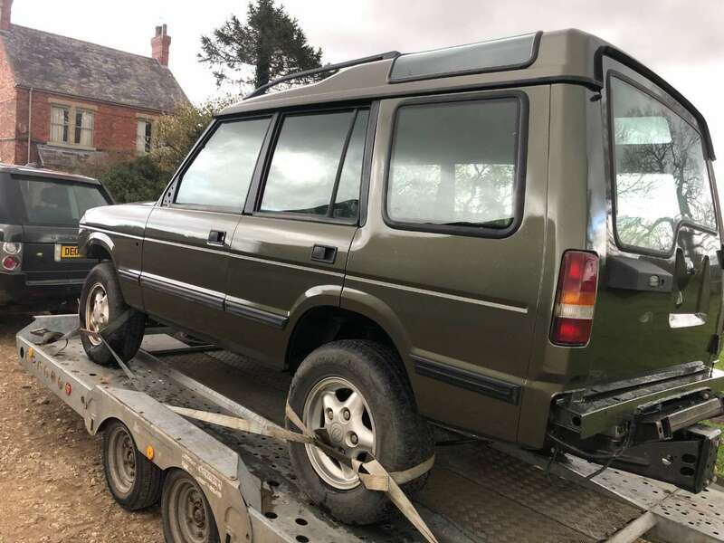

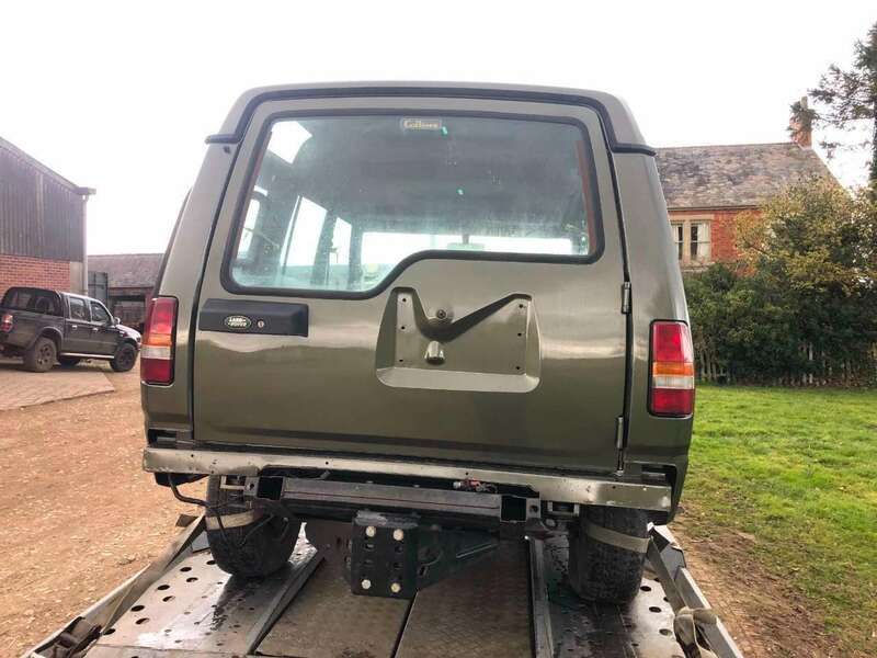

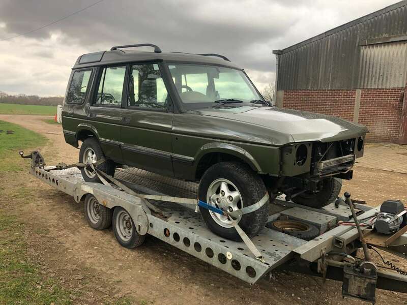

That is the 4th vehicle to leave the fleet this year, so things are going well. With an empty trailer it was time to collect my Disco 1 which had been away for a full respray. To say I am delighted with the result would be an understatement and the cost was extremely pleasing as it was less than 25% of what I had been quoted locally!
Yesterday it returned to my friend in Perth who did the welding, and as soon as he completes recommisioning a Corvette for another friend, we will start putting it back together.

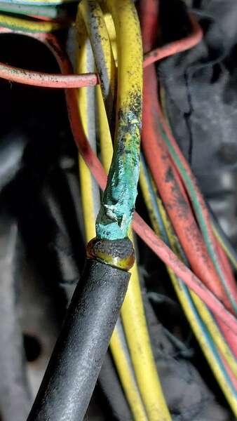

The Saab was duly loaded onto the trailer and taken over to my friends. Due to non running and non stopping, I had to reverse the trailer into his unit and up to the ramp which is very tight and was delighted when I got it there.  Next day I collected the new callipers and dropped them off with my friend, who had the car running! When I swapped the relay, I had checked power was getting to the relay (12V) but not to the connector before the pump (0.4V) so had concluded it must have been the wiring between the two so through in the towel. Simon, being wise did not trust my diagnostic ability and checked himself and got the same result (Hah!). The difference was he then checked it under load, at which point the voltage dropped to 0.4V meaning the fault was before the relay!
He eventually found the fault, but god knows how! I would not have found it in a million years and would have no doubt ended up scrapping it. Within the loom, under the battery tray and still sealed in the original wrapping, he found a section of corroded wire
The black bit is just a loose section of sheath, the wire itself had no connections there. The wire a couple of inches either side of it is like new when stripped, clean and shiny. The only explanation we could come up with is when new, tht piece of wire had a nick in it and it has slowly been corroding ever since, but who knows. He let in a new section and all is now good again. Simon called me late Friday to say the brakes were also done so I can collect it tomorrow.

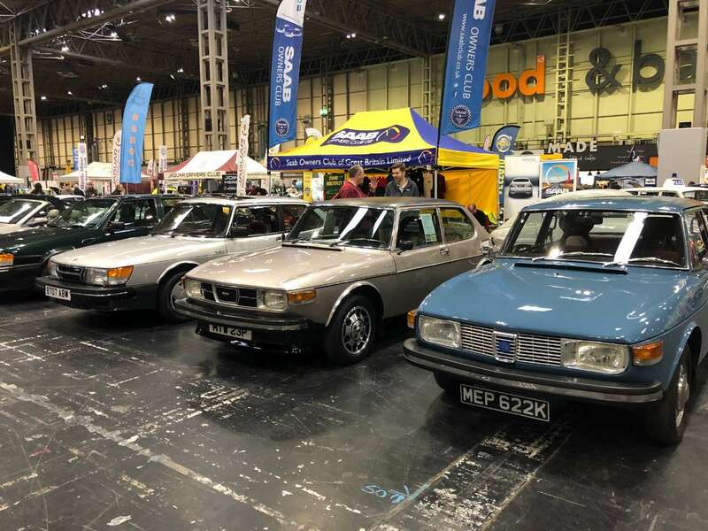

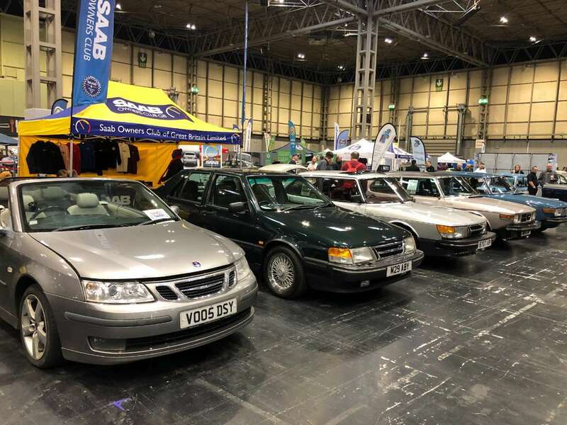

Firstly it was good to meet up with a few Shiters at the NEC over the weekend of the Classic Car Restoration Show. For a change this year we stayed in the Ibis in Coventry Central as it was a cheap 10 minute train ride to the NEC and a lot cheaper than our usual Travelodge at the airport which had increased in price a lot this year. It also had the advantage of being a few minutes walk from some really nice pubs.
As usual UKSaabs had a joint stand with the Saab Owners Club and this year I took my 2005 9-3 'vert as I needed to dash home on the Monday before flying back to Norway on Tuesday. This limited oportunities to work on the car, apart from putting the several acres of plastic back into place in the interior that I had removed whilst electrical fault finding, I also decided that the headlights really needed a polish as they looked like this

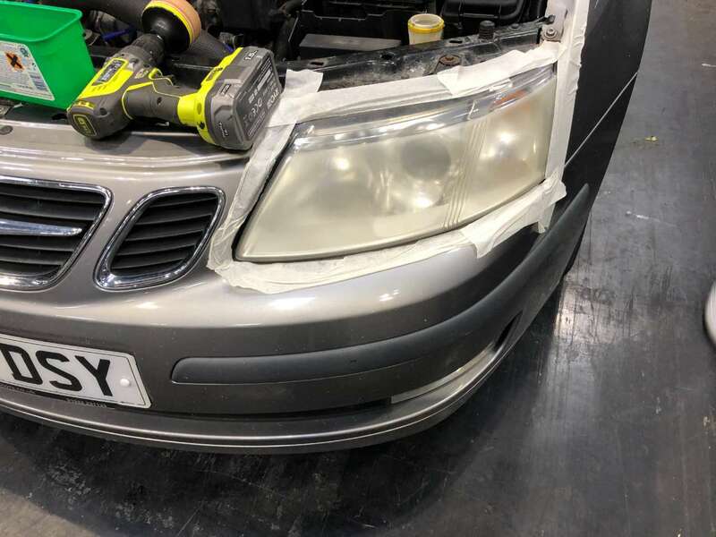

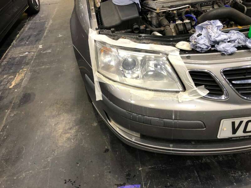

I blew a whole ten quid on one of ebays finest polishing kits. Part way through
Overall I have to say I am impressed, and only used half the kit so I can do another vehicle.249928154_IMG_00731.thumb.JPG.44763f443bb139d8776acdc966f1bb5f.JPG

Another couple of stand shots

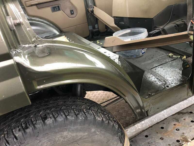

Whilst I have been away and @GingerNuttzhas been keeping me sane with pictures of progress on my Rover P5B, my other friend has been quietly putting this
back together again after its recent weldfest and respray. I have not wanted to ask how he was getting on as the plan is for me to go and help, but being away is making that difficult. Today, out of the blue, I received this in an email

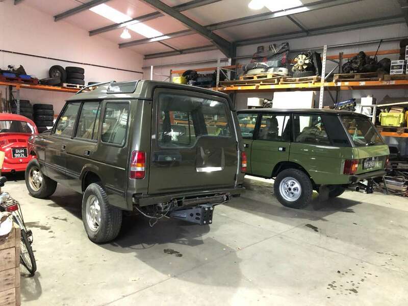

My friend has just sent a picture from his phone. The MOT man has been a tester for 10 years and says this is the best one he has ever seen.
I really like discoveries.  That one looks excellent 👍
That looks gorgeous. I imagine you'll never sell it, but if you did, it'd be worth a fortune and I'd be very poor
