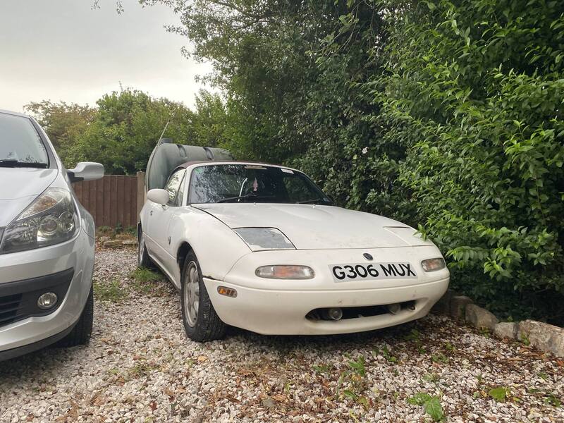

Today I needed to rearrange the drive to accommodate the new vehicular arrival tomorrow... I had to use the road as a car park for a bit.
This also meant starting the Mazda for the first time since I got it home
It started well, and ran well... I was feeling optimistic. So I let it get to temperature and still it seemed ok... no blue smoke no misfire. Maybe it was just one if those things....
So I braved a little run to the road... within a quarter of a mile I got the feeling that something wasn’t right... it was popping and banging on any slowing down. A quick glance in the mirror showed blue smoke billowing... Shitsticks...
Turned around and made it to the drive where as I turned in it died.... I got it going again and parked it up in its new spot. The smoking was pretty bad... so bad that it disturbed a was wasps nest in the Bush behind its parking space...
Bugger.
Is it fucked?

If low on compression measured with a decent compression tester, chucking out blue smoke and PCV is good, low down on power and misfiring enough to bang ... then it does sound fucked.
How much do you love that particular car? If a lot, then engines look to be available for under 300 quid.
If not, then sounds like it's at the end of its life. There are plenty of good MX5s still around and affordable if you wanted another.
Nah, quick strip down and re-build, right as rain M9
Yeah, if the MX5 is solid then it needs to live on! It should be easy enough to get an engine from a rusty one.

I’m not certain of the quality of the compression tester as I wasn’t there when it was done, so I think I’d want to do another one to be sure. But to be honest my wife’s uncle who did the compression test is likely to have done it properly, he really does know his way around an engine!
Excuse my thickness (it’s early and I haven’t had much sleep) what’s PCV?
Whatever the weather be a shame to scrap, it’s one of the 200 oldest ones in the Uk and it is generally pretty solid. Whether it’s me that fixes it is another question...

Only say, as said earlier in the thread that the generic red/blue box unbranded ones off eBay are crap. Usually give inconsistent readings and a good 50+psi out.
Lives in the rocker cover.

Actually a quick google at failure symptoms suggests that’s a real possibility....
Thanks @SiC
Three main issues that will cause these oil burning antics I reckon.
Bad pcv (least likely but possible)
Knackered valve stem seals
Worn and past it oil control rings on the pistons
Or you have really crap oil in that's sat there for a century and it's gummed the rings. Engine flush (with flushing oil) and a decent thick oil may fix.
As the PCV is likely the cheapest option I’ll fix that first! ?
Also check the timing.  If it's jumped a tooth or two that can cause all kinds of antics.  Including low compression obviously, and can massively exacerbate any other weaknesses of the engine.  It can also play havoc with the fuelling so smoke can be a symptom... doesn't take much oil getting in to make that more blue than black.
Do you have or can borrow a timing light?
Another good suggestion... timing is something which has been suggested by my tame MX5 specialist too (I’d forgotten that suggestion in the excitement of new acquisitions), although seems odd that it would run fine until warm. But I’ll check it nonetheless.
 Don’t have a timing light... I’m sure I can either purchase or Borrow one.
