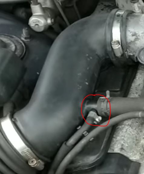

Hai DW.
I just watched your alternator replacement video and managed to snip the screen when you were naughtily displaying some engine porn.
The S-shaped bit is the bit we (i.e. my father and I) replaced, because the smaller bit attached to the part circled in red snapped off and created an EML light via a vacuum leak of sorts and, in the right condition, a moshing rev needle.
This may explain why the jubilee clips look so shineh.
