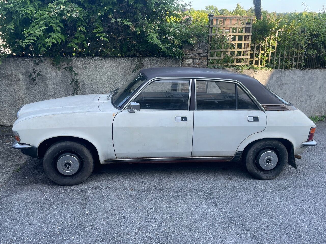

I havent taken any photos, but the white VDP is up on stands, the hoses to the rear displacers have had their connections doused in plus gas. And some second hand replacement hoses have arrived from the hydrogas specialist people. The underside looks really sound, wants a bit of wire brush and por15 or something like that. “better than it looks” definitely applies to this little allegro.
They seem to have bred as theres another on its way
oh dear! Pass the meds, matron!
From the garage update- i changed the split flexi hose and used a £40 hand pump i got off e bay about 7 years ago. Looks like its  been made diy in a shed, out of a grease gun. It was partly  seized up. Not a good start. After one million hand cranks from zero pressure- one  side is now at the regulation ride height. Half way there!

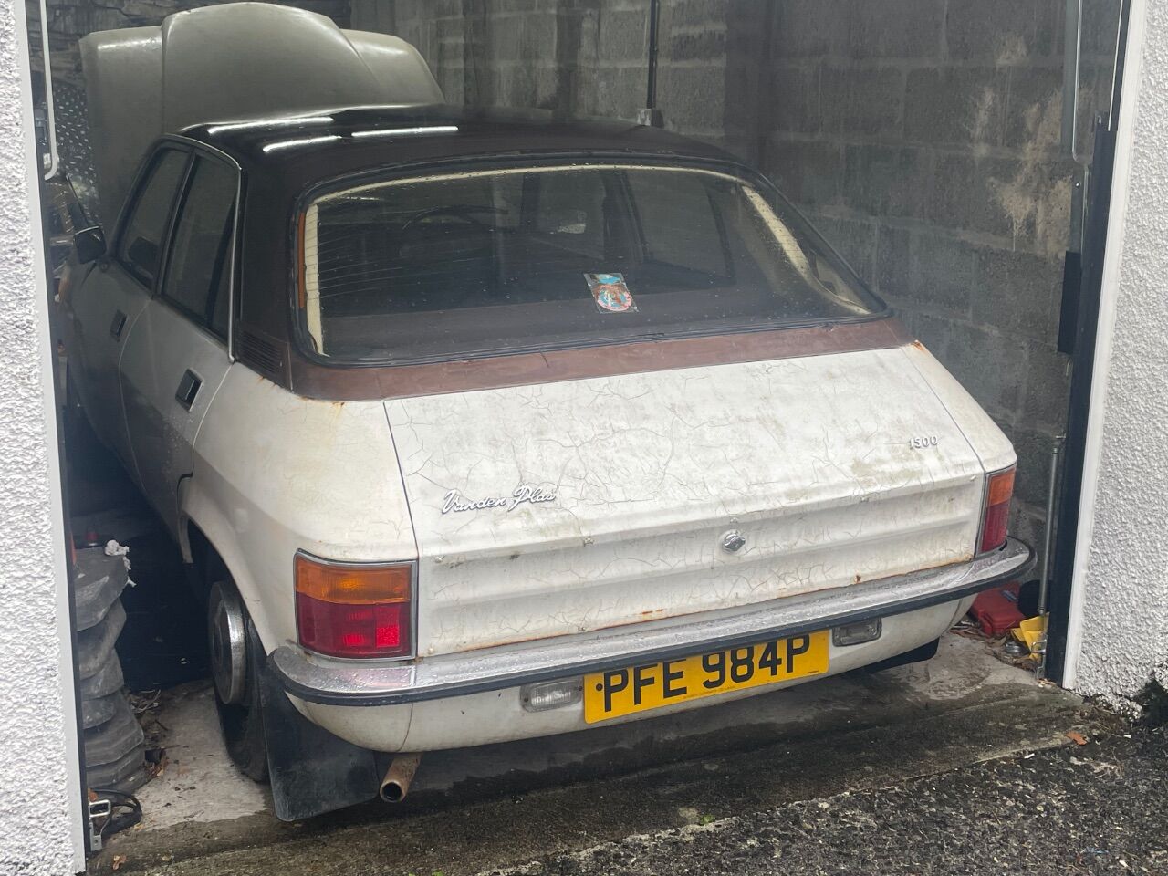

PFE984P is a modern age relates plate, coupled with the fact that it has an actual date of first registration record of 4th of August 1975, I would say, its an import from either Ireland or one of the channel islands?
(its a P suffix car, so it would of been computerised from new, thus there would of been a record in the archives as they say, even if it was laid up the day after it was registered, there would still be a record that could be revived with a V62, so I would not expect a laid up vehicle to have an age related plate like this and separated "date of first registration" & "Date of first registration with the DVLA" listings, thus I dont think its a laid up car situation)

Swapped the other flexihose over and started with one million cranks needed to pressurise the system on the opposite side with my feeble modified grease gun . Gym membership not necessary. Nothing doing.
Had a look underneath and the metal front to back hydraulic pipe is leaking - looks like corrosion. Progress, and a diagnosis. I wonder if these are even available?
2024 photo when it was decomposing on wasteland (looks the same, minus bush and with it listing over to one side)
