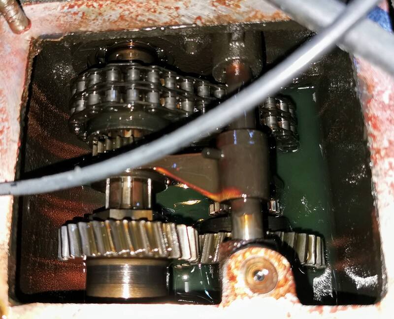

I had a bit of a moment of realisation today, in that while I had changed the diff oil and topped up the gearbox oil, I hadn't actually changed the gearbox oil - because there's no drain plug (not massively surprising as there's a diff in the way).  I'd always intended to vac the oil out to change it completely, but according to my whiteboard it hadn't yet been done.  Until today.
The oil in general wasn't bad, but it looked like there was some darker gunk removed from the bottom.
Ever wanted to see what's inside an Invacar gearbox?
Then with nice fresh oil in.
The oil may well be nearly as old as the car for all I know.

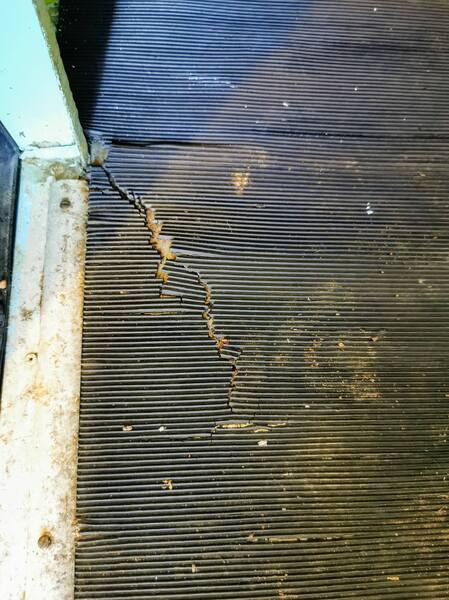

I really want to get the floor covering sorted out.  The rubber matting really is shot in my case.

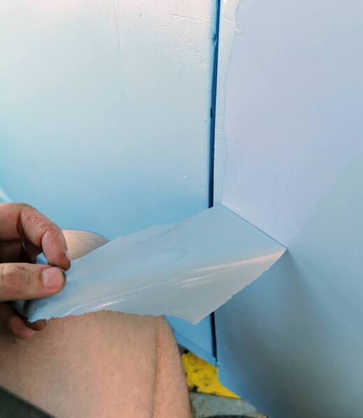

I definitely will be reverting to my earlier approach where paint is concerned...Not so much because the new paint has adhered so poorly to the existing paint in some areas, but because the finish there was so much better.
I've learned a few things since I started out, so we should be able to get a better finish now than we originally saw.  The car's also generally presentable enough that I don't mind doing a bit of work panel-by-panel going forward.
11 minutes ago, egg said:
To be honest I'd rather switch to carpet.  The left/right striping in this stuff makes it bloody slippery in the lateral direction and I've nearly landed face first on the tarmac on a couple of occasions while climbing out if my shoes are slightly damp.  Plus I think carpeting will help tame down noise levels in the cabin a bit.  I'll be going with something very low key, probably a dark/mid-grey with a short pile.  I want to actually use this car and this is the sort of thing which will make it a more pleasant place to be...There are plenty of mint condition examples in museums for folks to look at if that's their thing.
Given the cars ahem weatherproofing,I'd be inclined to go for some sort of marine carpet
maybe some adhesive soundproofing then the carpet on top?
To be fair, even in the biblical downpour yesterday there was only one drip landing on the floor.  Given what I started with I was quite surprised by that.  To be honest I really just ought to get the screen seals both changed and be done with it.
The main points of ingress are limited to the doors themselves which I have a plan in place to deal with.
She lives in a bone dry well ventilated garage though so any damp which does occur while out shouldn't linger.
I need to have a think about sound deadening.  The main reason I'm not planning on too much of it is simple: weight.  There are several aspects I want to address in turn.
[] Floor.  TPA has had the aluminium replacement floor panel fitted.  However this is simply riveted in place in maybe a dozen places around the outside.  The rest is able to flex and clatter against the chassis underneath.  You can make comedy wobble board noises by placing your foot in certain places.  That can't be helping anything.  Once the rubber mat is removed that will be getting securely fastened to the chassis across the whole length and width.  The underside will then be absolutely drowned in underbody wax to help further damp anything which might think about rattling.
Yes galvanic corrosion could be a long term worry...but even if the floor panel did rot out, it's a totally flat piece of ally sheet that's riveted in.  Hardly the end of the road to change.
