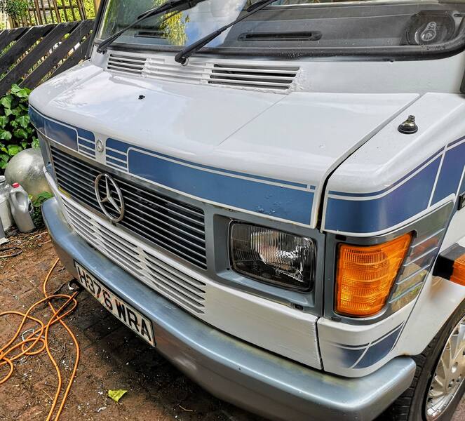

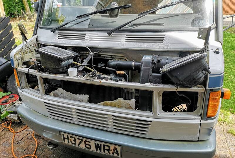

Some very quick and dirty paint applied to the front of the van.  I've got some blue that's a pretty good match for the vinyls so I'll repaint those areas in shortly.
It's not pretty by any stretch of the imagination but I think looks a bit less horrendous than it did.  Doesn't need to last forever given that both of the panels involved will be replaced eventually anyway.  At least the rust should be a bit less conspicuous at a passing glance now.

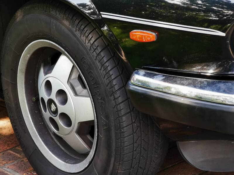

Today I set about giving both the front and rear screens on the Jag a treatment of Capt. Tolley's Creeping Crack Cure to hopefully resolve the issue with water seeping in between the screens and the rubber seals.
The driveway being on a slope is a pain when doing this as it tries to run to one side because of the slope.
While I was in the vicinity of the rear windscreen I took a brave pill and poked at the rusty blisters at both lower corners.  I was honestly expecting to wind up with holes in this panel (and know full well what an utter swine it would be to repair).  Mercifully the metal was still solid if somewhat pitted.  This was rubbed back a bit then liberally coated with Vactan.
I'll give it another couple of coats before getting some top coat on there.

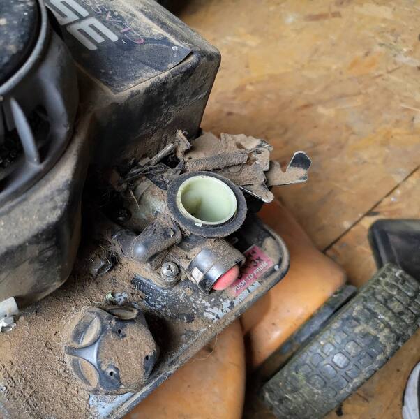

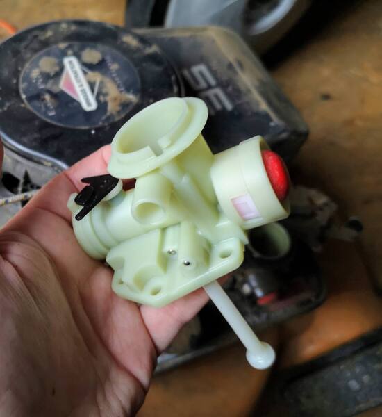

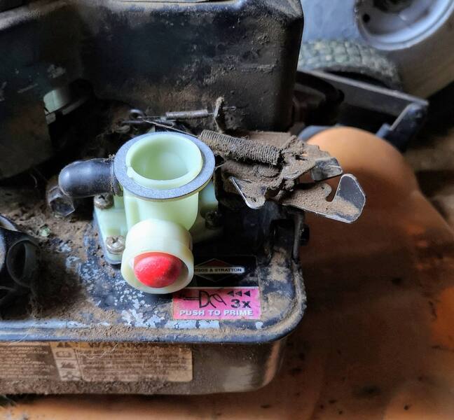

A couple of weeks ago our lawn mower started playing up, and no amount of cleaning the carb would restore normal behaviour.  It would run fine for about 30 seconds then start behaving as though it was running out of fuel.
I was about to order a carb overhaul kit before discovering that you could get a whole genuine Briggs carb for less than £20...Which makes spending £12 on an overhaul kit seem a bit pointless.
Ten minutes later the new carb was fitted.
Based on comparison of what came off and what went on it seems that the diaphragm which serves as the fuel pump has gone hard and plasticy probably resulting in poor fuel delivery.
While it was pouring with rain so I wasn't able to really test it under load, it started first pull and was happy to run on both idle and run settings, so it *looks* like we've solved the problem.

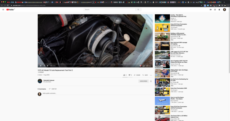

On 7/23/2020 at 11:07 PM, LightBulbFun said:
ah interesting :)
yeah was just a thought on my part, I dont know exactly how Model 70's where setup in period whether they where run lean or rich or such

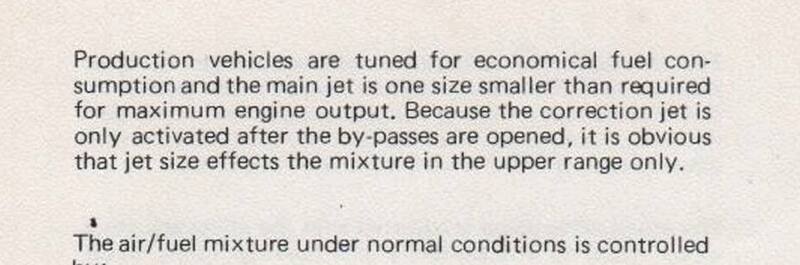

Well this paragraph from page 28 of the manual gives a good clue...
oh interesting :)
although do keep in mind thats from the Steyr puch engine service manual, section, which Is directly from Steyr puch and I dont THINK its Model 70 specific, im pretty sure for the most part they took the english Steyr puch service manual and just stuck it into there so to speak
so Its worth keeping that in mind when reading through that section of the manual, that there might be some discrepancies because its not Model 70 specific
certainly for example it says the webber carburettor is an 32ICS3 but as mentioned I have never seen a Model 70 with one (although as mentioned I have sadly not been able to go over an early Model 70 in detail yet, the Manual is from 1972 and the earliest Model 70 drive train I have been able to get a somewhat detailed look at is the one in TPA which is from KPL from 1975)
although in this case, the above you screen shotted is probably fairly accurate, I doubt they specifically fitted performance jetting to Model 70s or such LOL

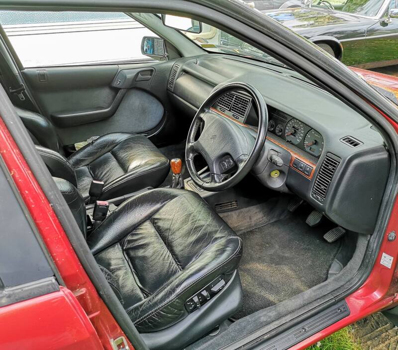

After what seems like forever I finally have this bush for the Xantia's suspension in my hand.
Despite coming from an eBay shop which didn't mention the name anywhere, it came in an AutoDoc box with an AutoDoc invoice...I'd never normally voluntarily buy from them given the history of sending out completely the wrong part that's on part with Euro Car Parts...However it appears that this is actually correct by some miracle.  While changing it looks a deceptively simple job, apparently getting the old bush off can be a right pain so I'm sticking with my decision to get the garage to do that work.  It's booked in for a week tomorrow, and I'll hopefully have the car back a few days later with a fresh MOT.  Only taken me eight months.
With the Xantia heading in for remedial work and an MOT at the start of next week I figured it was probably time to set about removing the cobwebs and pine needles from the interior.  I always try to present my car for the test in a reasonable state as I figure making a good first impression can never hurt.  The tester jumping into a car that's obviously cared for despite being worth about the same amount as the fuel in the tank is always going to put him in a better frame of mind than one he has to don full hazmat gear to get into.

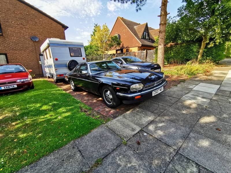

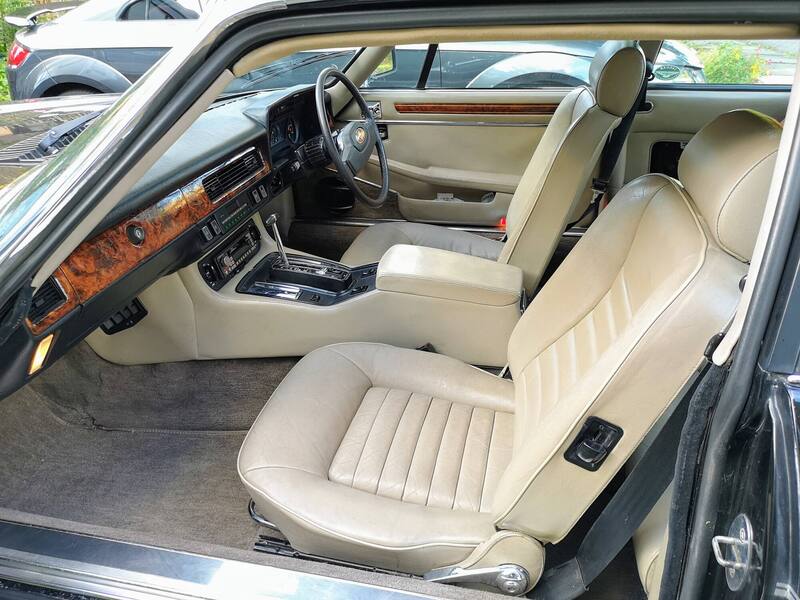

While the clearcoat peel let's the exterior down the interior still scrubs up will for a 24 year old, 140K mile car.
Gave the cab of the van a quick scrub up too as it was really dusty.
Really do need to do something about the threadbare carpet on the engine cowl.  If it wasn't glued on I'd just remove it and have that match the rest of the dashboard.

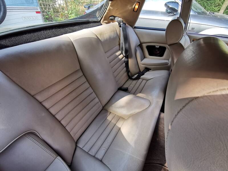

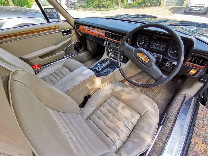

EDIT: Went back out after dinner and gave the Jag the same treatment.

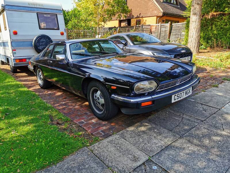

The exhaust on the Jag is definitely very much more throaty now - maybe a little on the loud side but that may tone down a little bit yet - it's a noise which still fits the car though so I'm happy with it anyway!  I'll try to arrange a sample of some description for you lot later today if I can.

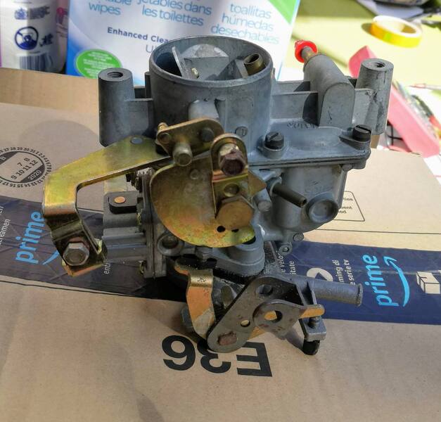

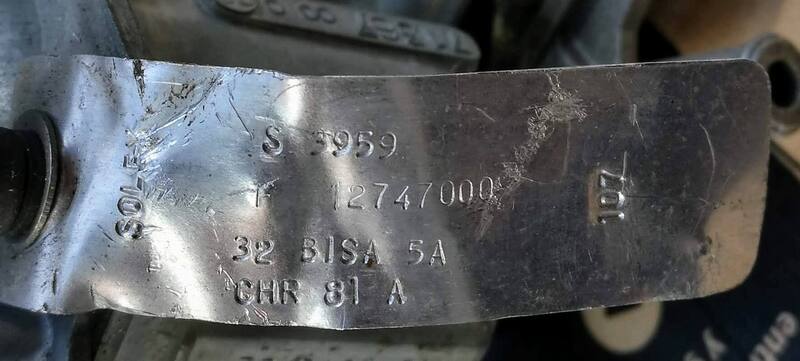

Had a parcel arrive this afternoon that I'd forgotten about since I last mentioned it a few days back.  This is what it contained.
Here's the data tag for those playing along at home.
This is a new old stock 32mm Solex carb.  It has the same throat size and stud spacing as the Weber 32 ICS carb on the Invacar - albeit with the base rotated through about 45 degrees.  So if this stays on the car I'll need to make an adaptor up - not that it will be difficult.  Just needs a metal disc with one hole in the middle and four smaller ones at appropriate places.
There was nothing really in mind here other than experimentation in the sheer spirit of curiosity.
Turned out the most difficult thing to get my head around for an initial test was figuring out how to actually bolt it onto the manifold.  The original Weber carb has studs attached to it.  This one has two holes to allow it to be bolted down or to fasten onto studs on the manifold.  Just bolting it on however was made a bit tricky by the fact that you can't slot a bolt in from the top because the top of the carb casting is in the way.  You can't slot it in from the bottom because the inlet manifold itself is in the way.  After a bit of head scratching I cut a couple of bits of threaded rod to size and put nuts in both sides to clamp it down.  That took me far longer to figure out than it really should have.
So what happened the first time I started it up?  I wasn't honestly expecting it to even start.  This was literally the carb as it was out the box - all I'd done was to blank off the vacuum feed for a distributor advance unit.  Apologies for the horrible camera work, you're listening more than watching to be honest though.
Well I think that's got promise!  The throttle response is immediately obviously far, far snappier.  Cracking the throttle open would usually result in quite a gaping hole in the carburation until the engine picks up, with at least the occasional sneeze back through the carb.  I think we might need to cobble together a connection to the throttle to see how it behaves under load.  The engine this carb was originally destined for was an 1100 I believe, so the per-stroke fuelling rate should have been pretty similar to what we would have been looking for here.  Should be an interesting experiment...Initial indications seem to be positive.

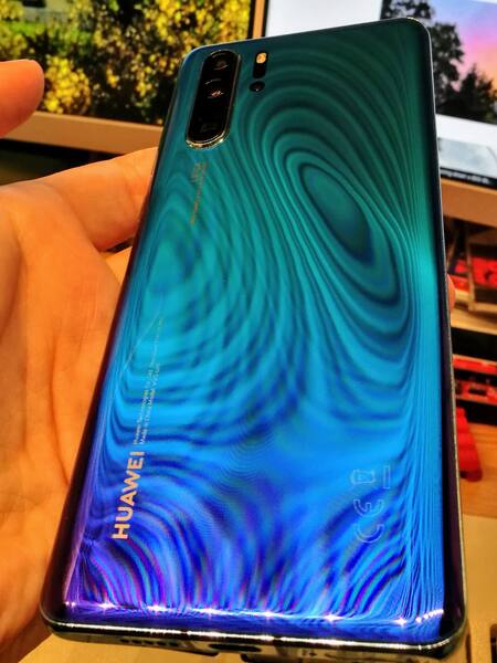

New phone arrived earlier and I've just about got everything set up now.  I deliberately didn't just have everything transferred over automatically as it's a good opportunity to weed out some software I haven't used in five years.
Camera looks to be all I've come to expect from Huawei these days.
Hey look... actual optical zoom with proper optical image stabilization.
That's taken standing in exactly the same spot.
Oh...we have a wide angle mode too.
That's not so big a deal outside generally...but where it will be bloody handy is for things like vehicle interior shots.  Here's what I mean...

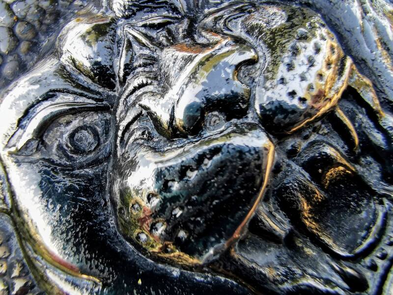

Jag bonnet badge:
Xantia tail light:
This will be fun to play with...

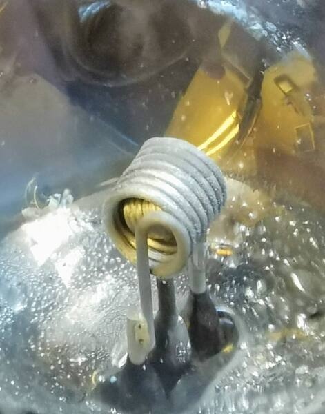

do you have a SOX/SLI lamp or the MA/V lamp on hand?
would be interesting to see how well it could do a macro shot of one of its electrodes :)
BTW dont forget to set the video recording settings appropriately :) (does the wide angle stuff work in video mode? would be quite handy for recording videos inside TPA etc)
20 hours ago, Zelandeth said:
I've never come across another petrol engine which "just" tries to set fire to its air filter periodically.
that gave me a good chuckle :) yeah its why I was wondering if the issues is caused by a mixture problem/running a bit lean then could it be resolved by fitting slightly larger jets or the such like?
or do your think its deeper issue or such like?
What, like this MA/V lamp electrode?
Don't have any SLI lamps handy right now...

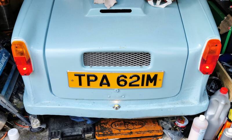

I *finally* found the long lost trim for the number plate light so have stuck that back where it belongs.
It's not perfectly straight, I'll tackle that another day when it's not a thousand degrees outside.
Did a bit more experimentation with the carb.  Let the engine run long enough to get decently warm to see if any running issues cropped up...still seemed happy.  Let's see what the CO meter has to say.
Well that's rather better than I'd expect for a carb from a totally different engine on which I've not even touched anything.
hah very cool you can see the thoria pellet inside the tungsten coil used to lower the work function of the electrode :)
(my only MA lamp is a GE A-H1 American example so it has different electrodes with the emissive material directly impregnated in the coils)
Got a better video today, showing throttle response...audio is better if nothing else.
The first run is me cracking the throttle immediately wide open after the engine had been idling for a good 30 seconds or so.  The engine here is always going to initially respond a little slowly just because it's got a really heavy flywheel attached and has to spin up the whole gearbox input shaft when the centrifugal clutch engages.
Anyone who knows these cars knows that this would normally have resulted in a fairly noticeable pause before the engine really picked up.
She starts a lot better now too.  Usually you had to give her a bit of throttle to initially get the engine to catch.
I have cobbled together a connection to the throttle cable which seems to work okay...think we might need to try to get a road test done tomorrow.
happy to see TPA is doing well so far with the new carb,
but something needs to be tweaked with your video settings, its at a weird aspect ratio wider than 16:9 but not quite full 21:9 I dont think?
either way its a bit TOO wide screen LOL it looks almost like the top half of the video is missing LOL
Re-jetting the original carb may well hell, though it's such a dark art that you'd really need to get someone who really knows this stuff to take a look and figure out where the issue is hiding.  Whether it's too little fuel, too much air or deeper issues with the design not being ideally suited to the engine.  Or I'm speaking rubbish and it is actually fine...though I reckon the spitting back behaviour is a symptom of fuelling issues, especially as I've not managed to provoke that even once yet since putting this carb on...and that's despite it actually running slightly leaner at idle according to the CO meter.
yeah, its interesting, I dont think this its an issue on any other steyr puch engined vehicles, (but most of the videos on youtube of them are of highly tuned examples LOL) I have only seen the Model 70 do it, ill have to try to remember to ask John REV's previous owner, about it see what he recalls back in when he serviced these for a living!
I do wonder if its something to do with Model 70's specific drive train, its  heavy flywheel and low speed of drive train engagement, it only seems to cough when you get on the throttle from a stand still/slow speed almost like its complaining about being made to suddenly get up and go as quickly as it can with such a heavy load to drag along with it LOL
I dunno just random thoughts!
I hope some day @dollywobbler (or you :) ) can get a stock 493cc Steyr puch 500 car for a test drive it would be really interesting to hear how it compares to a Model 70
Yeah, I need to find tune the video settings, I wasn't faffing with it for something this simple though.  I think the uber-wide aspect ratio is utilising the full width of the sensor, the normal 16:9 crops the edges a bit.  I'll make sure it's set to 1080p/60 and 16:9 next time I'm doing anything meaningful.
I have been meaning to do a proper "tour" video of the Invacar anyway, for which the wide angle mode will be bloody handy.  When I do get around to that I'll probably run the basic text I'll be planning for the voiceover explaining the history etc past you first for a fact check as I trust you to remember the details more reliably than me.
I've ordered a slightly slimmer case style than I normally use on my phone this time (aside from anything else, it seemed a shame to completely hide the back of it because it's so damned pretty)...
...The main reason for that though is actually that I hope to be able to more securely fix it within the window mounts I've got so hopefully will be able to get slightly less shaky video while driving.  We'll see.

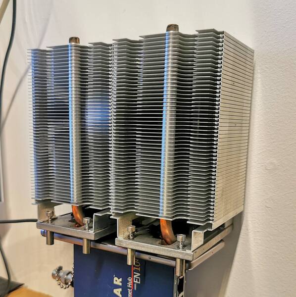

The P9 has now been returned to duty in the distributed computing cluster.  It does get rather toasty in this application though...but conveniently has an all metal case back (which is directly coupled to the back of the CPU by a thermal pad).  This was the solution I came up with for thermal management...
Yep, those are the old CPU heatsinks from my workstation.  I was sceptical that this would do anything as they're just sitting on the case...but they do.  The thing used to throttle the CPU after about 15 minutes before, it never does now and always stays well within spec.
