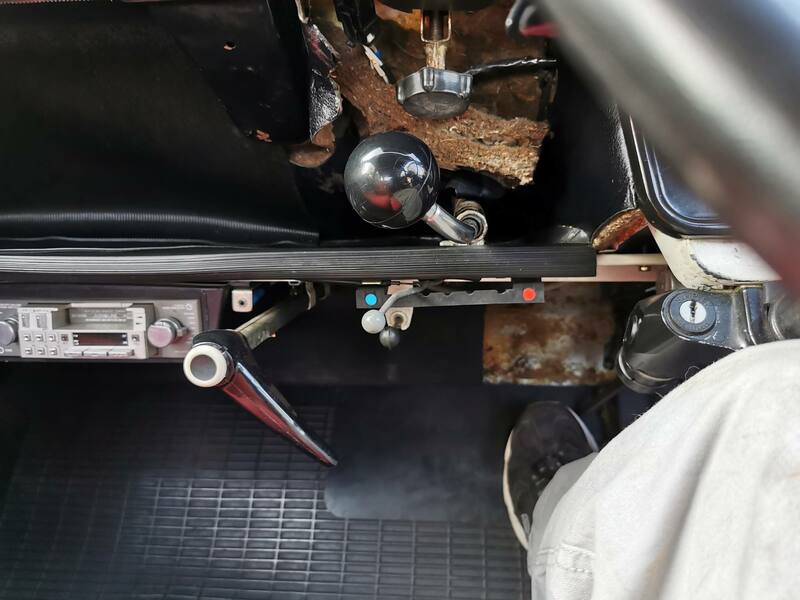

This afternoon I made a godawful mess, getting most of the old flooring out of TPA.
As expected given I could see daylight through it, the metal underneath the offside kick plate was largely missing.
I'll make sure a little plate goes in here to bridge the gap.  I did note that a few bits were hanging down there into the area of the door runner, I reckon this may have had something to do with why that door jams so frequently.
Quite a few of the rivets aren't actually attached to anything because they've dissolved, so I'll replace most of them.  I'll be adding a bunch across the floor panel anyway so it's held still against the chassis as currently it's totally free to move aside from at the edges.  That's going to involve drilling several dozen holes from underneath... that'll be fun.
Then we can start getting the new flooring installed and she will start to look a good deal tidier inside.

Well I think we might have found a large reason for the floppy floor.  A significant number of the rivets weren't actually secured into anything because they were smaller than the drilled holes, some others were only secured to the floor panel itself, and several others had dissolved.  I reckon about 20% of them actually secured the floor panel to the chassis.  Oh, and most of those were loose.
After a brief period messing around with the rivet gun I lost patience and just grabbed the bag of nuts and bolts.
Just this has added about 70% to the rigidity of the panel.  A lot of the rivets holding the body overlap to the floor seem to be just as bad, so I'm going to drill out and replace them all with stainless bolts.  Just need to pick up some new big washers for the body mounting bolts.
While it's a bit tedious this shouldn't take too long.  Currently there's no attachment to the floor panel aside from the edges.  My intention is to have it bolted to each of the chassis rails/braces.  Here's what's under the floor for those who haven't seen underneath an Invacar floor.
If there are still problems with any areas being floppy I'll probably attach a couple of lengths of ally bar diagonally underneath just to stop the panel from being able to flex so much.  We're keeping things pretty simple though.  Not wasting months on this.
The seat needs to come out next though as it's just going to make everything far easier.  This isn't going to be a "take the whole car apart for six months" job though.  I've been enjoying using the car too much for that, but I decided that I needed to sort the flooring situation after I did actually fall over getting out last week and very nearly took my eye out on one of the hooks on the garage wall because the flooring was so slippery.
Even when it wasn't trying to kill me the flooring was really scruffy though and was bugging me.  While I'm not too precious about the outside I do like my car interior to be tidy, and having this sorted out will definitely help my enjoyment of the car.  Very curious to see if it helps take down the noise level at speed at all.
The original kick plates are quite rough so I'm probably going to replace those, I've got some nice aluminium extruded pieces (they're actually stair tread plates) which will do the job nicely and as the return is a little less deep will make cleaning/greasing of the door runners less fiddly.  Think I bought those back when I first got KPL for this very purpose as they were completely missing on that car.

If I have a bit of spare time tomorrow I hope to have all the rotten rivets replaced.  I was pretty low on stocks of appropriate fasteners so did a bit of a restock today.
Should hopefully be everything I need to get the floor properly attached to the framework for the next couple of decades.
I appear to have managed to fail to take a photo...but not a huge issue given there's not much to see!
All of the rivets to the left of the seat in the floor of TPA have now been drilled out and replaced with stainless bolts.  The vast majority just disintegrated the moment I touched them with the drill so clearly weren't doing much useful.
The difference in rigidity of the floor panel with only that done is huge...you can still make it move, but it has resistance and doesn't just flop around.  Thumping it with a first now makes a solid sounding thud rather than a hollow rattle.
I definitely want to make a point of changing all of the fasteners involved here as they're all clearly shot.  So the seat needs to come out next as there are half a dozen buried underneath it that I can't get to any other way.
Goes without saying that I'll be looking closely at a few of the other body mountings where rivets have been used in case they're in as bad a shape - though the water being trapped under the floor mats for years probably made the issues here so much worse.
