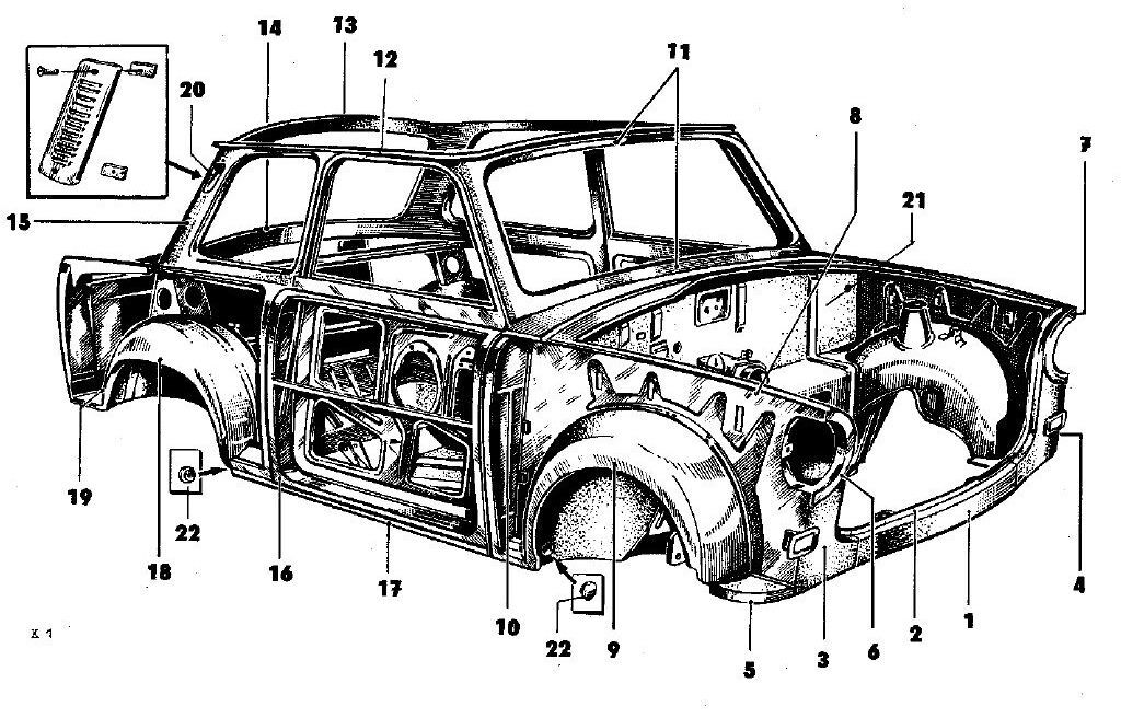

The main monocoque chassis is steel with Duoplast panels screwed and adhered in place on the sides, bonnet, roof and boot
4 hours ago, paulplom said:
I always thought these were grp or fibreglass.
Structurally kind of like a tiny P6.  It's a steel skeleton with plastic panels hung off it.
The other thing I should have mentioned in that last reply is that Duroplast is actually quite a different material to fibreglass.  It really is its own thing.  From a "what is it?" perspective the best summary would be cotton fibre reinforced bakelite.  Though the way panels were made was closer to what you'd expect from steel than most fibreglass processes.
The resulting panels are quite different to fibreglass.  I don't have a huge amount of experience with GRP panelled cars outside of the Invacar and a couple of friend's Reliants, but the Duroplast panels on the Trabant feel a little heavier but much stiffer than most GRP panels I've any experience with.
People like to joke about it, but honestly it seems to be a material which really is well suited to the way it's used here.  Aside from the bonnet (which in my case has been damaged anyway so may be more floppy because of that) you honestly wouldn't really know this wasn't a steel bodied car.  There's none of the frame flex and body rattling which usually seems to go with the territory.
You need to get the oft repeated jokes about them being made out of cardboard out of your head - It really is properly sturdy stuff.

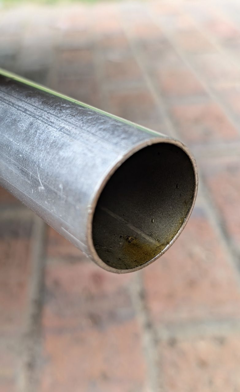

It's astonishing how much pipe there seems to be in even a really basic car exhaust when it's off the car and inside the house.
It doesn't sound like a lot on paper, but you can definitely see it is bigger than the standard pipe when you compare them.  Doesn't look ridiculous though.
Apparently there are differences to how the innards of the heat exchanger/expansion box are set up compared to the standard one.  How much difference it makes in the real world remains to be seen.
It's actually only held on the car in four places, and they're all actually easy enough to get to.  Only two require crawling around under the car, the ones on the silencer.  I'll have a quick look at the state of those tomorrow so I know what sort of fun and games we're in for.  Everything else has been off recently so shouldn't be too much of a headache.

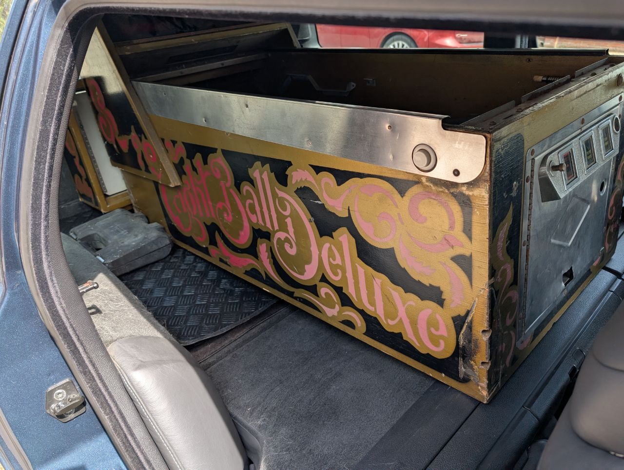

That's been about it for excitement this week.  Aside from proving that a pinball table will indeed fit in the back of a Volvo V70 with ease.

There's no way I'd have been able to build this part myself.
Aside from the actual carpentry, the hardware around the front of the machine, the side rails etc being "right" is really important if it's going to feel anything like realistic to play.
As mentioned, there is "some wear" to it in addition to having been picked over pretty well.
The worst of it though is on the back of the machine which will be up against the wall (from being shuffled around while sitting on its back no doubt) or is hidden behind the legs anyway.  It'll look a lot better once cleaned up and the paint has been touched up a bit.  It's a sound (and exceptionally heavy) base to work from for my purposes.
A lot of people who are doing things like this would repaint the whole thing and or apply decals or something - my plan though will be to just touch up the original paint.  I'm not going to hide what it originally was.
There are a fair few bits involved in this.
[] The cabinet.
[] A large high resolution display in place of the playfield.
[] Additional displays to take the place of the backglass art and the score/dot matrix display.
[] A PC to drive everything.  Which actually needs to be decently powerful.
[] Collection of actual pinball machine hardware (flipper/kicker/pop bumper/knocker solenoids, set of chimes, bells, shaker motor, ball launch plunger), driven by a specialised IO controller.
[] Actual flipper buttons & switches.
[] Bundle of power supplies for all the above.
[] Audio amps & speakers for both table and effect audio.
[] Several miles of wiring.
[] Specialised front end & simulation software.
Probably the most important bit of hardware is the playfield display.  Which I picked up at the start of the week, in the form of a 40" 4K PC monitor.  Which is an unreasonably good fit.
Which will actually sit down a good bit deeper in the cabinet eventually - but this allows a bit of a proof of concept photo though showing some idea of what we're going to be looking at.
I really ought to have taken a shot of Eight Ball Deluxe now I think about it, though I had this to hand.  These are obviously just static images and not even close to full resolution, it does give a vague impression of how it will look though.  It's worth noting that when the actual software is set up things like the scaling and view angle will be adjusted properly to look right - this is just a quick and dirty test.
The real work now starts.  Step 1 I think will be making a bracket for the display to be attached to (which is what that big wooden panel I picked up today was for - I'll be attaching the display to that via the VESA mounting points) and figuring out how far I need to drop the original supports down.  Then go spelunking in the loft to see if I've got displays "on the shelf" so to speak which will do the job for the backglass and score displays.  Reckon I have.  Which is nice as this isn't going to be a cheap project as it is anyway so if I can save a few quid by using parts I already have sitting around that's a bonus.
It will just be little bits and pieces done at a time when I have five minutes and aren't faffing with the cars, which if there's any interest in I can document it.  If not I might put a brief summary up somewhere, but it likely wouldn't include any of the head scratching and problem solving that goes on, which I think is what some people might find interesting.  Plus if I put different things in different places I have a terrible record for keeping the offshoots up to date.
I have to ask, theres not any fluorescent lighting in the "eight ball deluxe" signed top part? kinda wondering since I know on old arcade cabinets the marque as I think it was called? (ie the illuminated sign of what game the cabinet was running) often had a small fluorescent tube there :)
It would have originally been fluorescent lit, yes.  Which is actually quite unusual for pinball tables.  Sadly all that's left of that is the lamp holder sockets.
The vast, vast majority of them used a matrix of incandescent lamps for the backglass illumination.
