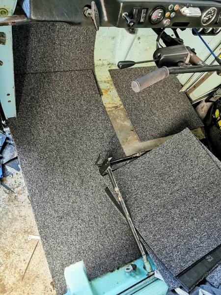

I'm basically making the left carpet, right carpet (which is *mostly* just a mirror image) then will cut an infill to go in the middle.
Nothing is being glued in place yet.   Before that happens I need to rotate the car 180 degrees so I can do the same knackered rivet replacement on the offside, paint the seat base, find a rubber boot for the gear selector linkage where it passes through the bulkhead and thoroughly degrease the entire floor and front bulkhead.
As the seat can only be moved a few inches to either side I'm also doing away with the sliding capacity.  Two bolts will be going through the rear of the frame to secure it in place.  As the latch is at the front of the frame the rear of the seat tends to shift an inch or so every time you change direction, and it's quite annoying.  If someone wants to undo it in the future it will just require a couple of bolts to be removed.  Should make the driving experience a bit more pleasant.  Having a wobbly seat just never instills confidence!

This is actually starting to look like I've got any idea what I'm doing...
The joins will be far less visible once things are actually glued down.  Plus the bar across the middle isn't bolted down at the offside yet hence the bump there.

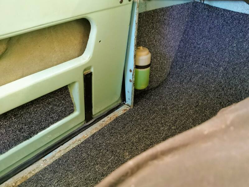

New offside outer "sill" made up from some ally sheet and bolted in place.
I tappedthe edge at the overlap flat with a hammer, though as this will be under both the carpet and sill kick plate I'm not really too bothered about how it looks.
I then went on a similar rivet replacement mission as I did on the nearside before giving everything a thorough wipe down then starting to get the carpet glued in.
After an hour or so getting distinctly high on carpet adhesive fumes we were three or four pieces away from the floor being done.
Closer look at where it's following the contour of the front bulkhead to show how well it's formed.
Yes I fouled up the bit by the steering yoke bracket...an infill will be cut to disguise that oops.
Will see if I can steal half an hour after dinner to go back out to stick the last three or four pieces in place... having to stop this close to done with this part of the job is really annoying!

Think that's looking better!
Astonishing what a difference a bit of trim can make to the feel of the cabin.
Main thing left to do is reattach the offside kick plate, but after fighting with it for 15 minutes established that requires access to that side of the car.  So it will be done once it stops raining for more than five minutes.

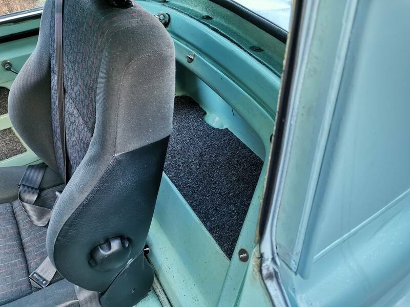

After attending the funeral of a friend this morning I found myself with a couple of hours free this afternoon so I decided to try to crack on with getting the offside kick plate sorted.
After a couple of hours of hitting things with hammers and swearing at it we were done.
Then the seal was refitted.
Which meant I could finish putting the cabin back together.

After a quick run round the block I can definitely report that the noise levels in the cabin are very much reduced, as is the general amount of rattles.  I'll try to get a better test done tomorrow.
