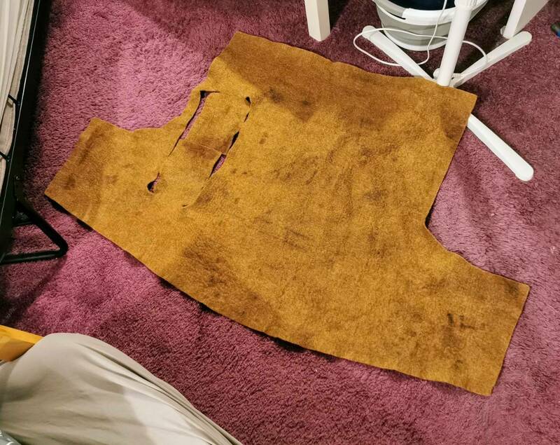

Simple but satisfying jobs today.
The carpet underlay in the front was switched round so the cutout for the pedals was in the right place.  Still don't know why that didn't occur to me when I was fitting it - though having to work around school kids running around my driveway at the time probably didn't help.
The observant among you may also spot the other thing I forgot yesterday afternoon.  The fuel switch was left on overnight.  I can however now confirm that the needle and seat in this carb are decent enough to prevent the whole tank decanting itself overnight.  Though it did leak by enough that I created my own little recreation of that video of them crossing the border the day after the fall of the Berlin Wall when I started the car up.  Thankfully after five minutes or so of driving the biblical levels of smoke reduced to invisible again.

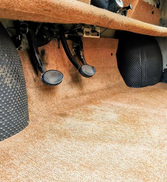

As I had hoped the carpets had fully dried overnight.  They're not spotless by any means but I think are a hundred times better than they started out.
My suspicion was that once they were in the car that the marks would be far less apparent.
Think I was right.
Perfect?  No.  However it's a 39 year old car, and based on that context I think is entirely acceptable.  The area by the pedals is looking in really surprisingly good shape given there's no separate heel pad or anything there.
Not sure what these carpets are made from, but it seems to be pretty hard wearing whatever it is.

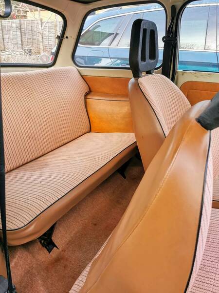

Between the carpets being back in the car (and no longer saturated) and the cooling shroud now actually being bolted together the car is waaaaay quieter to drive.  Don't get me wrong, it's still ridiculously loud, but it's a thousand times better than it was.  You can actually have a conversation at 50mph just by raising your voice a bit rather than actually having to shout.
Here's the before and after from the day I got the car and today inside.
Quite the difference.
Externally not much has really changed though!

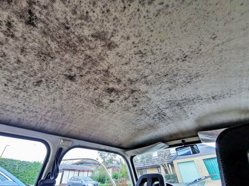

One area which has really suffered from the long term water ingress is the headlining. Well, such as it is. The "textured vinyl pad stuck to the inside of the roof" would be more accurate. It does a decent enough job of keeping the panel from drumming and dampens echoes in the cabin so what more do you need? Sadly the mould really has gone after it.
Interesting that there really wasn't much of it on the seats, steering wheel or seatbelts where it usually turns up. Just the roof. I have already given that a scrub down with a couple of cleaning products (including one to kill anything still growing there), but the staining really does seem to be ingrained into the texture printed onto the lining. The ideal approach to this would be to attack it with a bleach solution and a stiff scrubbing brush. However that's kind of difficult with it being glued to the roof, and I don't particularly want a face full of bleach or to find out the hard way which bits of the interior can be bleached of their colour. I very much doubt it will come out in one piece to allow me to deal with it on the ground. One thing I do have which I think may be worth a try is the steam cleaner. At the end of the day, a new headliner is €70 from the usual suspects, so I'll be planning on ordering one along with whatever the next batch of parts is I think. If I do manage to shift the grime in the interim that will just be a bonus.
Grubby headlining or not, the car was out and about again this afternoon, making a Fiesta look big.
