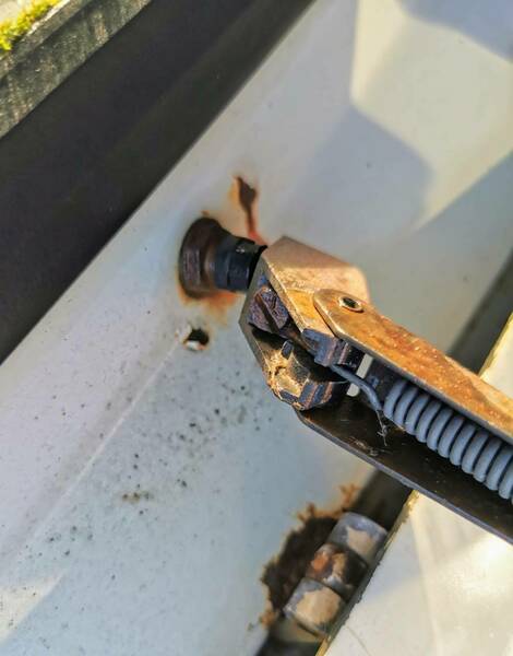

The wonky windscreen wipers were actually really simple.
The arms are held onto the spindles with grub screws.
Said grub screw on the driver's side was barely finger tight.  There is a fair amount of play in the spindle itself, but there's now about an inch of rotational play in the system rather than being able to move the wiper a good 1/2 the way up/down the screen freely.

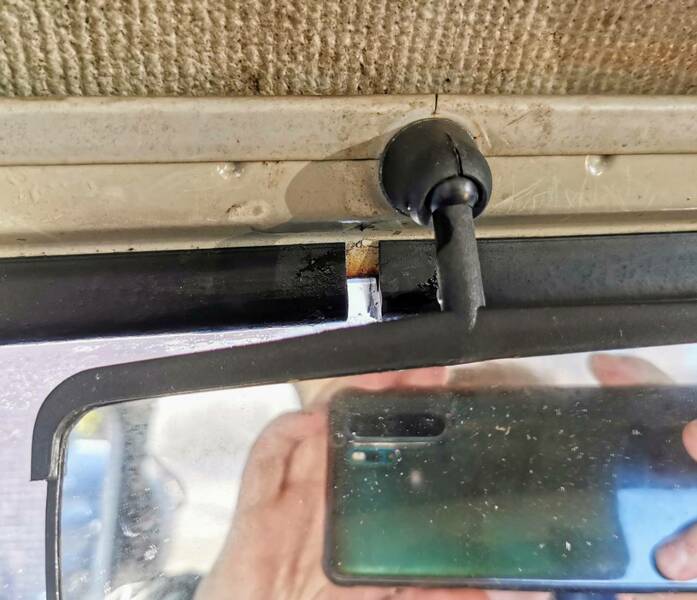

You can see daylight through the gap in the seal on the rear screen too, albeit a far smaller gap.
It doesn't look like there's any provision for the gutters to drain at the front of the car unless I'm missing something and there's a plugged hole in there.
This will have been encouraging water to run down into the door aperture.  I'll park the car facing uphill from now on to prevent that happening.

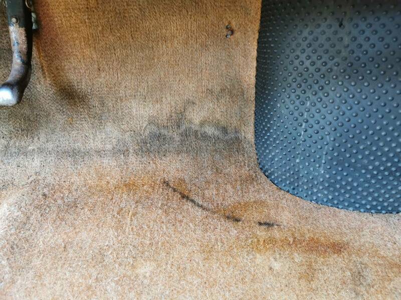

I did attack the carpets with the wet vac today to try to pull at least some of the moisture out as there's a lot of water in the car.  Unfortunately removing the swimming pool in the rear foot well was hampered by it getting down to -5C here last night so the water in the carpets there was basically a block of ice.
I'll need to revisit that obviously.  Likewise the passenger door pocket which has about 1" of solid ice at the bottom of it.
I did get a load out of the rest of the carpets though.
Doesn't look much different, but there was a good 3" or so of water in here.

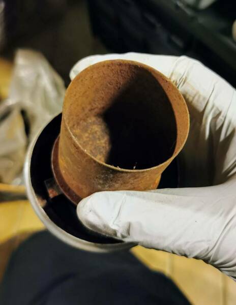

Next find was an older style fuel cap, which is totally going on the car if it's the right size.
Has a little cup on the underside I assume intended for measuring oil into the tank.
I think this fuel cap is actually for an MZ motorbike (another IFA product !).

Looking at this witness mark, I'm suspecting that the right hand side of the windscreen may be responsible for a lot of our water ingress.
I'm also somewhat suspicious of the passenger door seal, though hard to say if the water sitting in the bottom of the channel was just condensation as there's condensation all over everything at the moment.
