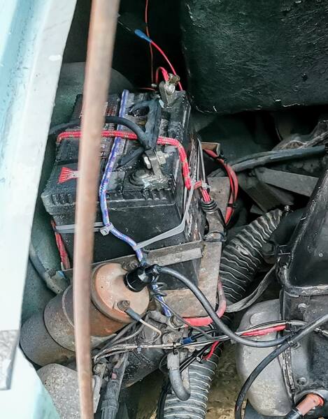

Spot the difference.
(Aside from the distributor cap.)

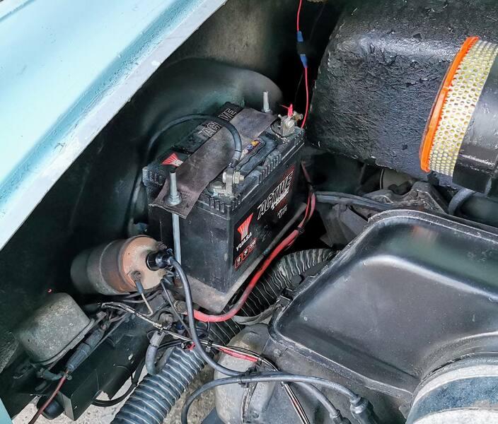

Yes... finally dealt with this horrific bodgefest.
These are the original battery hold downs.  Sadly as I was completely unable to find the original form factor battery (or indeed what type it even was), they're basically useless.
Here's a reminder why bungee cords and cable ties are not a permanent solution.
That had been pinched between the rear wheel tub and the chassis rail and had rubbed about 2/3rds of the way through.
My solution has been to cut a couple of bits of M8 threaded rod to roughly the right length (a little over 6") and fasten a bit of webbing between them - this is a bit of seatbelt originally from KPL I think where the buckles had completely rotted away to nothing.
I heated a metal rod up to red hot before using it as a punch to make two holes.  This melts the fibres together and prevents anything from fraying.
Not too worried about that anyway.  Ever tried to tear a seatbelt, even if it's already frayed halfway through?
Finished article...
It's tightened up sufficiently that the battery is completely secure.  If I have issues with it ovalling the holes out I'll replace it with a strip of angled steel instead - but I'd really rather avoid the need for metal across the top of the battery if I can avoid it given the layout.  I might go back and bolt a lip onto the tray though just so there's then *absolutely* no way it could conceivably slide free then.  It can't go anywhere the other direction as the wheel tub is in the way.  Probably overkill...but I'm a fan of doing what I can to keep Murphy's Law at bay.
