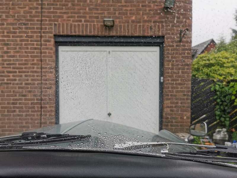

The Rover had one very annoying fault which rendered it all but undriveable in the rain.  That the driver's side wiper was catching on the top of the windscreen surround and lifting it off the screen for about 20% of the sweep.  Literally smack in front of my face.
That was a pretty easy fix by trimming the end off the wiper blade, being careful not to go too deep to uncover the metal.
Sorted.
Now I expect the wipers to merely be awful rather than it actually being worse having them turned on than off.
Quick fix but nice to have done.  Been meaning to since the (very wet!) day I picked it up.

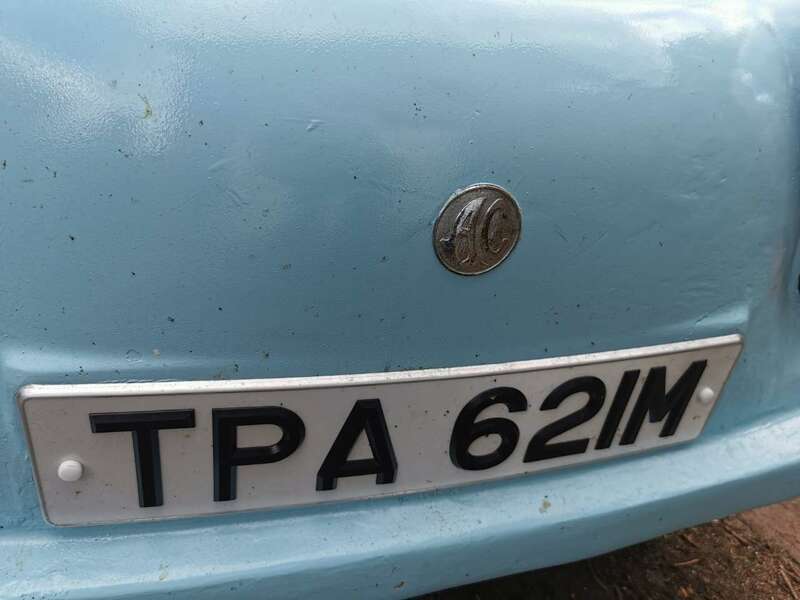

Unexpectedly an additional fleet member was acquired today.
This turned out to be abandoned in a hedge along the side of our properly that was removed today.  It's clearly been there for a long, long time (but less than eight years as it definitely wasn't there when we originally put the fence up).  Given the level of problems we've had with narcotics abuse in the space behind that hedge (which was one of the main reasons we wanted shot of it - hopefully with their cover gone the users will go find somewhere else to loiter) I made a point of checking with our local police station to ensure they didn't have note of the frame number as having been reported as stolen.  They checked a couple of databases and confirmed they had nothing on file for it - and seemed thankful for a face turning up at the window that wasn't hurling abuse at them.
It's been sitting for long enough in the weather that it'll need completely going through, and I *rather* doubt from the look of it that it was exactly a high end bike to start with.
However there's a simple satisfaction to be had in reviving something totally against the odds whether it makes sense or not.  So provided there aren't any total show stoppers like cracks in the frame it'll likely have another shot at life.

The wipers on the Rover are definitely working better - but still crap.
There isn't enough pressure being exerted by the spring in the arm to keep the blade fully in contact with the screen.  It's extremely wobbly where the spindle passes through the scuttle to suspect we've got knackered bushes in there which won't be helping anything.  I'll investigate later in more depth (ideally when it's not raining).  The wipers at least now are actually worth turning on when it's raining.  Beforehand they literally just made things worse for the driver.

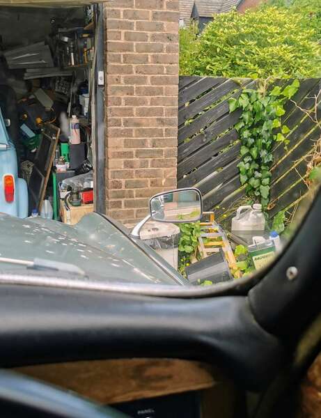

Spot the difference here compared to earlier photos of the Rover?
How about from here?
Yep, sorted the mirrors so they actually stay where you put them now (or at least I hope so, haven't been out of town yet since securing them).
Passenger side one is still kinda pointless - I do wonder if it's got the correct arm fitted as it's pretty much totally hidden behind the bonnet unless you lift yourself up from the seat a bit.
Though equally I do know the springs in the seat are a bit tired.
Will make parking a lot less stressful at least.

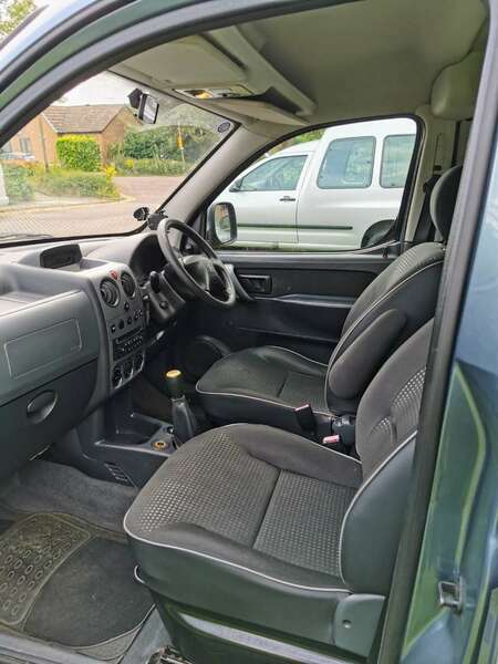

I'd been keeping my eyes peeled for one of these for a while, so when I got a second shot at this having missed it on the for sale forum here a couple of weeks ago immediately pounced.  Especially as this has one pretty rare option ticked which was high on my wish list.
Air con.  Which even works.
Needs a little love in a few areas, but for the price paid is in pretty good shape.
A really good valet and deep clean of the front seats will make a big difference.
Given these tend to be vehicles which earn their keep by working pretty hard though it really isn't bad at all.
Nice to see this still has the fold out load cover.  Those have usually long since vanished by this age.
Engine bay deeeeeefinitely has an appointment with some degreaser and elbow grease in its near future.
Aside from some bodged on wiring for an aftermarket horn (currently run to a button on the steering column) at a glance it seems free of hackery though.  Just needs a clean.  Guessing the horn issue is likely to be a clock spring problem, so we should be able to hopefully get rid of that in due course.
I didn't realise these got the Pug 206 style fitted at this age, though I'm not quite sure what possessed PSA to think that silver was a good colour to make your instruments.
Depending on the ambient lighting the visibility varies from absolutely fine to completely unreadable.  I pity anyone who actually wants to read the Km/h scale on the speedometer.
Drives really nicely though.  Clutch is a bit heavy, but I'm used enough to diesel PSA products to know that's par for the course.  General refinement and ride quality are streets ahead of the Caddy, as you'd kind of expect.  Aside from being a newer design, it's something that was designed from the ground up to be what it is rather than a small hatchback that someone welded a box onto the back of.  It's miraculous really that the Caddy drives even half as well as it does, but it does have shortcomings, particularly in the road noise and suspension refinement departments.
