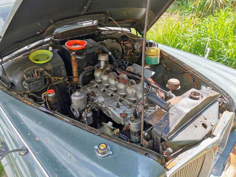

Things *may* be looking slightly less grim for the Rover though.  As I'm sure you would, before committing to pulling the head off I wanted to be absolutely bloody sure the water wasn't coming from somewhere else.
Using a camera to get where I can't see directly I noticed something which very much made me go "Hmmm..." Just now.
See it?
Zoom, enhance.
That is water running down the face of the head, above the seam with the block, apparently from the bottom of the inlet manifold.
The inlet manifold which I know is water heated.  Which for some unknown reason my brain had decided didn't have a wet connection to the head...yeah, given there's only one coolant line to it that would work real well wouldn't it?  Of course there's coolant passing between the manifold and head.
That corner, where the seal looks distinctly compromised from what we can see of it, I believe corresponds to the circled bit on this new gasket.
Which looks to me rather like the sort of cut out I'd expect for a coolant passage.
So I think we'll try replacing that before we go to the lengths of pulling the head off.  Though I'm not actually sure it's all that much less actual work!
...It does mean not having to bin two gallons of oil with all of about three hours of run time on though, which my wallet would definitely appreciate.
The head *will* need to come off at some point at the very least to replace the water pump to head seal, but if we could take a bit of the urgency off at least until I get the Renault sorted and through its MOT next month that would be lovely!

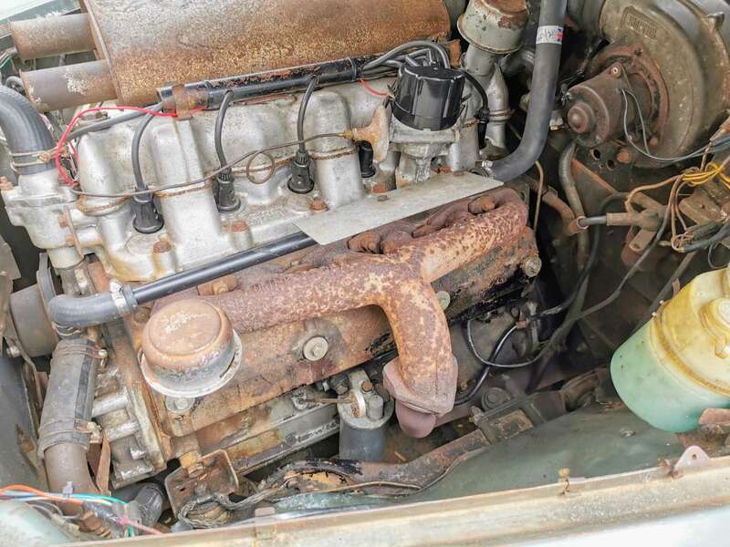

I've given everything that needs to be unbolted a thorough dousing in PlusGas while it was warm today and will leave it to stew overnight.  Hopefully get the opportunity to try to pull things apart tomorrow.  Fingers crossed without breaking any studs or daft nonsense like that.
I do not handle heat well.  Anything north of low 20s C, I'll be hiding in an air conditioned room please.
Perfect day for working on a car then.
Simple enough, couple of the nuts on the underside of the manifold were a bit of a git to get to, especially the one directly above the generator, but nothing too bad.  Helpfully all those involved are sizes which match metric, so I could use the less clunky tools.
The front lower nut holding the carb onto the manifold though still tried my patience.
Thankfully everything unscrewed without any protest - I was slightly concerned about the hazard of studs breaking, but no worries there.  About a third of them unscrewed from the head rather than the nut coming off, but I'll take that over a struggle any day.  I kind of wish they had all done that as it would have made scraping the gasket off a heck of a lot less fiddly.
My theory was that the gasket had failed around the rearmost lower coolant passage, so finding this was a bit of a morale boost.
What then followed was the best part of two hours of scraping.
Shown here at about the 80% stage I think.
Obviously I dug as much of the gunk out of the head and manifold as I could, but there really wasn't much to be honest for a car of this age.  Few bits of flaky crud, but nothing too bad.
I was originally planning to leave it ready to put back together and call it a day today.  However then bloody mindedness, mindless determination, stupidity (delete as you think appropriate) took over.
Roughly an hour later.
I reckon at least half of that time was spent bolting the bloody carb back on.  That one nut is absolutely bastard awkward.
I got everything back together and had time to get the cooling system bled, up to temperature and a quick test run round the block.
Result?
I'll take that.  We had two oil leaks pretty immediately evident.  One (which you can see there) was from the filter housing retaining bolt on the oil filter.
Which after being tightened up a smidge further seems to have stopped.
The other one is I'm 90% certain is just coming from the rear of the exhaust valve tappet cover which I'm waiting on a new gasket for.
After the car had been sitting for about 15 minutes there was one drip from the rear of the engine which looks to be oil rather than coolant - and on a 60 year old Rover I'll call that entirely acceptable I think.
We'll only really be able to tell properly after I get the car out for a proper run, but initially things look hopeful at least.

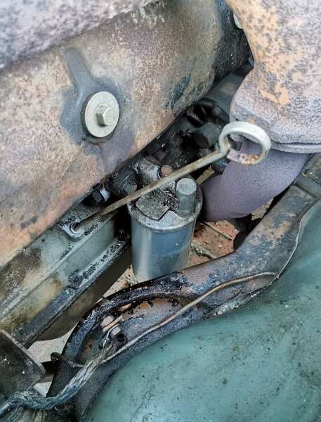

Had the Rover out this afternoon for about an hour or so of bumbling around running errands.
Good news, it's no longer peeing oil everywhere now the oil filter housing bolt was nipped up.  It's also no longer peeing coolant out.
There is however still a coolant weep in that general area - it's not enough to be an issue I reckon as the amount of scale in the general area suggests it's been weeping for years if not decades.  Plus before it started pouring out of that blown gasket there didn't seem to be any excessive water usage.
Pretty sure the only reasons we can be seeing water creeping out there is either a crack or porosity issue in the block.  I can't *feel* anything, but the water appearing there (it never actually drips, even after the engine is stopped) tells me there has to be something there.
Given this is a wet liner engine and has a cooling system capacity somewhere in the region of 15 litres, so provided the loss doesn't become an issue from either a manageability or environmental standpoint I'm just not going to worry about it.  Doesn't strike me as the sort of issue that's likely to suddenly get worse overnight.  Just keep an eye on it I reckon.

Last oil leak I'm bothered about fixing on the Rover (there are a couple of really minor weeps I'm just not bothered about) was from the rear of the exhaust tappet cover, which dripped into the starter motor and would leave quite a mark when parked up.  Especially after a higher speed run.
I'd been waiting on the arrival of the correct gasket for it as I managed to order the wrong one initially. Which I'm sure was a case of fat fingers and touch screens rather than me not knowing what I was looking for.
I continue to be astonished by how clean this engine seems to be internally.
Someone really has taken care of this mechanically for a lot of its life it seems like.
As I kind of expected, the issue was indeed a flattened and deformed gasket towards the rear.
Thankfully unlike the one on the inlet side, this hadn't been glued in place and peeled off nicely in one piece.
You can see how much it's lost its shape compared to the new one.
New gasket in within ten minutes.
Then went out for a half hour or so test drive, including a fast run up and back down the A5.
No sign of any drips at the back where it always used to leak.  Slight weep around a couple of the bolts (I think the seals under them have gone flat), but nothing to worry about.  I'll get a new set of washers for the bolts ordered next time I'm getting parts in, but it's not urgent.
I don't mind the odd drop here and there, but it will be nice not having a perpetual oil slick where I park on the drive now.
Though I'm also fully aware that this is a 60s British car, so it will probably just find somewhere else to come out of now!
